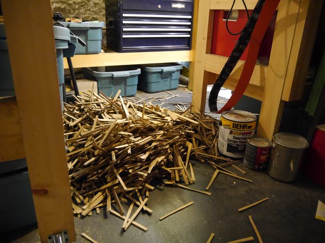

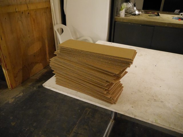

I just prepared about 31,000" of cardboard stock ready for cutting up. I'm pumped to go establish some general trends :D
Ok! So I just finished running the test blades through all the cardboard I had... In total I cut 19,440" of cardboard (1620 feet). I was planning on doing several runs, but the first blade was still cutting at the end of the allocated cardboard, so I kept going until I had used up 1/6 of the total amount on that one blade, then I did the same with all the others.
Each blade cut 3,240" of cardboard.
And I am completely unable to tell them apart by sharpness.
Each blade:
1) No longer shaves at all
2) Happily cuts copier paper
3) Cleanly cuts phonebook paper 45º across the grain (from the side)
4) Won't cleanly cut phonebook paper with the grain (from the top)
5) Still cleanly cuts corrugated cardboard
If you guys have any suggestions for other simple tests that might help discriminate between them I'd like to hear them! On the face of it though it seems that they all held their edge quite acceptably.
EDIT: Here are some photos of the test stock and the resulting carnage:

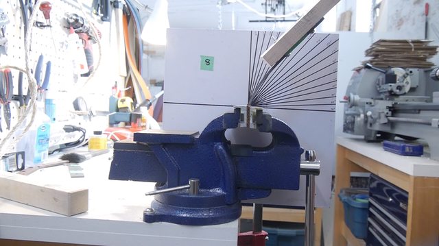

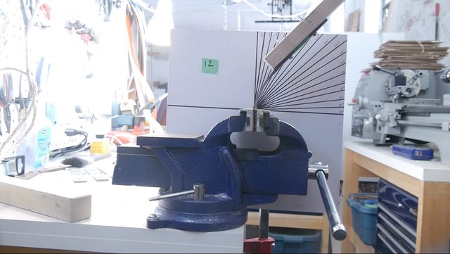

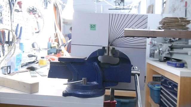

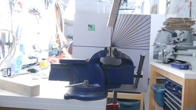

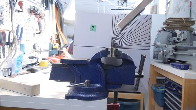

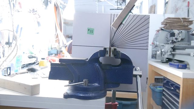

Break test:
Overall I was very impressed with the break testing this time! With the exception of blade #9 I consider all of the results to be acceptable. Each blade was very noticeably bent before failure, much more so than during the first round of tests. The only reason I consider this test important is because if a user of one of my knives decides to use it as a prybar then I want the knife to give them a strong visual indication that they're doing something bad well before it breaks.
The angles were measured by the angle of the tang of the knife.
Code:
[FONT=Courier New]
#7 - 42º
#8 - 42º
#9 - 10º (This blade failed early due to the crack that formed during the impact test earlier)
#10 - 90º (Wow!!!)
#11 - 35º
#12 - 42º
[/FONT]
#7 - 42º
#8 - 42º
#10 - 90º (!!!)
#11 - 35º
#12 - 42º

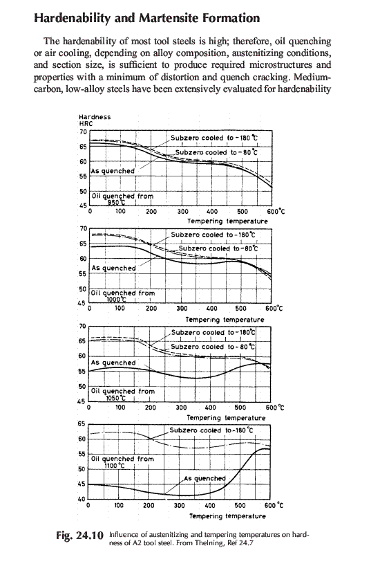

EDIT: Anyone seeing the results here for A2 should note that an experimental heat-treat was used for this test, not a standard A2 heat-treat.
I have to say I'm surprised that the A2 dropped back in terms of performance with the revised heat-treat. I think that the heat-treat I tried was likely optimized for edge-retention rather than extreme toughness. Putting it up against CPM3V is a pretty tall yardstick after all!
It's also worth noting that the differences in the other blades because of the revised heat-treats was pretty awesome! All of the other blades benefited from the updated heat-treats (except the toughness of A2, I bet edge retention on A2 has gone up if I could measure it). CPM3V in particular saw huge improvements, bending to 90º while fully hardened is simply amazing!

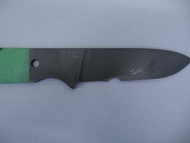

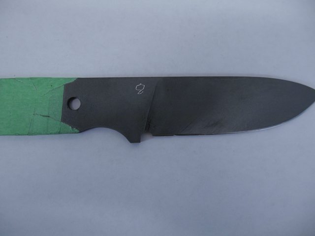

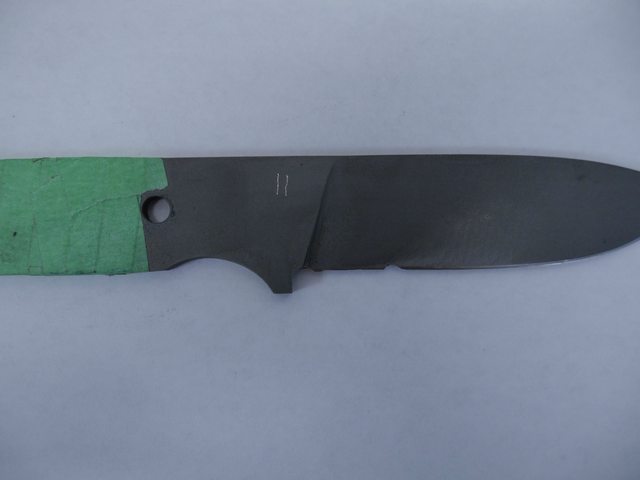

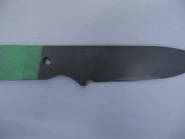

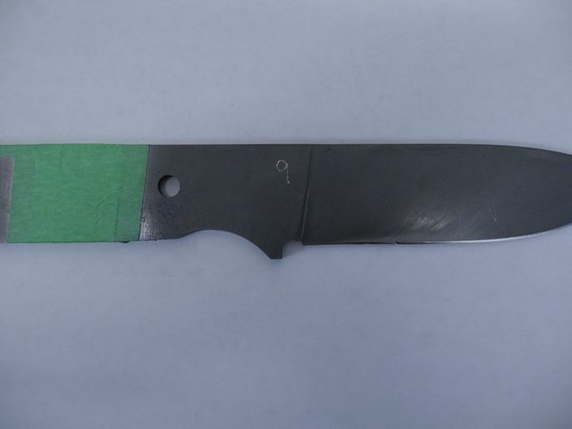

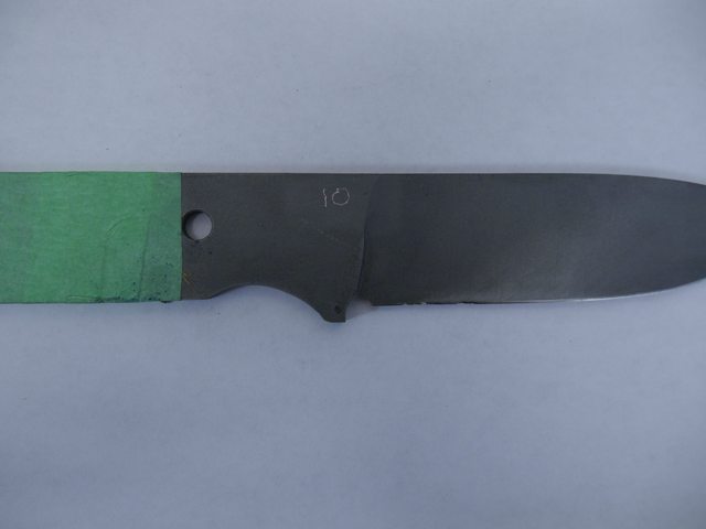

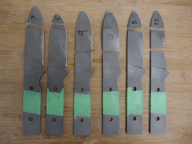

Here's what all the blades look like after being broken:
And here is blade #10, after it's infamous 90º bend!

Blade 9 - A2 Ver2 (62.5HRC) - 10º

Blade 11 - A2 Ver2 (60.5HRC) - 35º
Blade 7 - CPM154 Ver2 (62HRC) - 42º

Blade 12 - 440C Ver2 (59.5HRC) - 42º
