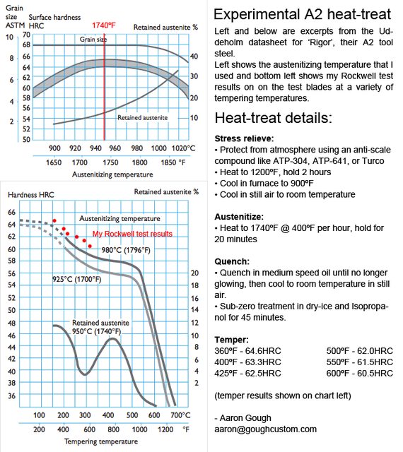

The A2 blades turned out to need a much higher than anticipated temperature for tempering, seemingly due to the really high initial hardness that we achieved. Getting the second blade down to 60HRC was a frustrating process of tempers at ever increasing temperatures.
Here is quick synopsis of the heat-treat that was used in the end for the A2 blades:
Stress Relieve:
Coat in anti-scale compound
Ramp to 1200ºF, hold 2 hours
Furnace cool to 900ºF
Cool in still air to ambient
Austenitize:
Ramp to 1740ºF @ 400ºF/hr, hold 20 minutes
Oil quench until no longer glowing, then cool in still air to room temperature
Sub-zero treatment in dry ice and isopropanol for 45 minutes
Temper:
360ºF - 64.6HRc
400ºF - 63.3HRC
425ºF - 62.5HRC
500ºF - 62.0HRC
550ºF - 61.5HRC
600ºF - 60.5HRC
I ended up with 2 blades, 1 at 62.5HRC, 1 at 60.5HRC.

Ok, so last night I will admit I was a bit confused and worried about the hardness testing numbers I was seeing. The same sentiment was echoed by another forum member so I was spurred on to do a bit of digging around and see whether these numbers are really fishy or not.
Below is a simple visualization I put together of the heat-treatment details for the A2 as well as the tempering results:
You cane see that the austenitizing temperature that was used was the one that gave the highest as-quenched hardness, add very fast quench and the sub-zero treatment to that and that blade would have been VERY hard before the temper.
The results that I was seeing after the different tempers have been graphed against the curves that Uddeholm provide. You can see that the results I got reflect the curve quite nicely, they're just 1 point or so higher.
After seeing this my worries are pretty much calmed. We had to temper higher because of our higher initial hardness, the graph shows the same phenomena for different austenitization temperatures quite clearly.
I'll be double checking the calibration of my hardness tester, and the hardness of the blade once I get to the shop, but I don't think the numbers are an error at this point. Quite a relief!
