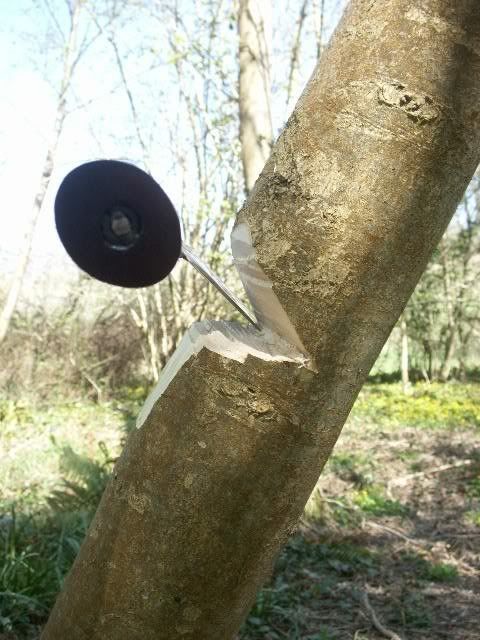

Mors Kochanski uses and swears by a puukko style Mora that has a full length, stick tang. He does all sorts of wild stuff with it. He's even tested it by driving it into a tree and standing on it.
