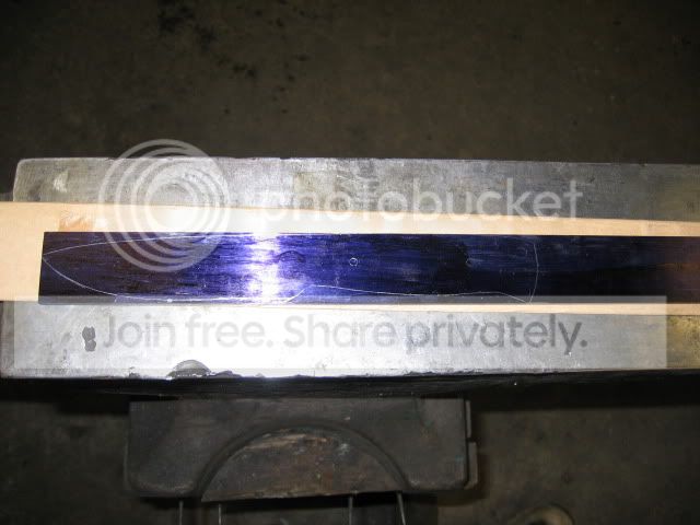

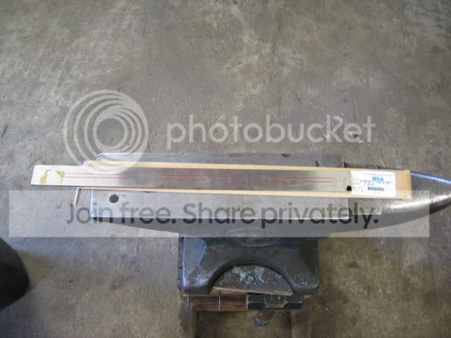

1.) For this knife I will be using O1 tool steel. The “O” in the name designates that this is an oil hardening tool steel. O1 is a very popular tool steel for all different levels of knife makers. This piece is precision ground which means that it has been ground perfectly flat. This is advantageous because too makers who don’t have the capability to forge because the steel is annealed and ready to work. The size of this piece is 18” x 1 ¼” x 5/32”. Most pieces of precision ground steel come in 18” or 36” lengths.
2.) The first thing I do to the steel is to use Dykem to “paint” one of the sides. Dykem is a type of fluid that machines use to layout parts on a piece of steel. As you can see in this picture I have traced the knife outline as well as the holes in the handle onto the piece of steel.

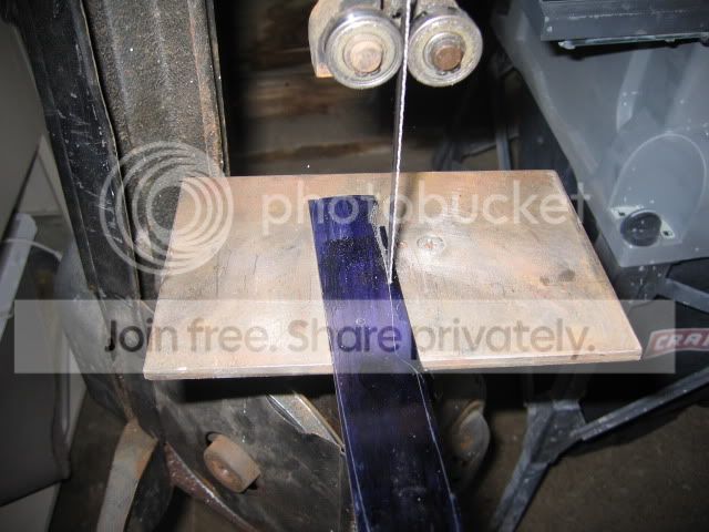

3.) The next step is to cut out the shape as good as I can on my metal cutting band saw. This can also be done on the grinder as you will see in the next step but using the band saw is much faster and saves on belts.

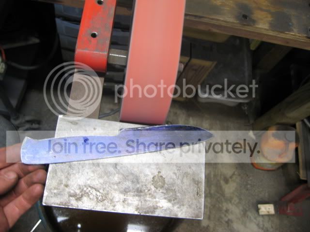

4.) Here I am using a 6” contact wheel on my KMG to grind off what I couldn’t get with the band saw.

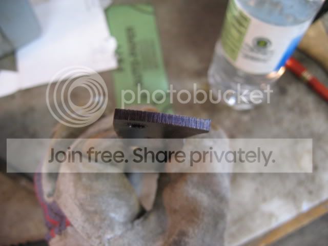

5.) Now that I have the shape I want I will double check to make sure the holes for my handle pins are perfectly centered. I picked up this particular caliper at Harbor Freight for $6 on sale and it’s been one of the best things I have ever bought. I use it almost every day I’m in my shop and after three years it’s still going strong. If you don’t have one of these I would strongly advise to get one. Even when they’re not on sale they are less than twenty bucks. All I am doing here is measuring how wide the handle is where I am going to drill a hole for the pin and dividing it in half to find the exact center. Once I find the center I will use the caliper to make a mark.

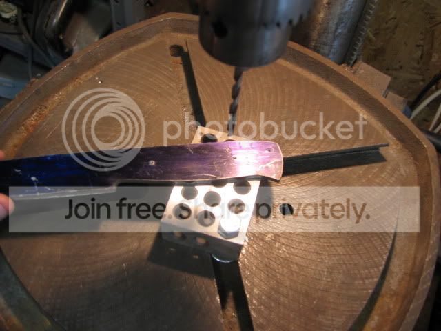

6.) After I scribe the center I use a center punch to make a small divot so that my drill bit won’t wander as I am drilling the hole. I am using a 1-2-3 block that is bolted to my drill press table so that I can drill on a perfectly flat surface and get the holes as straight as possible through the tang. A 1-2-3 block is a metal block with dimensions measuring one, two, and three inches long respectively. I don’t know what their exact use is but I have found various uses for them and they are inexpensive.

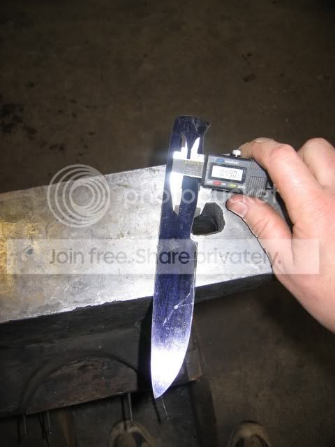

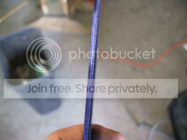

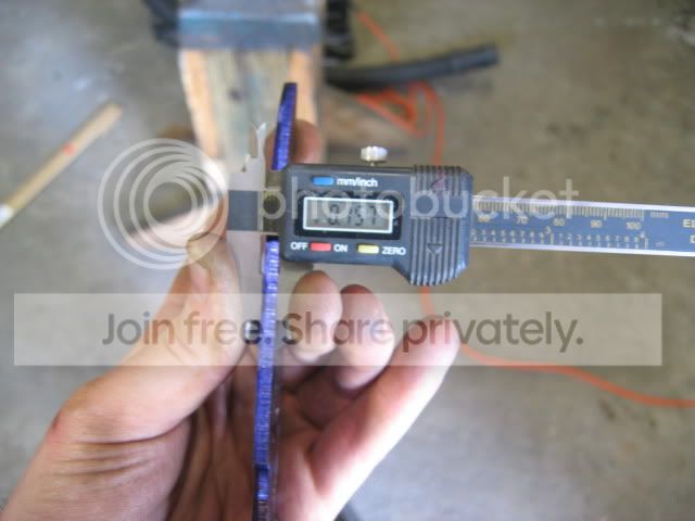

7.) Here I am measuring the thickness of my steel so I can scribe a center line for grinding. As you can see it is 0.157” thick. I divide this number to get the center and then subtract 0.015 from that number so that when I scribe I have two lines with .030 distance between them. So the equation I use is 0.157/2=0.78. Next I do 0.78-.015=0.765, this is the number I set my caliper to. The reason I do this is so that I have 0.030 distances between the lines. This is how thick I want my edge to be after I am done grinding.
8.) Here are the two lines I will use so I can make sure and grind evenly on each side.

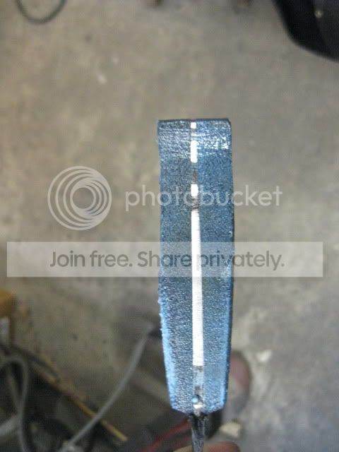

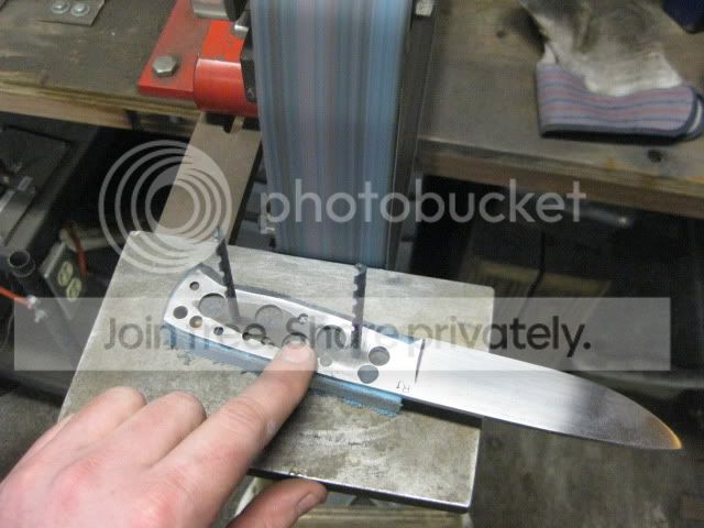

13.) Okay now on to tapering the tang. I will again scribe two lines similar to what I did when I ground the bevels in.
14.) Next with my contact wheel I will hollow grind out up to where I want the taper to start, I use my guide here again to keep everything straight.
15.) Here you can see where I have hollow ground one side out down to the scribed line. The reason for hollow grinding out before I actually taper the tang is simply to remove material, that way when I switch to the flat platen I am only grinding the sides as opposed to grinding the entire width of the tang.

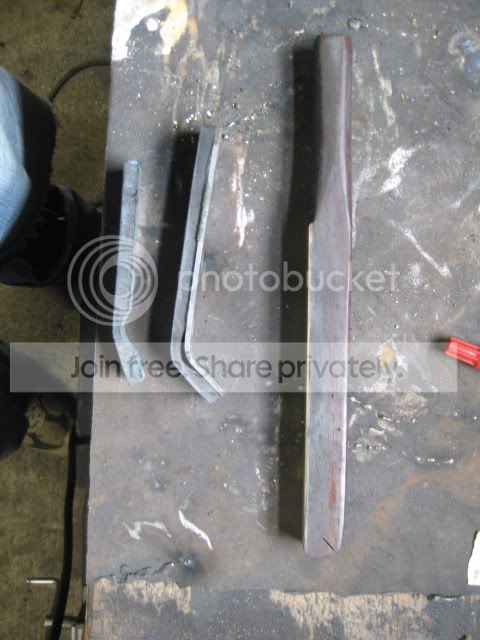

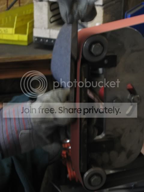

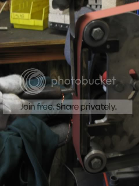

16.) So here I am actually tapering the tang. I do this with a 60 grit belt initially and then switch to a 120 grit disk to get every this perfectly flat. One this that I found really helps is the push stick I am using here. All that it is a piece of wood with a bolt glued in the end of it. I cut the head off and filed some grooves in it to give it grip. With this it allows me to put pressure on the very end of the tang while I hold onto the top of the blade above the platen.
17.) Some of these pictures are a little blurry so I apologize but here you can see what I have ground so far. I reapplied the bluing so I can see what I have ground off and what I have left to grind.
18.) Once I get tang pretty well tapered I use pressure from my thumb to do the last little bit. Since I am only removing a little bit of steel at the top as opposed to the bottom my thumb allows me to control the pressure better.

20.) A better shot of my push stick. After the blade and tang are ground out I move to my disc sander and a 120 grit disk. I finish out flattening out the tang and then move to the blade bevels. I don’t have a picture of this but the disc sander really allows you to work in you plunge cuts. I

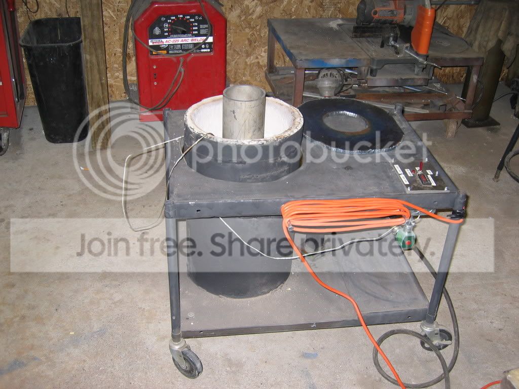

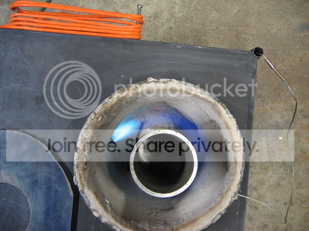

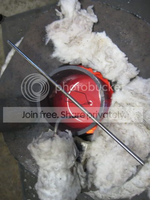

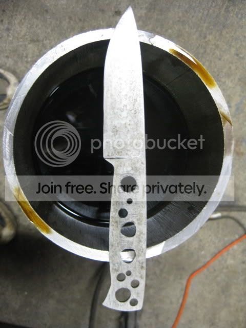

21.) Once I am done there I heat treat the knife using my salt pot. It's homemade and runs off propane. I set my controller to 1475 degrees and it takes about an hour to get to stabilize at that temperature. Once the temperature has stabilized I suspend the blade in the bath by a stainless steel wire for twenty minutes.
22.) Here is a picture of me moving the blade from the salts to the quench tank.
A shot of the blade after it has cooled down and just before it gets tempered.

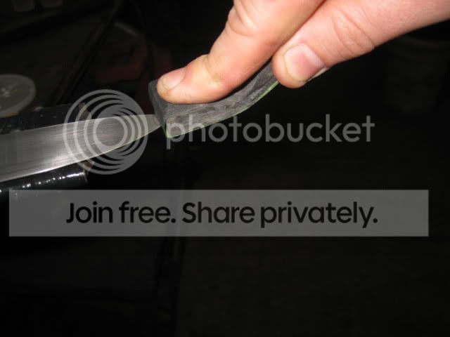

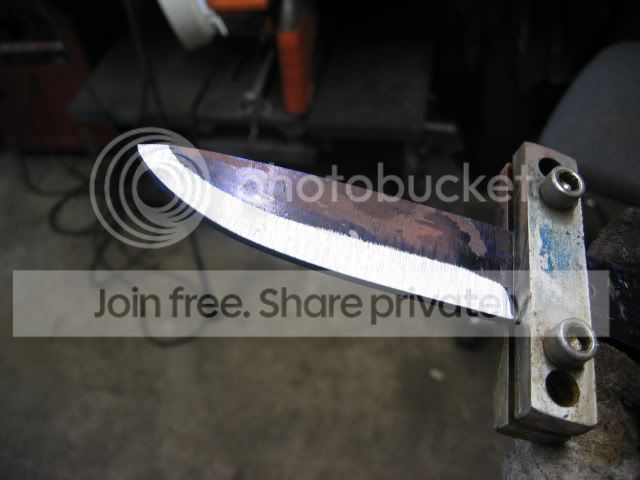

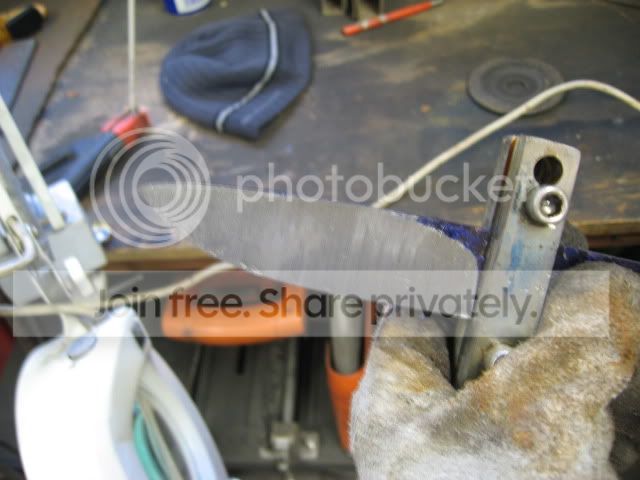

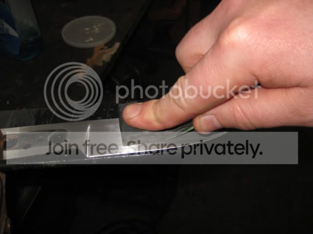

24.) After the blade is tempered it is time to hand sand it. Sometimes I will use my disc sander if there are any deeper scratches but usually I just start with one of the sanding sticks here. I always start with 220 grit. The most important thing to remember is to get ALL the scratches out from the previous grit. You can achieve this any number of ways such as sanding in different directions at each grit or looking over the blade carefully with some kind of magnifying glass. When I first start out at 220 grit this is where I "erase" any other scratches and make all the scratch lines go the same way. I liken this to starting a painting on a blank canvas as opposed to starting it on a canvass with a bunch of other paint marks on it. If you don’t get all the scratches out at 220 grit you'll never be able to get them out at the higher grits. I've found that 220 grit is really the last grit where you will be able to remove any significant amount of metal, the rest of the grits are just to get scratches smaller.

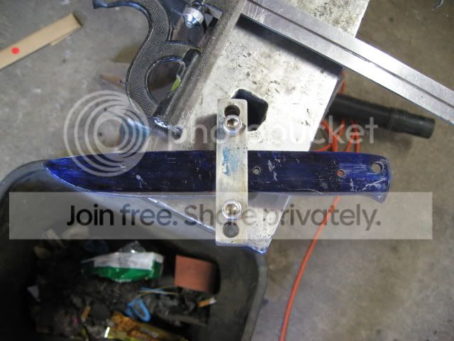

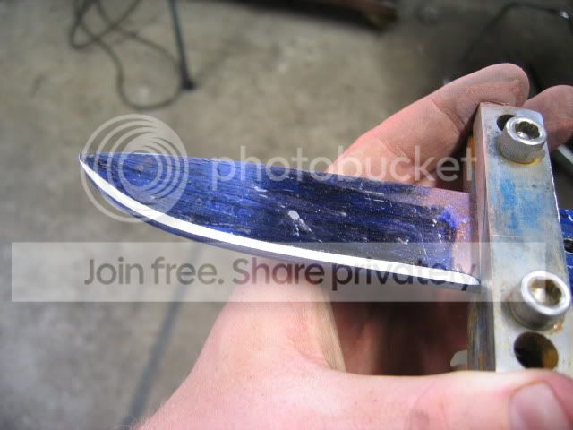

Here the rig I use to clamp my blade for hand sanding. I wrap the piece of steel in electrical tape to protect the blade surface from getting scratched. I also make a few extra wraps to support the tip of the blade since it is tapered.
26.) Here is a series to demonstrate how I will do the final strokes at whatever grit I end up with. I start at a point that will be covered up by the scales and in one motion “wipe” the sandpaper off the end of the tip. If stop and start you risk getting the J-hooks that you sometimes see.

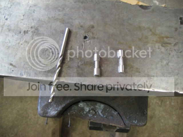

28.) These are the corby rivets that I will be using. At the beginning of remember I had drilled the two rivet holes and the thong hole. The drill bit I used was 11/64” and the beads are ¼”.
...Here's the rig I use to clamp my blade for hand sanding. I wrap the piece of steel in electrical tape to protect the blade surface from getting scratched. I also make a few extra wraps to support the tip of the blade since it is tapered.
Why didn't I think of that?!? You sir, have invented the infinitely-variable proper-taper sanding stick! I love that idea and will try it out this very afternoon.

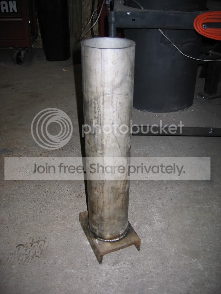

Rob, would you describe in more detail your "propane salt pot" method of heat treating? Thanks.
Thanks for the great tutorial. Can't wait to see the final product.:thumbup:

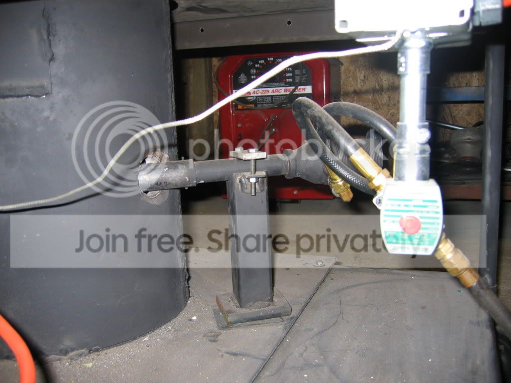

The salt pots that most knife makers use are simply a welded tube placed in the middle of a vertical forge. The tube is filled with special salts that are rated to whatever the temperature of the steel you are heat treating needs to be. The benefits of using salt is that it more evenly heats the blade, it heats the blade faster and since there is zero oxygen in the salt bath there is no scale to be ground off after the blade is heat treated. Basically the blade looks exactly the same after it is heat treated as when it went in the salt bath, this allows me to do more of the finishing of the blade when it is still annealed of soft. Here's a couple pics, most of the salt pots that I have seen all have the same basic setup.
The tube /"pot" it is stainless steel (304L), the bottom is a piece of stainless steel channel I had my friend weld on there.

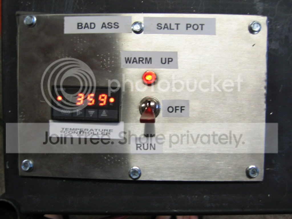

This is the burner and valve that controls the gas flow to the burner. The valve/solenoid (green, on the right side of the picture) is connected to the controller that is in the next pic.
Ignore the stupid labels, my brother thought it would be funny to use my wife's label maker to label all the tools in my shop "bad ass". The PID controller is what I can program the temperature I want into. I have a thermocouple that I can put into the salt once it is melts to monitor the temperature. Once the salt reaches the temperature I programmed into the controller it tells the gas solenoid to close by cutting off the electricity to it, this is why if your looking for a gas solenoid for a salt pot you need it to be normally closed. Once the temperature drops below the temperature I want it sends electricity back the the solenoid and warms the salt back up. Since the temperature I use are way above the flash point of propane it will automatically reignite.
Let me know if you have anymore questions.

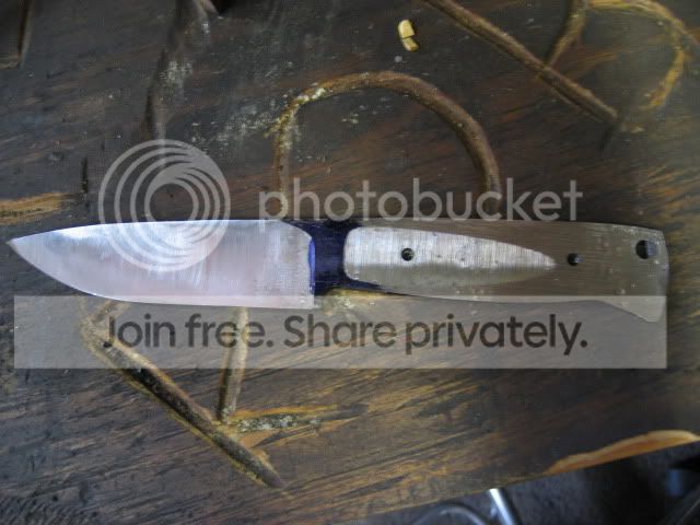

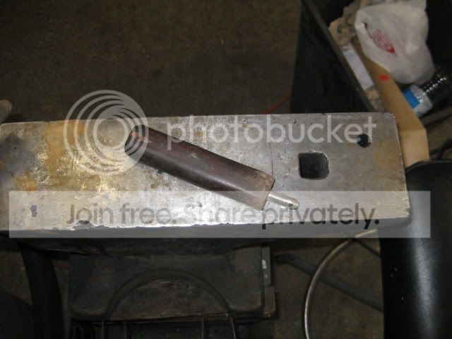

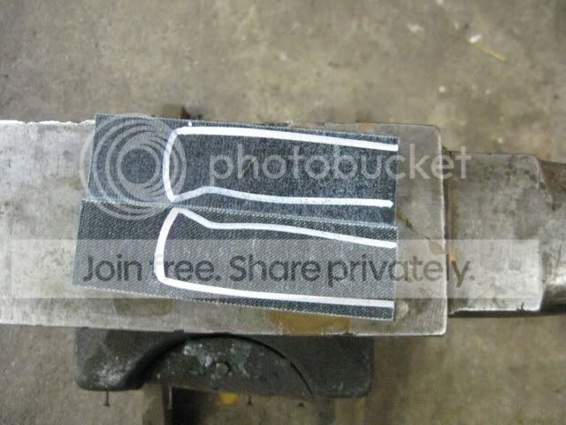

31.) Next I trace the rough outline of the handle on the scales I will be using. In this case I will be using scales I bought from Shadtree Composites at the Wolverine Knife Show in Novi, MI, the owner post on here under the username fod. These particular scales are made out of denim.

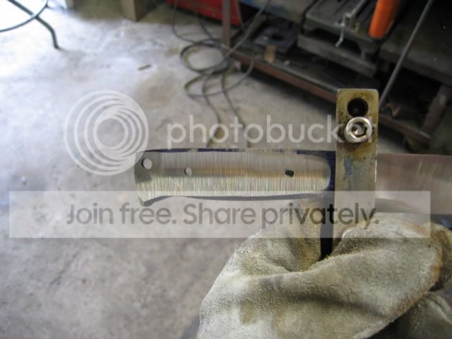

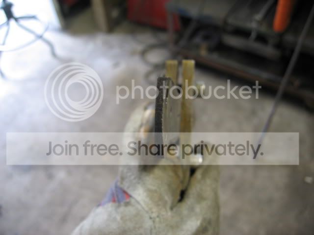

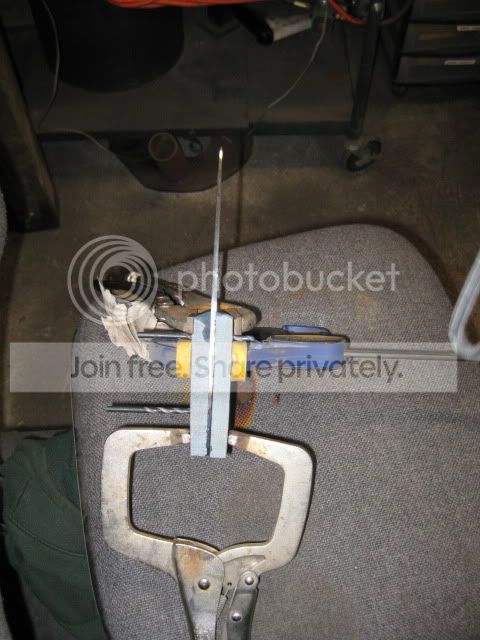

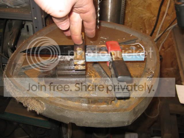

Here is the rig I use to drill the holes in the scale material. Since the tang is tapered I can’t set the scale down flat on the drill press table. I clamp the blade at the ricasso since it is perfectly flat, this keeps the tangs perfectly perpendicular to the drill press table and allows the drill to drill straight through the scale even though the scale is at an angle to the table.
34.) Next I use the flat platen to grind the scales closer to size so when I glue them up I will have less work to do.

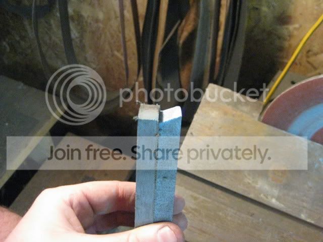

35.) The next step is to grind a bevel where the front of the handle will be.

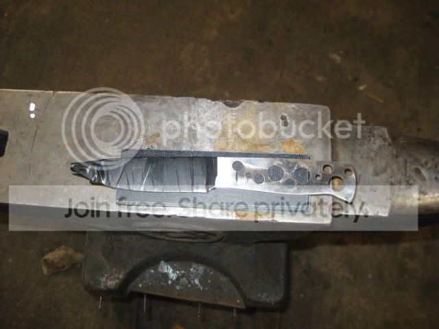

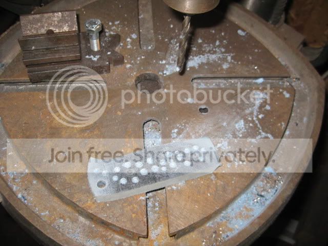

In preparation for gluing the scales to the tang I drill little holes to give the scale more surface area for the epoxy to stick to. One thing to be careful of here is to not drill too close to the edge otherwise they could show once you grind down to the tang.

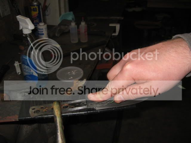

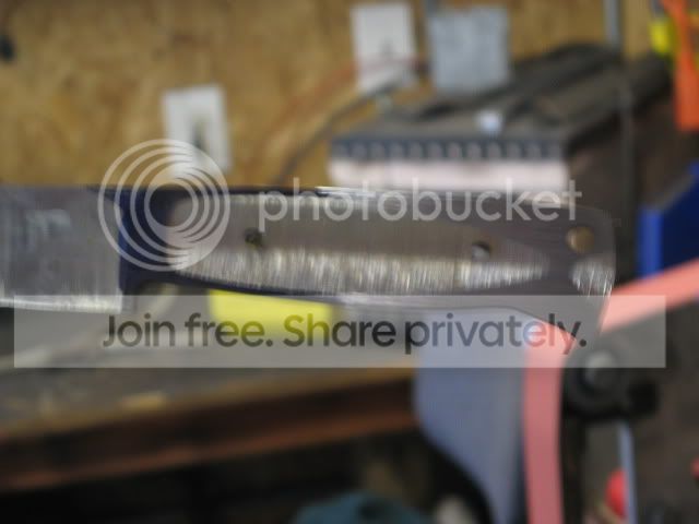

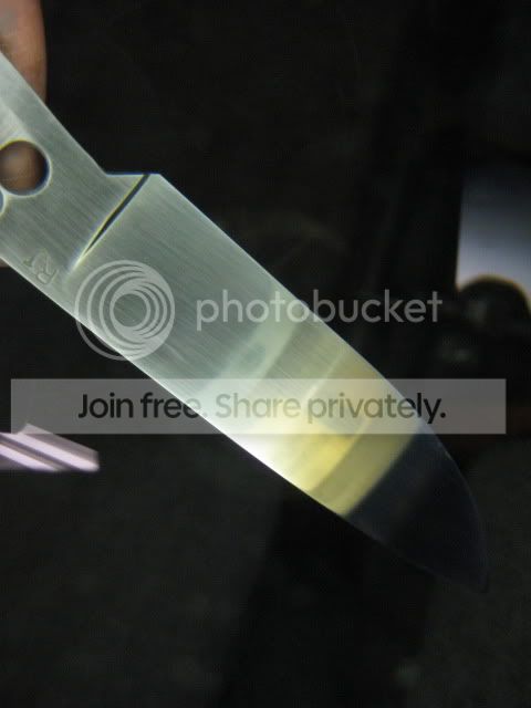

37.) Before I glue the scales to the tang I give the blade a good once over to make sure there aren’t any scratches, if there are they are a lot easier to get out before the handle is glued on. Here is a shot of the blade through a magnifying glass.

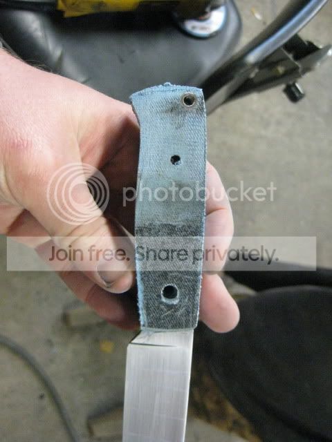

Here is the handle glued on. I use the drill bits again to make sure everything is lined up. I use superglue as the glue to hold them on, later I will put the rivets and thong tube in. If you ever do this make sure to coat the drill bits with a release agent so that the glue won’t stick to them, I use Vaseline.

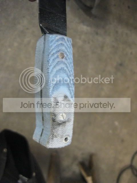

The next thing do is to drill out the rivet holes to ¼” so I can install the corby rivets.
40.) Now it is just a matter of sanding off everything to make it look like I want. I start at the front and grind it down to how I want it on both sides, using my contact wheel.
41.) Once the front is ground down I move to the back and start to grind in the palm swell. As I go I check to make sure that things stay relatively close on both sides, I’ve found that it’s easier to do a little a time on each side rather that finishing one side and trying to make the other match it.
Another great tip. Thanks!

I like the idea on the jig for drilling the scales, too.
Only thing I would add to that procedure is to add another layer of material to the bottom side of the scale so you don't get a break-out when the drill makes its way through the bottom side of the scale (the outside surface, actually).
