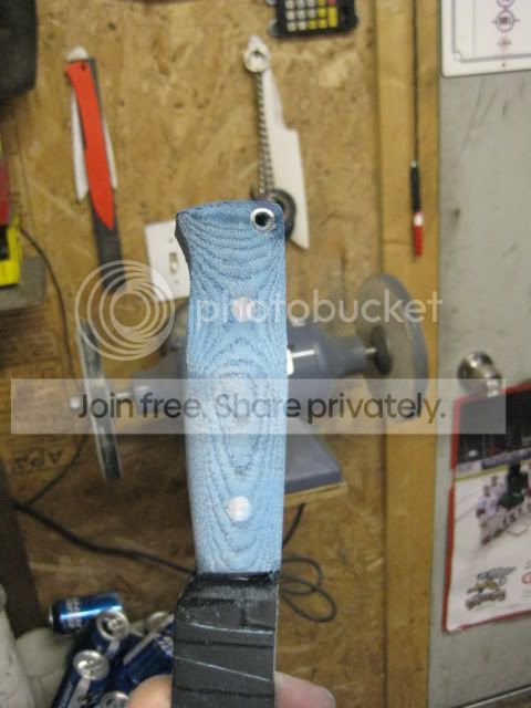

42.) Here is a shot of the handle after it is pretty much done. Next I’ll use files and sand paper to finish it.

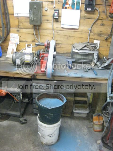

43.) One thing I noticed about grinding the denim was afterwords my shop looked like a smurf had been massacred.
