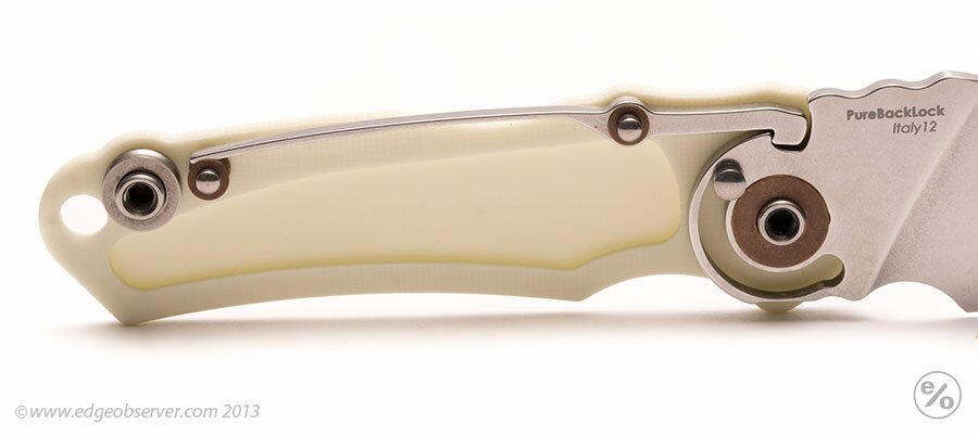

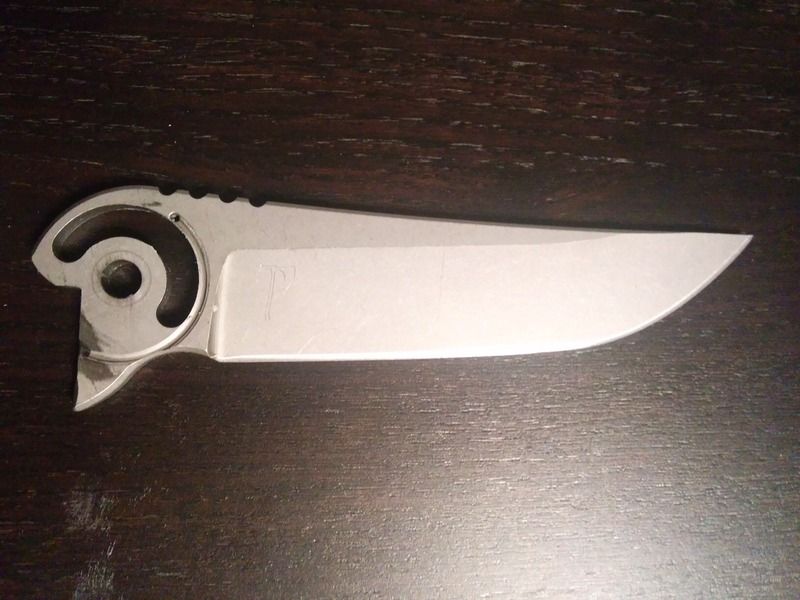

Hey everyone lets have a discussion about stop pins: External blade stops, conventional stop pin, internal stop pins et cetera. What are your thoughts?
My personal thoughts:
External blade stops- offers side to side stability for light prying, a smaller probability of denting due to two points of contact on the handle slabs (also assuming the contact points are hard enough to engage the stop pins), looks cool,more "hard use" in general.
Conventional stop pin- Tried and true, although the blade may slightly dent the contact surface of the pin in frequent hard flicking, causing later lockup.
Internal stop pin- Allows a sleeker design without obstruction. However the pivot area where the blade have been milled out for space for the stop pin just seems weak to me. So much material is removed. More for a light-medium use knife.
Do share your thoughts about the respective styles!
