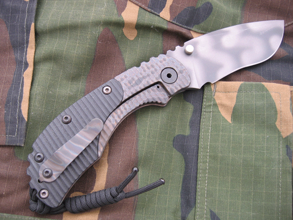

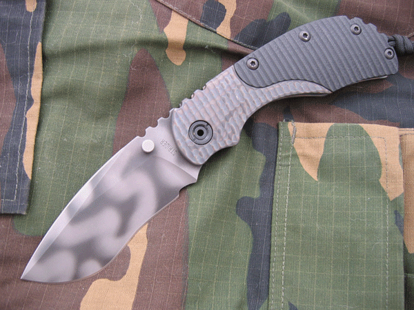

Got my Strider RC yesterday from Blue Line Gear and had some initial thoughts on it. First off though I'd just like to add that service from BLG was excellent as always. Anywho...
First thought on seeing it, wow this thing is huge. I also notice it has dings in the Ti finish because Strider ships them in ziplock bags instead of a decent pouch. It's irritating to know how much it cost only to be shipped with dings and crap on it because they don't want to put it in a decent bag.:( Took it out of the box and held it in my hand closed. It's not so comfy holding it like this since the back of the blade sticks out so far and digs into your fingers. Big deal I spose, I could live with that if it was the only problem. Next I notice the thumbstud isn't tight and wiggles/spins around which is irritating. Then I open it up and try to wiggle the blade. It wiggles up and down slightly because the lockbar is sliding on the tang a bit. It also has minimal side to side play. I figured I'd have to set the lock with a couple of snap openings like on my SMFs/SnGs but it seemed to make it worse.:(
What is rather odd to me was that the issues that were brought up, and defended as being correct, with the design of the SMF/SnG were different on the RC. Such as the lock mating wasn't the huge angle, it was fairly close to being a full contact lock, and the lanyard hole is now set so the blade doesn't cut it. Also the clip is a good eighth inch away from the scale. Just struck me as odd that they would change the things they defended as being correct. I'm not saying they aren't correct I'm just saying it's odd.
So... within 1 hour of getting it I sent the Striderguys an email telling them I'm sending it in for service. That sucks. To wait for a knife to get here to be consistently let down by the fit/finish. I say consistently because out of the 15 or so production folders I've ever gotten from Strider all but 2 had to go back when new to be adjusted. Maybe it's just my luck but I doubt it. And before everyone chimes in about how great theirs are I would ask if they are customs as I've had very few problems with them.
Overall I'm disappointed with the RC's quality and feel that it shouldn't have left the shop in that condition. Especially at that price point. This will be my last Strider. BUT... I am keeping most of the rest of mine because after they are fixed when new they are a good knife but if they don't care enough to do some minimal QC then I don't care enough to waste any more time/money with them.
And this wasn't meant as a flame fest this was meant to express my continued disappointment with issues that are so easy to fix they shouldn't be issues.

I do want to say something about a trend I'm seeing lately, not just with Strider but with other knives as well. Oily's pic above illustrates my issue perfectly.
My issue is this, observe how the tang of the blade is ground above. The first part is very flat, then the angle increases VERY sharply. IMO, what's happening is makers are throwing the precision needed to get good lock fit out the window. The first part of the tang lets the lock bar slide over, but the remaining angle is too steep to take up blade play. The result is the lock has play and slips even though it covers the first part of the tang, but it can never wear enough to match the angle on the other part of the tang. So basically you stuck with a crappy lock.
IMO it's a shortcut that ultimatly fails, but taken because the makers don't want to take the time to do it right.
It looks problematic to me as well, it appears to only match on the far right of the liner as well and assuming it has the only front mating that Strider promotes as optimal, this is a extremely focused point load.
-Cliff
