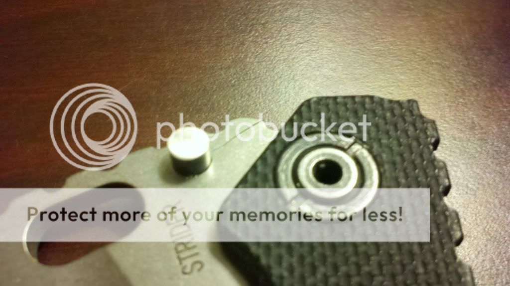

The same thing happened to my SnG:
I was told that this is caused by the stress on the metal from pressure putting in the pin. They'll get it fixed, but be prepared for a bit of a wait. Alot of people have been able to get their knives fixed pretty quickly, but they must be busy right now or something because mine is going on 2 months in the shop.

Exactly -- their approach to warranty/repair issues is "just send it in", with an email being the best way to contact them if you need to. Send your knife in, and it will be fixed. It may take a little while simply because with an issue like this the only real option is to replace the entire blade.
As for the crack, that's just something that happens occasionally with studs that are press-fitted (a hole or stud that's a tiny bit too small/big), not something that's specific to the way the knife was used or the brand; there are plenty of threads about it happening with ZTs and other knives that press-fit their studs
