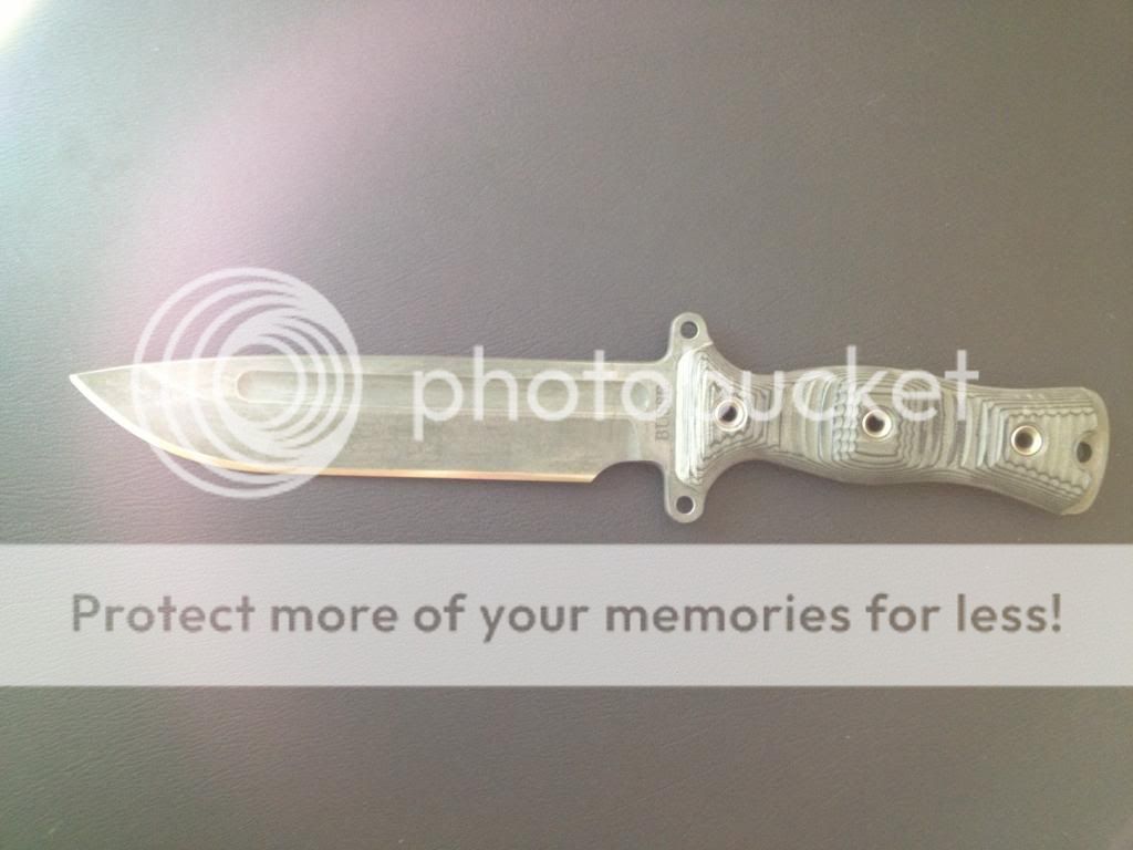

Stripped INFI
Dang that sucks..yeah you gotta etch them before. I'm sure you can send them back in and have the logo put back on for next to nothing.
I emailed the Swamp. They would only put the logo back on if I had both knifes refurbished for $55 total. I understand that they're a business with bills to pay, so no hard feelings, just a lesson learned. Bussekin knives are really great blades and I have nothing bad to say about them. My RMD and RS are users, and I like them much more naked. I'll miss the logo, but not $55 worth of miss.

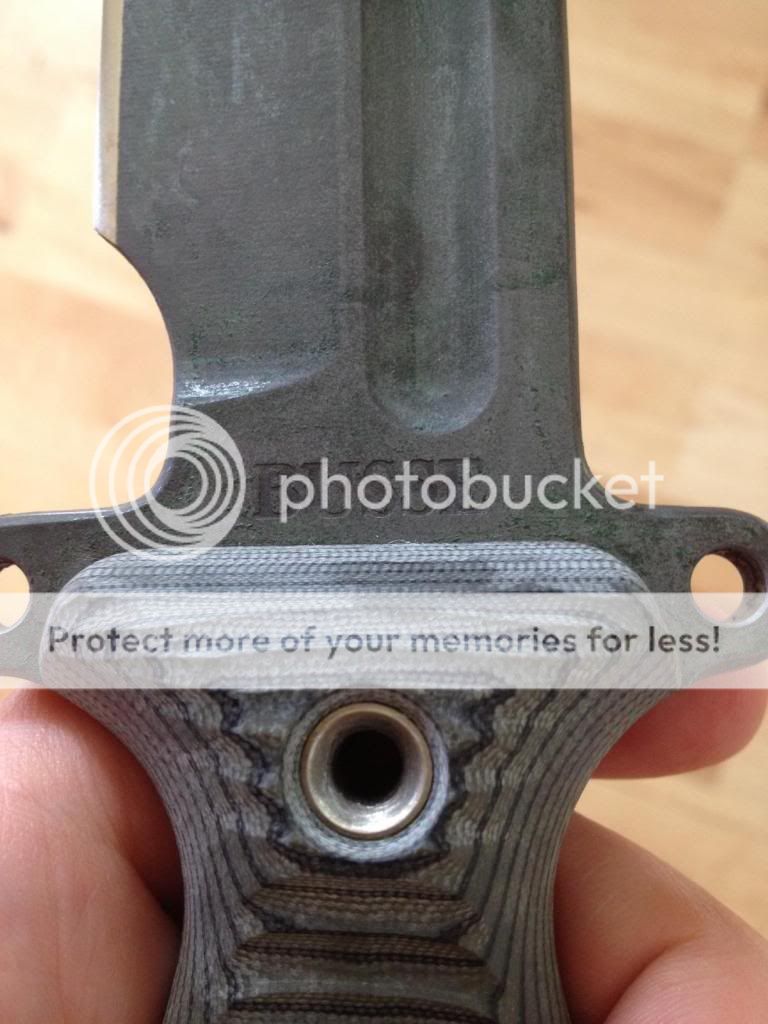

I use masking tape to build a small trough around the logo, fill it with etchant and let it sit overnight. :thumbup:
I found that the grooves in the crinkle coats allowed the etchant to flow under the tape and have got to the steel on thin paint spots on users or even made it to the blade edge.
I have just been applying small amounts to the logo with a q tip. Check it every couple hours, remove the old etchant and reapply fresh etchant.
The etchant won't effect the coating, only bare metal.

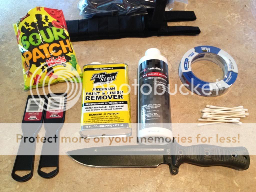

I did this last night and into this morning. I was never terribly crazy about the jungle green color (bought the knife second hand with the intention it being a user), and became even less pleased when any and all scratches appeared brighter green :barf:
Necessary equipment:
Turns out, the etchant has pretty good surface tension. I eventually removed the tape and just applied and re-applied the etchant with the aforementioned Q-tip. In between applications, I rubbed a wet Q-tip aggressively over the logo to remove the deposits, then left etchant on over night.

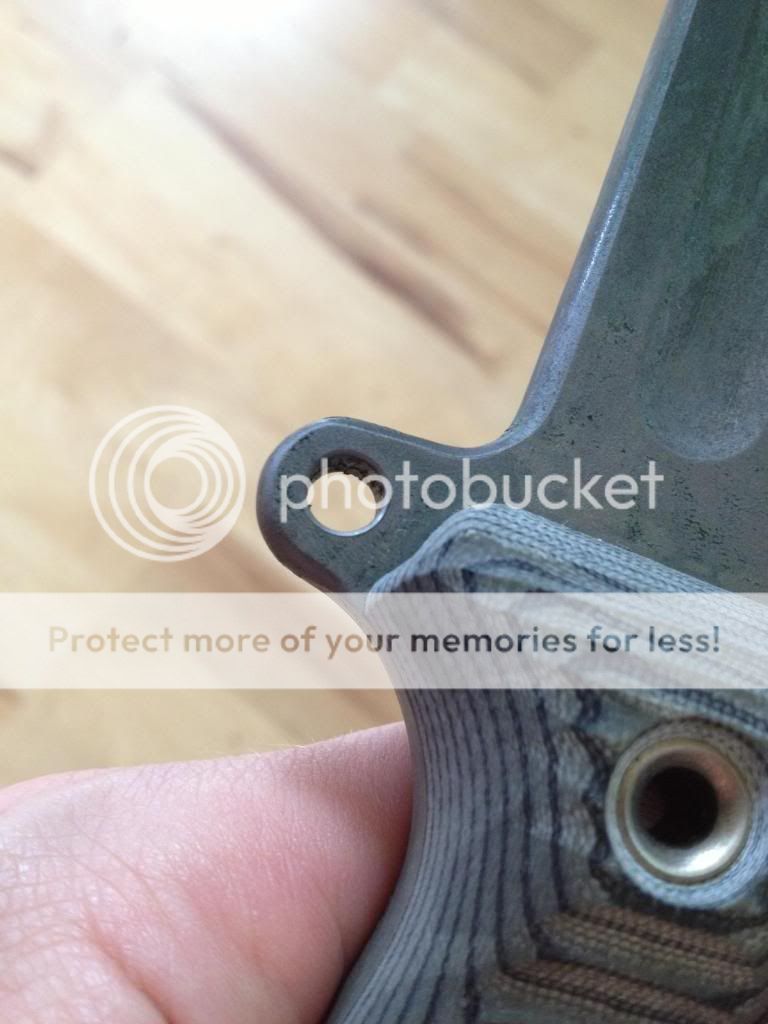

Once I began applying the Zip Strip, the first few layers of paint came off pretty easily. From there, things got tricky. After MANY applications/scrapings the paint reached a point where the Zip Strip was no longer making a difference. Luckily, the etching had taken well, but as you can see, there was still a good amount of paint left. For some reason, the lower part of the tang was REALLY holding onto the paint. I also recommend removing or taping the G10 grips, as mine were slightly discolored by the Zip Strip!
The holes (I'm sure they have a name) were a pain in the ass to deal with, and I eventually resorted to picking at the paint with a 1.5mm Allen wrench.
Ater many hours of picking and scraping, I used an old leather belt to rub Mother's Mag polish on the blade in an attempt to remove more paint. I got to a point when I kinda liked the look of the blade, so I stopped. I stropped the whole blade a few times and called it good. In a neat twist, the blade damn near matches the green/black G10 grips!

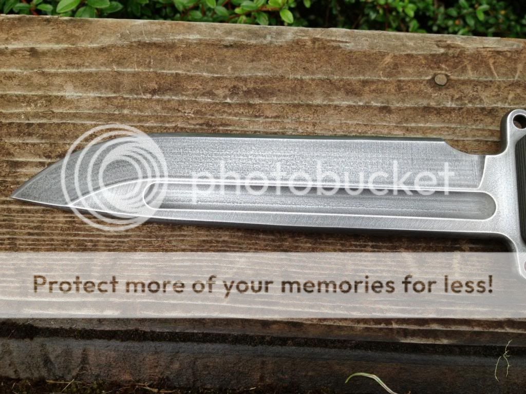

I decided to continue to remove the stuff that was adhered to the metal...
I bought a wire wheel for the grinder and it made short work of the leftovers! After cleaning it up with some 150 and 400 grit wet sanding, I am content with the finished product. It looks a lot like pewter.
Tooling marks! Looks amazing!
