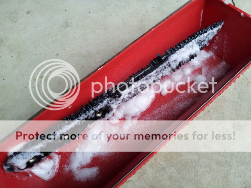

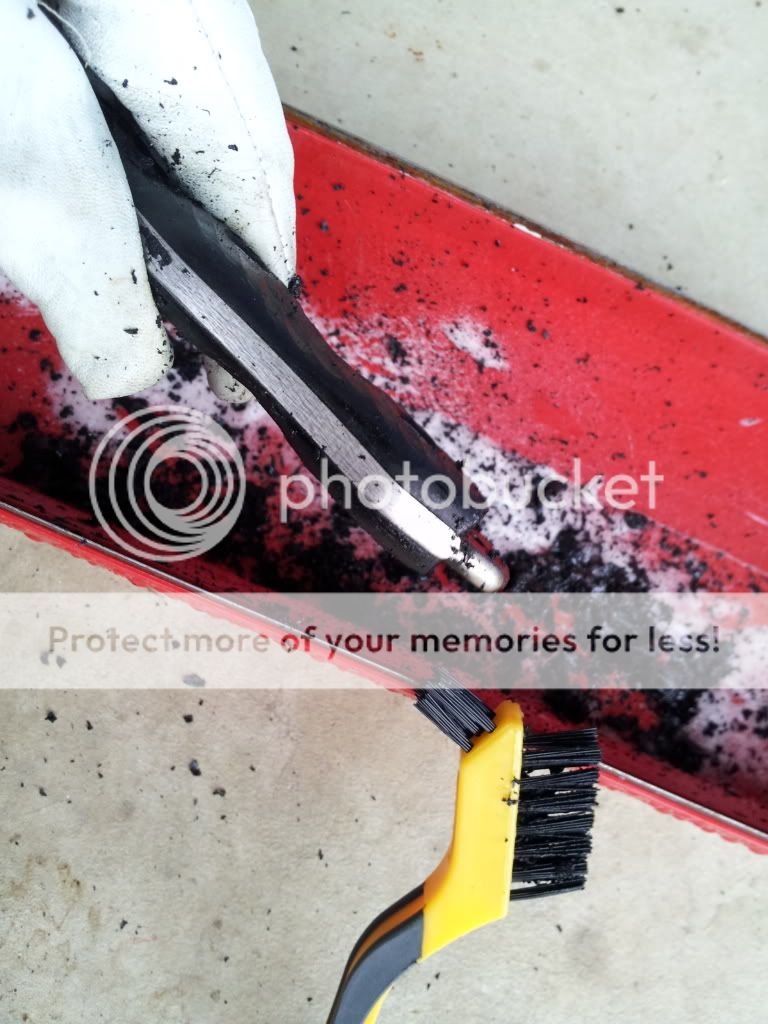

Stripped INFI
I decided to continue to remove the stuff that was adhered to the metal...

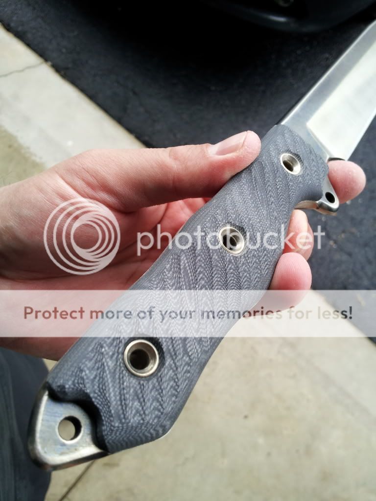

I bought a wire wheel for the grinder and it made short work of the leftovers! After cleaning it up with some 150 and 400 grit wet sanding, I am content with the finished product. It looks a lot like pewter.
Tooling marks! Looks amazing!
Wow! That looks awesome!
Thanks guys! I'll be giving it the beans later on today on the property. Trails need clearing!

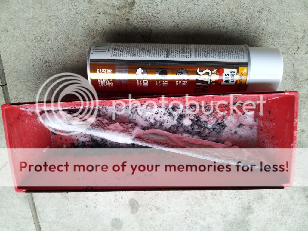

Thanks to Crouchingrooster I got a smoking hot deal on a DSSF! I decided I'd make a great Busse to practice my stipping. I used Klean Strip and a plastic bristle brush followed by a WD40/ Never Dull wipe down. It only took a few minutes to do and the infi underneath was awesome! Please note my scales did lighten up but, after the WD were back to normal.
