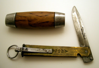

Ounce for ounce, I would think that the simple locking mechanism on a Swedish Barrel Knife would be closer to a fixed blade type of knife, the entire lock goes back into the handle basically making it as close to a full tang FB as you can get.
Can you imagine one of these made from titanium? :)
Sorry to say if I had a choice I'd pick a the barrel knife, I think your lock design is unusual, your take on a sturdy folding knife is interesting but needs a lot more refinement and you gotta drop the "...strong as a fixed blade" spin.
Have you ever looked at Barry Woods Swing lock mk2 knife if you want a knife that won't fold on your hand it's a great choice.
I wish you luck in your endeavor and have subscribed to this thread to follow along and see how this one goes. BTW, the pics are not mine, I had a Woods Swing lock and sold it, wish I never did and I've yet to get me a barrel knife, some day, some day :)

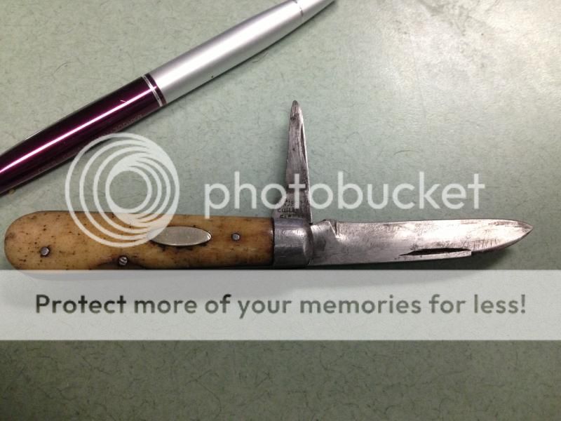

The company that made this knife went out of business in 1923. It has outlast one or 2 owners without being broken. I continue to use it today and it works great. No overly complcate mechanisms, just a blade and a handle.
