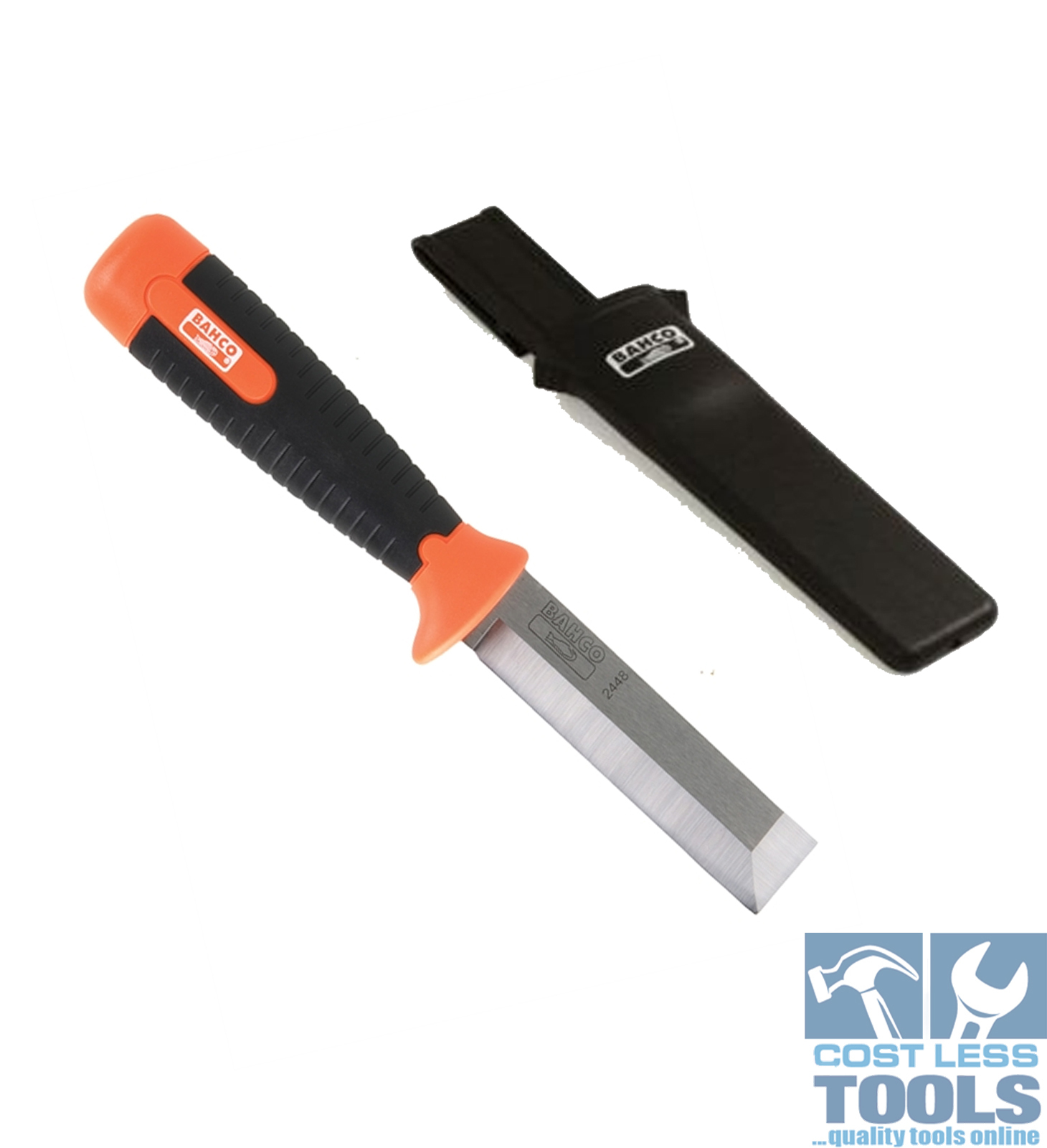

A ''wrecking knife'' might be a good idea, and seem to be fairly cheap for one made by Mora.
