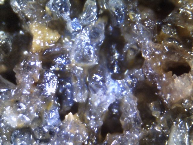

thats secondcrack's picture , from Re: India Stone - coarse which says
That's a picture of the approximately 30mls of grease that came out of my India stone, some grease was dissolved in the soapy water it was boiled in, I had removed some previously, and some still remains in the stone. I estimate there's around 50-60mls in each stone on average, but that estimate is very rough.
It's almost identical to petroleum jelly, but darker and more odorous. I find the stone better to use and less messy when using diluted cleaning solution (simple green, etc) rather than with oil, and having boiled it the cleaner works better than before.
If I was using oil I would not boil the stone, and even if using water it might be better to leave the grease in; I just was not prepared to put up with grease leaks and stains any longer. Working better with cleaning solution as a lubricant is a side benefit.
There are other interesting pics in there like this that shows the grease doesn't fill all the holes

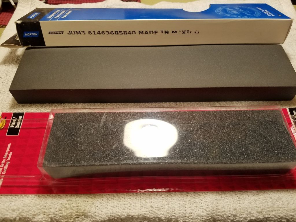

I found one of the hardware SiC, 2X8" stones today and purchased it. Pictured here beside my Norton JUM-3. Both have the coarse side up. I had a rewards card burning a hole in my pocket, with that brought it under a sawbuck. It's coarse side looks much darker than the JUM-3. DM
I did some reprofiling with the hardware SiC stone and it eats tough steels like 440C. It took maybe 10-15 mins. to take down the edge shoulder and remove metal about a 1/4" higher. I was surprise. It does much better than the JUM-3 (Norton's 100 grit). I'll be using it more in this application. DM
The ACE hardware stone is aluminum oxide per the ACE hardware website.
That's pretty much exactly what my stone looks like. Except mine is a 6x2x1 and the fine side is a grey color. Not sure if it's alumaoxide or sic but it really did help me get the cases done fast. I think I'll still purchase a Norton crystalon just for the piece of mind that it is sic. I also applied some Vasaline to mine and hit with a hair dryer fast and the keep honing oil on the stone for a long time
