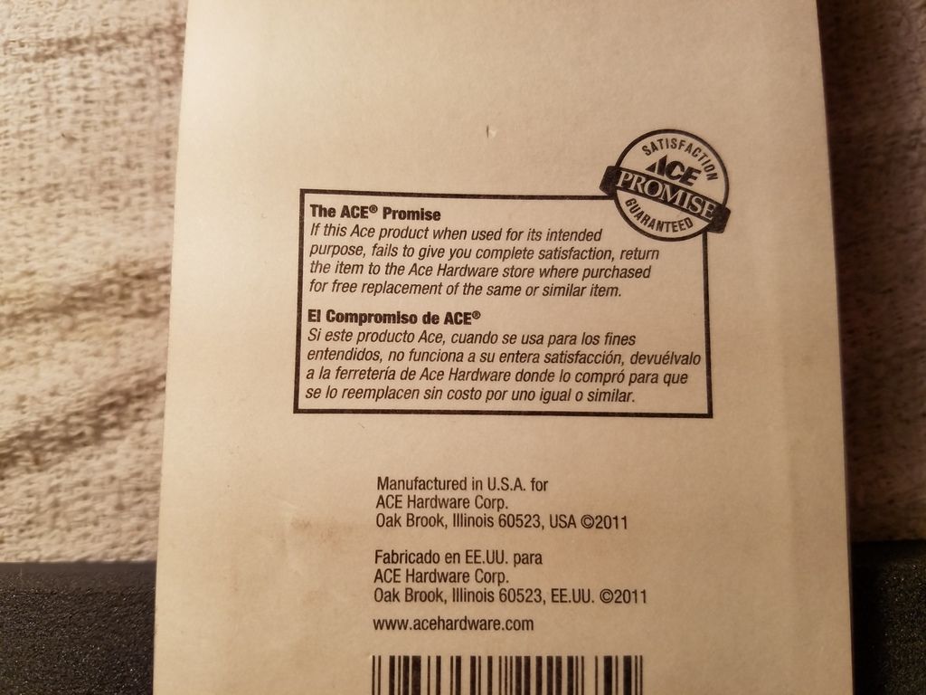

I've been using Go-Jo with good results and clean up is a snap. Just wipe it with a cloth. On the back of my box it says made in the U.S.. DM
