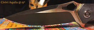

Can you take me through your sharpening process please? I’m curious how you get such great edges.I don't do a ton of mirrored edges any more, just one here or there. But recently I had 3 to knock out, here is one of them!
Mostly it's just taking a lot of time and being methodical, there are multiple approaches to getting a super polished edges as demonstrated by others above. I use lapping film down to 3um, then strops to .25um, alternating directions to make sure the prior scratches are completely gone =)Can you take me through your sharpening process please? I’m curious how you get such great edges.
