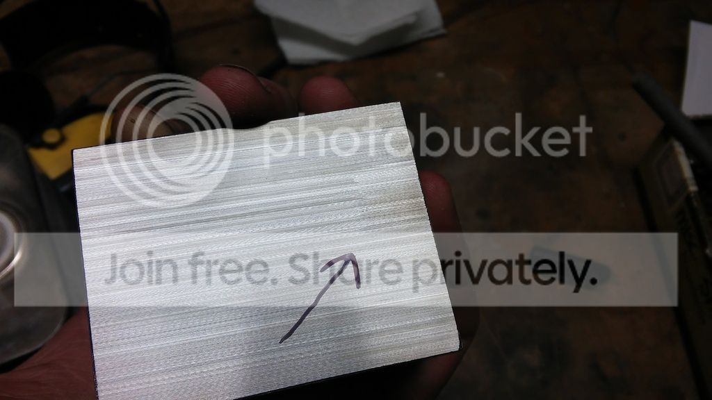

Here, you can see a light variation in the finish. I'm not entirely sure what this is from...

For the finish I got in the pictures, I used an A60 stone- about 1/2" thick- And dressed it prior to doing a roughing pass. When I got a consistent cut all around the piece, I dressed it again and proceed to take a series of very light passes. I'm not entirely sure how deep the finishing passes were, but they must have been a thousandth or less. The VFD is set to 60 Hz, the maximum frequency and I believe that is running at3450 rpm if I'm reading the data plate on the motor correctly.
So all in all, the electrical issue of not being able to turn the freaking thing on is resolved, but I'm still figuring out how to get a consistent finish all around. Any advice on how to get more consistant finishes would be greatly appreciated, as well as critiquues to my "process" as it is.

You didn't start your grind in the middle of the block .001 deep did you? You start with the wheel off of the block, get the table oscillating back and forth, then crossfeed into the block a short distance for each table oscillation, or with a very slow continuous cross feed.
You said you dressed the wheel, how much did you take off the wheel? How fast did you travel the crossfeed during the dress?
Your grinding finish appears to me that the wheel was a little loaded and getting hot in the grind, with too much cross feed per pass. If you were oscillating the table in one direction and then the other without cross feeding in for each movement, and you got that much spark and sound in both directions, that's evidence it's not cutting completely and is actually pushing the grinding wheel up slightly.
I started off with the wheel to the right of the block, but not touching. for the first pass, I had the entire wheel in contact with the block with the exception of maybe a 1/16th overhang-maybe less. I fed it into the block at a consistent speed (moving left), then backed out (to the right) without moving the crossfeed. In other words, I let the wheel go over the block twice for every movement of the crossfeed.
When I dressed the wheel, I must have taken off 1/32 or so off. I moved the diamond really close to the wheel, moved the crossfeed forward and back, and repeated until I made contact with the wheel. I did this until I could feel and hear the diamond remove material the whole way through. It is dificult to regulate the amount being removed because the wheel for the x-axis is very touchy and very little movement of the wheel will result in a fairly large movement of the table. In retrospect, I probably could have just used the z- axis adjustment to really fine tune it. When I moved the crossfeed, I tried to take it slow and steady, though my definition of slow may differ from yours... I did notice there seemed to always be three peaks on the wheel after dressing. I can't recall it being noticeable on the wheel itself, but it did leave a pattern on the block in the first few passes. It evened out after the first few passes.
On my finishing passes, I believe you are hitting the nail on the head with having to much crossfeed per pass. When I was first trying this out, I was advancing the crossfeed about 1/16" each pass, but on these finish passes, I believe I went almost the full width of the wheel (1/2"). That may be contributing factor #1. When you say "If you were oscillating the table in one direction and then the other without cross feeding in for each movement", I'm assuming you mean I should have been advancing the crossfeed on the return pass as well? So for every movement on the x- axis, I advance the crossfeed?

Let's call the table oscillation "X" axis and crossfeed "y."
To dress the wheel, the dresser should be secured to the magnet and then indexed via the X until it's under the wheel to the left of center. This way if something happens it will be pushed into free space by the wheel and not pulled under, which could result in an exploding wheel.
With the X in this position, it should be locked. Lock handles are in different locations on different machines.
Then position the Y so the dresser is directly under the wheel and like you said feed into it with Z slowly until you hear it tough off.
Now move the Y so the wheel won't touch the dresser and then feed Z down .001 to .002". Feed Y one pass across the wheel. Do Z again and repeat.
Note the surface of the wheel before and after your first dressing pass. Regardless of the color of the wheel, properly dressed portions of the surface will be lighter in color than undressed. You're done dressing when that color is uniform across the face.
I'm concerned a little about the numbers you throw out there. Talking about a 1/32 of an inch in regard to surface grinding is off like if you were to say you adjust the tool arm of your 2x72 in feet.
Don't put yourself left of center in regard to the wheel. Dresser should be left of center. Engage the work piece with the X axis in motion. Carefully note how far you're setting Z moves. Dress at most .005 at a pass and that's a heavy dressing pass. It's hard to say how much Z to feed first a grinding pass without knowing the setup a little better but without coolant you will likely be limited to .001 or so. After each X move index the Y .030 to start and raise or lower that value based on how it's cutting.
If I have time on Friday I will make a surface grinding how to video so you can get a visual for speeds and what I described here.
That's gold right there! Yeah man, you gotta start thinking in "thou" when you own a surface grinder, if not before... 1/32 being around 30 thou, that's a HUGE amount in surface grinding for a single pass or even a few passes with a stone!
I took maybe 1/32" off the wheel, not the block. I think I would have stalled the motor had I tried that! I think I was taking off a half a thousandths each pass.

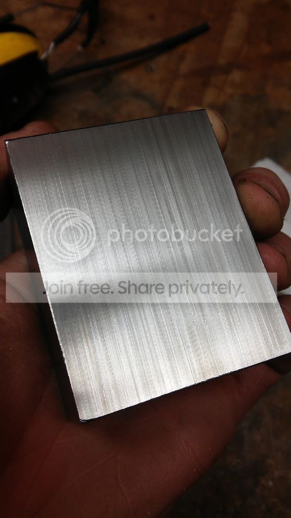

I didn't get much time to screw around in the shop last night because of homework, but I did sneak out there long enough to try it out with slower feed rates, smaller depth of cuts, and only advancing the crossfeed .05 every pass. I still have those small ridges you can see in the other picture, but they are much more uniform and they appear to be finer. Ialso tried using the Z-Axis to dress the wheel and it worked much better.
As I recently experienced myself with a contact wheel and abrasive belts, you do want to wait until the machine has warmed up before you dress your stone. I know there are a couple of different ways to dress a stone as well, from a "fine" dress, to a quick and "rough" dress. A little bit of coolant may also make a difference, as may a different type of stone. There are about as types of stones as there are materials to cut with them, and they each behave in their own way I suppose. That's part of the reason I went to belts. Takes just a small amount of the guess work out.
Lastly, if you want to see your best finish, you probably want to try sparking out on the piece, or IOW, stop moving the grinding wheel down, but keep going over the piece until there aren't anymore sparks coming off the work.
