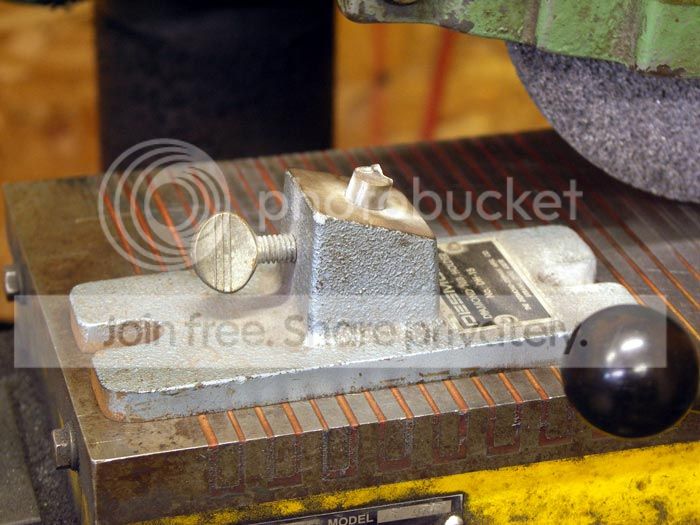

Patrice, you only need a "Single Point Diamond Dresser" or "Phono Point Diamond Dresser" ($10-$30 USD) and something to mount it in.
For single point dressing, you orient the diamond at 90deg vertical under the wheel and down-feed, then cross.
I made my "fixture" out of single point dresser and a piece of 1x4x4" scrap, with a hole drilled vertically through the center of the cross-section. The diameter of the dressers is usually 3/8" and tapered. All you have to do is drill a 3/8" hole in something steel and big enough for the mag chuck to hang onto.
Total cost of my square "Dresser" setup was $15. On top of that you can get radius dresser fixtures on ebay all the time for $100-$200.
Next, regarding your chuck, for accuracy, you need to "Grind in" your chuck to your spindle. Essentially, you need to surface grind your chuck, with the grinder. They're made for that.
There are a few methodologies for this, depending on whether or not you have flood/mist/etc coolant (I don't think you do), and which wheels you're using. You *need* to grind that in eventually if you want real accuracy, but you can probably start without it. You're likely better off not trying this procedure before you're comfortable using the feeds on your grinder, since one (literally) wrong turn can screw you up.
You grind the chuck with your machine's spindle so that it's parallel relative to your spindle and your table travel. When you clean up the table ways, you need to be careful not to use abrasives, as that can throw variance into the accuracy.. Clean precision surfaces *only* with #0000 steel wool and non-acid cleaners or solvents.

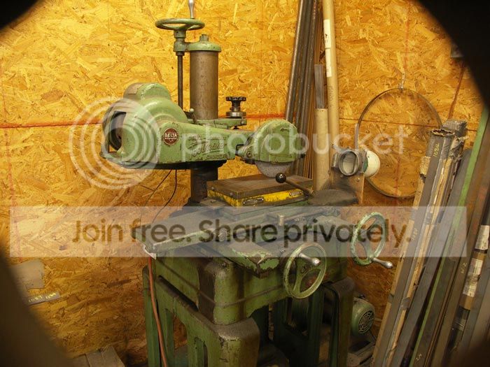

Here are some photos of mine and to answer a couple of your questions.
Less than $50 for diamond point dresser and holder.
1/2" x 7" x 1-1/4" wheel. You do not want or need a 1" wheel. You start at the edge of the piece you are grinding and work across it's surface. You are not going to run the full width of the wheel across the surface in a single pass, with stone or belt. Hope that makes sense.
You can switch back and forth from belts to stone wheel. But once you try a stone and learn how to use it, I doubt you will want to.;)
Also, if I were to set up a belt on one of these. I'd use a 1" wheel and split the belts. 2" is not what I'd use.

Some of ya'll may have noticed, I love heavy old cast equipment. That surface grinder is something special. I love it.
