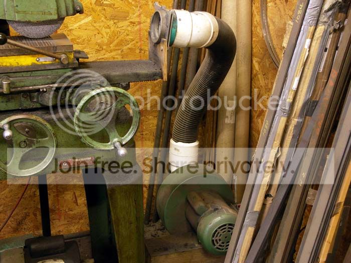

Here's a shot of the vac hooked to the surface grinder. Smallest Grizzly vac, with flex hose and 5" galvanized flue piped out the wall.

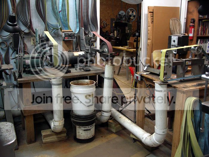

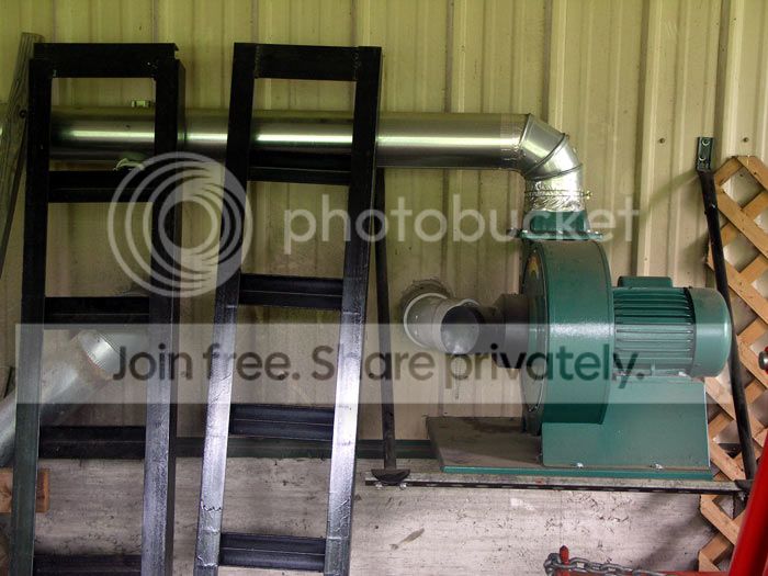

Then a shot of my grinders and the Big 2hp vac mounted outside.
Both are piped to the end of the shop and blow out in the grass.

As Corey said, I have a little...let's call it “cleanliness obsession” so the dust extractor is already being planned. Got the 5” piping, just need to build a collector for it that will catch as much as possible without getting in the way. I also blow the dust outside using a 1HP blower with gates on every collectors so I can have only one open at a time. Works pretty good, so much so that I had to put a grill at the KMG collector cause it kept pulling belts out of my hands when I was changing then and making confetti. ;)
