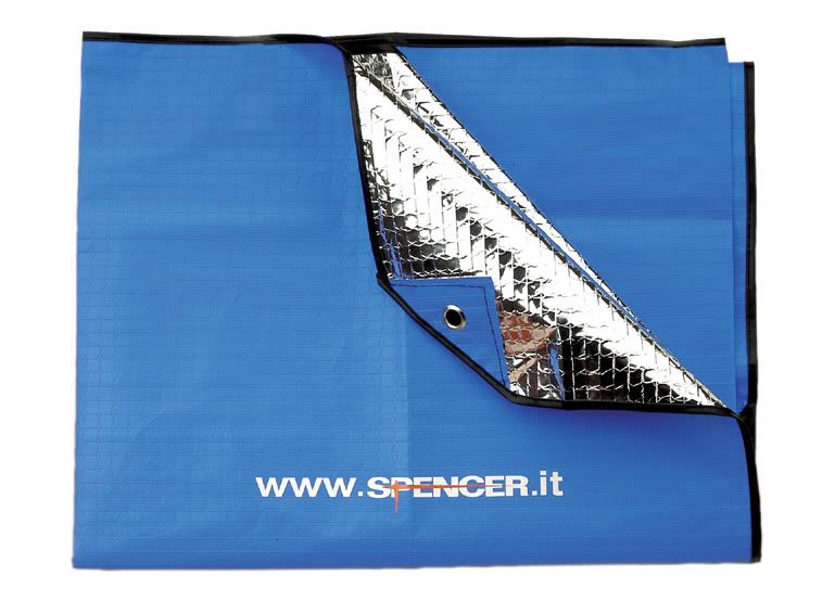

I've only tired one type of rescue sheet. Its made by Spencer Medical, an Italian company.
Made from aluminised polystyrene and measures 63x86" (120x220cm).
The good thing about this is that it isn't fragile at all. Definitely more solid that the one Ron Hood talks about 9 years earlier in this thread.
The material doesn't crush, crumble or tear like foil, but sort of springs back to shape. You can use it more than once.
They also make a larger, heavier, and more durable model that looks like a tarp.

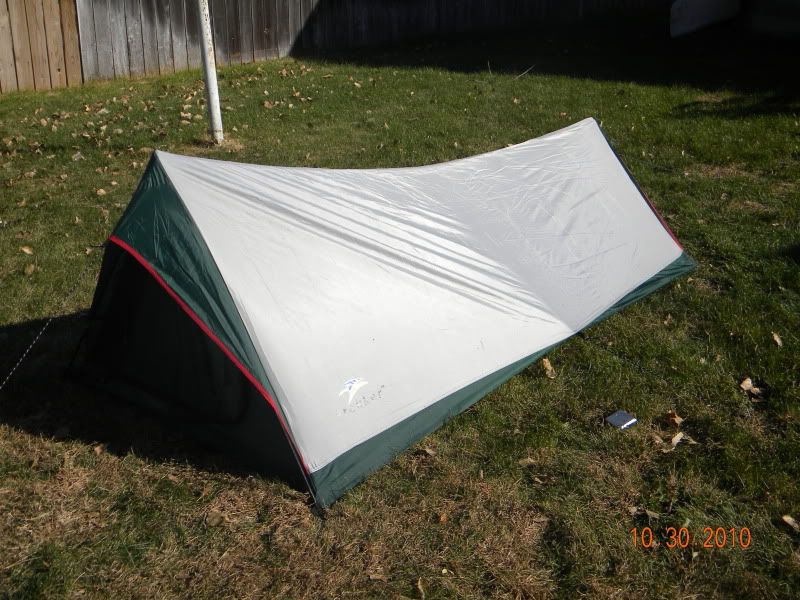

Heres a "experiment" I did a couple weeks ago with a Heat sheet as well as and GI issued blanket
I was reading about Mors Kochanski's Super Shelter last night and got to thinking.
I had just picked up this Trekker brand bivy tent at Goodwill, and thought can a the Super Shelter theory work with a normal tent.

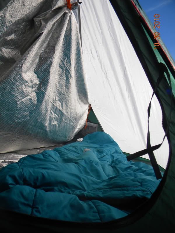

I set the tent up with one side facing south, as to be in the sun all day.
I then rigged up my thermal blanket from end to end across the ridge line fo the tent, using the attachment points already in the tent. I must say it was almost too easy to set up. I pulled it as taunt as possible and formed it to the shape of the north side of the tent, with the refective surface pointing South.

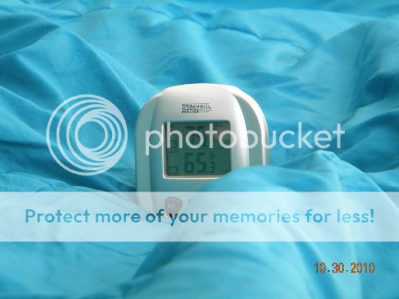

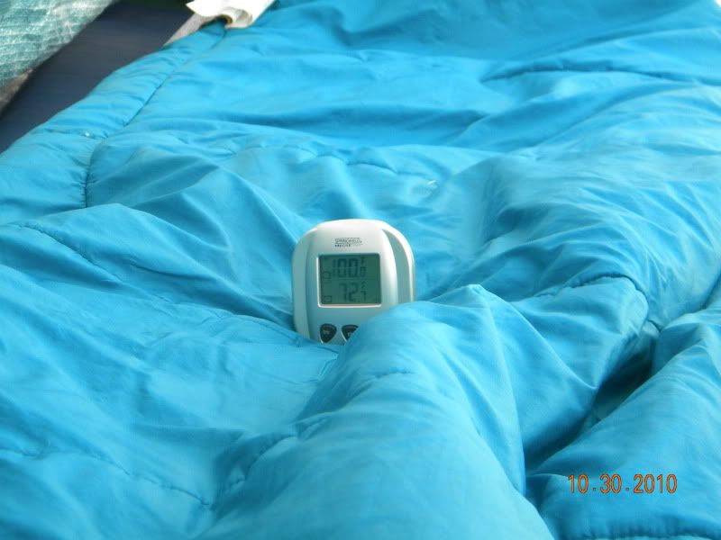

Placing my therarest pad and sleeping bag in the tent as if to warm it for a nights sleep. And then placed a indoor/outdoor temp gauge in the middle of the tent. Placing the other sensor just outside the tent, about a foot or so.
Then a minute later checked to see if there was difference in temp already,
10 minute mark:

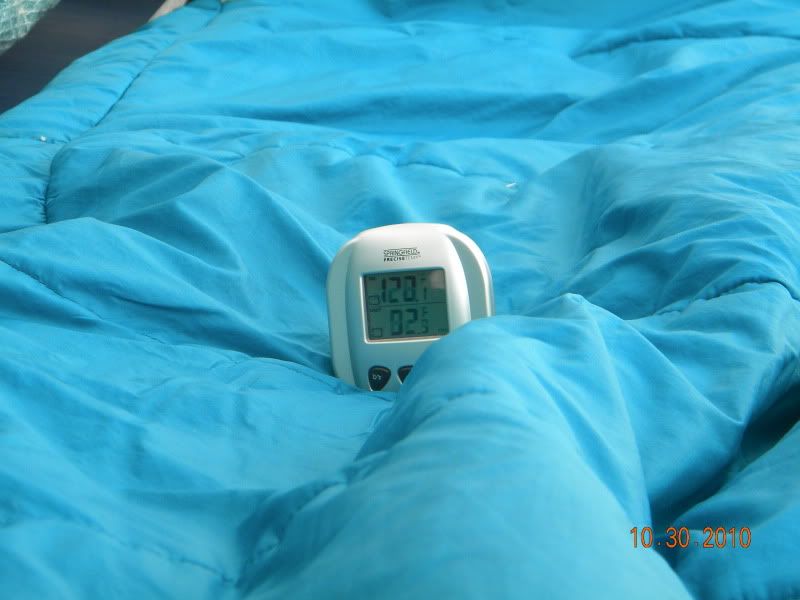

30 minute mark:

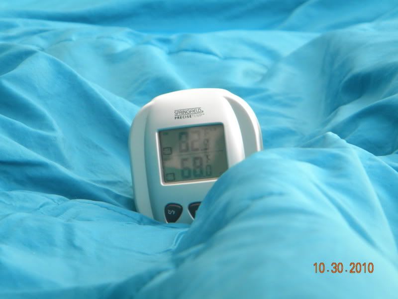

1 hour mark: Hard to read, but it says 128!! And the ouside says 82, I would think the tent is reflecting heat to it as well as outside temp is 68.
I would say its working quite well!!

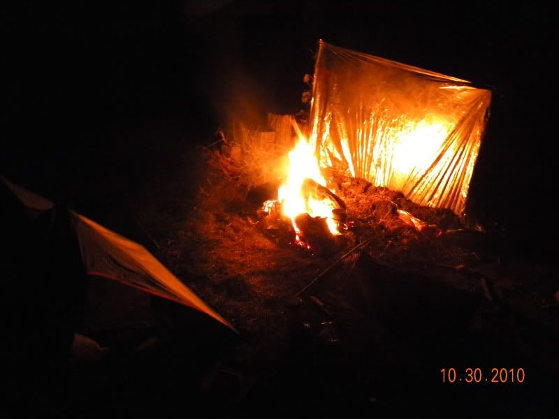

I ended up going with a fire, I set up another reflector on the otherside of the tent, this time using one of the heat sheet style blankets.
Got the fire going, and cooked up some bannock and tea! As to not waste a prefectly good fire!

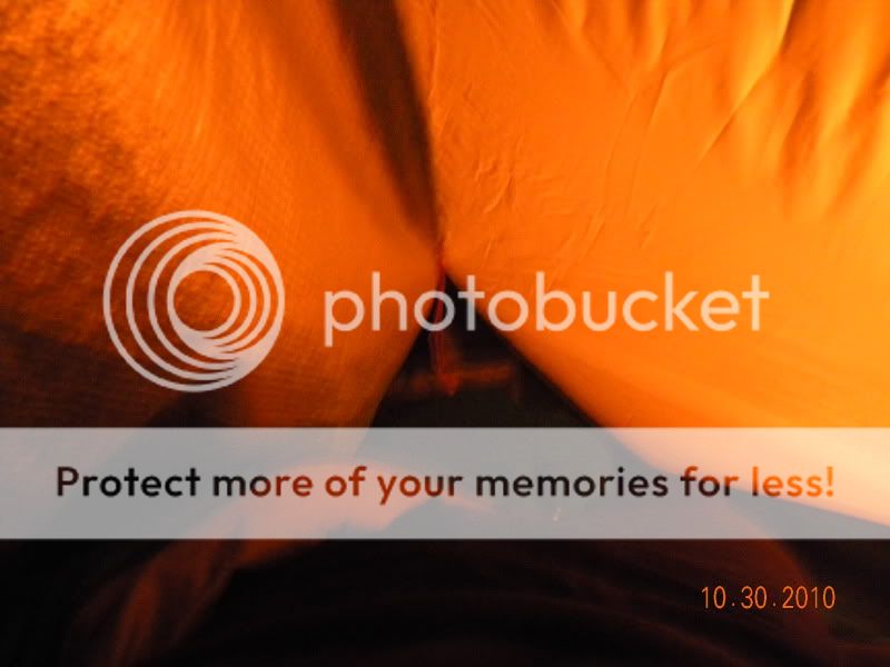

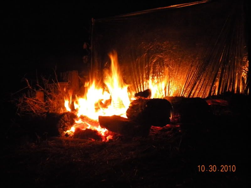

Here's a view from inside one looking down the tent as I lay in it, the other looking out the door at the fire.

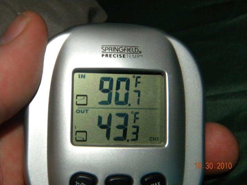

The warmest it ever got was 91,

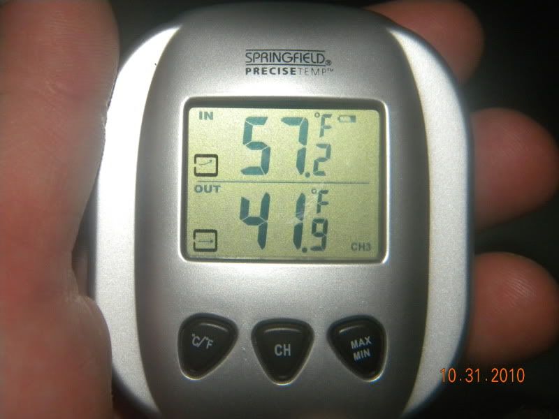

And the coldest was 57, after the fire died down.
When I got out of bed this morning it was 39 outside and still 57 in the tent, Not bad at all.

But I made sure it was dead calm night as I really didnt want to wake up with the tent on fire!!
Things I would do different, is ad a clear plastic piece between the tent and the fire, not only to help trap the heat but to act as a spark/ash guard for the tent.
