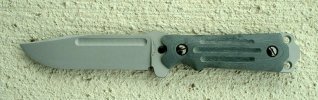

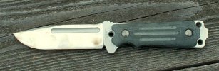

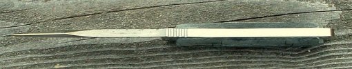

Hello all, Sorry for the long wait. Except for sharpening I finally finished this package.
Final spec's are;
Blade; 5" x 1/4" flat ground to a convexed edge D2. Blade has a 2 1/2 " fuller.
Heat treat; Rc 59-60 by Paul Bos
Blade finish; Bead blast
Handle material; Bead blasted and fluted black linen micarta with 2 1/2 " chicago screws.
Tang; 3, 1/4 inch lashing holes with glass breaker/ pry bar butt, jimped inclined thumb rampand and recessed index finger.
OAL; 10 1/2"
Sheath; Kydex with black nylon web and YKK quick release buckle.
Thanks for Looking

It is a fuller, it reduces weight and maintains strength.
Really nice looking knife. Won't the fuller just be somewhere else for dirt, blood, food to accumulate though and make it harder to keep clean?
Thanks, I don't think it would make it much harder to clean. Reguardless, you still clean your knife before you sheath it don't you. Although I have had fellas bring knives to me for sharpening before the season with last years blood, fat and hair still on the knife.
Apologies first of all, I'd only seen the earlier pics when I posted, my internet connection is playing up today (and senility doesn't help!) Again, really nice-looking knife. I always give my knife a wipe before re-sheathing and between tasks, but it IS harder to get the blade clean with a fuller, particularly in the dark. Just a thought anyway. Good luck with it, I'm sure it'll be very greatly appreciated and in demand.
