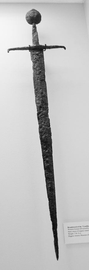

Just in case anybody is interested here is a museum specimen of a Castillion or 'Castellan' sword.... and is considered an Oakshotte Type VXa profile.

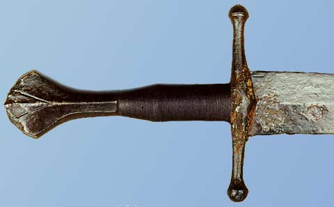

And here is the type of pommel I will be shooting for:
Here is another example from the 'Castillion Find'.. the archaeological collection that brought these swords to light. This one has the cross guard design that I like and that has been requested once again by the customer.

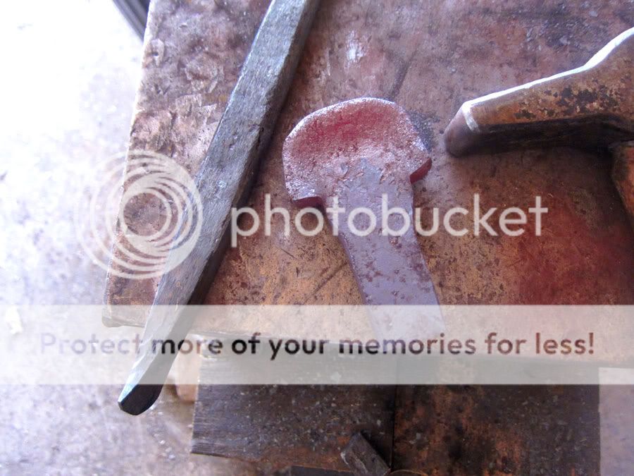

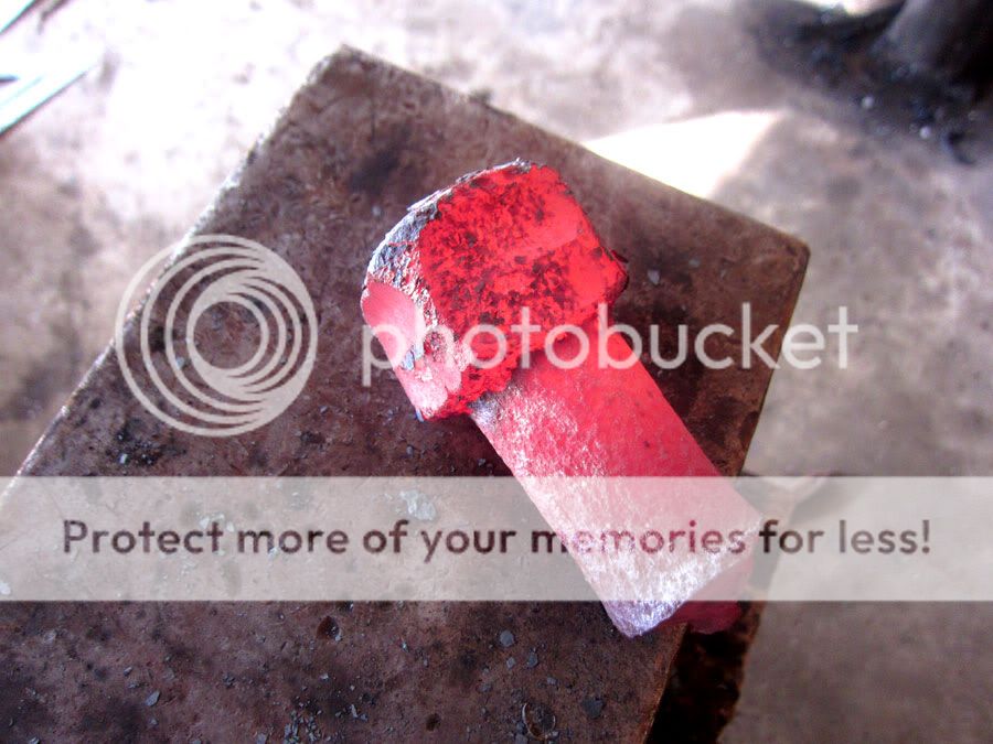

Okay I forged some fittings today. Forging big fittings from wrought iron is always a pain since it's usually in a form that isn't convenient. For example.. here is my pommel:

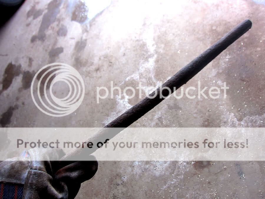

Forging down big pieces of wrought like that with my press almost always leads to hot shorting and crumbling as the sides of the iron cool faster than the core resulting in splitting and cracking. So I just get it close and then grind the rest of the profile. I actually made two pieces from what you see in the last picture... one a bit more massive than the other. It's important to get the right counter balance for the proper handling of the sword.. so I may end up using one or the other depending on the weight I need.
The cross guard will be easier to manage since I can forge it from a 1/2" round bar of wrought. My client ended up deciding on an alternate guard style you can see....

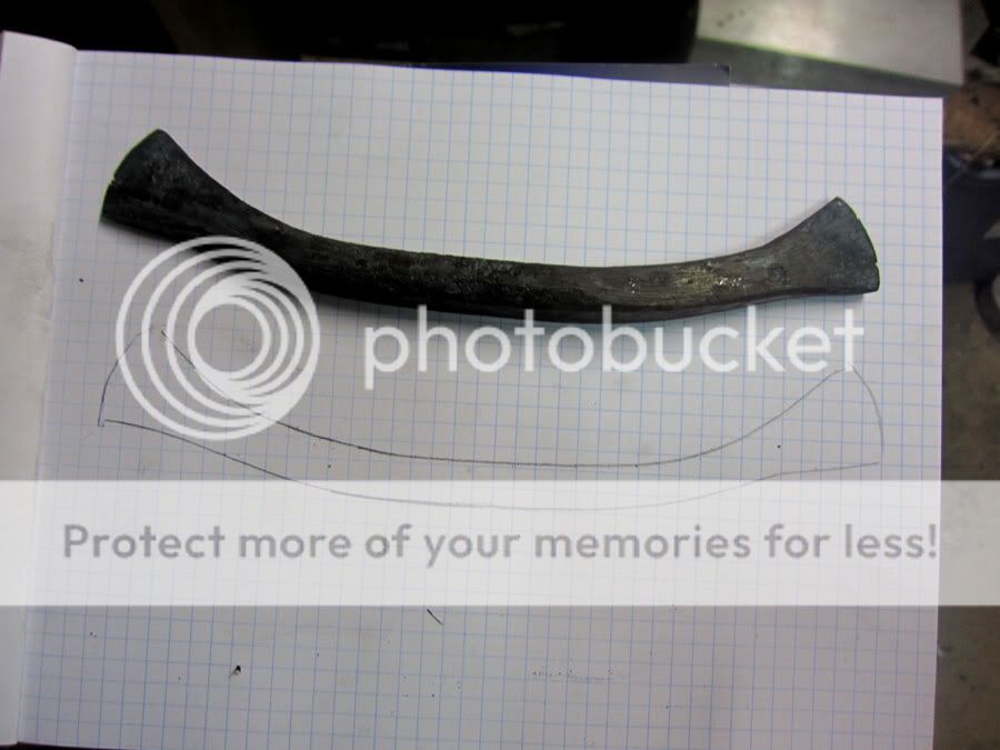

I forged some curvature into the cross guard and then traced it on some graph paper to check for symmetry, etc...

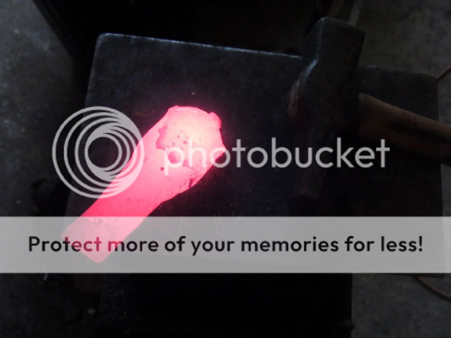

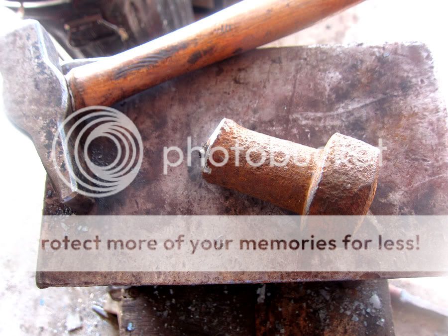

I decided to work on the other pommel piece out of concern for the mass in the first piece. I'm just trying to forge this into a rough shape and then go for a lot of grinding. At this point.. it mostly needs a little more width to get the flaring I want (refer to the picture at the beginning of the thread).

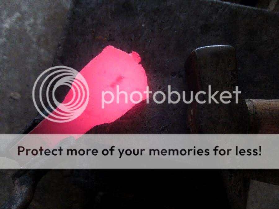

To get the width I just put a shallow fuller in with the press and then flatten:
And some hand forging as well...
Now the piece of wrought has all the dimension I need to grind it to the final shape AND hopefully have the mass I need to counterbalance the blade.

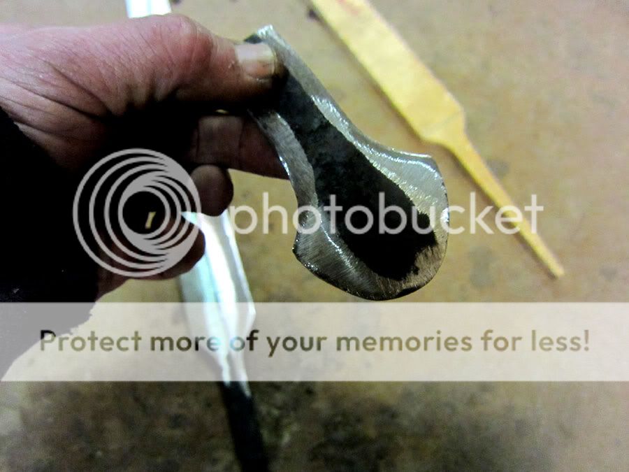

I had to keep hammering on that dang pommel due to fear of losing too much weight grinding it... So more forging to shape:
After cleaning up a bit...

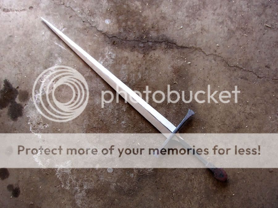

And I got most of the grinding done today. I start by grinding the bevels a bit and then switch to establishing the flats and distal taper. Distal taper will be fine tuned by flexing the sword with the tip on the floor and looking for flat/dead spots that indicate stiff areas. Much like tillering a bow. I will try to get pictures of this tomorrow.

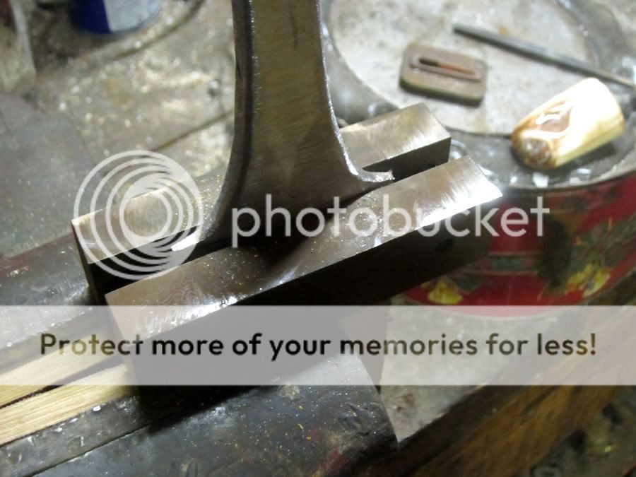

Getting the shoulders (mostly) even with an old file guide. After heat treat I will fine tune with my good carbide lined guide.
Here is where it is now... almost ready for heat treat. Just need to true up the edges and fine tune distal taper. It is so, so, so important with blades this long to have everything equal and symmetrical in as many dimensions as you can work with. You can easily turn a sword like this into a sabre in the quench.
