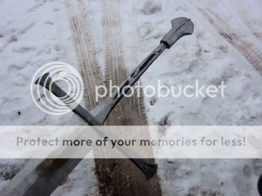

Here is where the sword is now:
That picture might not have meant much unless you were aware that we just got hit with the biggest snow storm of the year. We got about 15 inches... so I was dealing with that most of the day (in addition to un-stucking the two vehicles in the picture).
Here is what I did today while the sword was going through it's many tempering cycles in an attempt to correct that nasty hinge.

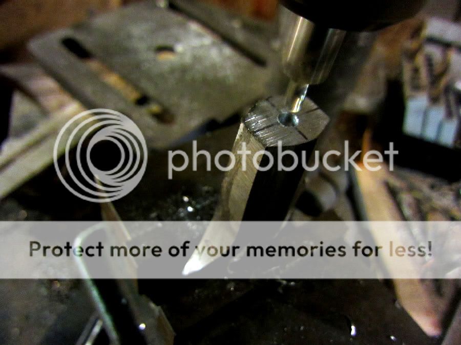

I drilled out the pommel to accept the tang. At this point.. I just have a hole drilled through.. but I will mill out a recessed, square slot for a portion of the tang... and the rest will be round and peened through the bottom. The recessed square keeps the pommel from spinning. This was the deepest hole I've ever drilled and had to do it from both sides and I was thrilled to see the two holes meet up.

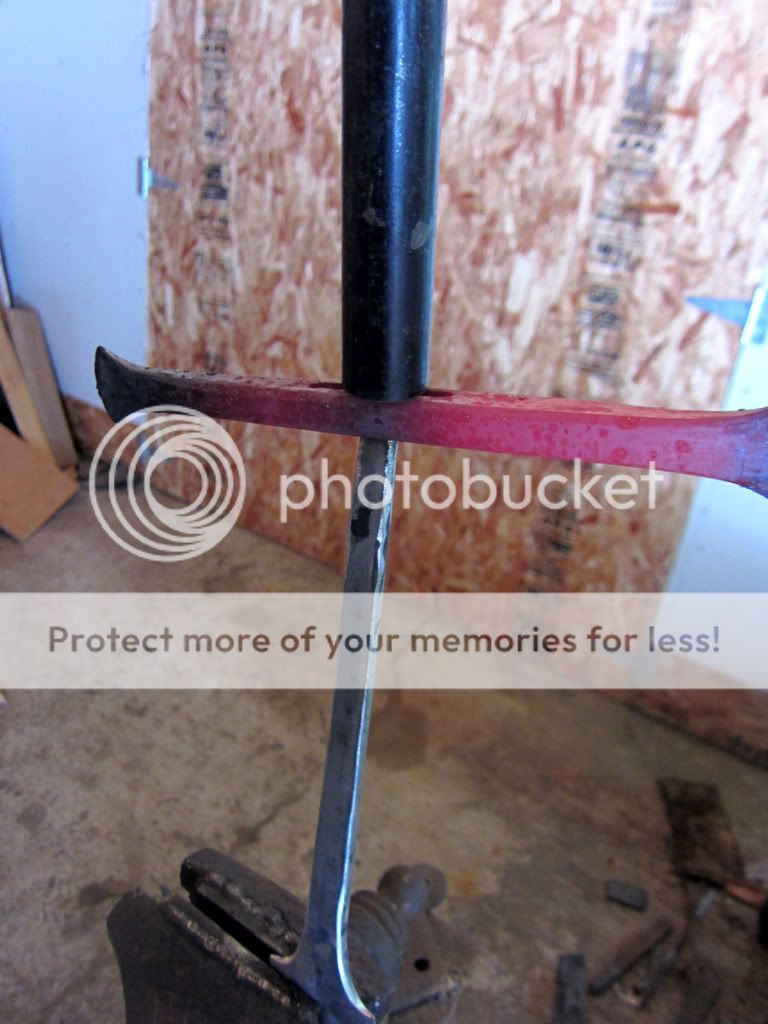

And here is the first 'kink' I had to work out after the quench:
To fix it, I clamped it to a straight piece of steel with a shim on one side and then soaked in the temper oven for 2 hours (425F).
This one corrected nicely on the first try due to the thinner cross section. The one I'm dealing with now is 3 inches above the tang where the steel was 3/8". I'm giving it one more shot. If it doesn't work, then re-grind to fix any of the uneven areas that probably caused it and then quench again.

Well I finally got that blade straight. Five tempering cycles and then figuring out the best clamping method did it...

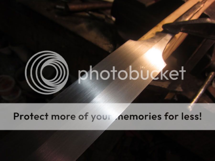

Tomorrow I do clean-up grinding on the sword and finish sanding.

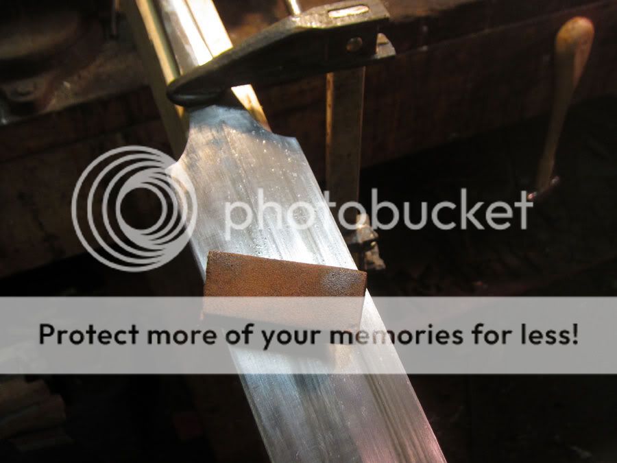

Ben... It's actually not too bad because I will machine sand it to 220 with the lines running towards the tip.. and then just go over that with a 150 EDM stone. I want it to have a 'draw filed' look under the antique finish.
Not too much work over the weekend.. wife's birthday. But I got a good start on the blade finish. 150 grit EDM, followed by 150 grit paper:

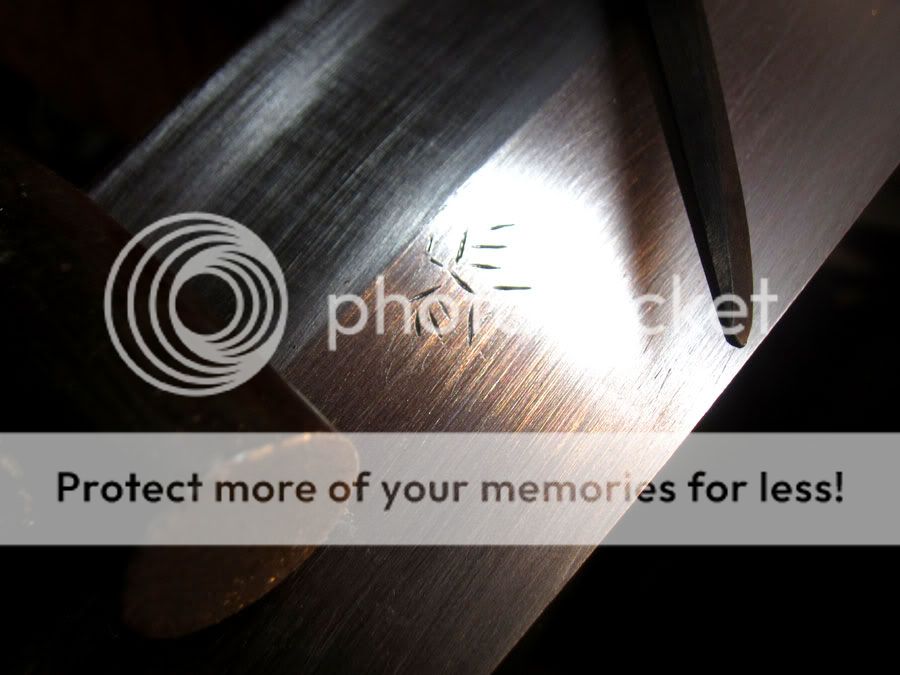

I recently spent a couple of days with Patrick Hastings (Tagane Arts) learning the very basics of a type of Japanese engraving called katakiri. I thought it would be fun to start including a 'passau' mark on all of my swords using some of the chisels I made with Patrick. These were usually wolf marks and where very simple chisel mark patterns. But there are examples of other animals and the idea (originally) is that the animal mark gave the blade some talismanic protection. So I offered to the client the opportunity to select something of meaning to him. In this case... a griffon (not completely done yet).

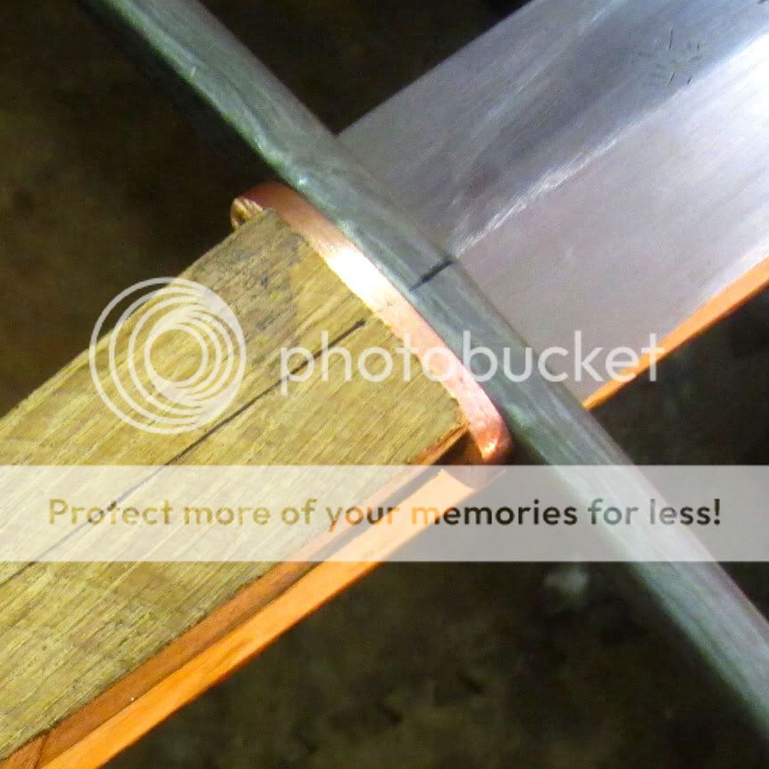

But some progress. Copper spacer has been fashioned and white oak scales morticed for handle/grip.....
Okay... Got some more work done today. Guard etched... Handle grip almost done.. Copper spacer textured (not showing well). Just need to do pommel and back third of grip and blade/finish cosmetics.
