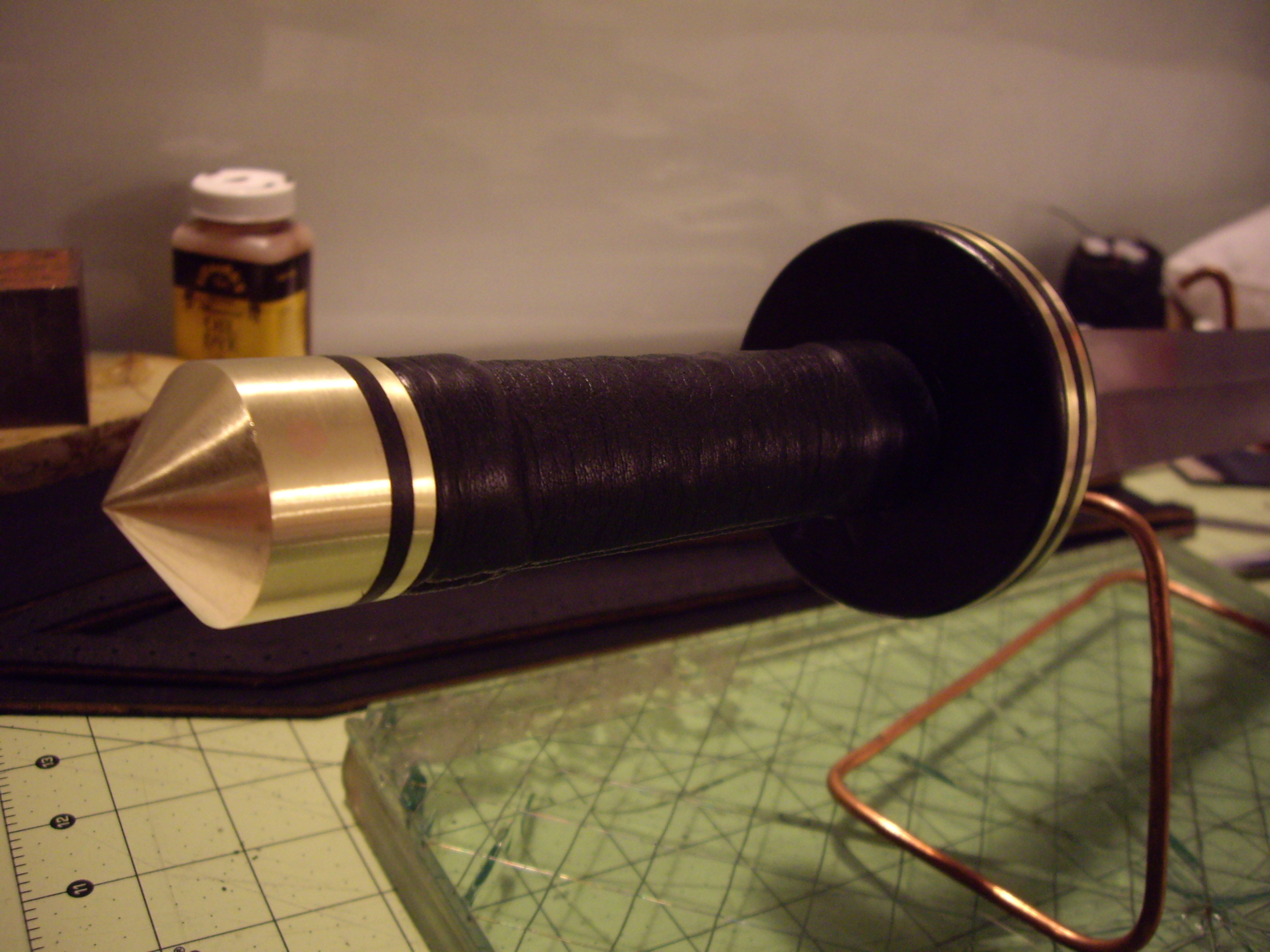

Exactly, Horseclover! The blade could have been spread out a bit more, at the expense of the thickness at the ridge, but I liked it as-hammered and brought forth the grinder. The blade has almost no taper along its length, so it has good balance thus far. Not pictured was the half finished pommel, bulbous as a bumble bee's arse.

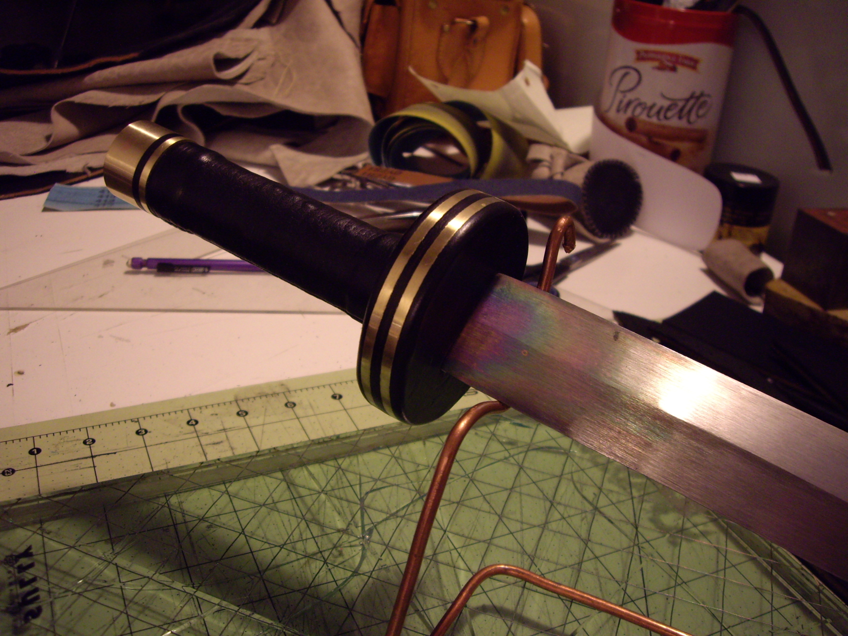

Presented for our spectators' scrutiny, the hilt of the buzzing sword! Next will be a bit of polishing for the blade, a final sharp edge, and a fitting sheath.

nice one. the "stinger" looks like a brass plumb uhm piece?
So that is full tang to the brass stinger?
Good job so far! ;]
Thanks gentlemen!
That's correct Sloth: full tang to the pommel, with a copper pin. All materials used are new stock; no recycled pieces.

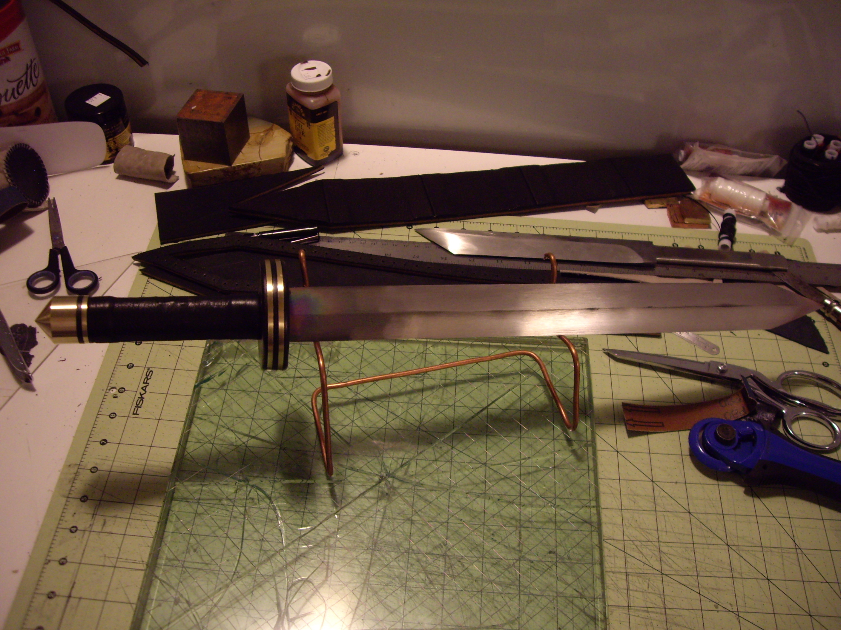

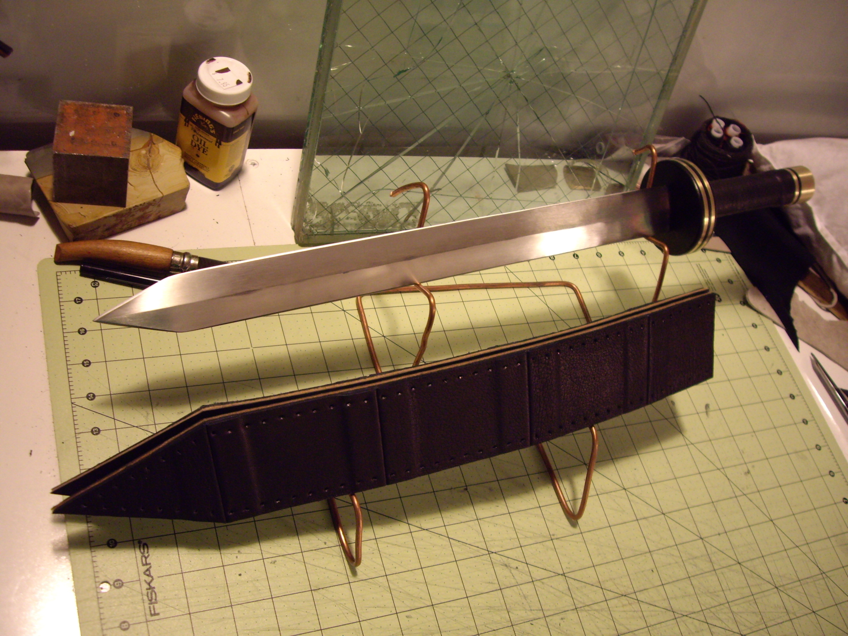

Just lovely..I like how the ancient design has come together with modern touches. REALLY like that pommel. I espied the sheath in the back (I think) coming along too..Can't wait for the final pics. Mecha, you've definitely livened things up around here! :D

Thanks for hangin' in there, everyone. The sword is 98% complete, and we are rapidly approaching the conclusion of this build: CUTTING VIDEO! :D

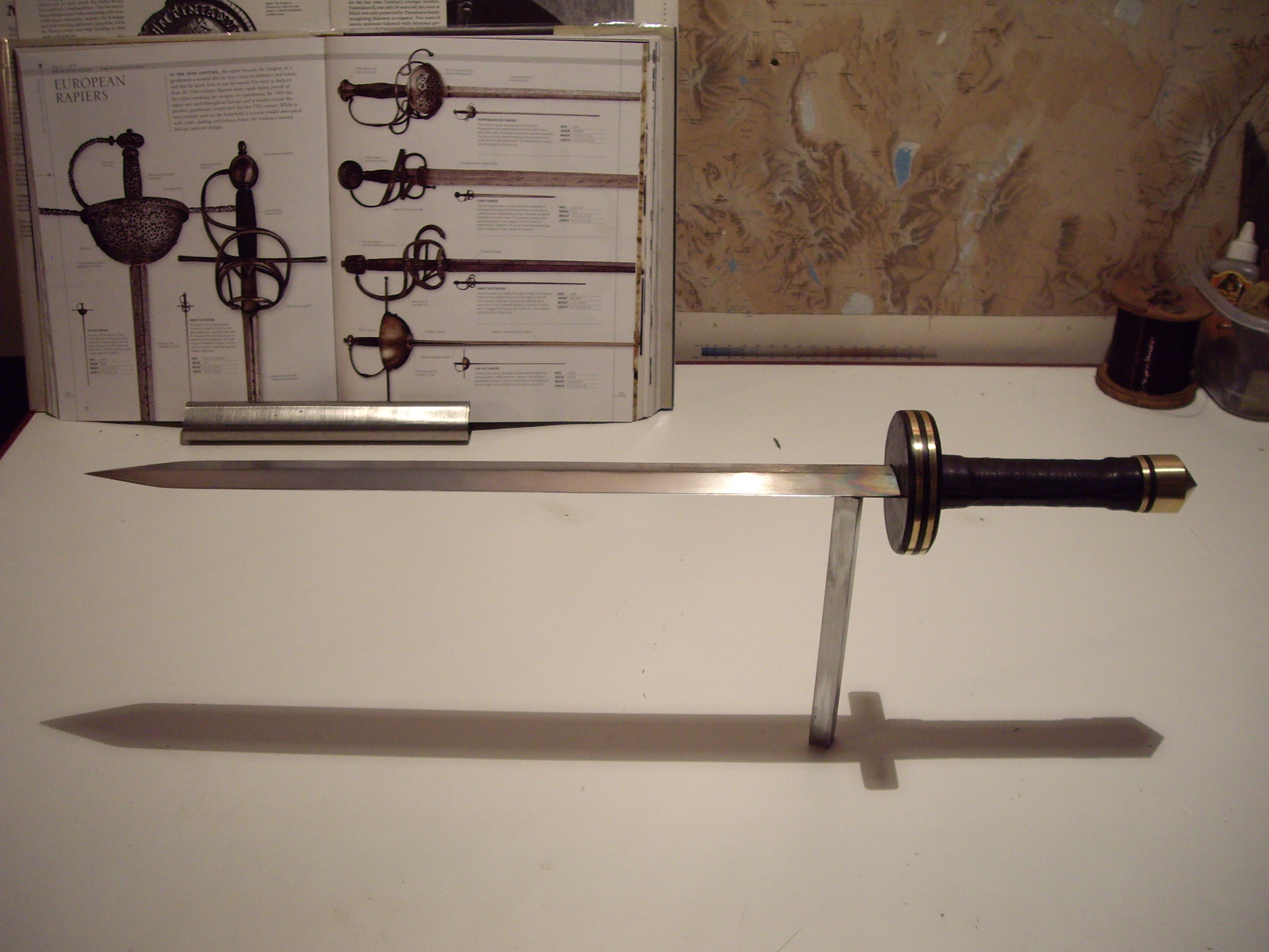

Here is a photo showing the approximate balance point of the sword:

This is certainly a cool blade. You mentioned how much the bar weighs, but may I ask how much the gladius weighs overall now it is ground and has a handle?
