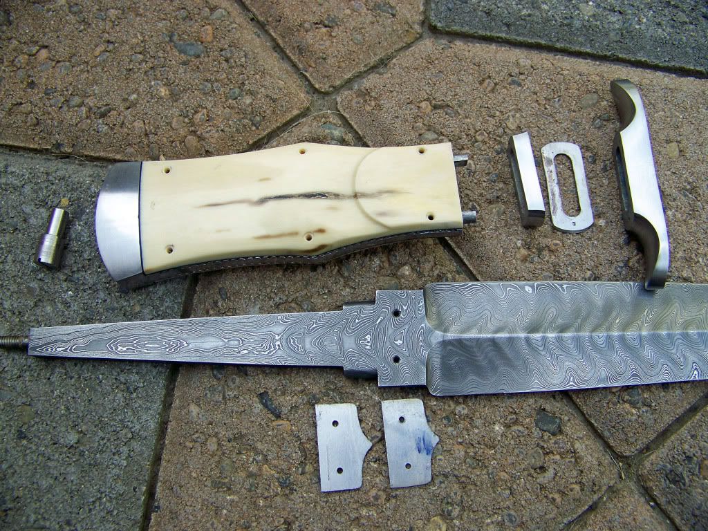

Here is a shot of mine before I peened the name plates on the blade. The handle scales are not removeable. I dont use pins but instead try to hand file the frame and slots in the guard, collar and spacer so it doesnt have slack. I tried to make the parts so symetrical that they could be installed in either direction but finally just put an index mark so they can be put together the same each time.

Bruce, thanks for the "take-down" shot. I would like to see others. Love to see them where the knives are as clean on the inside as the outside.
I'm going to add the dagger to this thread assembled as well, if you don't mind.
