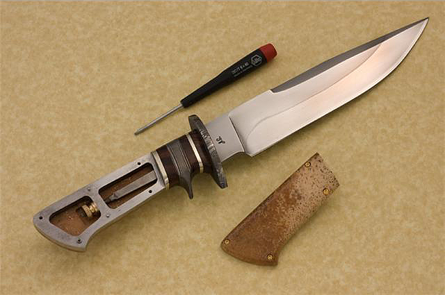

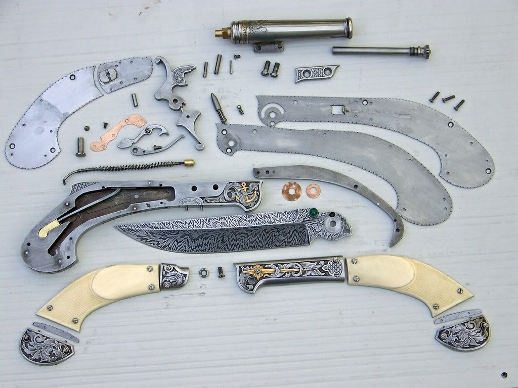

Here is a couple more take downs.
A full tang, not many of these around,

:eek:WOW!! That is SICK!!!!
So is your pistoli Mr Bump. I don't think you need therapy:D

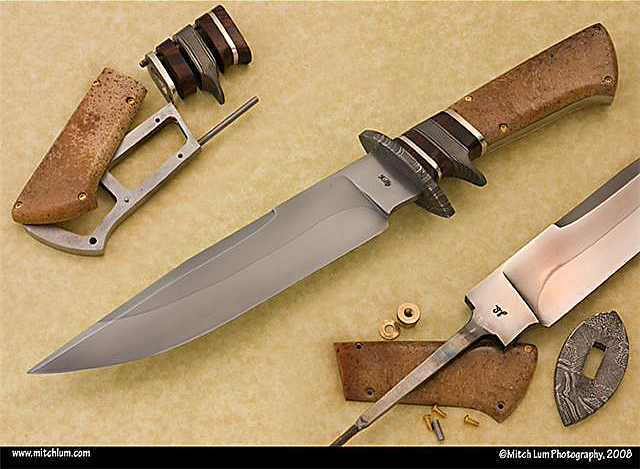

Bruce's layout of his mini-canon says it all about takedowns...they sure are special!! Very impressive, to say the least. :thumbup:
Other than admiration for the skill involved, I had not developed an interest in ever owning one, myself. That was until I handled Karl's at the Branson Hammer-in. Karl took the time to explain his process of construction and theory behind the madness (:D) and I left with a new outlook on takedowns. He has fine-tuned his procedures so well, he is right in saying they are an example of simplicity. Hope to own one someday.
Now, Bruce...he may need therapy! :eek: :D

Consider a multi-part knife like the one shown here. Look at all the mating surfaces. There is no - there's that word again - epoxy to fill in any voids. It can't be done just "close". "Close" doesn't work. All surfaces need to FIT and FIT RIGHT so that even LIGHT can't come through. Nothing's gonna get filled.

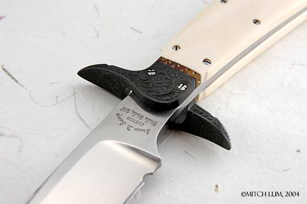

Bruce, thank you for contribution to this thread. I didn't realize that stag handled beauty was a take-down. It was my favorite of yours until the introduction of your recent dagger.
Take-down or not, that OKCA Best Bowie of Bruce's is one of the most elegant knives ever!
