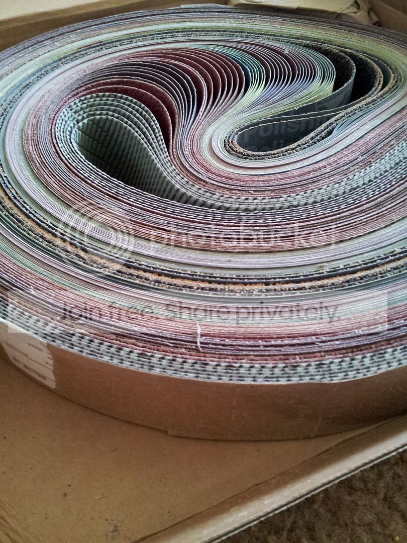

My belts came in today from Trugrit.

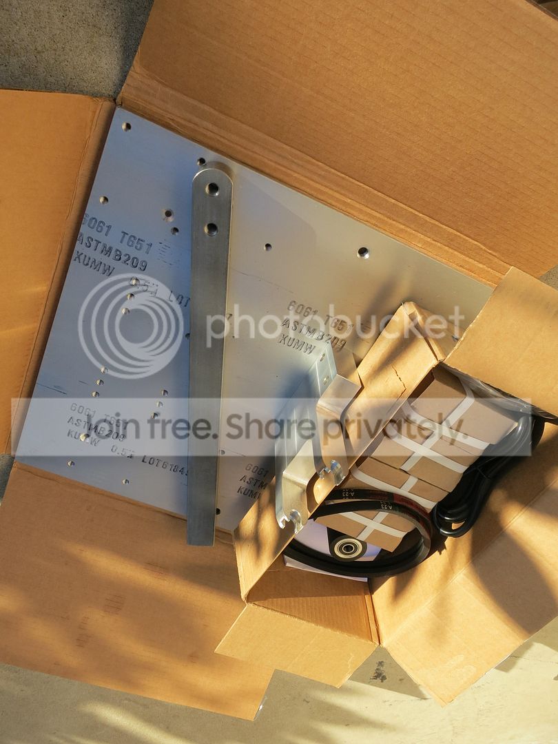

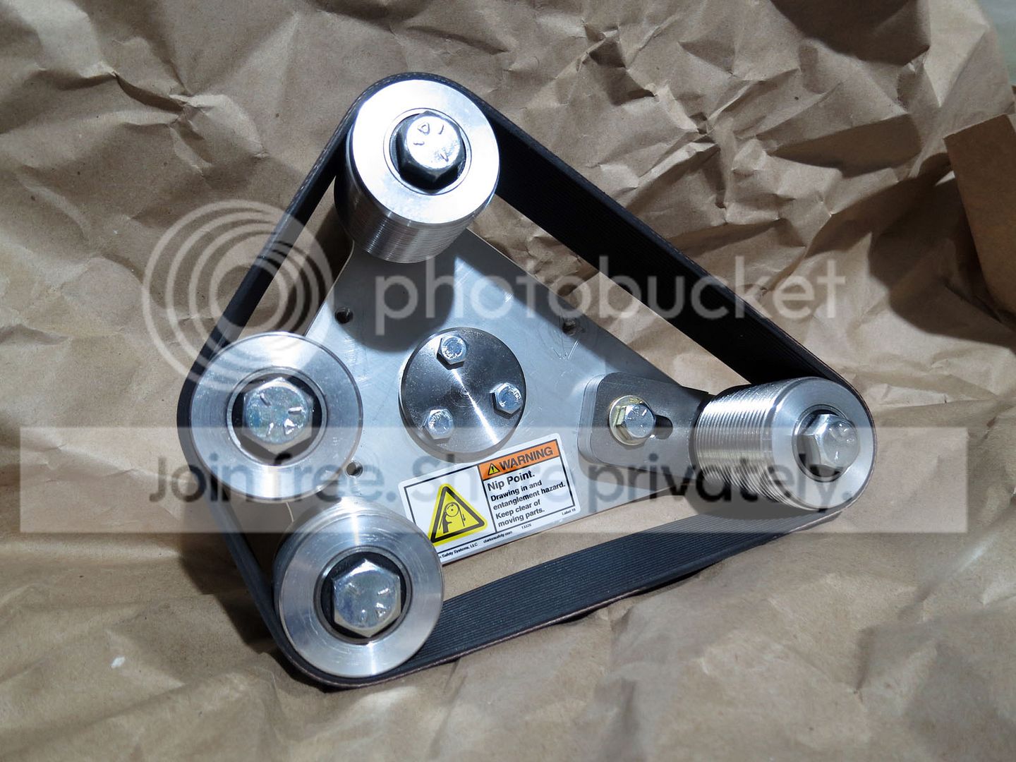

Also got some parts in from Beaumont. Subplate, Workrest, 2'' Contact wheel, Small Wheel Attachment, 3/4'' wheel for SWA, and pulleys. Although to my surprise, Rob forgot the hardware for the subplate, so I can't mount up the motor to it.

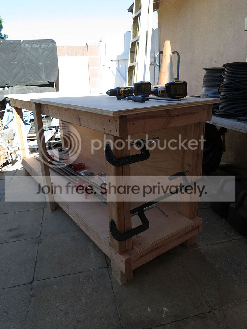

Today's work:

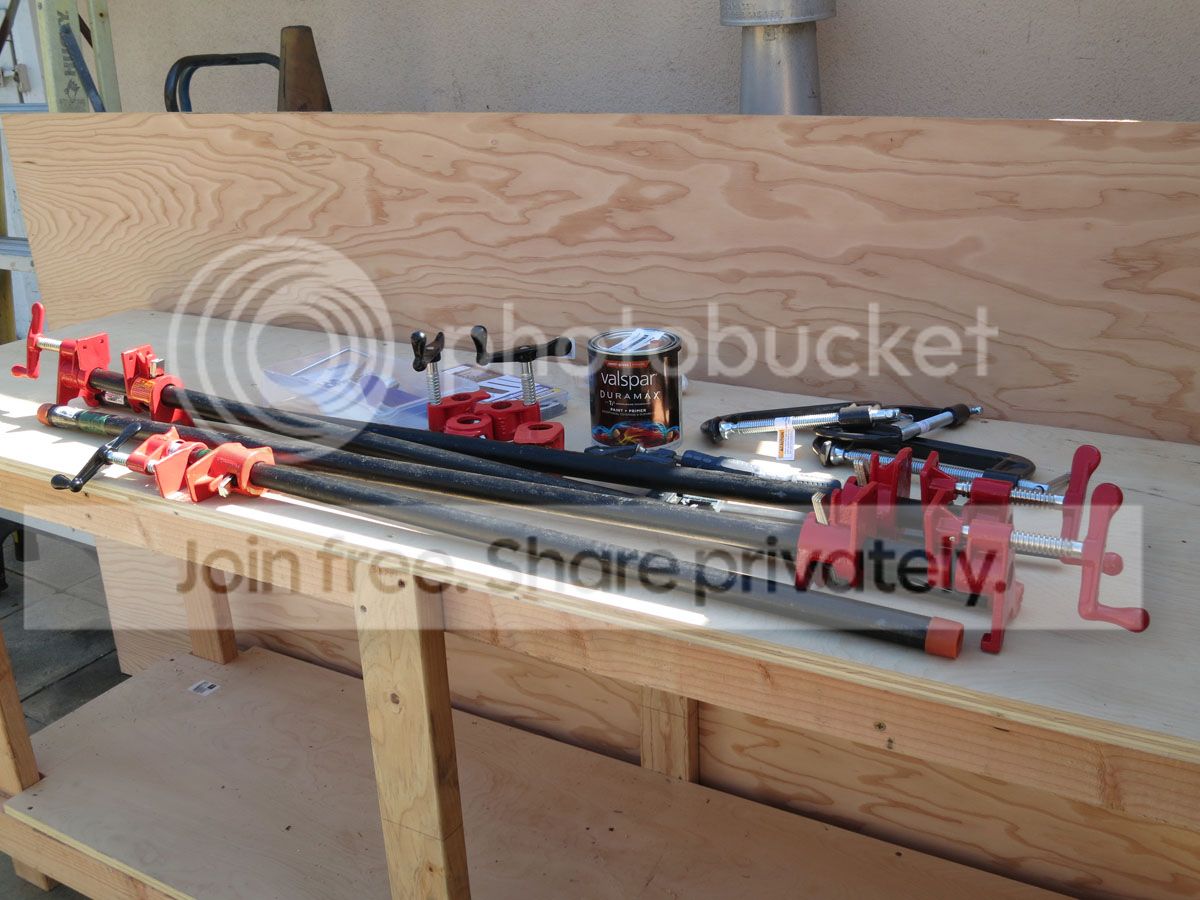

Decided I wanted to beef up the vertical support, so I doubled up on 2x4's, glued and clamped.
Also stopped by HF for some Pipe Clamps, these are awesome! Only heard of them just 2 weeks ago, this would have come in handy so many times in the past. Picked up C clamps, quick clamps- then zoomed over to lowes for the Paint and rollers.

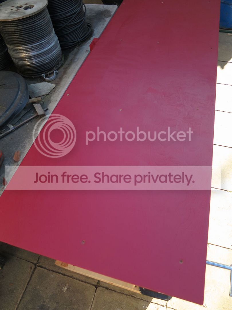

Painted what I could with the little energy I had left. Now I remember why I hate painting anything.

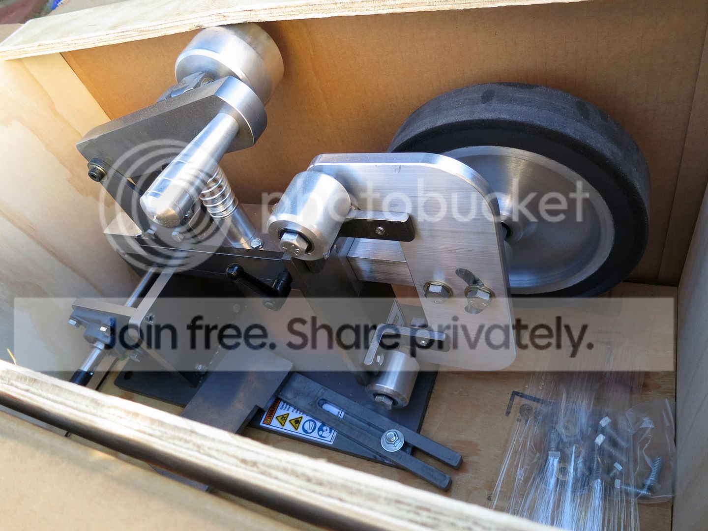

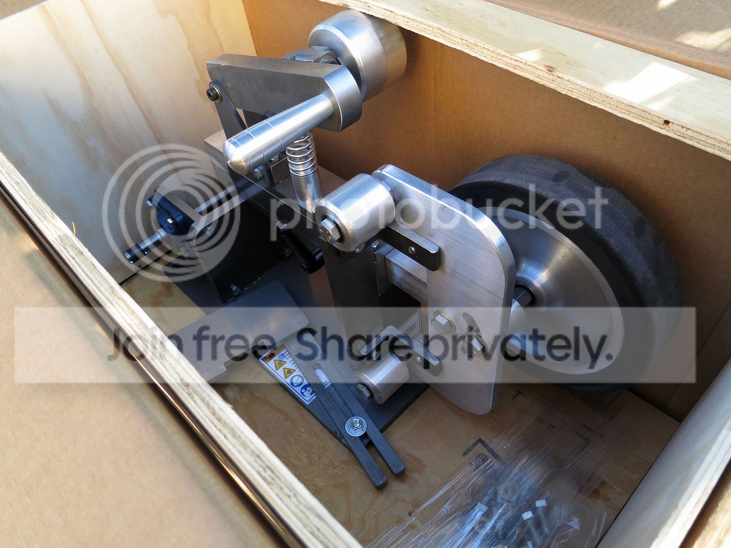

Grinder came in today- which I am stoked about. However they didn't send me tracking- had I not been home the box would have been left there. Not thrilled about it, but luckily I was home. My last order with them, bolts were forgotten. This one now has an aluminum tooling arm, even though I specifically requested a steel one several times via email and mentioned at least 3 times by phone. Beaumont makes a great product from what I have seen so far, but their service is sub par from my experience with them.
Mob, I understand that you are disappointed in the tool arm being aluminum but I used steel arms (7 of them) for over a year and I sold them all to get aluminum tool arms. It saves 10 ibs on each attachment and they work just as well. You are going to love working with a KMG...they are great grinders.
Thanks! I'm alright with using aluminum, however I still prefer steel because I feel more confident with it. My complaint really, was just in getting an aluminum arm- after stressing several times wanting steel.

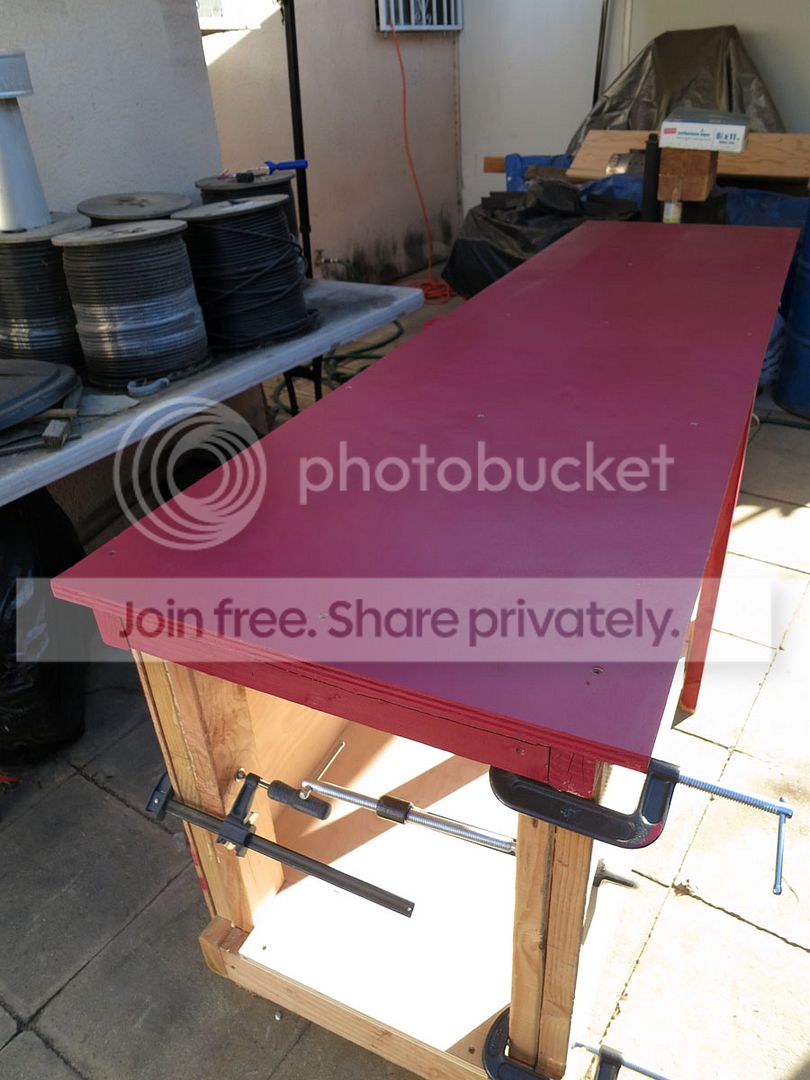

Either way, I can't wait to get this thing going. Current mission is getting everything painted up- as it will be in the backyard (my only option) under a canopy and covered by a tarp after use. Quite a bummer, I haven't even had the time to take her out of the box yet. Been scrambling to finish painting the work bench for it, before it rains here for the next 3 days.
I'm wondering if your workbench might be too tall for your grinder. Most find that the ideal grinding height is about even with your elbows when your arms hang at your sides. I placed the center of my wheel at that height, based on others recommendations, and it really does feel right.

I hope not Bob,
Took me a while to paint. lol
Bench is 34.5'' tall, I am 5' 5'' tall. I measured my arm height horizontal around 42.5'', when first building the bench- I didn't have the grinder. So I wasn't sure that the center height of the kmg was. A friend told me 8'', so I based it off of that. If anything I will saw the bottom legs down, or build a small platform to work from. The grinder hasn't been mounted on the bench yet- since it's still drying. This would be an ideal time to shorten the legs, but I won't know until having the grinder on it.
