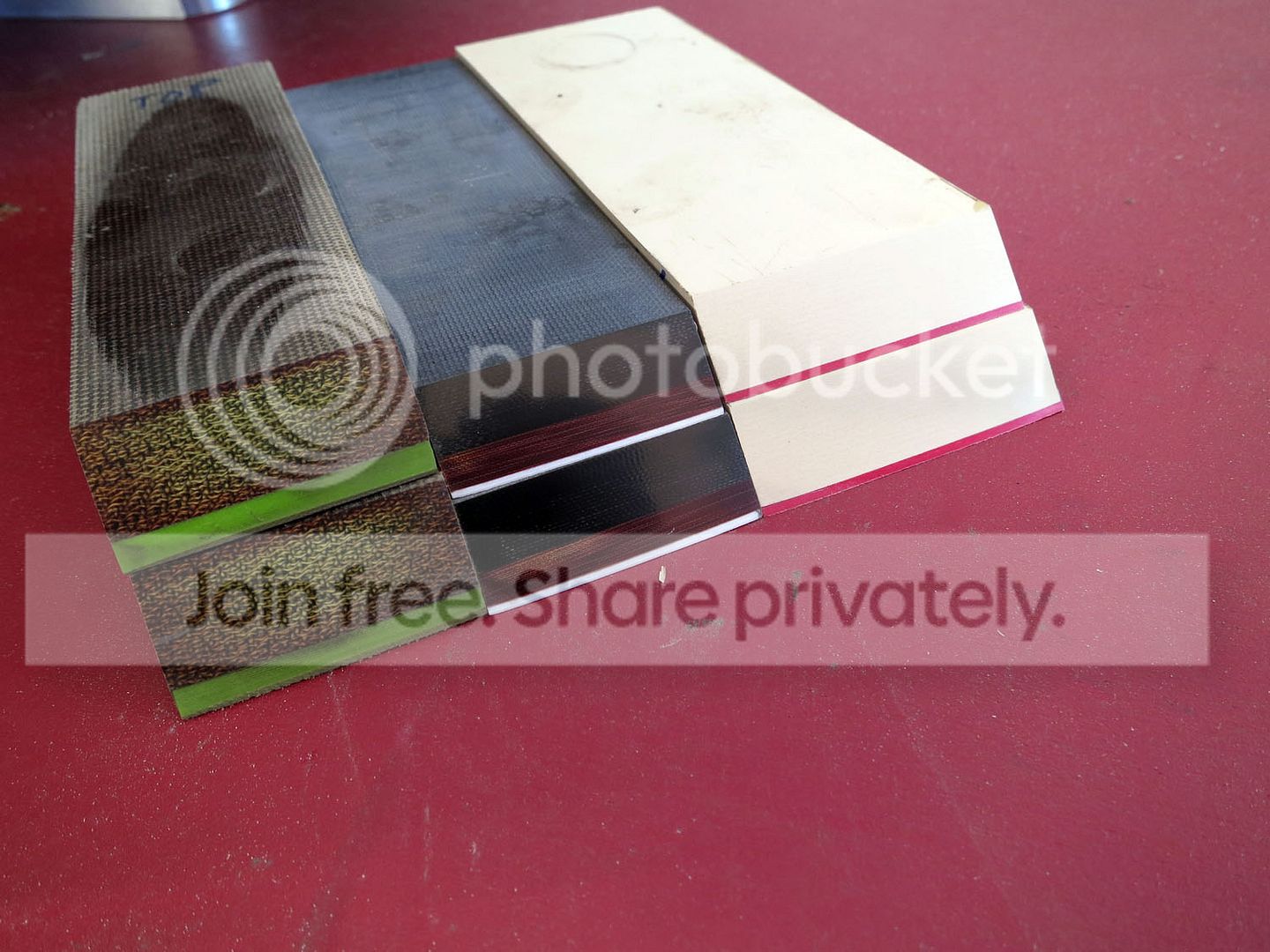

We use composite balusters for the wedges Its the cheapest material available that does not absorb water. We here for the long run so anytime we can help, let us know.

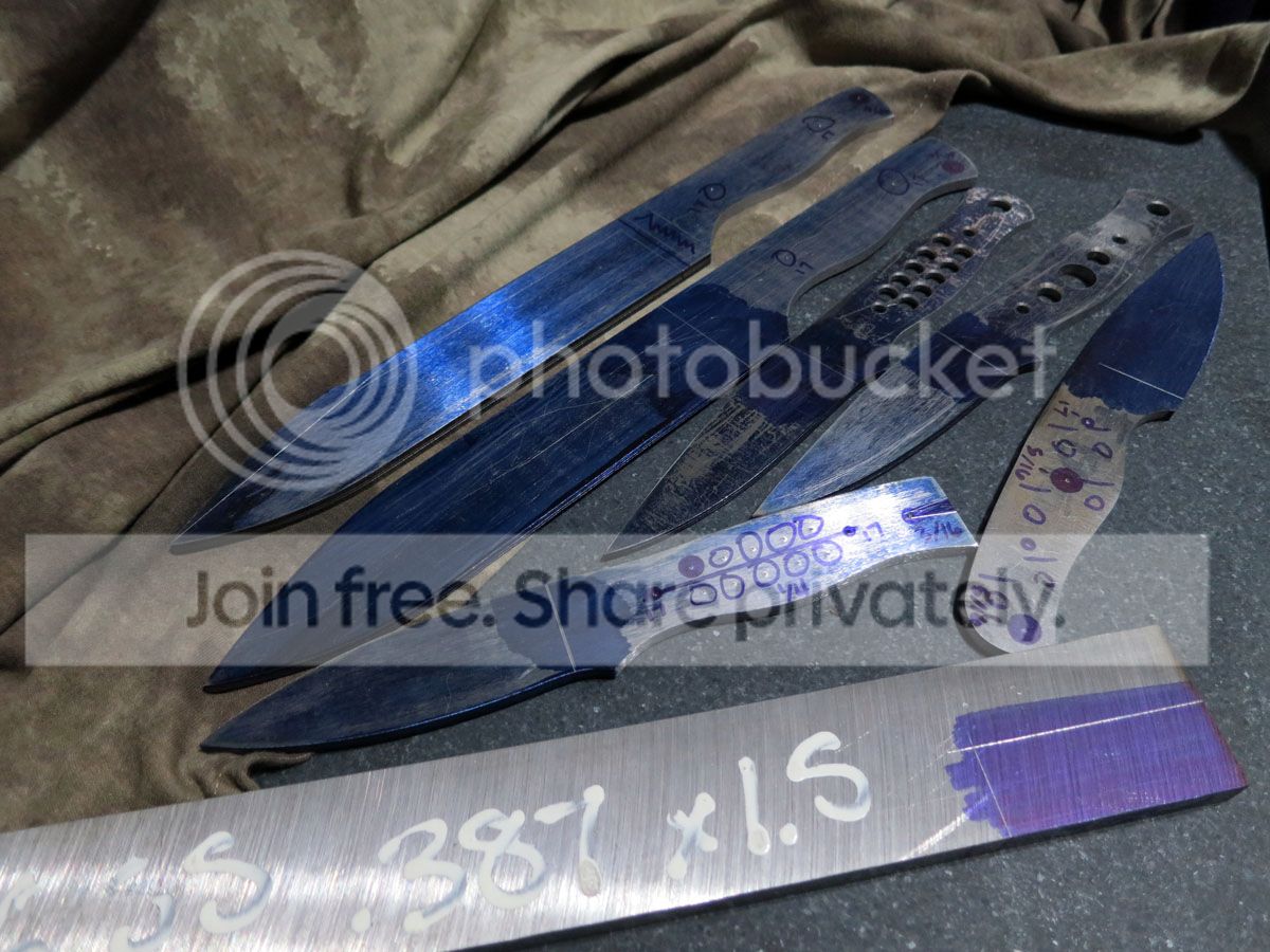

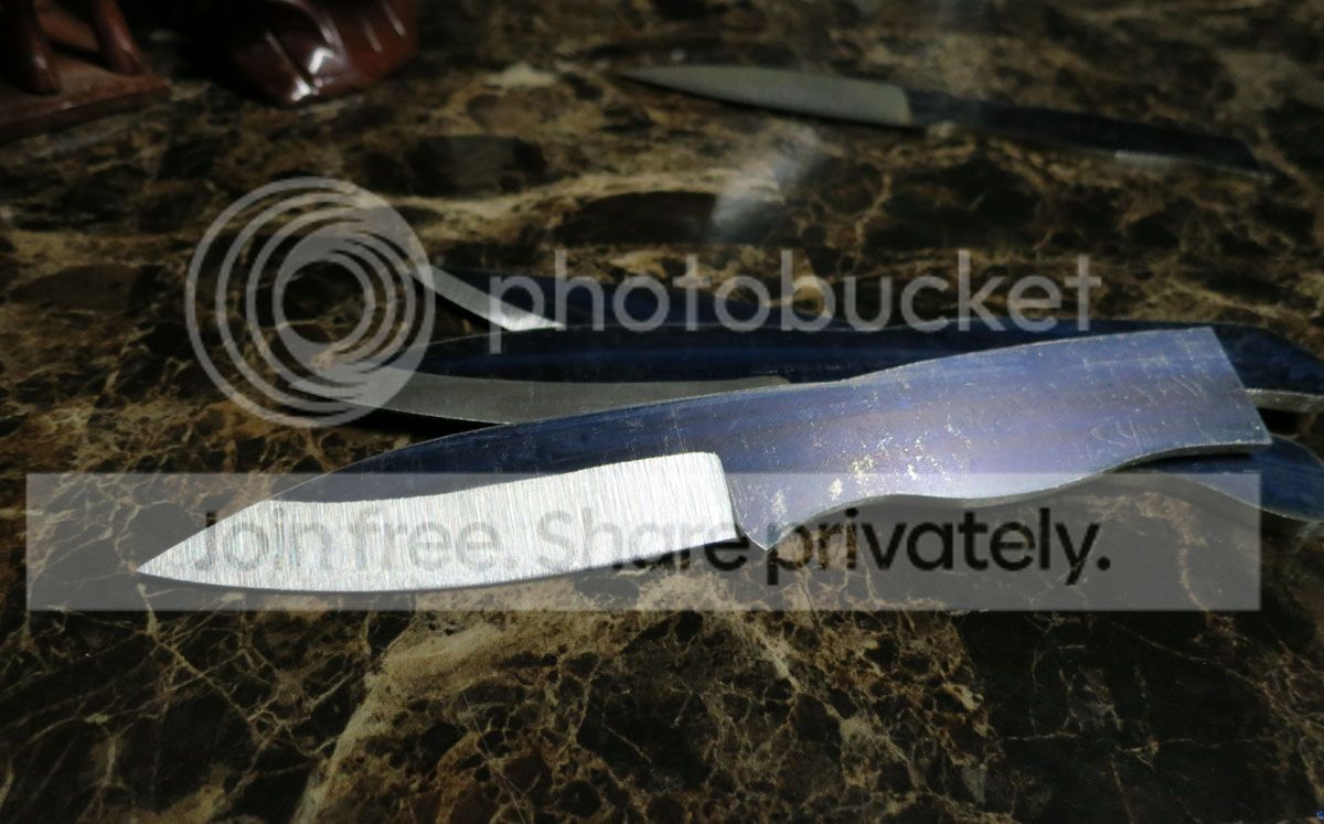

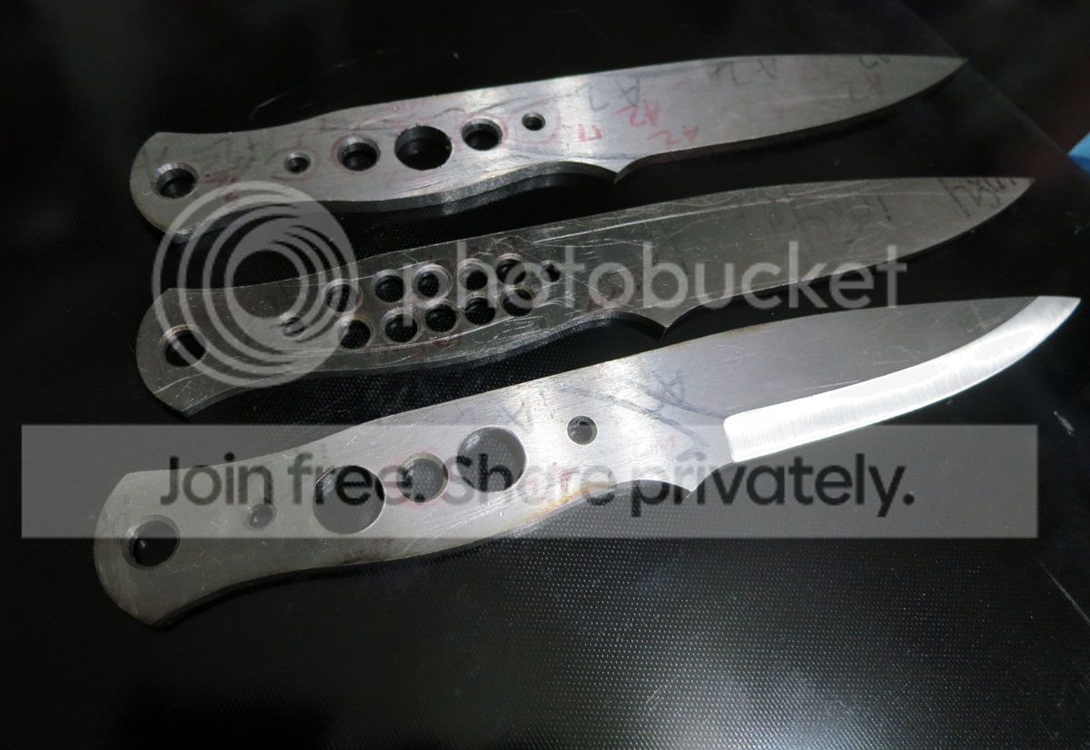

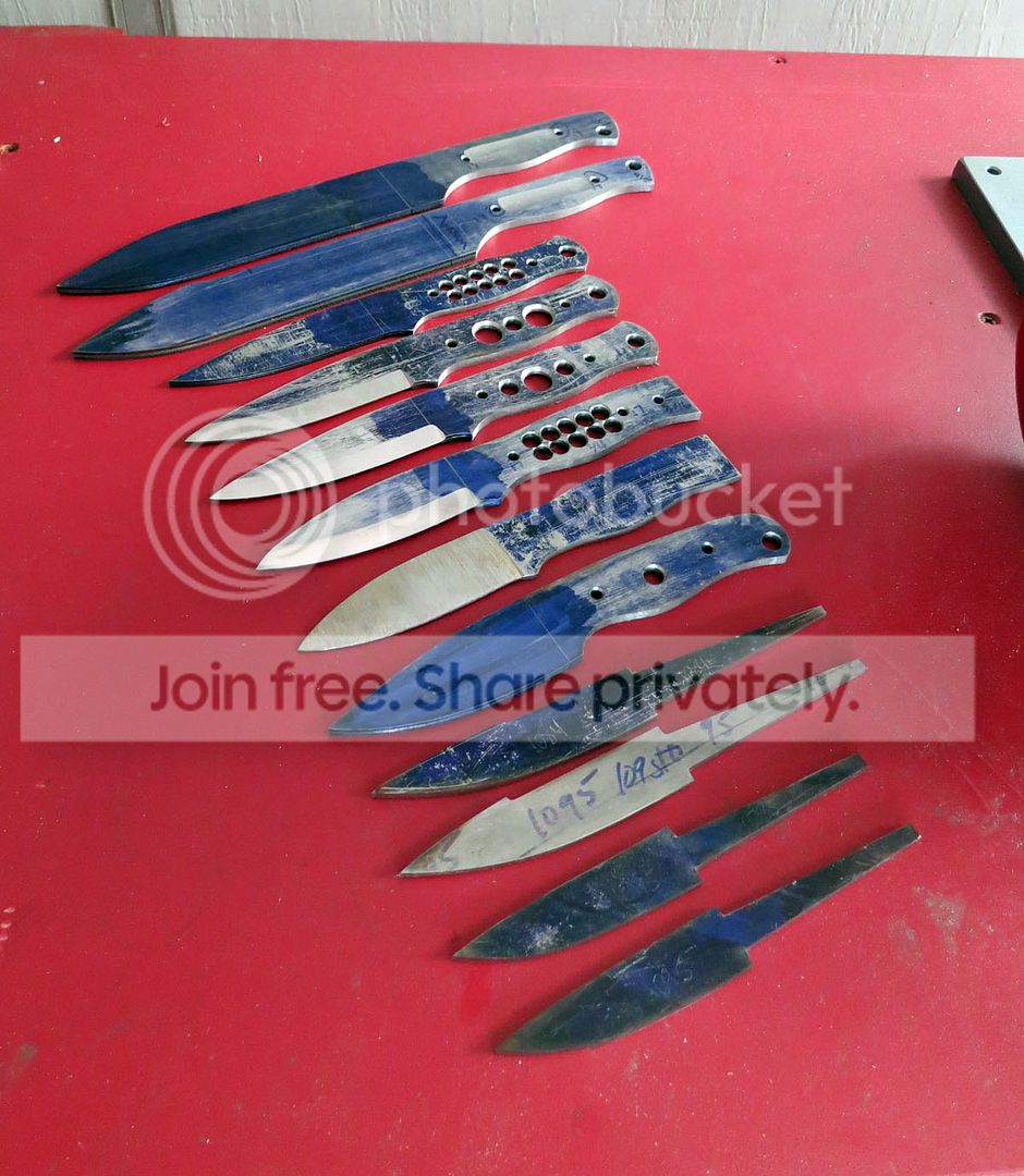

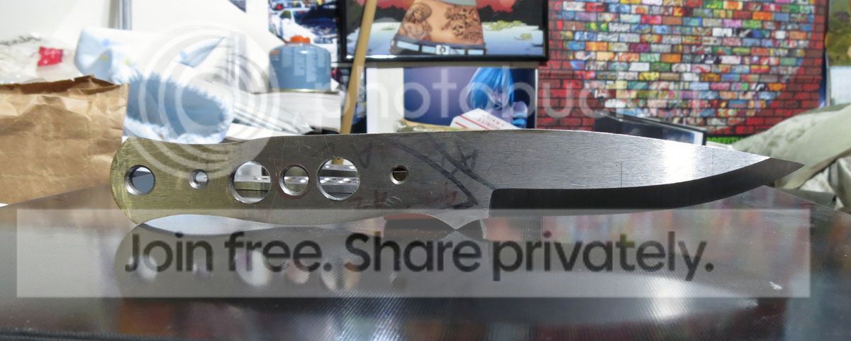

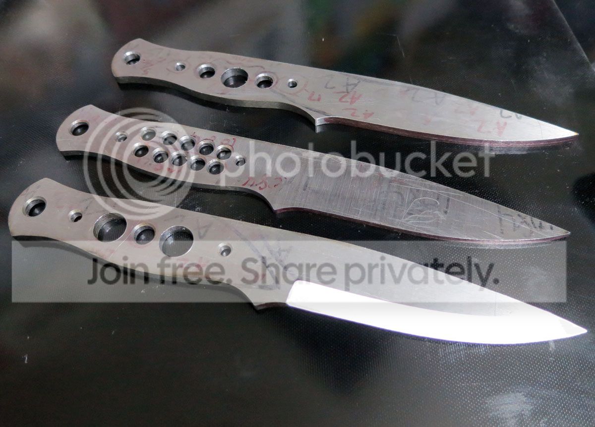

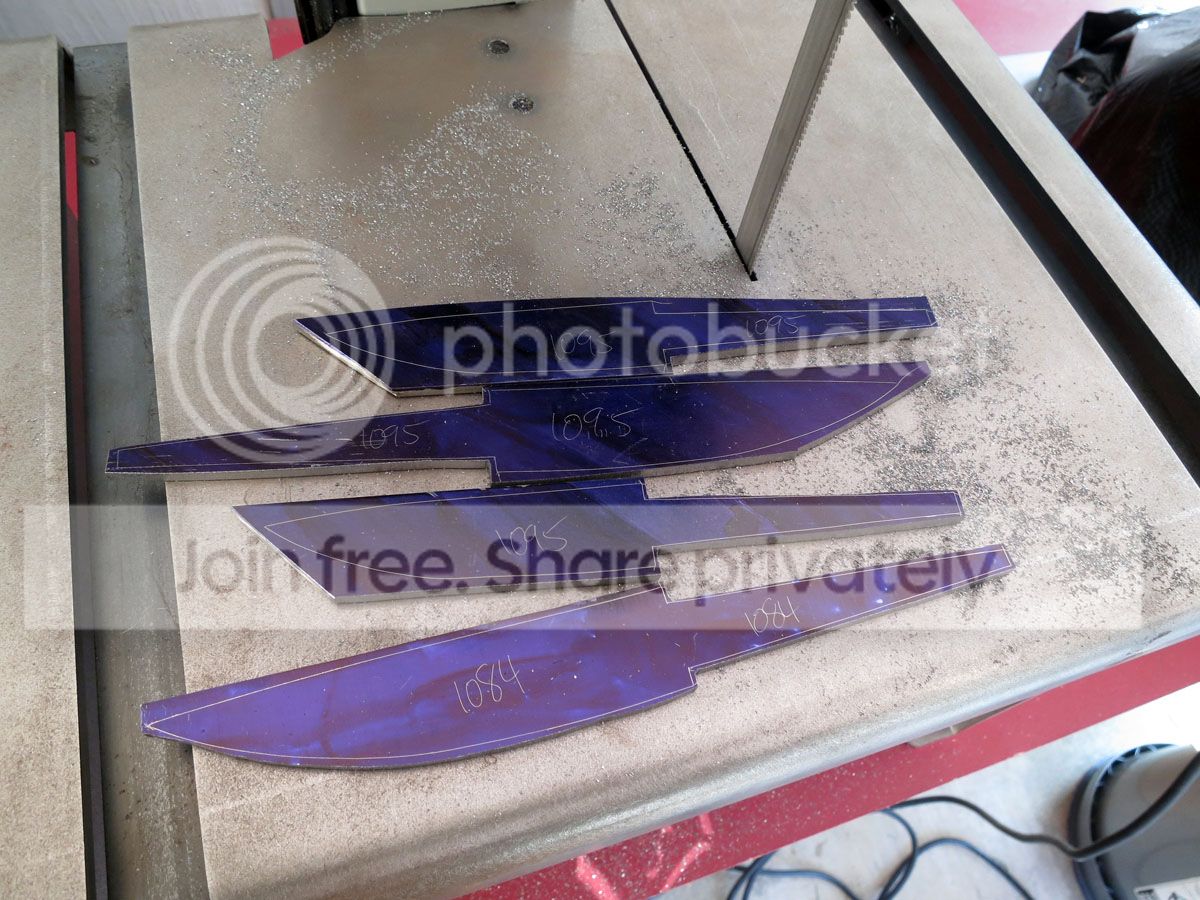

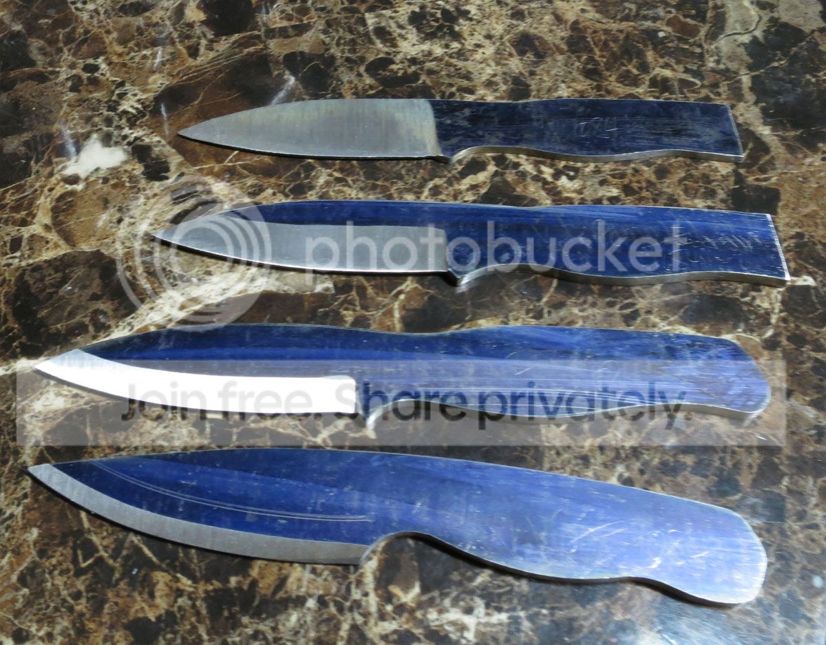

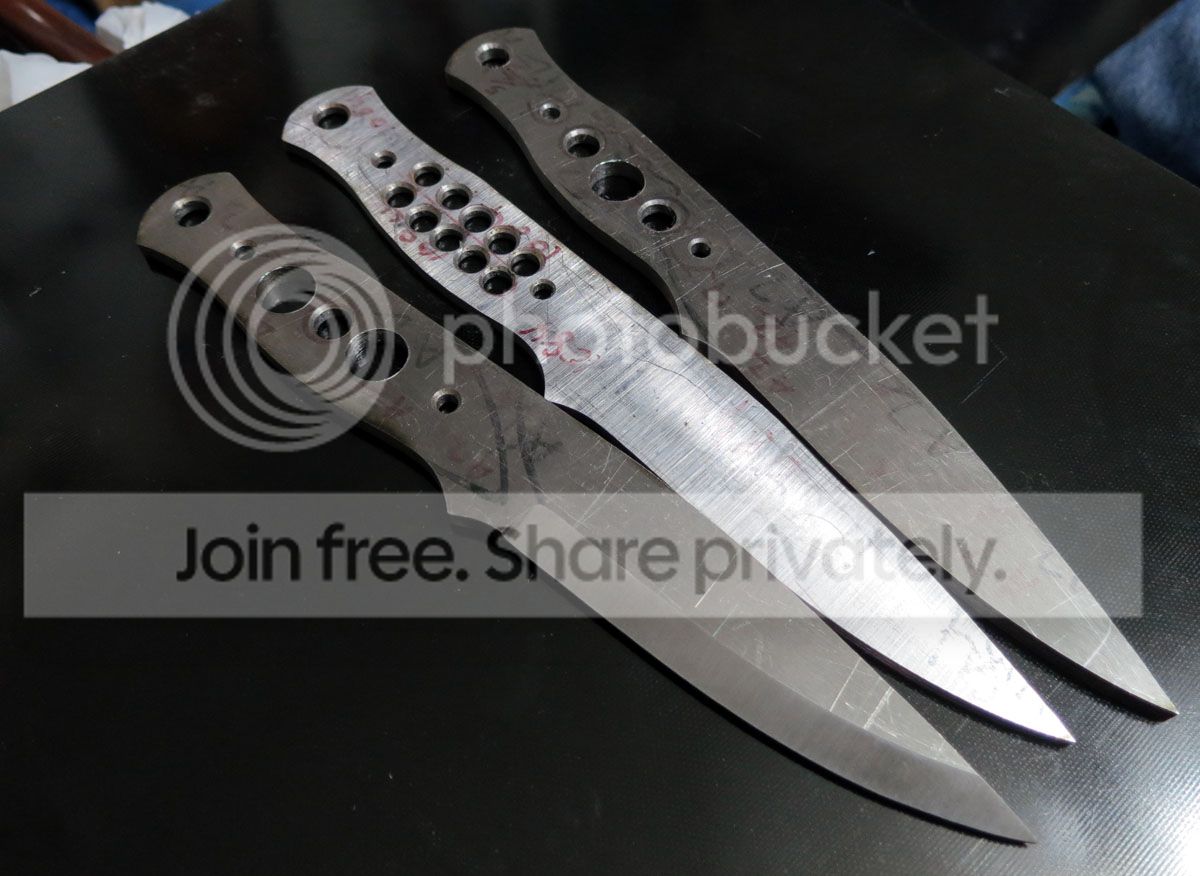

Finally felt in good enough shape today to get on the grinder. Boy am I glad that I started with the 1084 blanks, everything was botched. These are my first 4 blanks. One will be a full flat grind.
Any positive feedback appreciated.

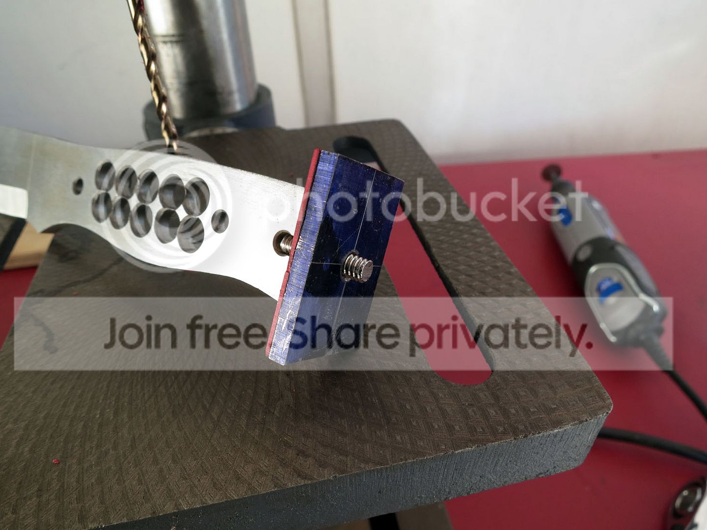

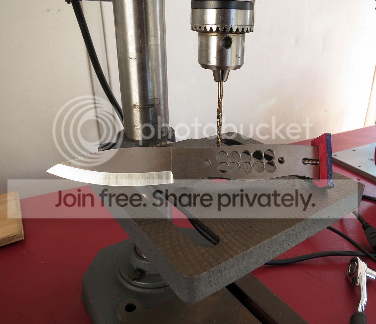

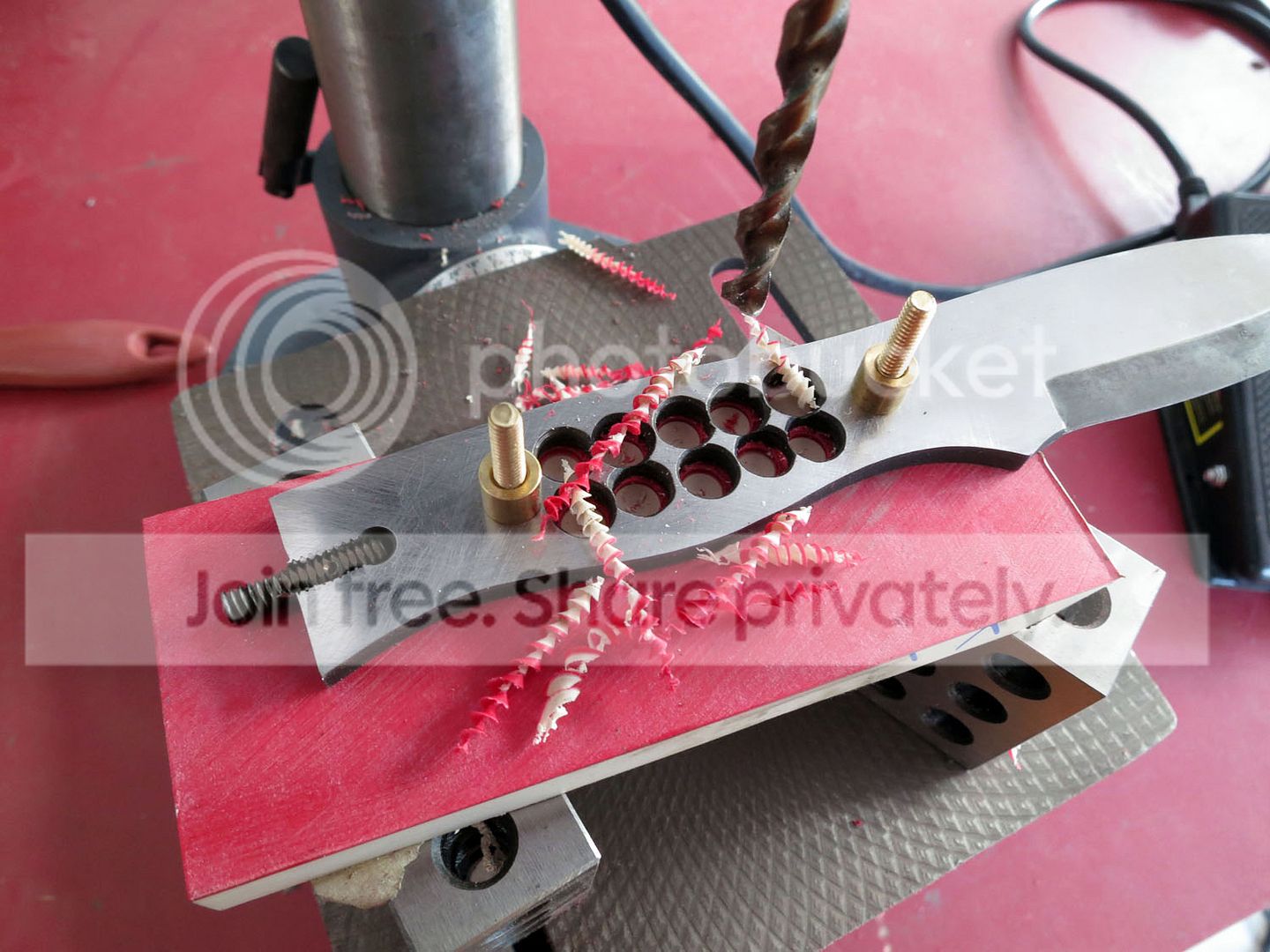

Got a little more done today. I had no idea it would take so damn long to drill holes in a handle. So that left me with only 3 done so far. The rest of the blanks are still being dialed in, I'm going back and forth between short (height) handles and medium height ones. The big choppers are on the large side, so I will bring them down.
My attempt at a Woodlore clone based off of Cody's (Adventure Sworn) version of it. This is not my own design, however I did draw things based off of photos. Something nice, was being able to size the handles exactly to my own hands.

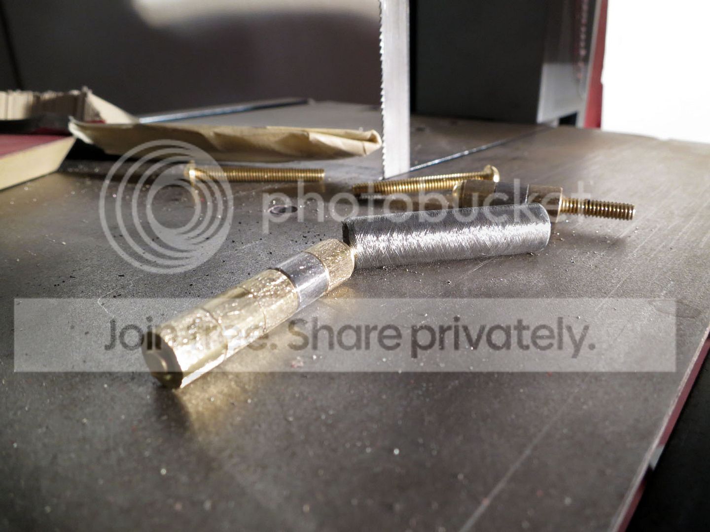

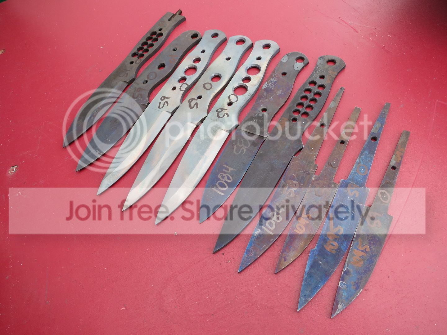

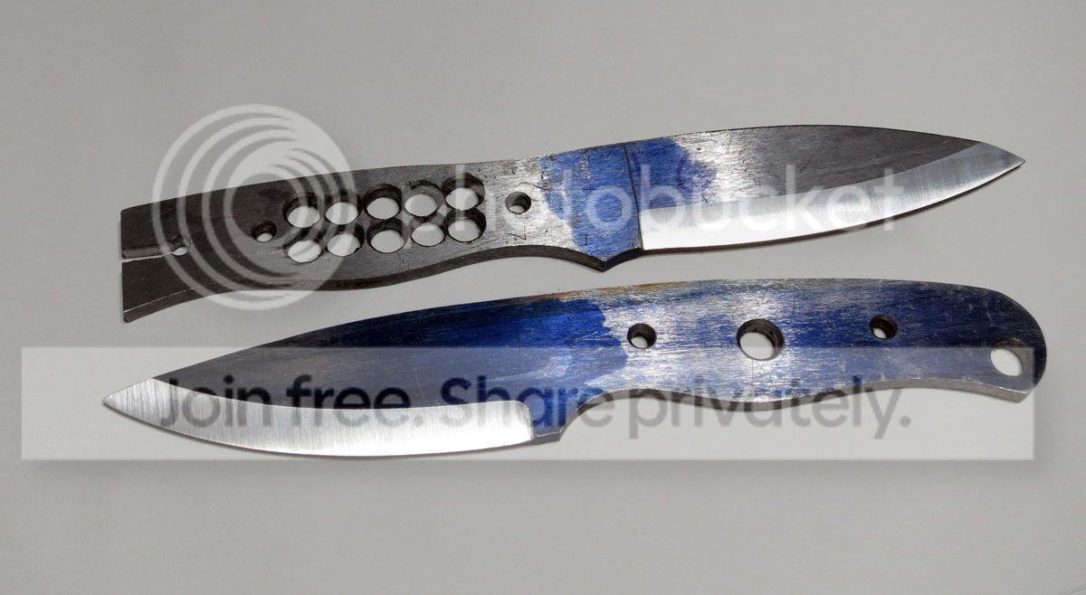

I refined the handles on the choppers a little more, laid out the handle holes. One chopper will have a single guard made from 416ss plate and pins, and the smaller knife with a flat butt will get a threaded pommel from 416ss as well. The last two will be a first for me.
Another boring update:

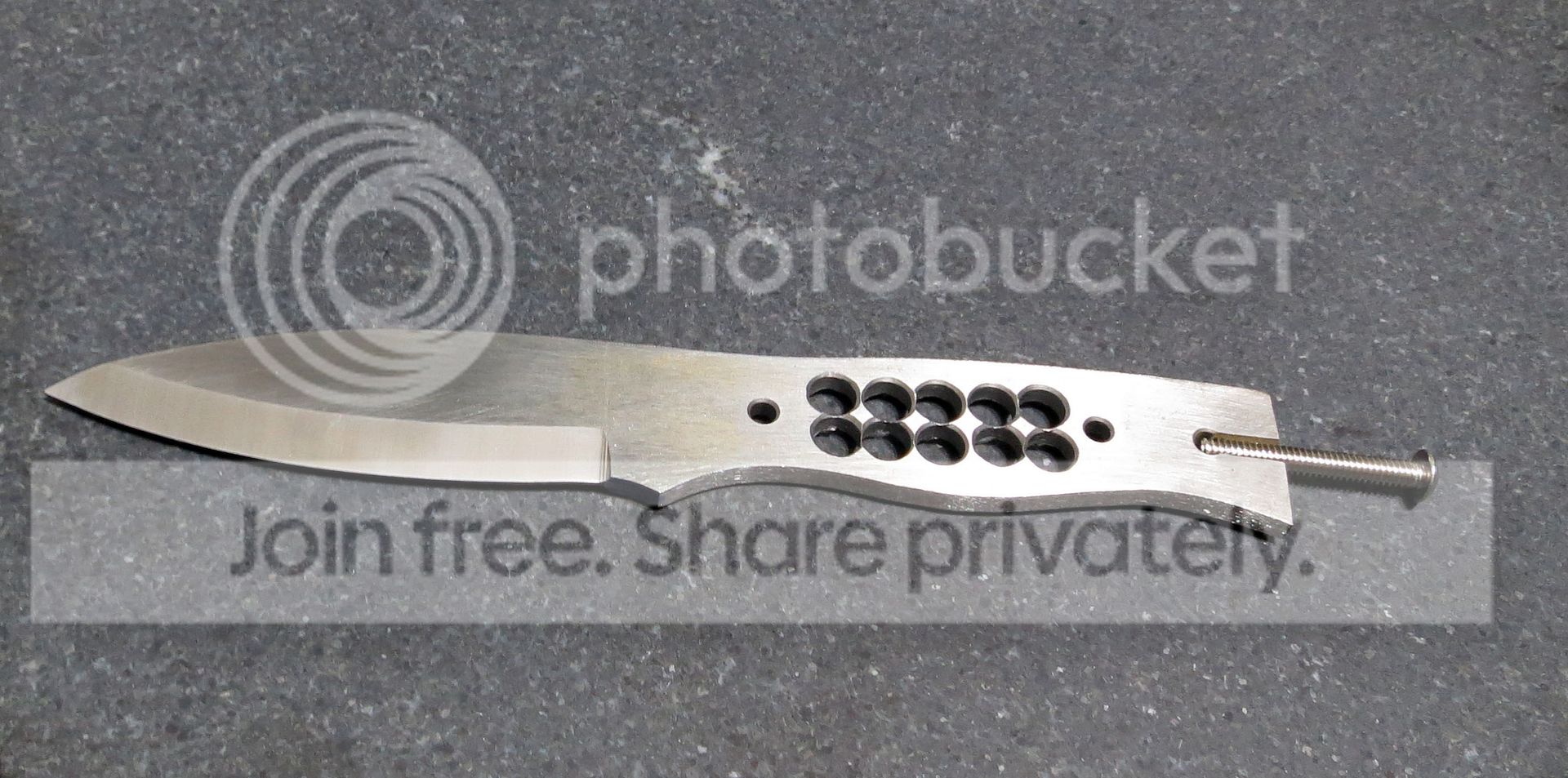

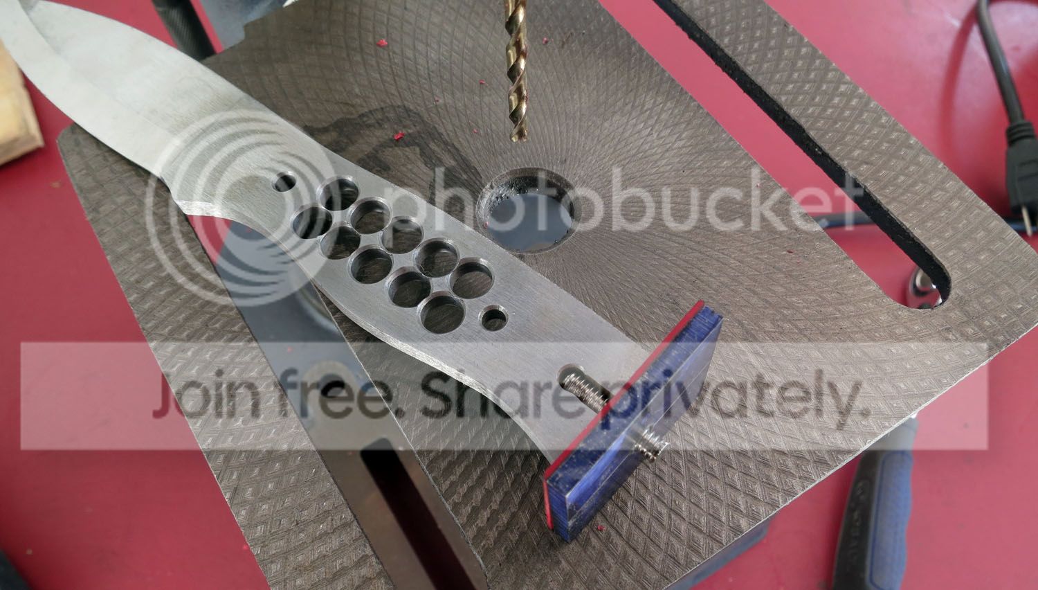

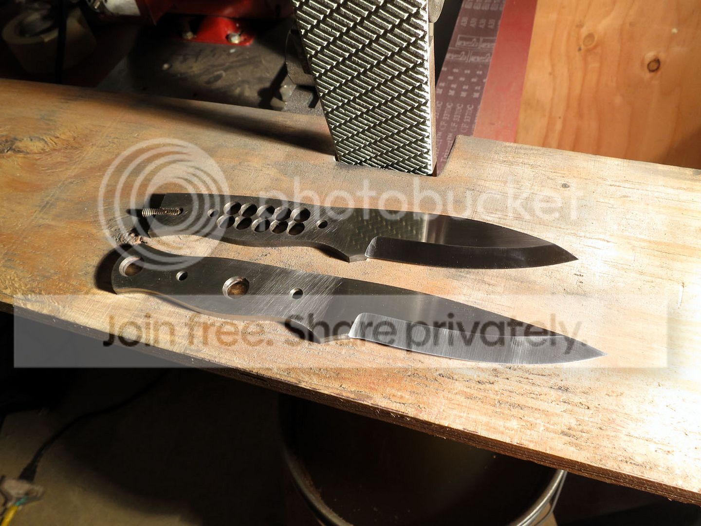

Holes drilled, choppers got some steel in the handles removed.
Also cut more blanks for a stick tang carving knife.
Wasn't sure how these two designs I came up with would turn out, but boy I'm stoked on them now that they are starting to come to life.

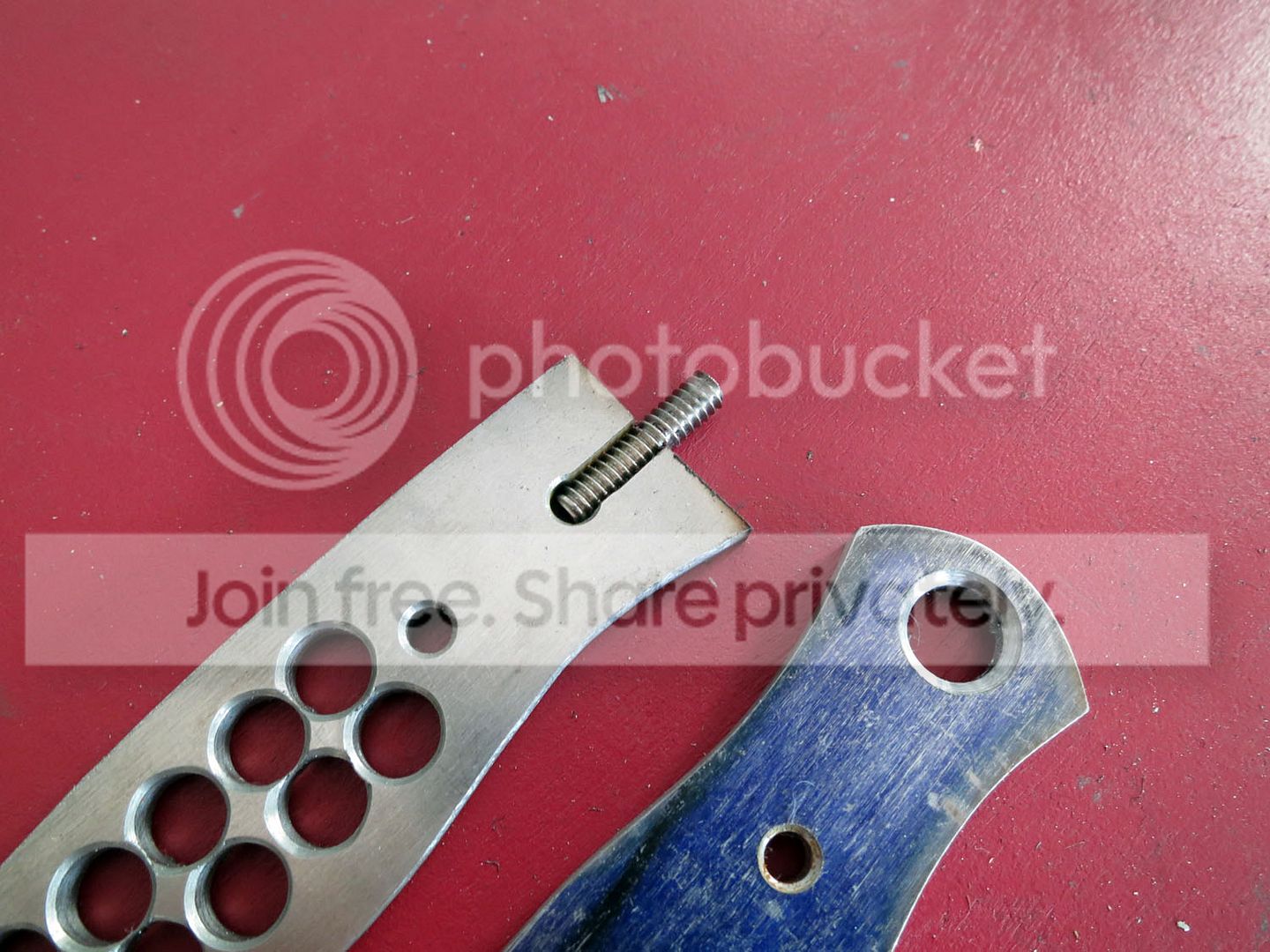

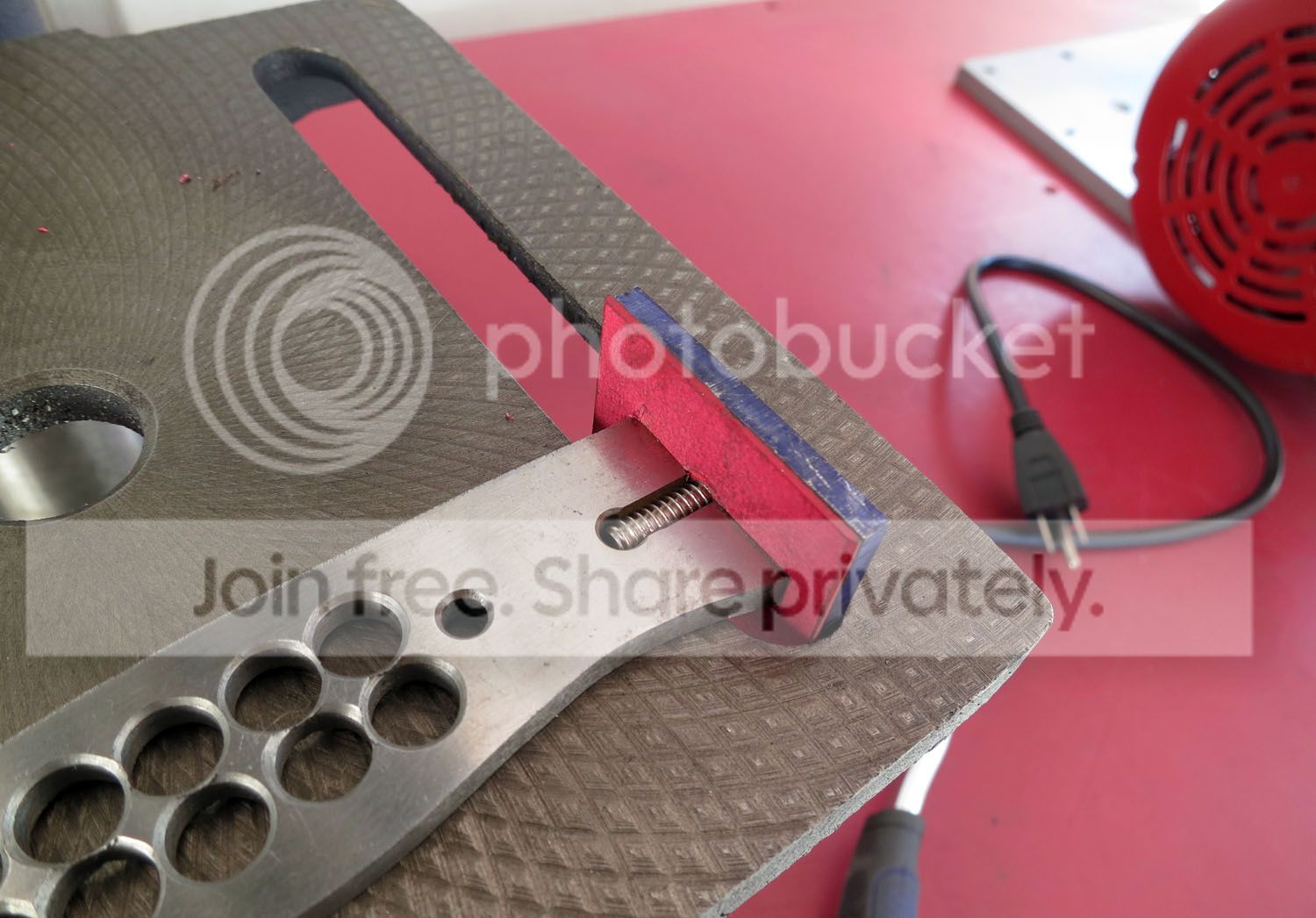

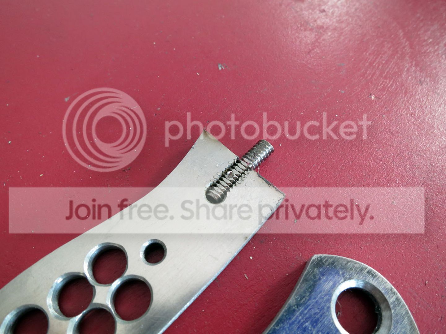

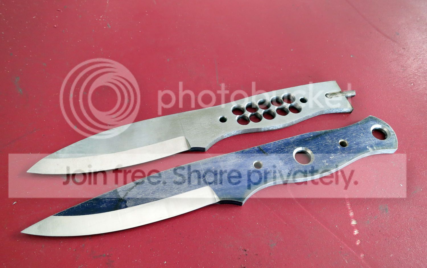

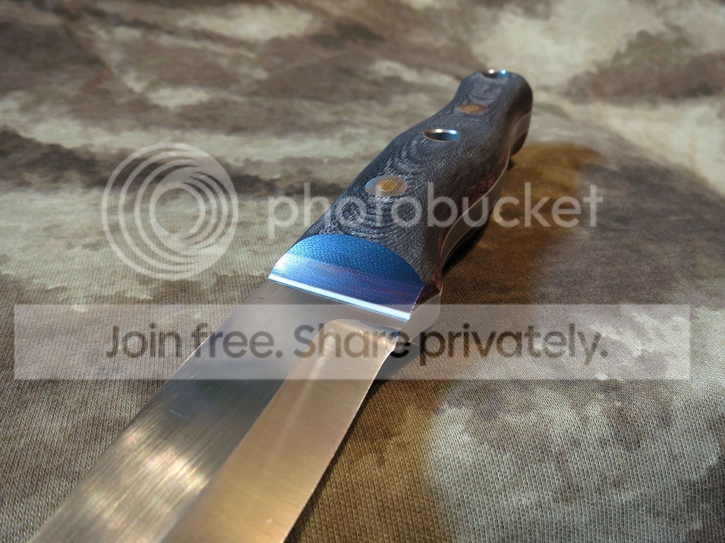

I got the threaded screw ready for action on this specific knife.
Had a HELL of a time fitting up the pommel plate. Learned lots of things on this one. What a headache.

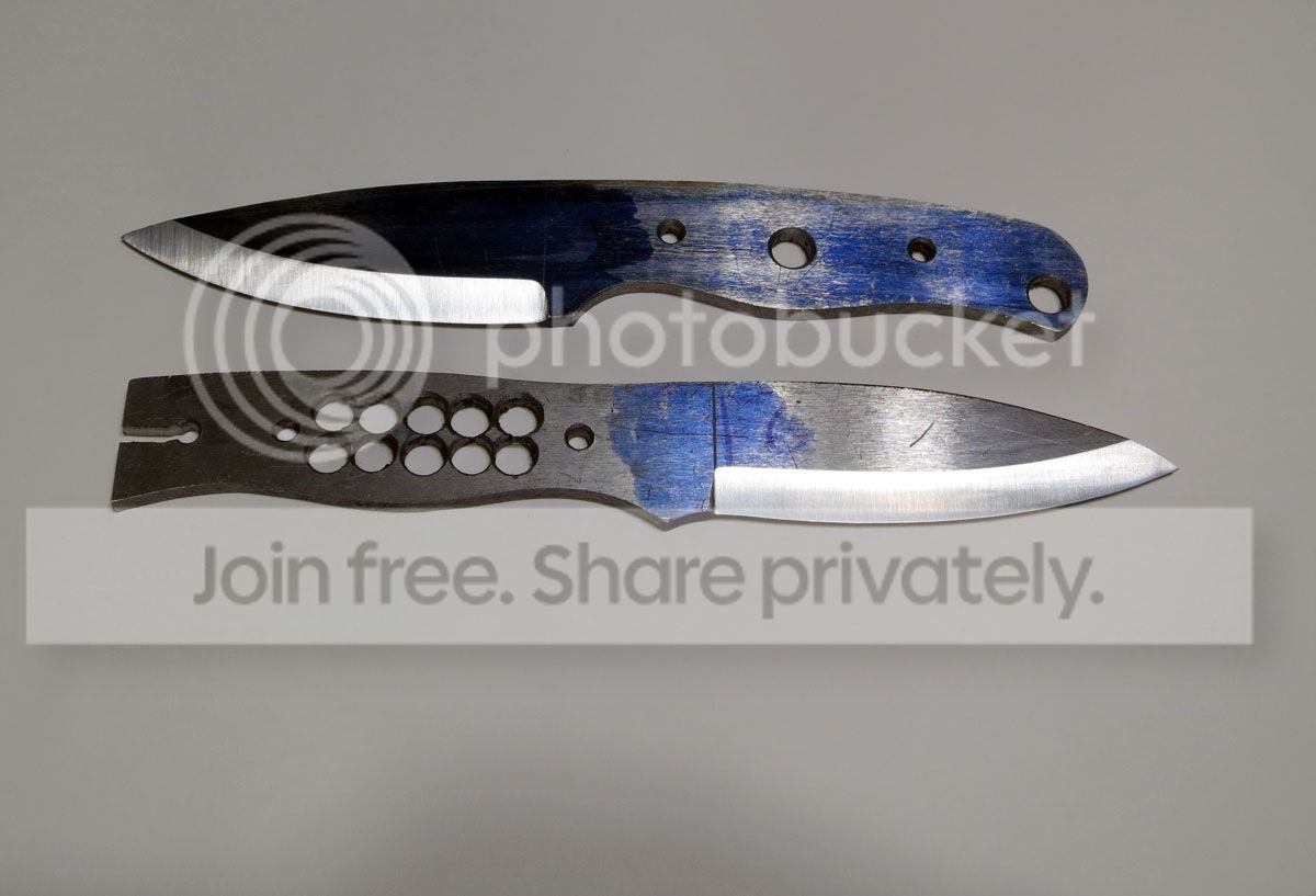

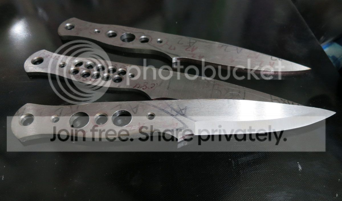

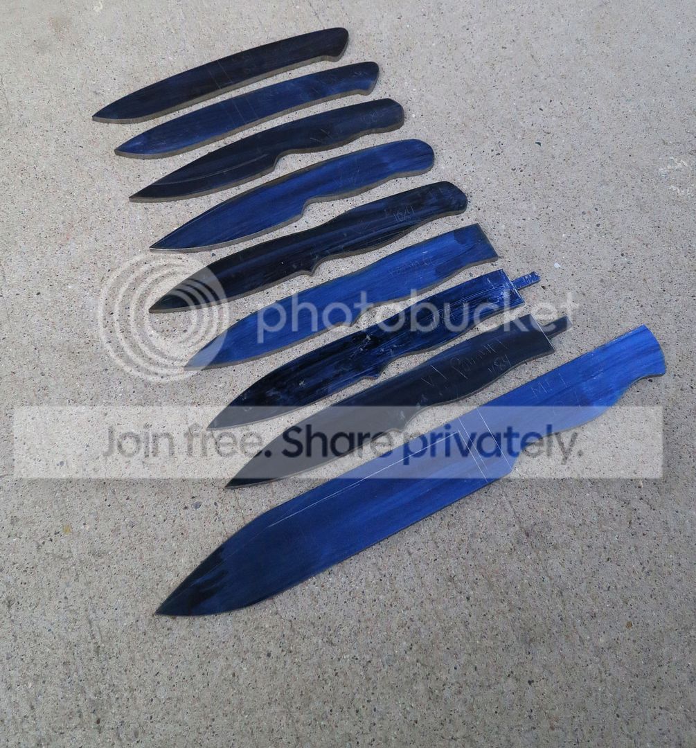

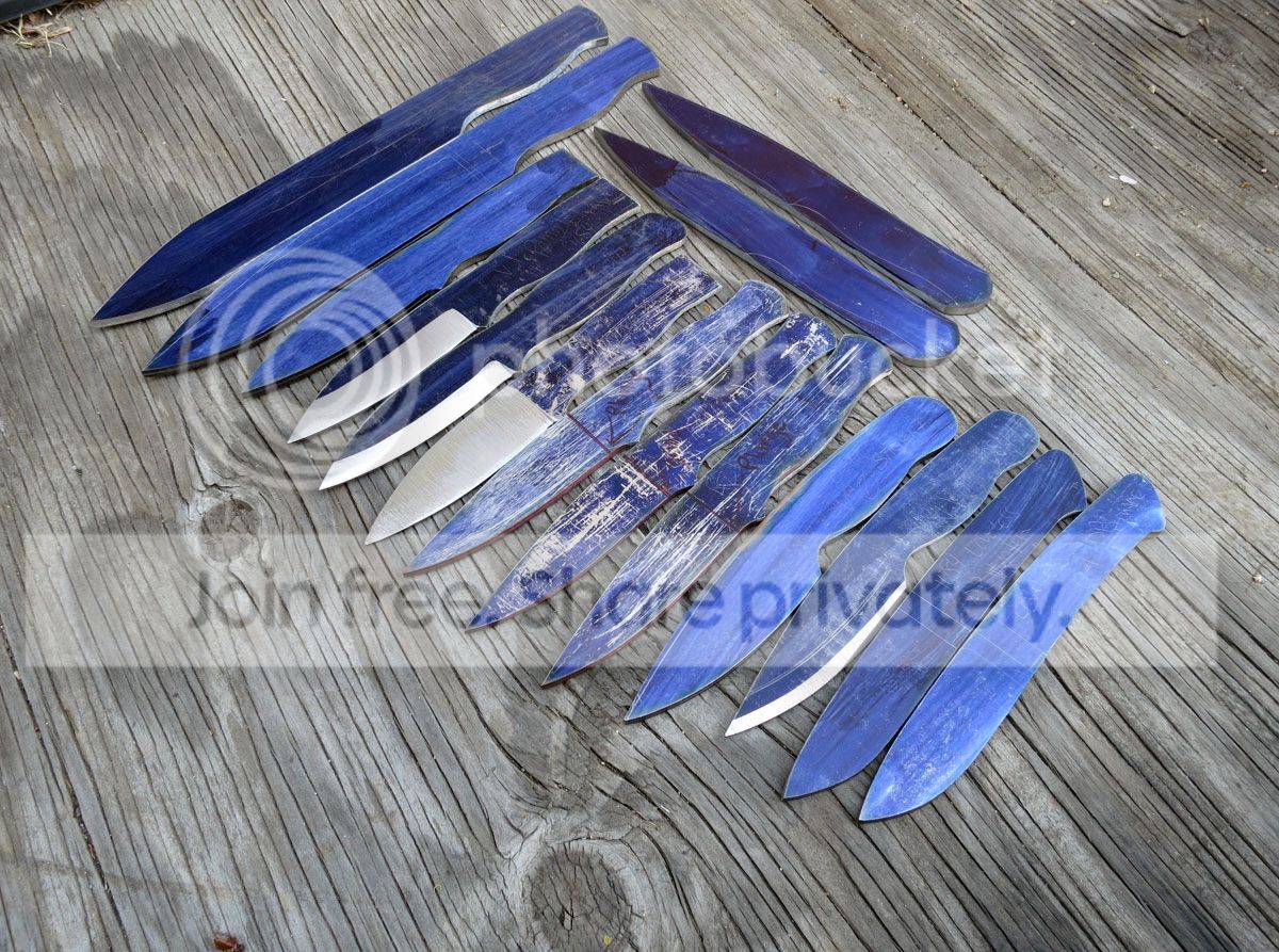

Small update for today. I picked up my blades from Tru Grit today- 2 days for HT is awesome- especially when they are within driving distance. Can't say enough good things about these folks. I've been there twice- once to drop off and another to pick up. Both times everyone was very friendly and let me sit and chat for 2-3 hours. Talking about other hobbies, old injuries, etc. Real stand up people! I've spent considerable amounts of times conversing via phone as well.
Here we have the blades. The ones with a nice clean bluish hue were HT with foil. A2 steel- I like the results a lot. This will save a lot of time on cleanup and worth the extra $2 per blade.

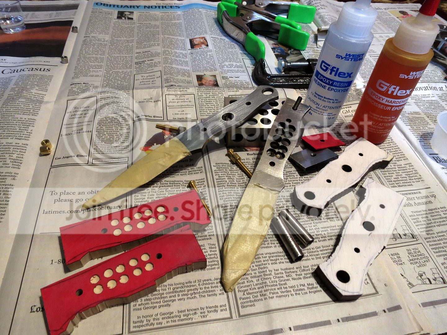

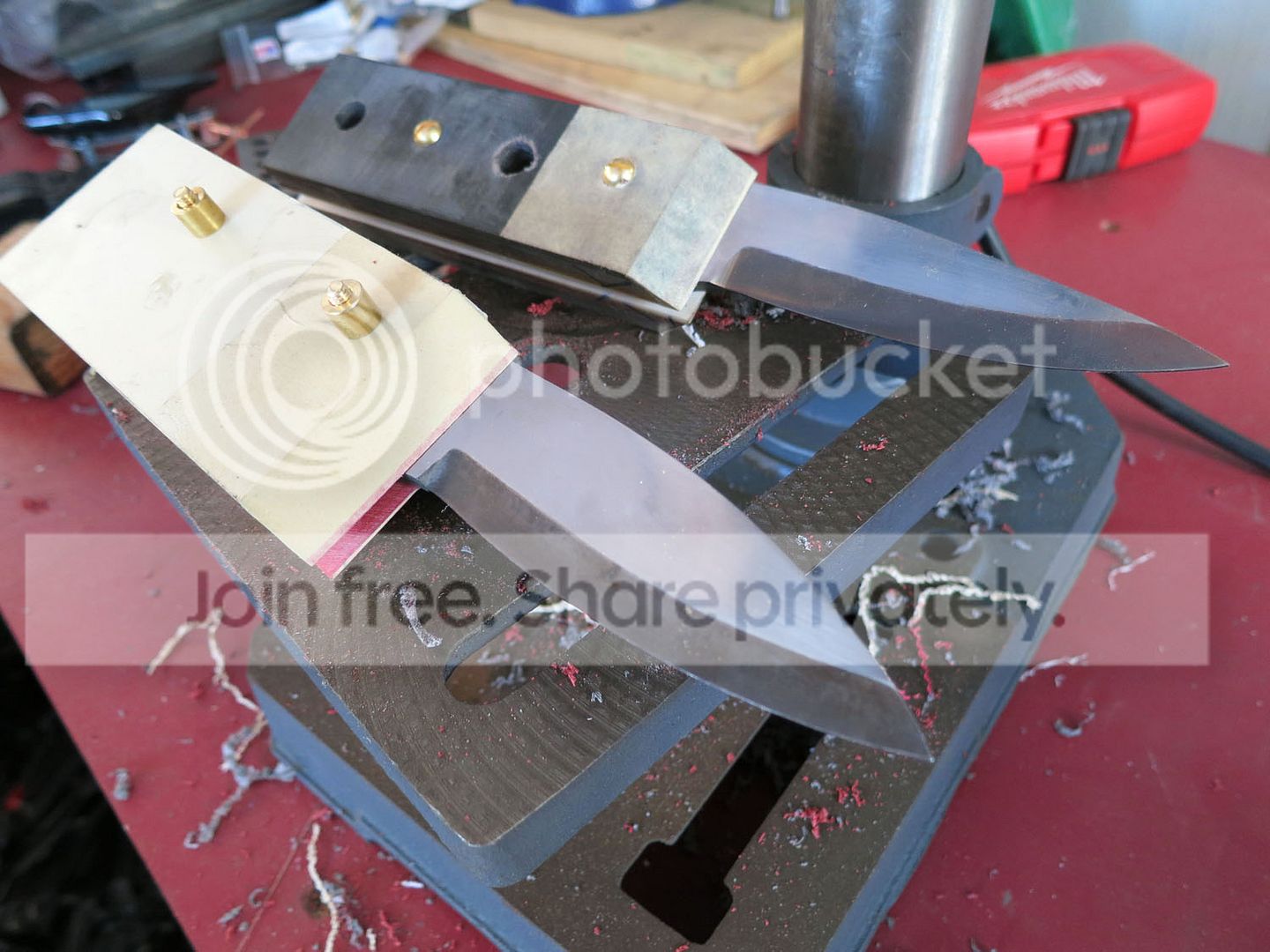

Drilled out holes for Loveless bolts and pins.
Handle material.
Toxic green liner with green canvas micarta, white and maroon liners with Black linen micarta, red linder with Ivory paper micarta
Drilling out handles a little the give epoxy a bit more of a lock in.

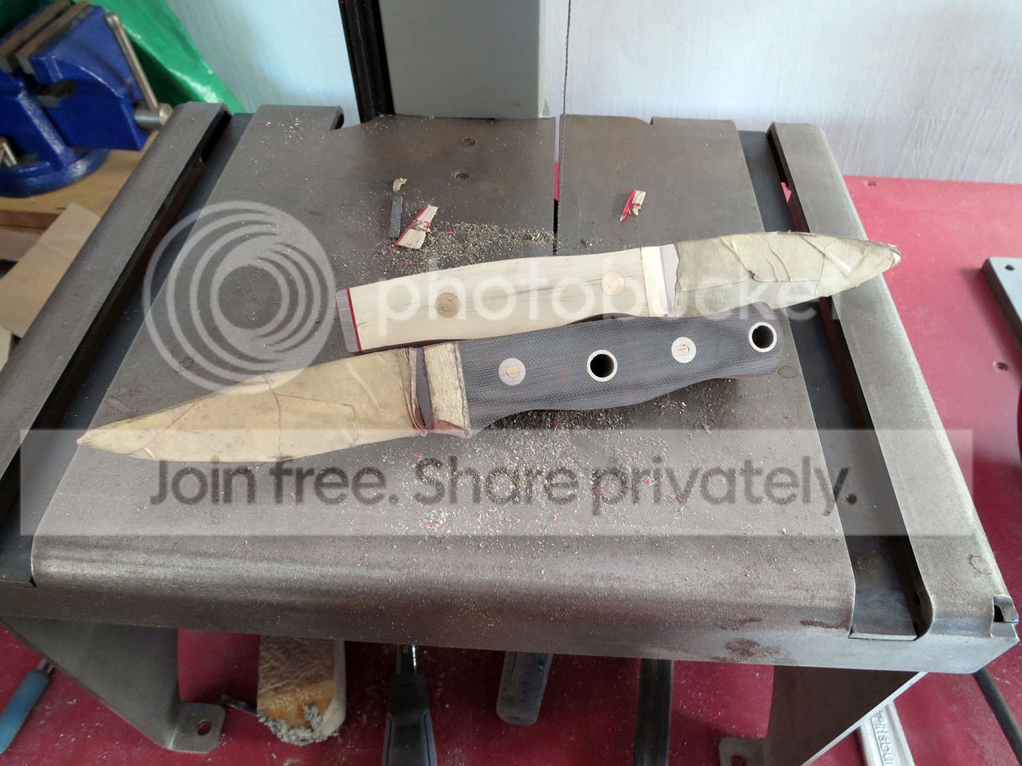

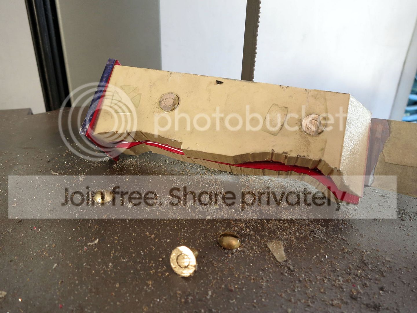

Sawing scale closer to actual size, to save on grinding/sanding time.

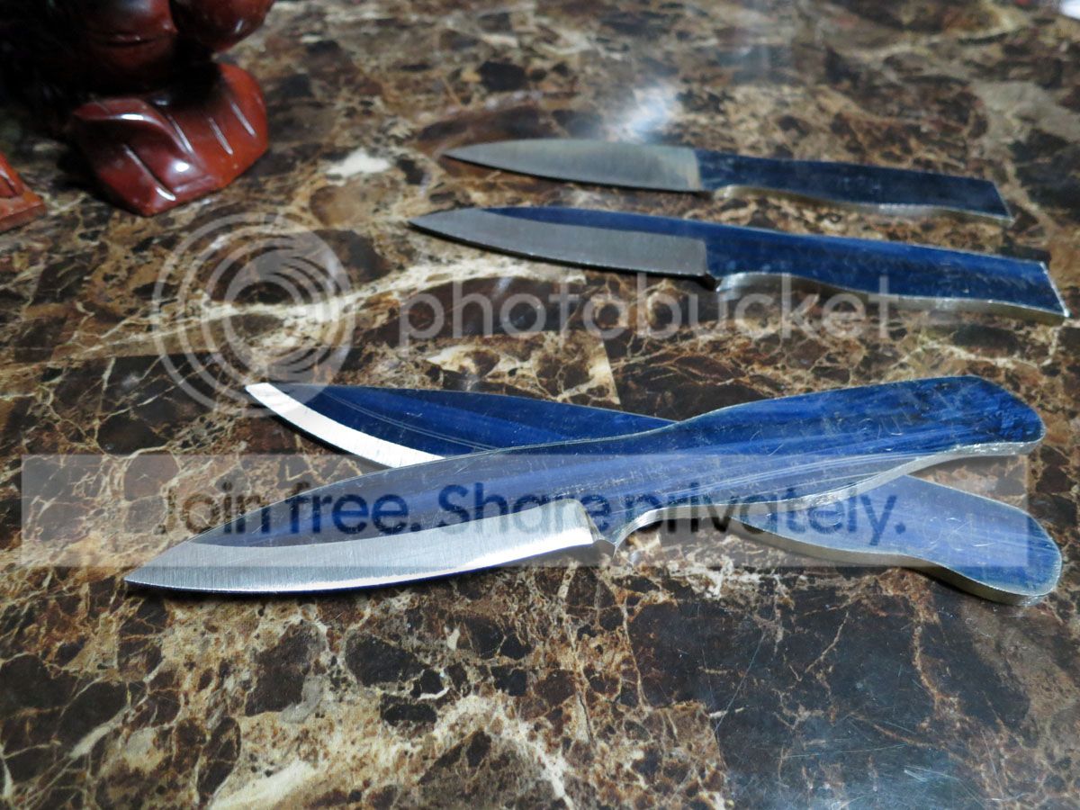

Final edge: I noticed the A2 was much easier to grind, quite noticeable in fact. Although the hardness is the same on both the A2 and O1. I wonder why it's such a noticeable difference.
Roughing up Loveless nuts and 3/8'' tube

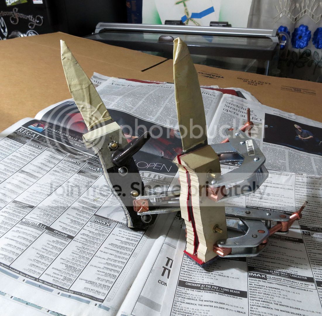

Setting up for gluing
Clamped and glued

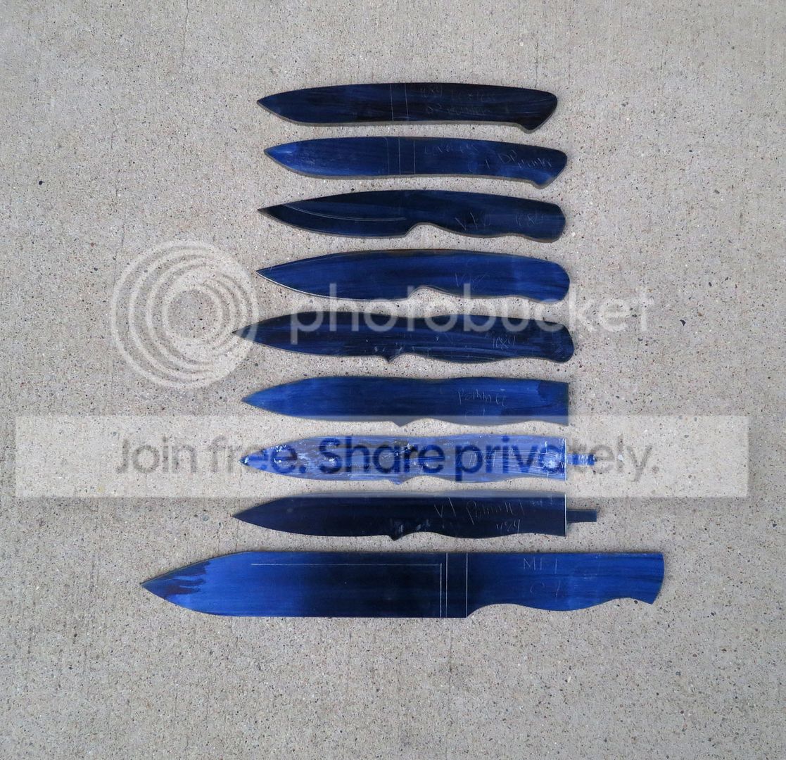

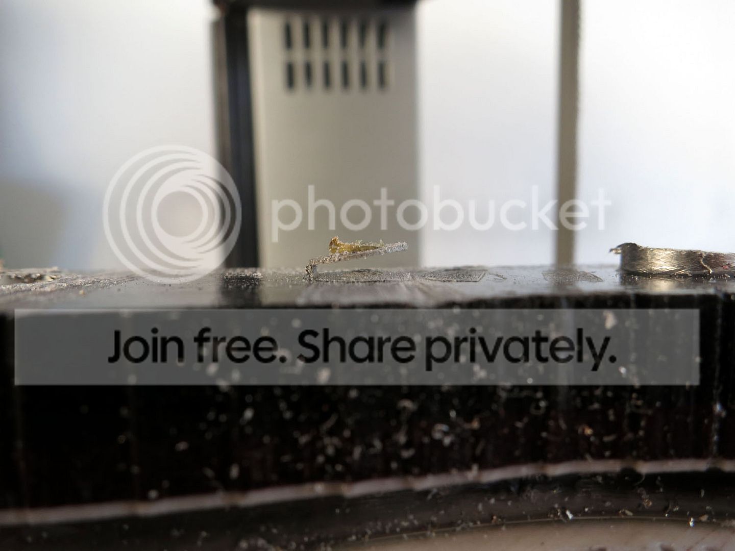

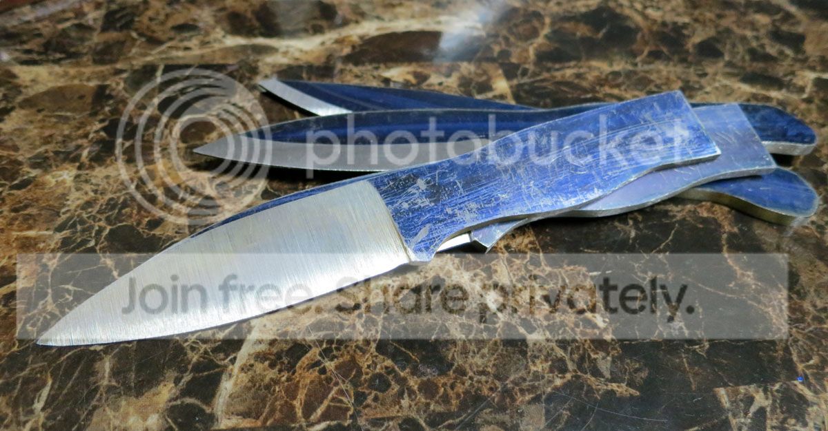

Hoping to finish these knives on Monday. I have been pleased with everything except the plunge lines. I struggled A LOT with plunges on all 15+ blanks, none of them look half decent. More like a baboon did it while being blind folded and drunk. I know good plunges will come with time- but aside from that, these are looking good so far. Especially for my very first knives.
Another issue is with the steel becoming magnetic, so a demagnetizer is in order when I return from my trip.
Yes, they'll get better. But, if you're like me, you'll always find something that needs improving.
Most impressed with your progress. Well done! :thumbup:
I agree, I want to make the best knife I possibly can.
Thank you. It's been slow going, aside from the wonky plunge issue, I've been happy with the results so far.
Looking good.
As for your plunge cuts...over hang your belt about 1/8" on the side of the platen. Do not start at the where you want the plunge....start 1/4" ahead of it and then back up into it....Be sure to pre- bend the edge of the belt over the platen.
If you are using a work rest...Leave a flat area on the spine long enough for the blade to ride on. That way it is in the same position on both sides of the plunge. Once you get the plunges set...you can then shape that flat area any way you want. But that long flat area really aids in stetting a nice plunge when using a work rest.
Looking good.
Thanks.
I'll give that a shot, I was just thinking my belts could be a little too stiff as well. It occurred to me a short while ago, that I've got some JFlex belts.
I've been using a jig on these, getting a smooth transition from the plunge start into the actual edge has been the problem. I can get my plunges to start in the same spot on both side, but one or both sometimes end up looking squared. My further attempts to smooth them out, leaves me with wonky transitions. Seems like more practice is my only answer to this. Also paying more attention. :D

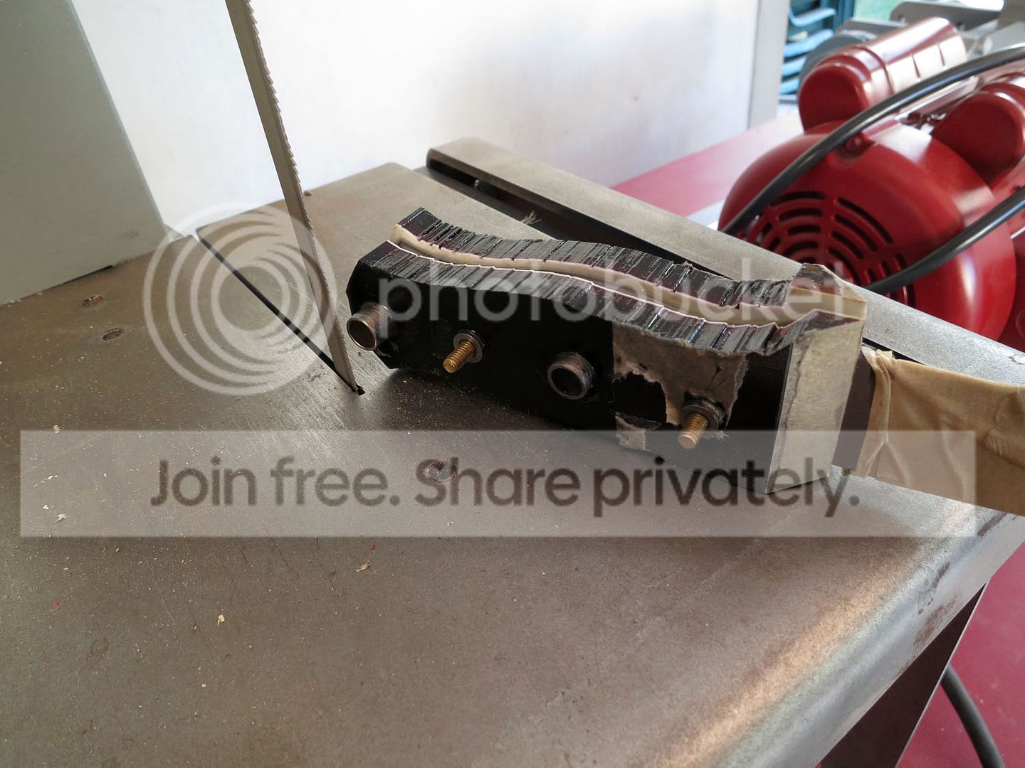

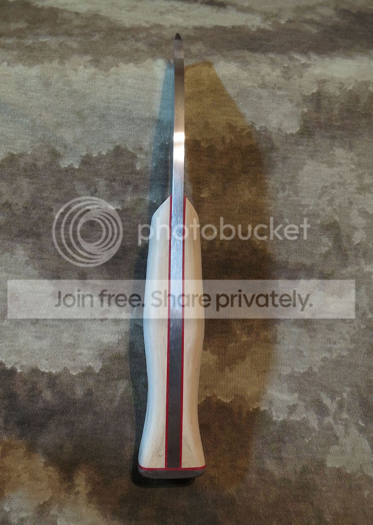

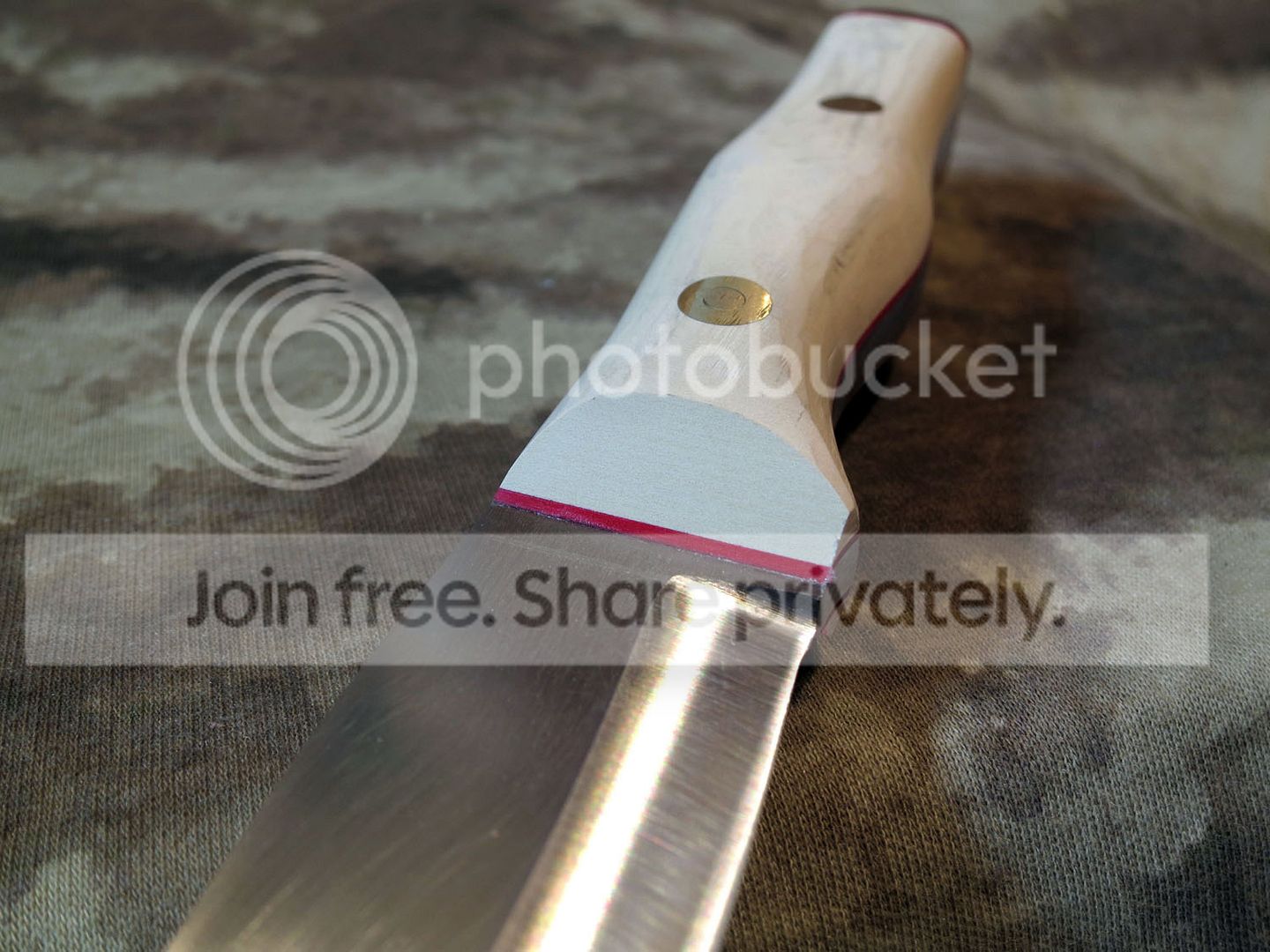

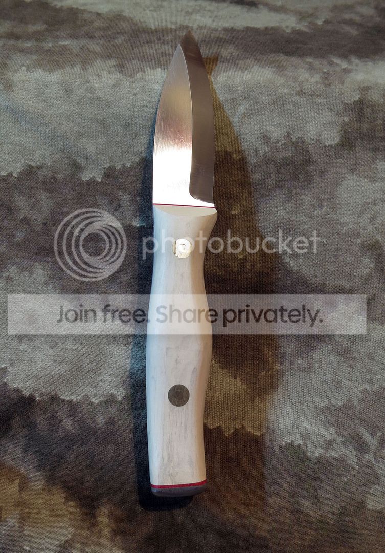

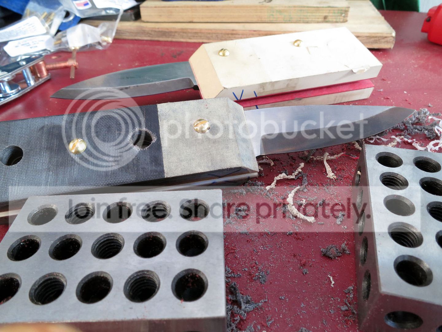

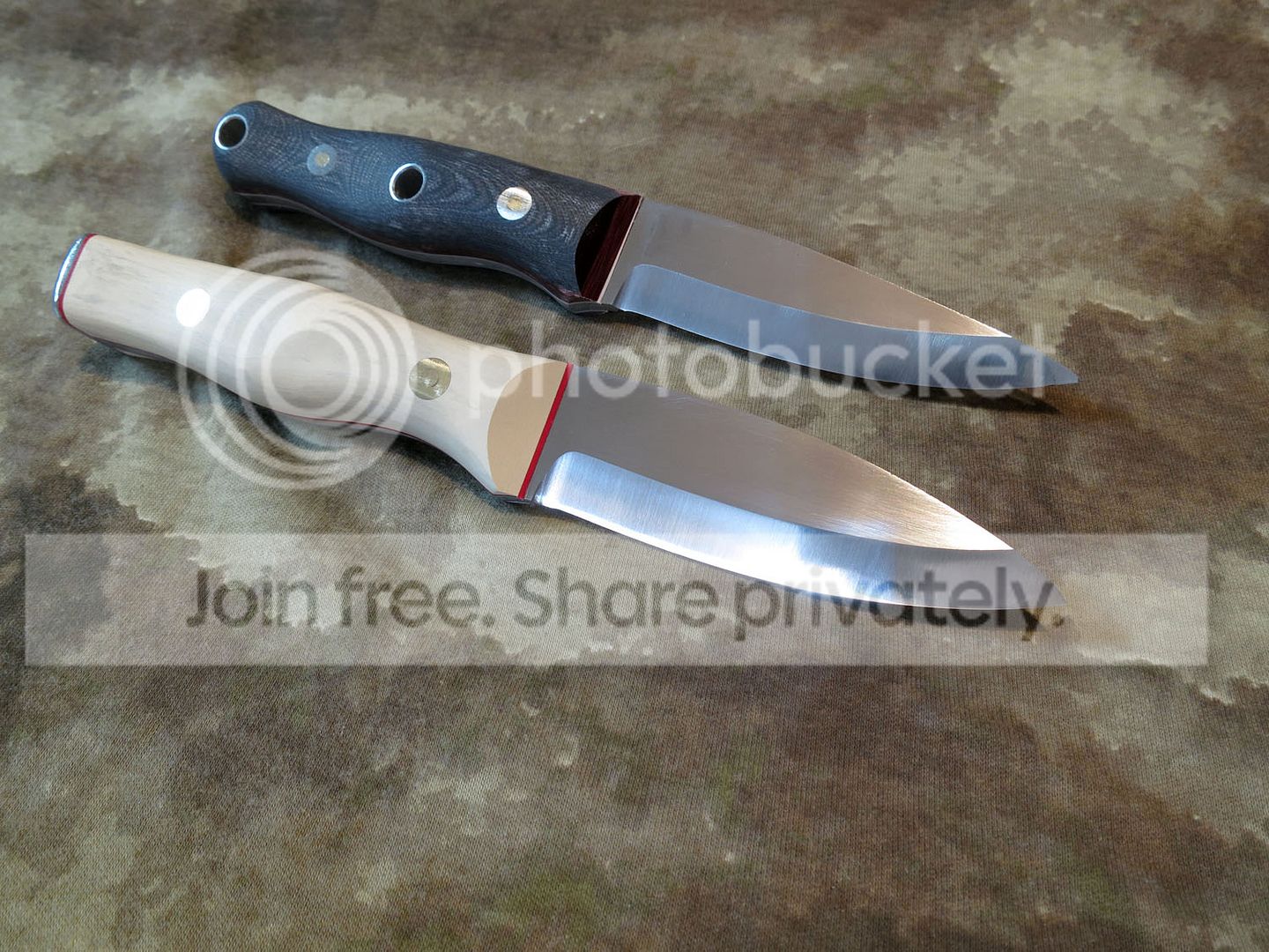

Blades are pretty much done. I left the handle rough shaped, wanted to use them first to make sure it's what I want before final finishing.
Glue dried up.

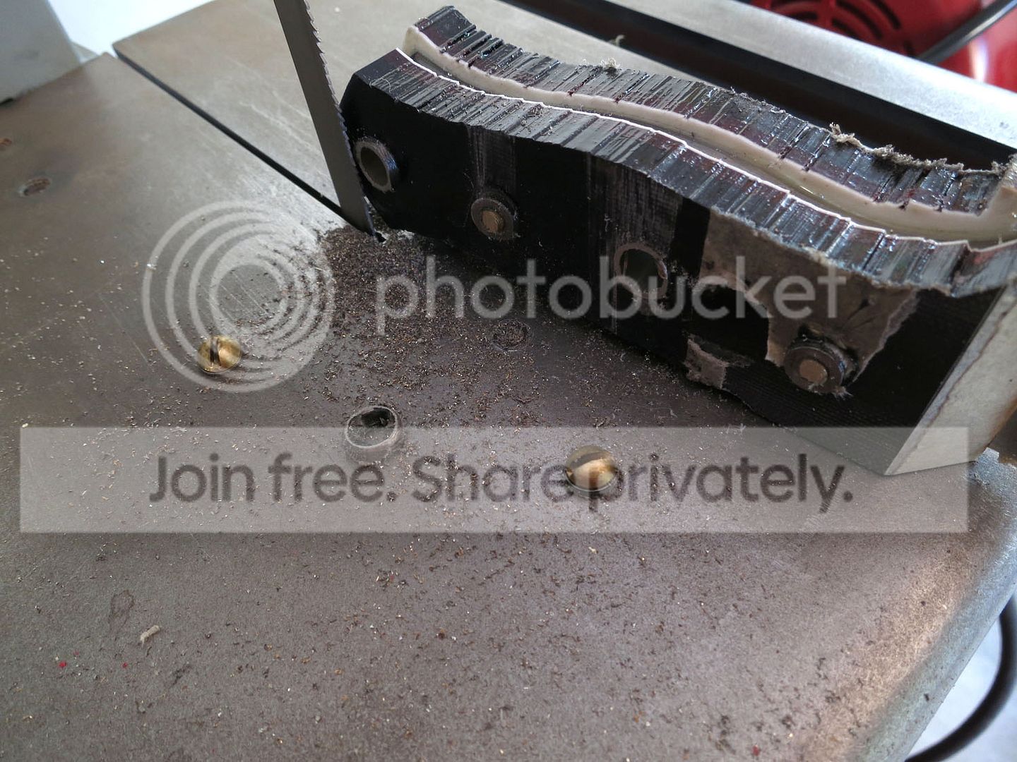

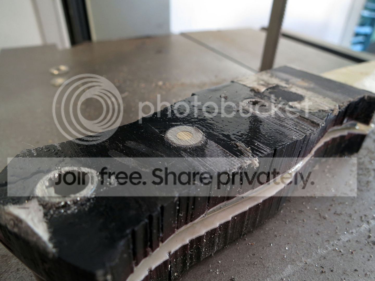

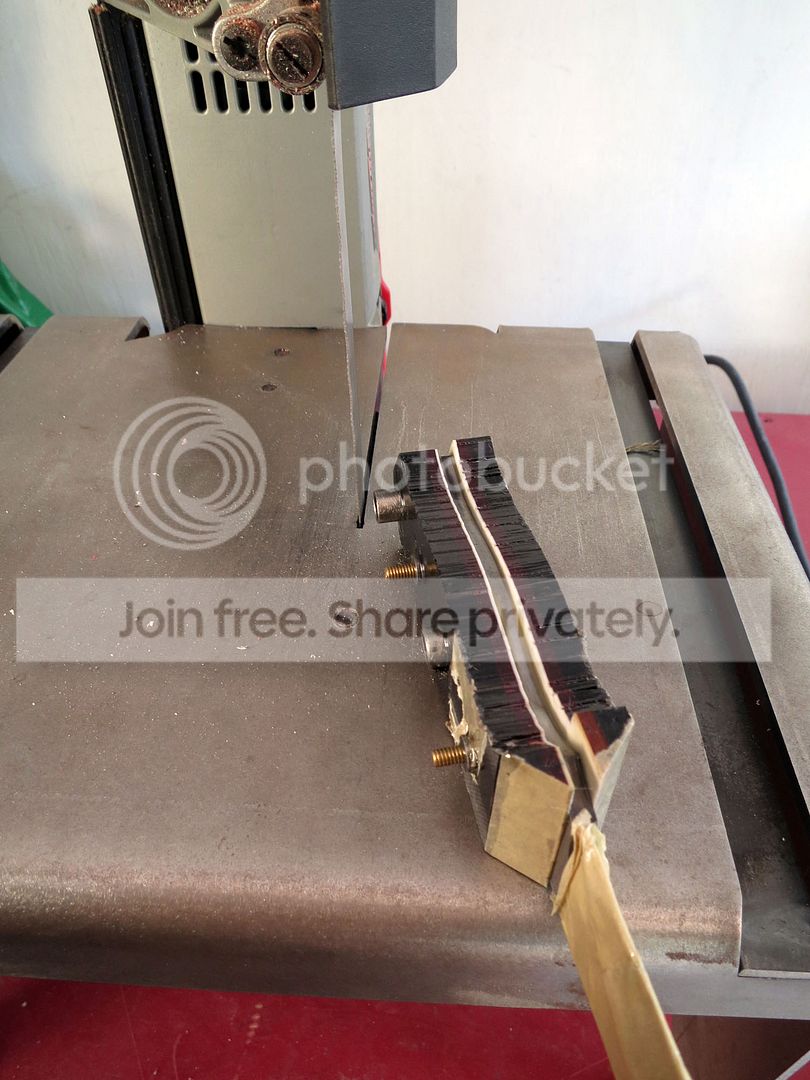

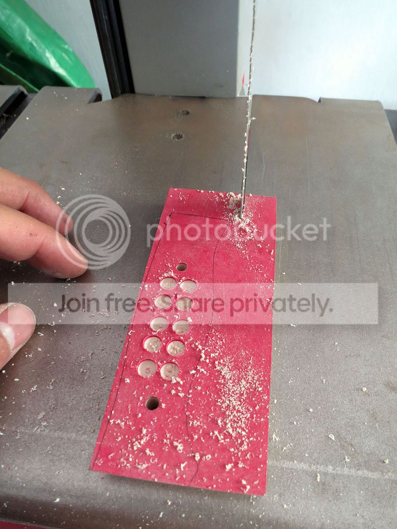

Cutting excess on the bandsaw to minimize generated heat from grinding
It's crazy just how thin this saw can cut!

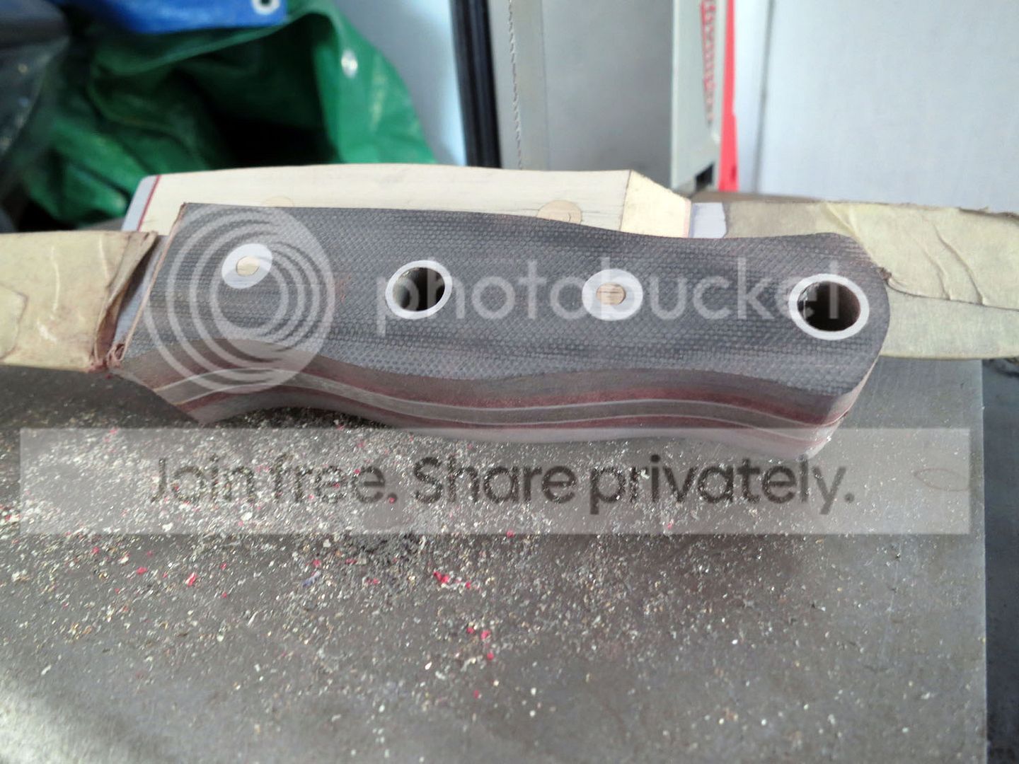

Sanded flat on the flat platen
Rough sanded
Top view
Bottom

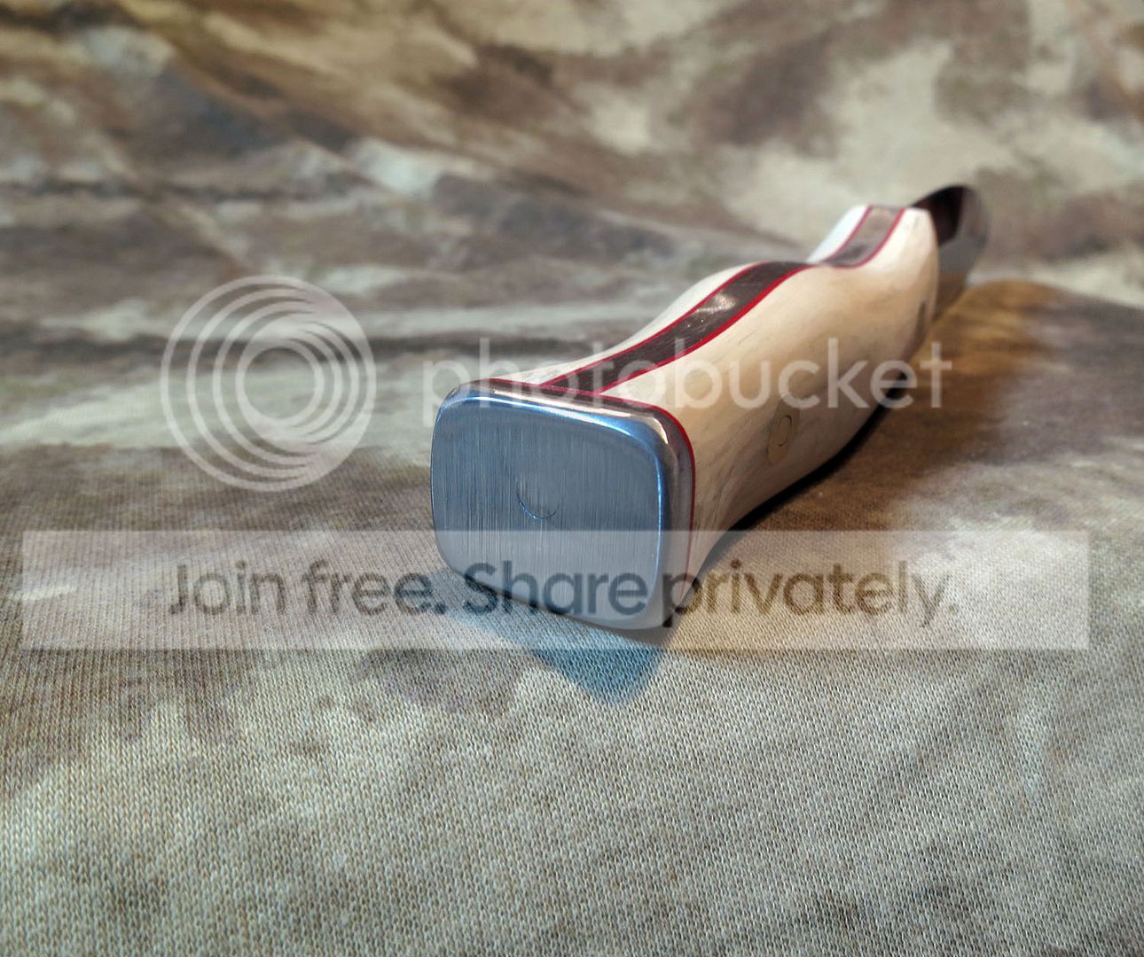

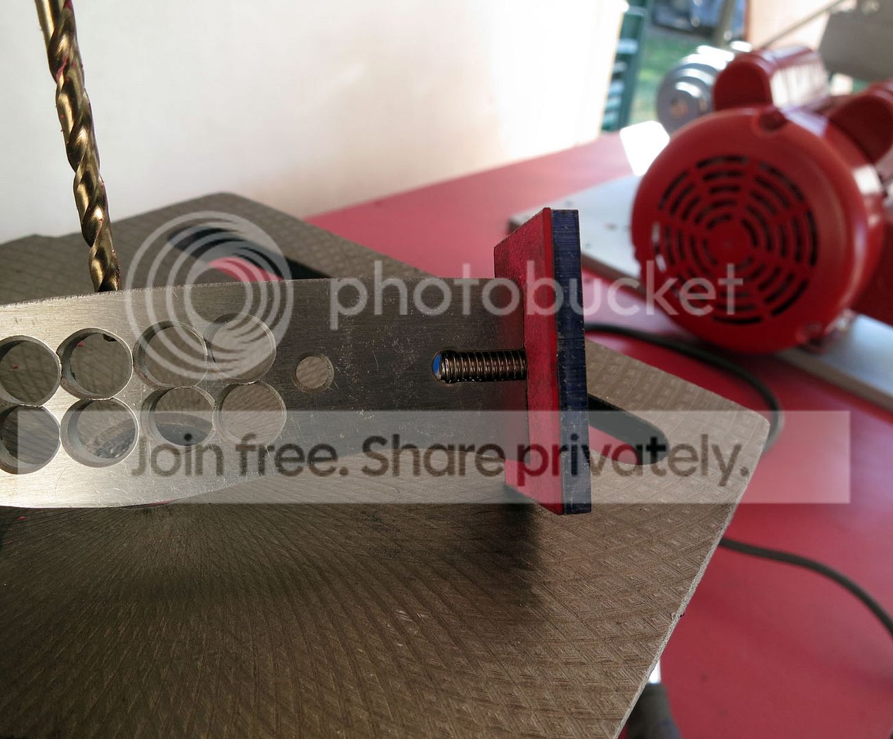

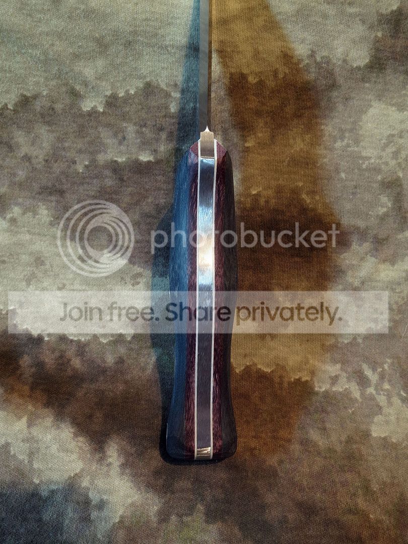

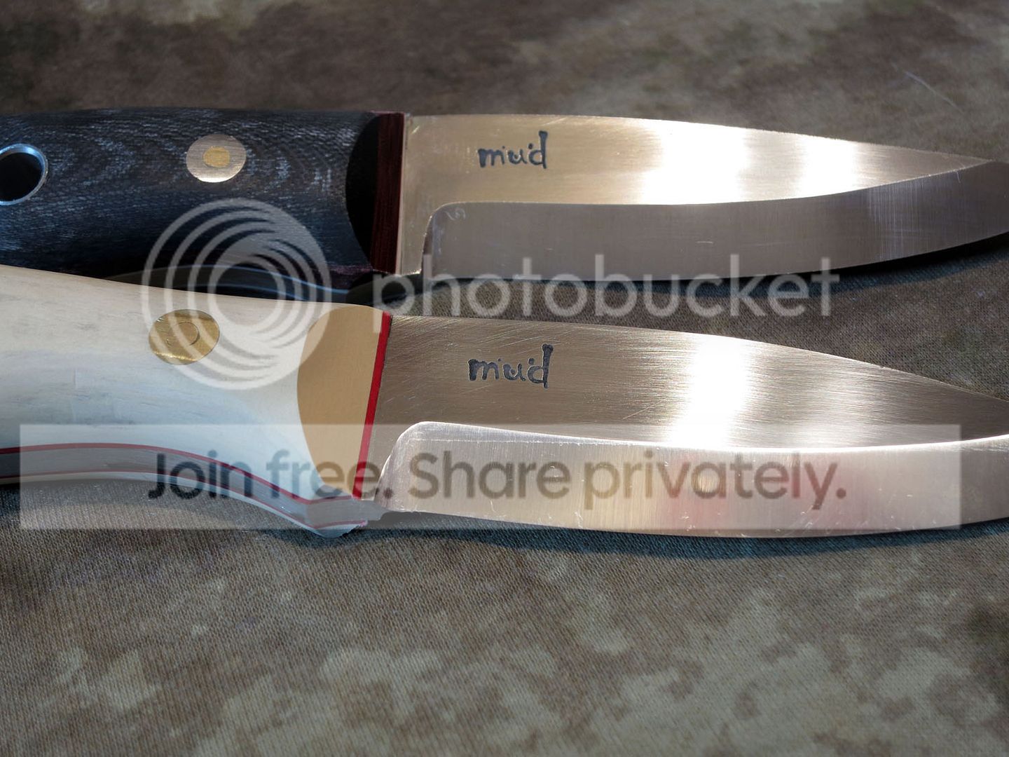

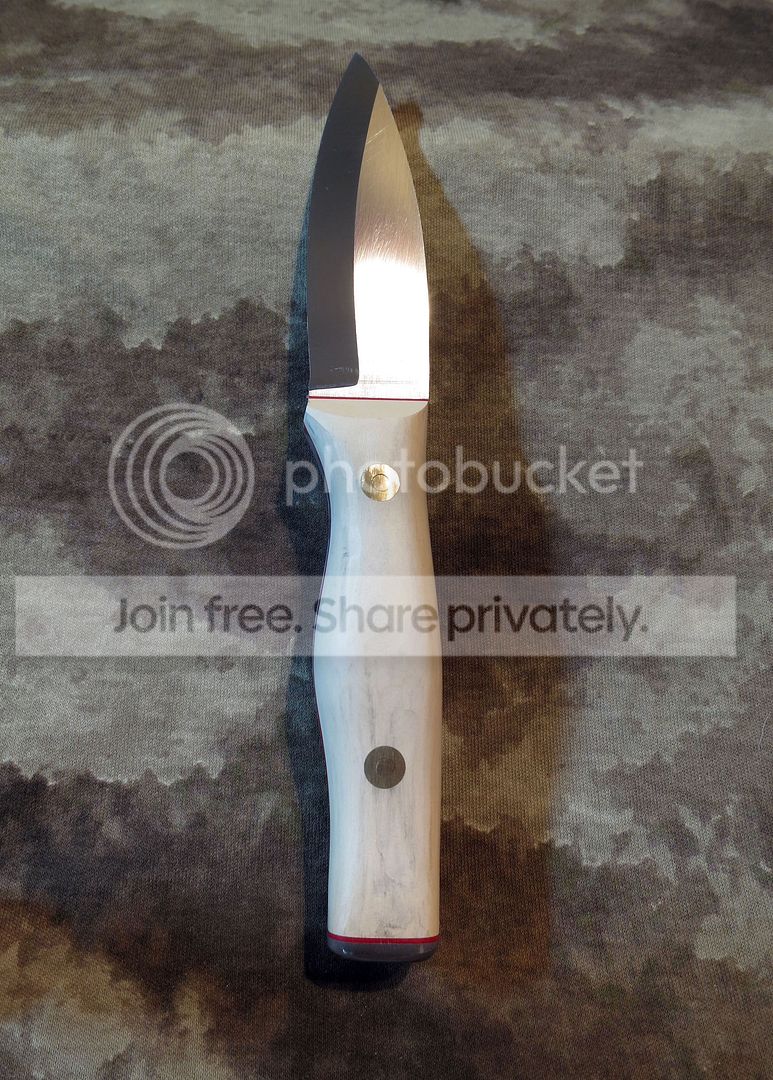

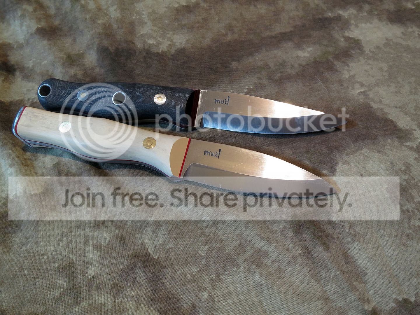

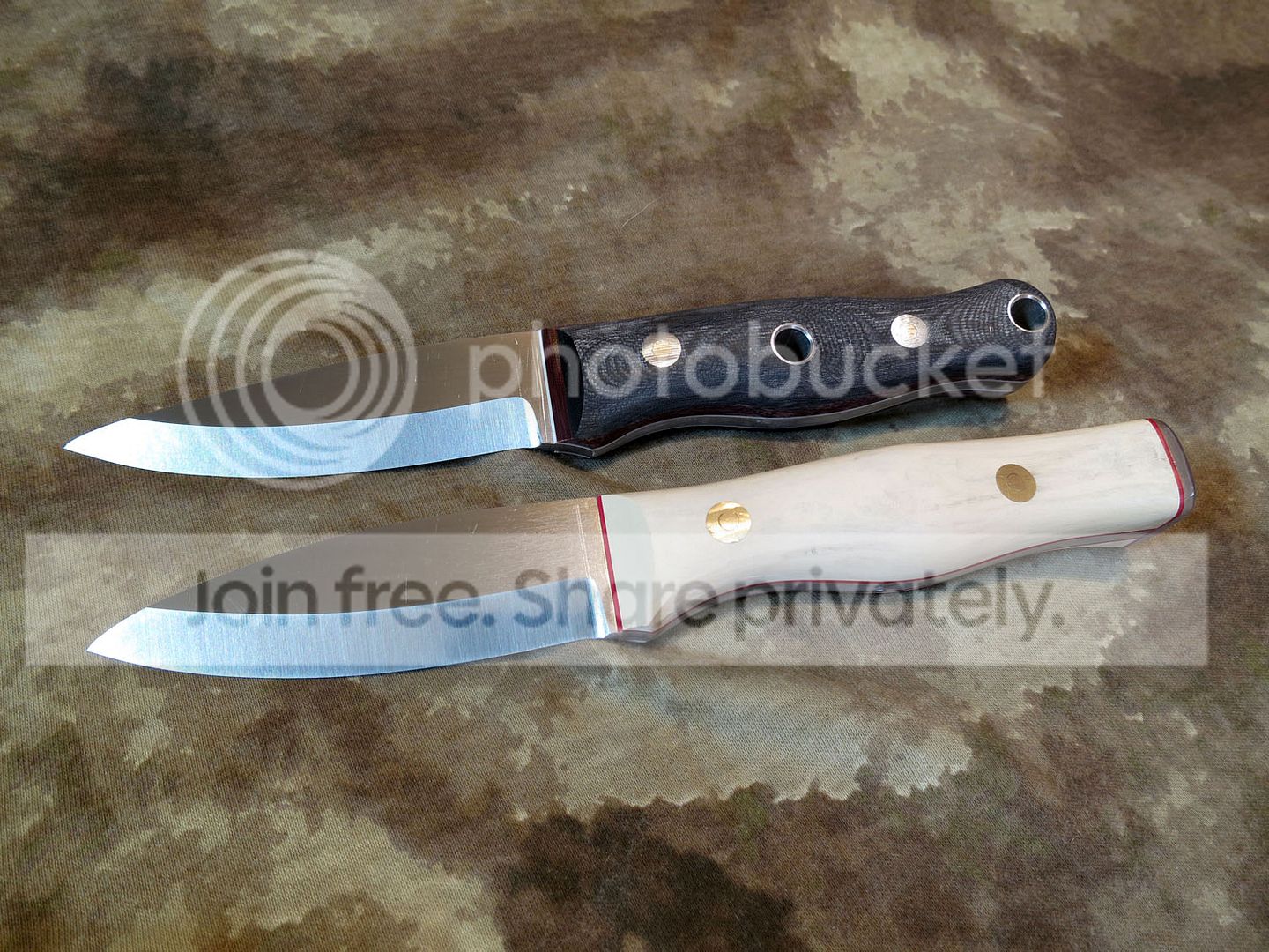

Pommel plate was attached via 10-24 stainless thread and G-Flex epoxy. Pommel itself is 416 stainless
Top View
Bottom

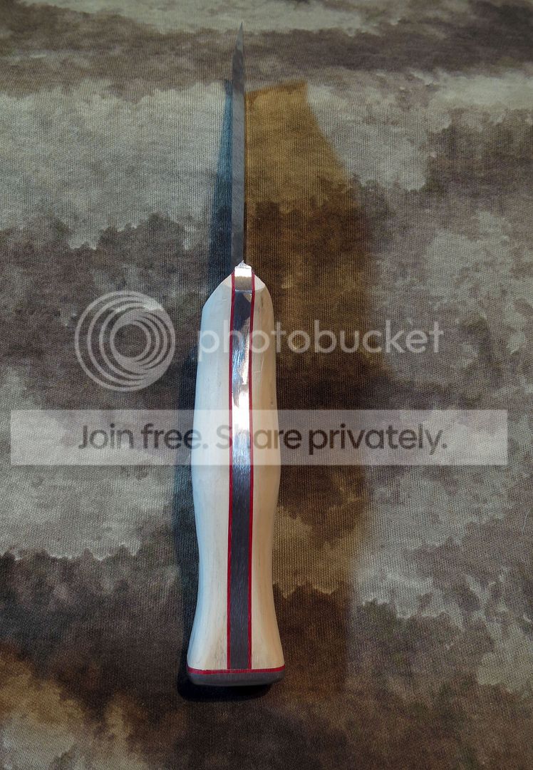

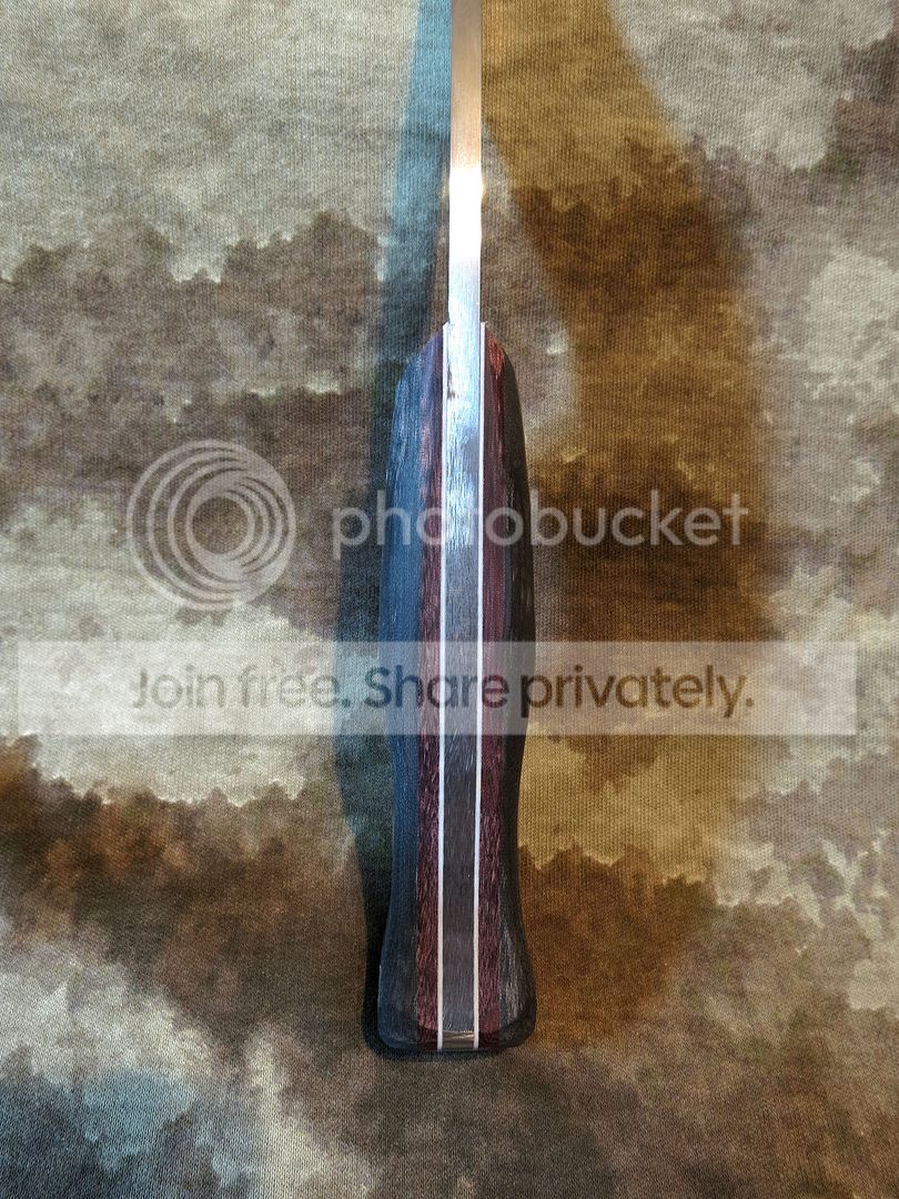

Black linen micarta, maroon micarta, white fiber liner
Paper ivory micarta, red fiber liner
Added my logo
