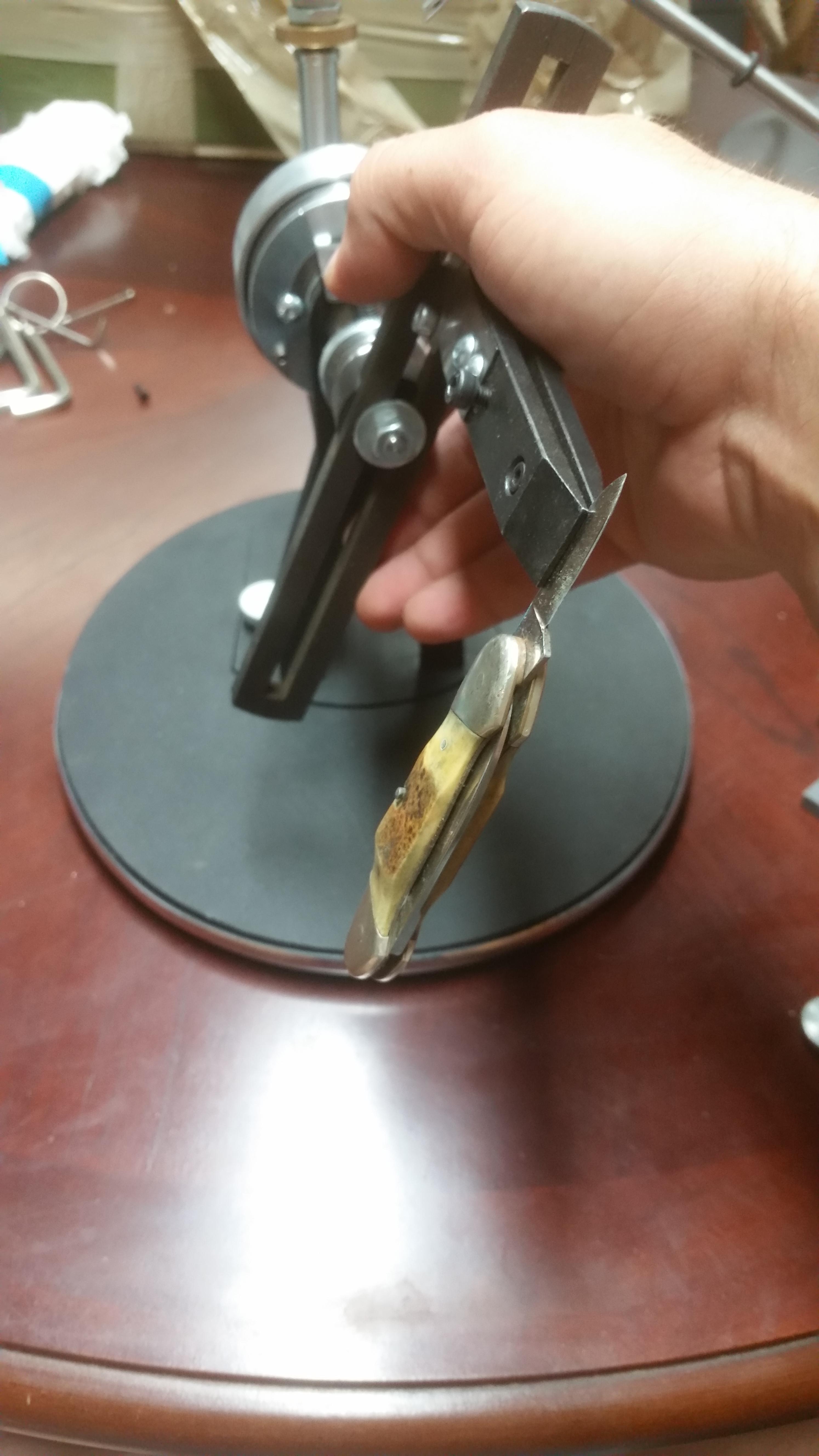

Thanks. How do you think it would work on a trapper or trapper jr? i tried a wicked edge on the trapper but there wasn't enough of the blade sticking above the clamp for the paddles to miss the clamp.
Could you post a photo and what angle you were shooting for?

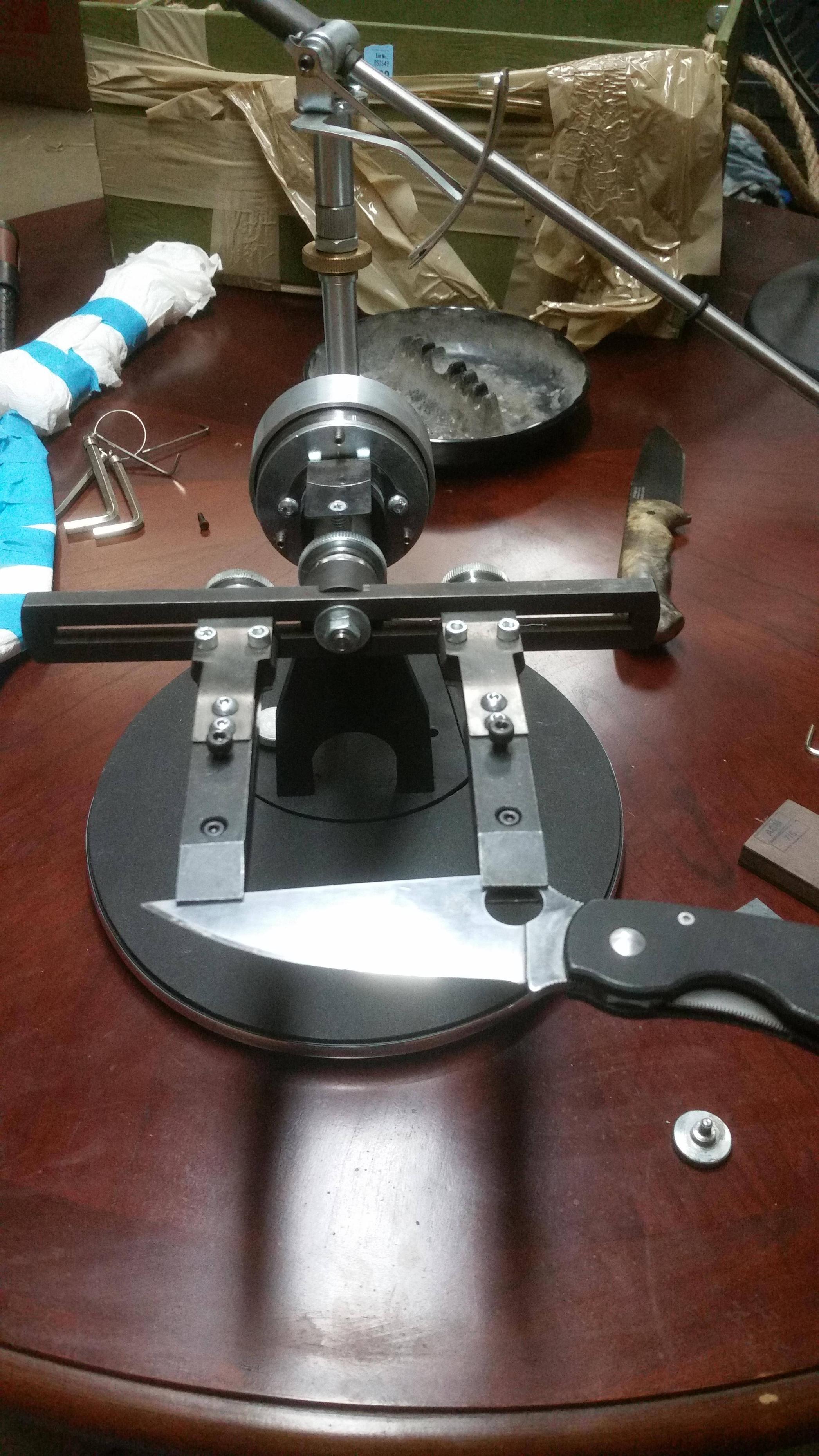

With the K02 and low angle clamps I could sharpen this little blade at 15 degrees per side and could've squeezed another couple of degrees if I'd wanted:
Spyderco Military for size comparison. I can get that down below 10 dps easily:
Sorry I can't post pics. I didn't take any at the time, and I don't have the WE anymore. I want to say I was trying to get to 10 or 12 deg per side but can't remember, it's been a little while back. I ended up buying the tormek small knife atachment to try out, but it had the blade off center. I built my own "small knife attachment" that would allow you to center the knife up, but still wasn't satisfied with that. I would like to get around 10-12 deg per side
