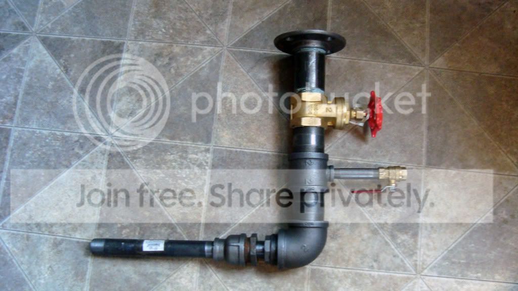

Sure.... the parts are yours... it's more than 4# but less than 20#. I can send you these exact parts on this forge blower I'm building.. They list can be modified if someone thinks anything different would be better. I had almost every part here left over from a job...It's a modified version of Indian George's burner and the burner Nathan(Silver Pilate) got from Hightemptools(formerly Ellis).....with a Bladsmith inspired mixing chamber... I still have to add the needle valve....
1 2" floor flange, 3-2"x4"(ish) nipples, 1-2" ST 90, 1-2"x1/2" tee, 2-2"x1" bell reducers, 1-2"x1"bushing,1-1"xclose nipple,1-1"x10" nipple.
I might not get it fired for the first time this week... Maybe next. So.... I don't know from experience if it will work well... I assume it will... Anybody with a blown forge that would change what I did before I ship Unky the parts?
Here's my built burner...

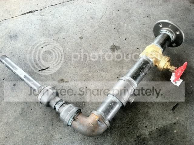

So I got the package from Brian today, and quickly screwed it together. Nothing is tight yet This is just my way of keeping the parts together till it is permanently assembled.
Next will be getting the propane fittings and the blower attached so I can test fire it, and then its doing all the welding on the forge body. My next set of questions though are, is there any special type of pipe that I need to make the burner holder? Can it be anything strong enough to hold the burner, or are there things to stay away from, like galvanized pipe. Secondly gas supply, I am thinking I will just order the 0 - 17 PSI Propane Regulator/Assembly Kit from High Temperature Tools & Refractory, the 10' hose with pressure gauge one. Will I still need to get a needle valve as well, or will the regulator and shut off valve that Brian supplied do the job?
Like I said in the previous post I think I will be putting temperature controlled on hold for now and just go with temperature monitored. For the simple steels I will be working with for the next little bit I think I will be able to get by with that. If I venture into the more complex steels in the mean time I will just send them out.
Unky, I finished my forge up a couple weeks ago and used a very similar burner. You will defiantly want the needle valve for fins adjustment of the gas. As far as the tube to hold the burner, I just used 1-1/4" pipe as my 1" burner fit snug inside it. I wouldn't use galvanized. I used copper rather than a hose for gas supply...just seemed safer. By cranking mine way down I can idle at around 1300 degrees at 1/2 psi on the gauge. With minor adjustments of the air valve and needle valve I can hold my HT temps. Have been forging at 1-1/2 psi at around 1800 degrees. It seems to work fine just monitoring the temp. Just stand to the side when you light it.

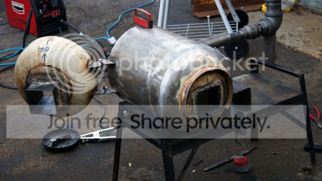

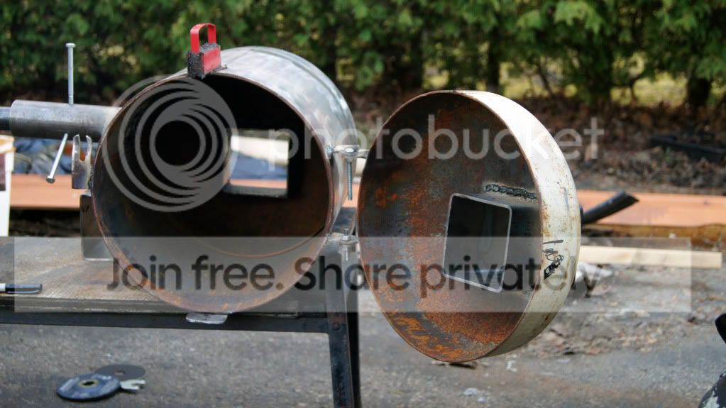

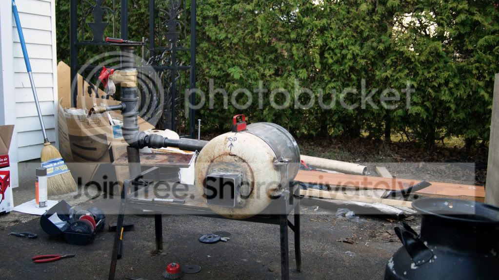

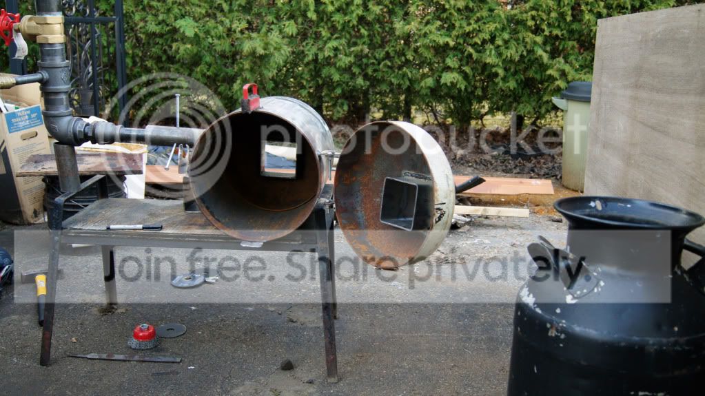

Its been a while since I have worked on this, life just kept piling other things up in front of it:o. Well today after attending my Aunt's funeral I had some spare time and a new wire feed welder so I went to work. My welding leaves a lot to be desired, but it holds so I guess that is a good thing. I have a few more supplies to pick up before I am finished welding, and I still need to get into Ottawa to pick up some ceramic wool so its not finished yet. I found a propane hose that may work for me, if I can find a few fittings to adapt it to the black pipe, and I still need to finish the door's latch, but this is what I got done today
I have an old Propane grill frame that I will be mounting it to, but I don't have it hear right now to measure up for the leg placement, and the little piece of pipe is just there to support the burner while it is on the makeshift stand.
Sweet!!!!
I'm(Greg's) hoping to have my forge up and running by Saturday. Looking forward to seeing it done!
That thing looks really good. Nice job on it.
A question about the pipe work for the blower unit. Why do you have it going up? Most of the other furnaces like this I have seen the blower and pipes going vertical like yours. The way I look at it is gravity works really well. If it isn't held in place tightly and almost perfectly vertically, it would probably try to fall over. Why not flip the pipe over so that it is already hanging down. That would eliminate the possibility of it falling over while everything is hot. Not trying to give you crap about it, just trying to understand why most I have seen are going up, not down.
The reasoning is that propane is heavier than air. If the pipe points down and you have a slight leak the gas will pool at the lowest point and risk being ignited when the motor is turned on.
That is how I understand it any how
