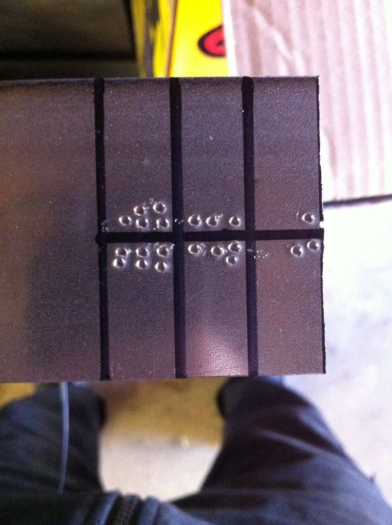

If you look at the following photograph I did something I haven’t done before and that is I punch marked my test pieces before I cut them up so that I would know what parts of what pieces were adjacent to what other pieces. This way I hoped I could possibly determine if I was dealing with soft spots on the bar of steel that overlapped adjacent test pieces. This way I was hoping that it would tell me if my problem was with my test pieces and the way they were treated or if my problem was with the steel and soft spots within the bar.

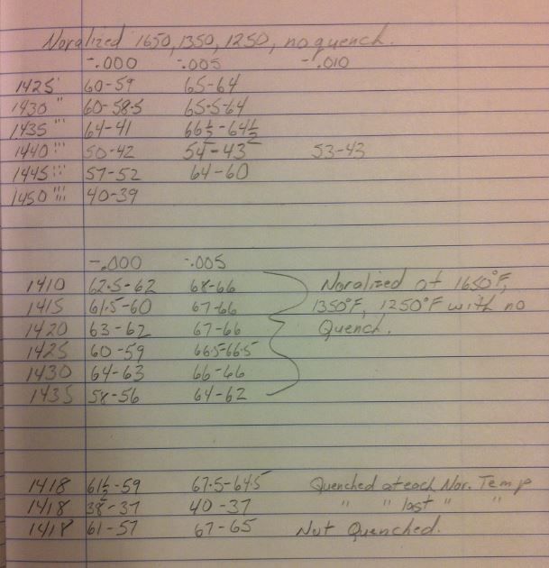

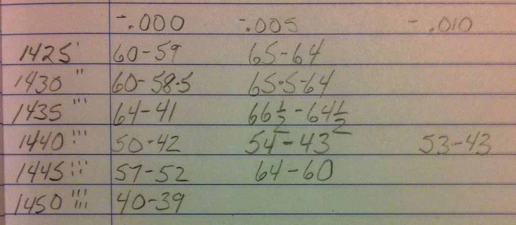

So once again for the eighth time I tried my 1425°F to 1450°F austentizing temperature test in 5°F intervals. And on this test I did normalize at 1650°F, 1350°F and 1250°F and I did cool to black between each temperature but I did not quench at any point during the normalizing because I suspected that was causing my problems.
If you look at my results for the first three temperatures I thought I had actually solved the riddle because my hardnesses after removing .005” of material to get through the decarb layer I was in the mid-60s. Not ideal but pretty darn close. But then I hit 1440°F and once again my numbers went for a crap but they pretty much continued to be awful for the rest of the test.
The fact they fell off and didn’t really recover properly makes me suspect that I simply dropped off the high tolerance for astentizing temperature for this steel. I know these numbers seem low but I just think my pyrometer for my oven is not calibrated properly and from my tempil stick test I assume it is out by about 30° so the 1435°F I think is around 1465°F which is about the recommended temperature.
So one of two things happened either the same bizarre all over the road inconsistencies hit me again and it’s just coincidence that they were the last three highest temperatures or I got good results and it’s just that I went beyond the austentizing temperature range of the steel. And I know it is pretty bizarre it would fall off so quickly from a 5° variation but maybe it’s possible.
But the idea that the steel has bad spots with low carbon and that’s why certain pieces didn’t harden seems unlikely because I know from my punch marking which pieces were beside each other and some of the highest were directly adjacent to some of the lowest for example the 1430°F sample was right beside the 1440°F sample and shared a lengthways edge and I tested along both these edges and on the 1430°F sample it was hard all along the edge that was cut out directly beside the 1440°F sample and I tested that edge and it was extremely soft all along. And the same thing happened with the 1435°F sample which was hard all along its edge that it shared with the 1445°F which had a soft spot along its edge.
I know none of this is conclusive but it certainly suggests that there are not soft spots on my bar because those soft spots just seem to coincidentally exactly match the shape of the test pieces I cut so this tells me that my problem is how my test pieces are being treated and not that there is something inherently wrong with portions of my stock.
So what I am saying is at this point I think there is still hope and that I tested too high a range for my autentizing temperatures and that if I test from 1435°F down in 5°F increments I may actually find a good range where everything is hard. If that doesn’t work I am done but then again I say that every day, LOL.

Today was a very good day in the shop because not only did I have consistent results and think I have a viable heat treat for W-2 I believe I also figured out what was causing all my wild variations previously.
At the top of the page you can see yesterday’s test and from it I hoped that the hardnesses fell off after 1440°F because that was too high of an astentizing temperature and wasn’t just the usual unexplained fluctuations.
So if you see the test below that I used 1435°F for the top of my range and tested down to 1410°F and lo and behold all my numbers were in an acceptable range for hardness. That was a real relief to finally see good numbers. It looks like things began to fall off again after 1435°F so it looks like that is the top of the range. Obviously 1410°F is not the bottom because those hardness is are still quite good so eventually I will have to test the lower end of the scale further to find the true center but for now I feel I can confidently make a knife by staying in the middle of this range and can hope to be in the 66 to 68 range. And obviously my oven is much warmer than the readout indicates because I am austentizing at 1418°F and others feel 1460°F is the sweet spot.
Now that I have figured out what was an acceptable austentizing temperature I did another test with three pieces. I did them all at the same temperature of 1418°F because I figure that is about the middle of the range so far even though it might be a little cooler once I do more testing on the bottom range. In this test all I did was vary my quenching during my normalizing cycles. For the first piece I quenched after the piece turned black after every temperature which were 1650°F, 1350°F and 1250°F. For the second piece I only quenched at the final temperature of 1250°F and for the third piece I did no quenching at all.
I suspected that quenching was causing all the unexplainable extremely low hardness readings I have been getting lately and this test certainly affirms that. Quenching after every step didn’t seem to make much difference either way but shockingly only quenching after the last temperature cycle gave readings 40 and below. It is hard to believe that this commonly suggested practice renders this steel so completely useless after hardening.
I have a working system now to make a good quality knife and I will probably do that now because I have certainly had my fill of testing samples but down the road I will do some more testing because I think there probably is perhaps another hardness point or two to be gained maybe. I know some people are getting 67 ½ and 68 ½ consistently but that may be because they are using different W-2 but I will try to see if I can gain something else by continuing to fiddle with my heat treating and especially my normalizing because I think maybe if I add a couple more temperatures between 1650°F and 1350°F I may gain a bit.
But anyway it looks like I have finally gotten a good heat treat for Aldo’s W-2 and I’d like to thank everybody who was so helpful with their suggestions because it was a great help. And I replied to your message Willie that since I have success now there is no point in sending you a sample but thanks for the offer and I am saying this here because I couldn’t see my reply in my outbox so I don’t know if you will receive it.

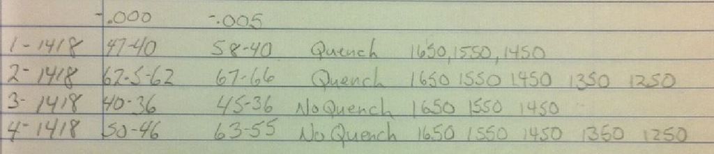

Again today my tests had unexpected results. These tests again affirm that W-2 is an especially finicky steel when it comes to heat treating and validates the practice suggested by many much more experienced heat treaters than me of the importance of doing your own tests because once again today conventional wisdom was shown to be inapplicable to this steel.
It was suggested to me by samuraistuart in a sincere attempt to help me that I wasn’t cycling “correctly”. He wrote, “Normalize at 1650, cycle down but stay at or above critical for a few cycles, as in 1550, 1475, 1450, finish with something slightly subcritical if you like as in 1350-1375. 1250F is doing nothing but stress relieving, and also beginning to slightly spheroidize the carbides.”
I had been using Stacy’s cycling temperatures of 1650°F, 1350°F and 1250°F. Stuart’s suggestion made sense because I was normalizing to break up the coarse Spheroidized carbides so today I tried two different heat treating cycles. I had one where I had three above critical temperatures where I used 1650°F, 1550°F and 1450°F and for my second heat treating I used those three above critical temperatures +2 below critical temperatures in addition being 1350°F and 1250°F.
In the past it seemed that not quenching during normalizing gave me the best results but also one test gave me good results when I quenched after each temperature cycle so I also did two samples in each normalizing test one without quenching and one with quenching after each temperature. So I had four samples in total; one sample went through five cycles without quenching, one went through five cycles with quenching at every temperature, one went through three above critical cycles without quenching, one went through three cycles above critical with quenching.
Here are the results.
Almost every result was unexpected. Firstly only doing three above critical cycles whether I quenched are not gave terrible results not even out of the 40s for hardness. This absolutely is against conventional thought because these cycles are the ones that are supposed to break up the course spheroidize carbides and it was thought this is the part of the normalizing that leads to greater hardness when in fact seems to have done very little.
And both the samples whether they were quenched or not where sub-critical cycles were added they were significantly harder even though this is only supposed to “stress relieving, and also beginning to slightly spheroidize the carbides”. So this test basically showed the complete opposite of what I expected and that is that adding additional higher than critical temperature cycling doesn’t aid in hardening and without the addition of subcritical cycling temperatures they don’t do anything to harden.
But the other surprise was what quenching and not quenching did. I suspected that quenching after every temperature might be beneficial because it had been once in the past and by doing that and cycling all five temperatures I attain the same hardness as I had previously with my other successful normalizing procedure so this wasn’t a big surprise but affirmed what I suspected. But what was a total surprise was that not quenching using the five different cycling temperatures did not give me good hardening again because not quenching did give me good hardness results when I used it with just three cycles of 1650°F 1350°F and 1250°F.
No wonder I had so much trouble getting consistent results because this steel reacts in very unexpected ways. Why is it that when I use five cycles and don’t quench I didn’t get good hardness but when I used three temperatures with one being above critical and two subcritical without quenching I get good results?
So right now I have two ways to get between 66 and 67. I can use five temperatures, three above critical and two below and quench after each cycle or use three temperatures one above critical and two below and not quench at all. This makes no sense but this is the reality.
So I do have consistent ways to do heat treating with W-2 but just out of curiosity I think I have to do a test only doing subcritical temperatures normalizing. It makes sense at this point that it really is just the subcritical temperatures that are doing the work because doing just above critical does nothing and doing above critical and below critical works so it only makes sense to do an only below critical because it seems like that is what is working? And I think I will do with and without quenching just for the fun of it.
