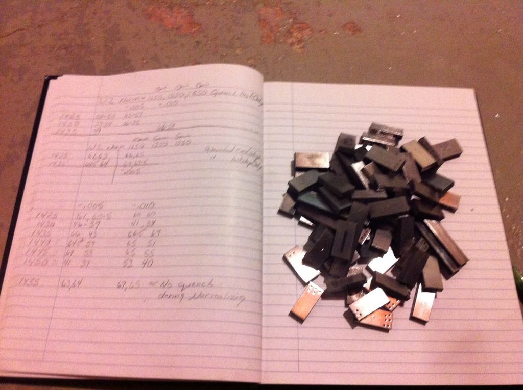

Testing W2 Hardness Quenched with Parks 50 and 9% Brine Solution.
After around a couple of months of careful testing and analysis trying to nail down the proper treat for W-2 I have come to one conclusion and that is that W-2 is one persnickety m*****f***er to heat treat. I admit it my nemesis is W-2 and it has beaten me not because I have given up but because I simply don’t know where to go from here because the results vary vastly when using the same steel from the same piece of flat bar using the same equipment and the same procedures. My results are so bizarre it seems as though somebody is sabotaging my experiments but that’s impossible because I’m the only one here, lol. I admit I am totally perplexed by this steel and really have no idea what my problem is with it or how to solve it because my results are simply all over the place with no consistency.
I have only made two knives all summer and that’s with a lot of time off because I decided to practice my grinding on some cheap tool steel and put the stainless away for a while and I chose W-2 because it gives the best hamon but instead of being able to practice my grinding basically I wasted most of the summer trying to figure out how to heat treat W-2 and have gotten nowhere. People can give me suggestions if they want but I just don’t see what the problem is but my question is has anyone else ever given up on W-2 because it’s almost impossible to get consistent results in heat treating?

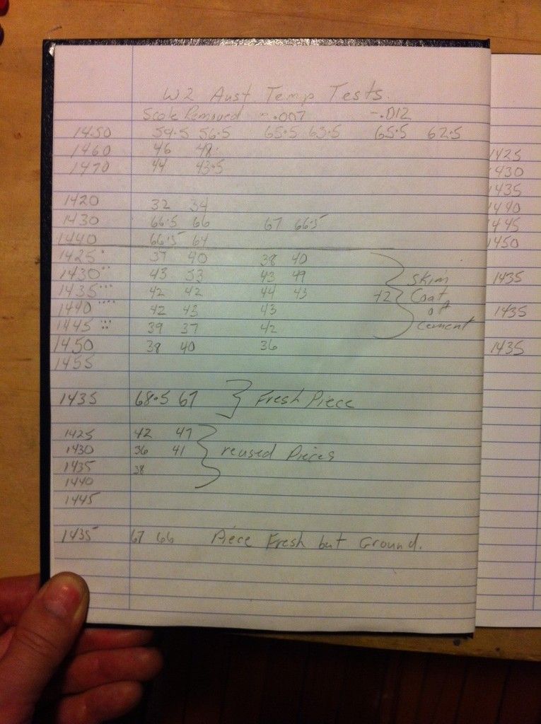

Here’s the story if anybody’s interested that I cannot make heads or tails out of. This is a little bit of repeat of a previous post but it will tell the complete story in one go. If you look at the top of my first photograph I’m trying to figure out the proper austentizing temperature so I tested 1450°F, 1460°F and 1470°F and from the results it looked that 1450°F was high so next I tested 1420°F 1430°F and 1440°F. If you look at my results from that it looked like probably 1435°F was the sweet spot because I was getting in the mid-60s.
The next day I tried the same experiment using a skim coat of furnace cement to try to cut down on scale and tried to use a broader range to really see the hardening curve and know exactly where my temperature was best by testing every 5°F from 1425°F to 1455°F. As you can see my hardnesses are a disaster where I only broke 50 hardness in one place. I assumed that the skim coat was slowing down my quench so I did one test piece at 1435°F with a fresh piece with no anti-scale layer of furnace cement and got hardnesses of 68.5 and 67 so I thought I had my perfect temperature and I was ready to make a knife.
The day was getting late so I quickly tried to reuse some pieces from the previous experiment where I ground off the scale and cement and got the same disastrous results where it says reused pieces. I found that perplexing but thought maybe it was because I didn’t get rid of the de-carb layer so I tried grinding a fresh piece like I did the reused pieces and tested it and got 66 and 67 so I figured that was my problem.
Now today I decided to redo the 1425°F to 1450°F with brand-new pieces expecting to get the same results as yesterday but this time I couldn’t even get hardnesses of 40! That is just beyond my comprehension because I was using the exact same steel and same procedure and yesterday I got 67 and 68.5 and today I only cracked 40. You can see these results in my second photo.
I thought maybe it was my austentizing soak time and it seemed to work fine at 10 minutes previously but I doubled it to 20 and after removing a decarb layer I got 64 ½ and 65 again so then I thought maybe 15 minutes was a sweet spot but it wasn’t then I tried half an hour and again that was worse.
Honestly I don’t expect anybody to solve this problem because they aren’t here watching me and I don’t blame people for assuming I don’t know what I’m doing but I honestly have meticulously been adhering to the same procedures and my results are truly confounding. So my question is again has anybody else just given up on W-2 because it’s almost impossible to heat treat properly consistently?
I do have one sneaking suspicion that it may be my parks 50 because I’m not actually using parks 50 for all these tests. I used the parks 50 that was sent to me for the first set of tests where I was using 10° variations and getting in the mid-60s. But after that I used 50 Quench Oil that I bought which is what parks 50 is now called because another company bought them out and this is what I purchased and the initial test was done with the oil that was given to me that is truly parks 50.
That would explain why suddenly my results are so poor but my highest readings when I did the fresh piece in my first photograph is with the 50 Quench Oil so how did I get that if the oil is no good? Honestly none of this makes any sense to me and I think it’s time for a few drinks. I don’t think anybody can help me but feel free to put your two cents in.

Hey Jeff, it sounds like you are changing more than one variable with each iteration. That would make it hard to nail down the culprit, and could be part of your problem. I'm not much of a knife maker, but I a guilty of the same thing!
I quenched those with the Parks 50 you were kind enough to send me I agitated for 30 seconds and then left them in the oil long enough to cool completely. It was at about 80°F.
I was just curious if you had used brine or the oil for those numbers. Thanks for the further data!
Also, Jeff, the oil I sent you is the same as the oil you've purchased if you purchased it through Maxim. My 5 gallon jug only says "50 quench oil" or whatever. Not Parks 50.
I'm willing to bet you either have a furnace/thermocouple fluctuation or a bar of W2 that is inconsistent. I think you should put away the notebook and make a knife. You know what temp you need to hit 66 RC. You know your quench medium is correct. I think further experimentation is going to have you chasing your tail.

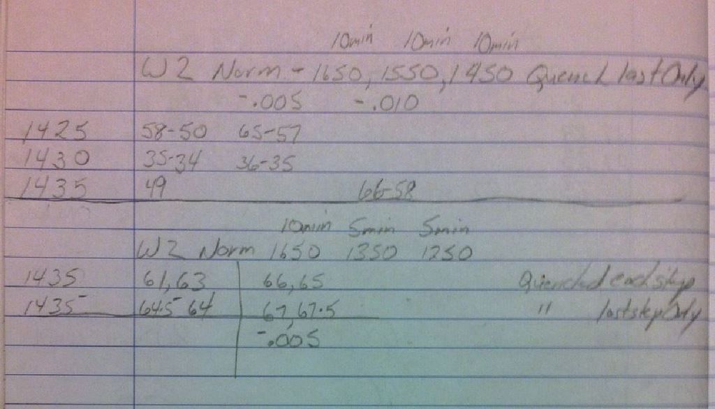

Success!!! You are absolutely right Willie normalizing is the secret. Thanks to your suggestion I tried normalizing two pieces one from each of my two stocks of W-2 and after grinding off .005” they were both 66 ½ hardness throughout their entire surfaces.
I had tried normalizing in the past and it didn’t seem to help but I think that is because there is inconsistency in the structure of not only batches but within a single piece of bar. I think probably the degree of spheroidizing varies and so some test pieces don’t need normalizing because the spheroidizing is not so severe and other places is more severe so it does need normalizing and I think that’s why I was getting such variations throughout individual test pieces. After I normalized not only was it hard it was hard consistently throughout the entire test pieces.
I am a little confused though because people seem to say normalizing and thermal cycling and I thought they were the same thing. The method I used is the one Stacy recommends; I heated to 1650°F let cool to black and then quenched in water and then did the same procedure at 1350°F and 1250°F. Is that what you would recommend for W-2?
Now that I have that figured out I am going to normalized six pieces and do another test from 1425°F to 1450°F in 5° increments to really nail down the sweet spot for maximum hardness. I know 66 ½ is very good but I might as well try and find the 67 to 68 ½ spot if I can find it and I am just plain curious how sensitive this steel is to austentizing temperatures and how wide the range can be before it dramatically falls off.
I was going to take you up on your offer to send you a few pieces but I don’t have to now because it looks like you solved my problem so thanks for the offer and thanks for the great advice; you solved my problem and it is much appreciated.
The sequence I use is 1650 for 10min, cool to black (magnetic), 1550f for 10 min, cool to black, 1450f for 10min, cool to black and quench. 1350 or 1200 will stress relieve and fine spheroidize the steel. The first cycle it above ac3, which grows the grain, making it all the same size, and its hot enough to break up the course spheroidized carbides. The two subsequent heats result in new grains forming within the old grain boundaries. The heat is low enough that the grains don't grow. I'm not sure about the reason for the quench on the last cycle, but those with mire knowledge than me said it can lock everything in where we want it, so I trust them. The subcritical temps are only needed if one has to grind or machine the steel, as spheroidized structures machine easier than pearlite.
It was another surprising roller coaster day in the shop again today trying to figure out my heat treat for W-2. Your normalizing cycles made a lot of sense to me Willie so I tried them in my test to try to figure out the best astentizing temperature for W-2.
I normalized six pieces so I could do 5°F increments from 1425°F to 1450°F. As you say the 1650°F cycle breaks up the course spheroidized carbides and the subsequent heat cycle results in new grains forming which was what I was hoping to do. And I didn’t do the subcritical temps because I didn’t want any fine spheroidized carbides. So I just did the top three temperatures exactly how you described for 10 minutes each and cool to black and on the last one quench after black.
As you can see from my results I started to get the same terrible results I had before I started normalizing so for some reason your system did not work with my W-2. I’m not saying it doesn’t work with yours and perhaps it’s just our different batches have different requirements.
So then in my next test I tried redoing the same normalizing system I used before that Stacy recommends that worked for me hoping I would get repeatable results and fortunately I did. So either the fact I did a low temperature 1250°F cycle gave me my improved results or it was the fact I didn't do the two cycles at 1550°F and 1450°F?
It was a real relief to finally get a repeatable results so I can move on now with my austentizing temperature test using this normalizing sequence again. When I did your test I only quenched after black on the last piece but when I had my successful test yesterday using Stacy’s method I quenched after every temperature so I thought maybe that was the difference so when I did my retest using Stacy’s method again I did two samples and with one I quenched after every temperature and the other I only quenched after the last temperature.

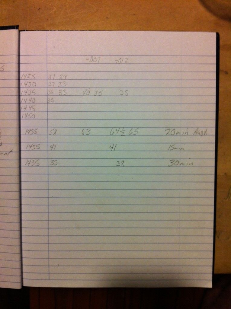

I have been trying to do a simple test to figure out my austentizing temperature from 1425°F to 1450°F in 5° intervals. I have actually thought that I had my consistency down enough to do this test and I have been wrong seven times now including today. Every time I think I have solved my consistency problem I try that damn test and my results are all over the place. It seems like every single day I feel like I have figured it out, solved the problem and tomorrow I will get my results but that tomorrow never comes and I actually against all reason feel the same thing today. This steel may very well be the devil’s work in my humble opinion, LOL. But seriously it just seems like it starts to behave like I have found a procedure which will give me consistent results and then the next time I use it they are all over the place again.
These are my latest results. On the top of the page you can see yesterday at the end of the day I returned to my initial normalizing cycle of 1650°F, 1350°F and 1250°F. Some people say to quench after every temperature and others say only on the last so I tried two samples doing each method. And as you can see I got pretty good results with both but the sample I only quenched on the last temperature was higher so today doing my 1425°F to 1450°F test at 5° intervals I only quenched after the last temperature during normalizing.
If you look at the results there are some decent hardnesses but again some are all over the place for absolutely no reason which is bizarre considering all these pieces were normalized in the same batch in exactly the same way. The only difference was the austentizing temperatures varied by 5°F. It is so bizarre that 1425°F and 1435°F were over 60 and yet 1430°F maxed out at 41? That is just too bizarre? And if you look at the pieces I put the highest and lowest reading for every piece and the variation is crazy.
But as usual there is one small glimmer of hope that may be the answer. Because yesterday I got better results only quenching on the last step while normalizing I tried one piece that I normalized with the others but I did not quench at all. This piece resulted in not only having amongst the highest hardnesses but also had the most consistent hardnesses throughout its entire length. I took about eight readings on this piece and nothing was below 65 and most fell in the 66 range.
This makes me think possibly that the problem may be the quenching during normalizing is throwing off all my results. Not thinking it mattered I have been very sloppy with this procedure usually just letting all my pieces cool to black and then chucking them in a jar of water on top of each other. I didn’t think it mattered but this may be resulting in very uneven cooling which is giving me such wildly varying results even within single pieces.
Many times I thought I had figured things out so my confidence is waning but this does seem like a possibility so tomorrow I am going to do another six pieces and try the same test again without any quenching during normalizing. And I am thinking that quenching during normalizing may actually help hardness it’s just that I have been doing very uneven quenching not thinking it mattered so if I do get consistent results not quenching during normalizing I may try again quenching during normalizing but doing it very carefully just like I quench during hardening by agitating pieces separately.
