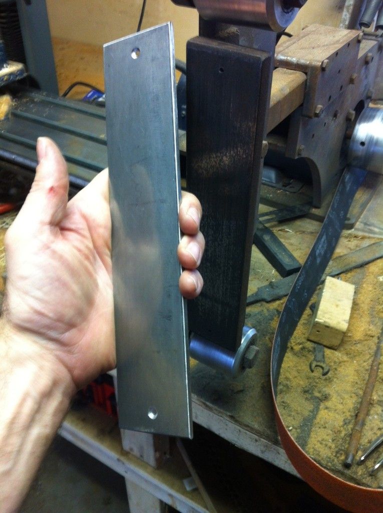

Unfortunately I have been working the last few weeks so I haven’t been able to do any blade making but yes noseoil I am getting to the point where I should be able to make some pretty good blades. Now that I know my heat is even in my oven I’m going to do some test samples to figure out exactly what temperature gives me my maximum hardness with my W-2.
From my tempilstick tests I think I am within about 5° from what my readout on my oven tells me if the stick is pretty accurate but of course there is no way to know that so I think I will try three samples right under the sensor at 1450°F and 1460°F and 1470°F. Hopefully one of these will give me a hardness of 68 and then I am off to the races to actually make a knife. If all goes well I will get that done tomorrow if I don’t get called for work.
Before I make my next knife I am also going to make a platen out of some 2 inch 1095 that I have because the one I have now is just mild steel and it’s starting to get a little wear in it. Obviously I want it as hard as possible and I’m not sure if I will just quench it and not temper it for maximum hardness or if it might crack if I don’t. Maybe I will temperate to about 200°F? Any suggestions?
A stress relief temper is a good idea. I used O1 and used 300f.
I think you are right Willie because it’s better to lose a couple of points of hardness than have the thing crack on me. Interesting you use O1 because I would think 1095 would hold up almost as well.
Here’s a photo of it before I have done the heat treating. I’m holding my new platen in front of the old thick mild steel one I have been using. Because my 1095 is only about .175” I am just going to attach it to my old one with some machine screws for support. I countersunk my holes front and back and centered them so I can flip it vertically and horizontally as it wears as I only seem to use the top half so I should get four uses out of it.

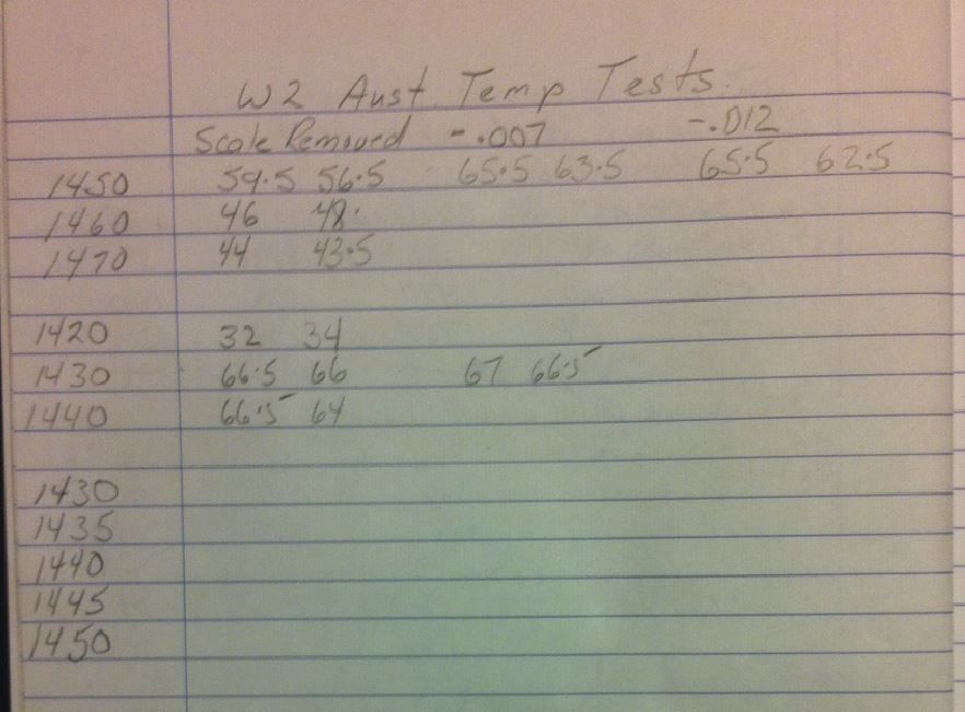

I did some tests today also with Aust. temps for W-2 which are kind of interesting so I will post them after dinner.
I had 1/4" O1 on hand. My 1095 is 3/32". I have W2 in 1/4", but I like it too much for blades, and I don't use O1 much anymore,
Now that I have my oven heating pretty much evenly throughout its length I did some tests to try to determine the best austenitizing temperature for my oven with W-2.
Since most people feel the best temp is around 1460°F initially I tried 1450, 1460 in 1470. I had three pieces that I had put a thin watered-down skim-coat of furnace cement on to act as a scale inhibitor as recommended by Stacy because I suspected scale was giving me wide variations in readings on some of my earlier test pieces.
As you can see from my readings 1450°F gave me the best results but not as high as I had hoped for so it seemed my ideal temperature was lower. I also put in a piece of 1450°F Tempilstick and it was totally melted at 1450°F so I assumed my furnace was hotter than the readout temperature in conjunction with the fact 1450°F also seemed too hot for an austentizing temp and most people were using 1460°F.
So my second test I reused the same pieces to save material and time and did not coat them with any skim coat or furnace cement. As you can see 1430°F and 1440°F gave much better results even with just the scale removed. I also did a tempilstick melt test on this series and it was melted at about 1420°F so if the stick is accurate which there is no way of knowing my oven is about 30°F hotter than the readings and the fact my ideal austentizing temperature seems to be about 1435°F seems to verify this fact pretty closely since most people are using 1460°F for theirs.
I didn’t include these figures so as not to confuse myself but this second set of tests where I reused the same samples from the first tests without recoating them with a skim layer of furnace cement gave variances of readings up to 15 points so that does verify that it is scale that was causing such disparities in the past with my tests. I may do some tests later perhaps with some commercial scale inhibitors because I find it’s hard to get the skim coat of furnace cement even and with it I still did get a couple of points variance in my first tests but that’s markedly better than without it.
So now that I know my range I’m going to do tests every 5°F starting at 1430°F up to 1450°F with pieces that have a skim coat of furnace cement and I will be removing a layer to really know what my hardness is at and below the surface.
What is surprising is how quickly the hardness falls off outside the 1430°F to 1450°F ranges. It seems pretty obvious even at this preliminary stage that this steel only has a 20°F range before hardness is dramatically affected so it just goes to show how important a very evenly heated oven is for knife making. And I hate to beat a dead horse but that’s why I think it’s so sad that Evenheat sells heat treating ovens that heat so unevenly because doing a sizeable knife in one of those ovens would definitely fall off the extreme ranges beyond the 20°F mark.
