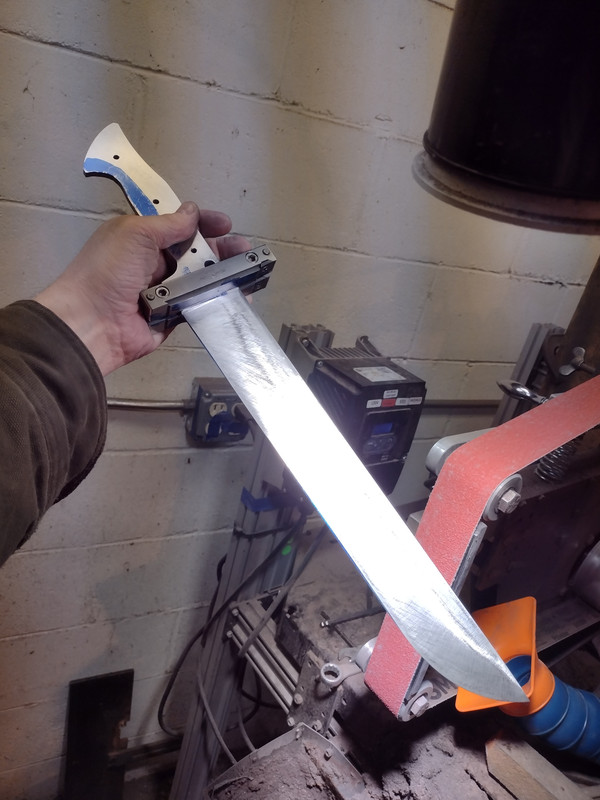

That is stunning.
That is stunning.
That's a heck of a chunk of steel! Nice!
Looks awesome to me! That's a short sword, haha The handle seems to be perfect for getting a good swing.

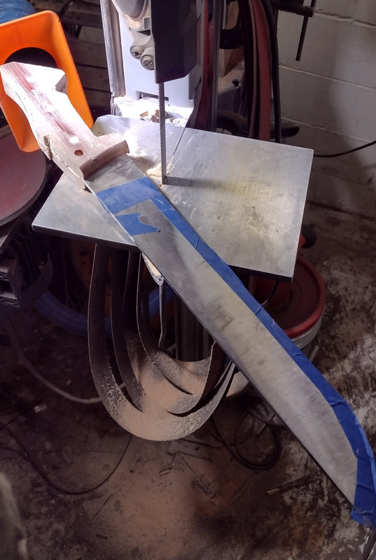

I would think the harder RC would chip out, but maybe you got the best from the steel.
Could also be the difference between old growth trees and new growth. Newer trees that are harvested for board I don't think are as dense as old growth. I could be wrong though.

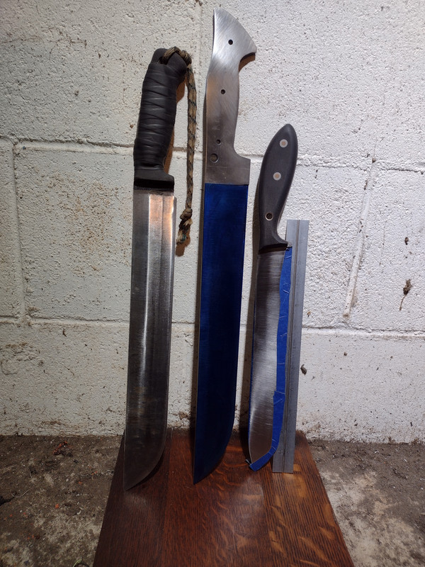

Also what kind of steel are you using? And any distal taper on that behemoth?
Thanks for the reply!I think so too, I have No idea how old they Are? I assume before the settlers got here?
I use all kinds of steels. I like so many!
This is AEB-L @62HRC treated by HIS
My next choppers are going to be More of this or Nitro, A8mod, 80crc2, and 1v
As far as taper.... Not in any length, meaning, only at the point, from me rotating the blade when grinding the front. So just a couple inches.
It's a Chopper, and not very tall. And not very thick, I think 3/16" ? So a taper would make the blade too light feeling at this thickness.
That's kind of a magical thickness for longer choppers. 3/16"
In my opinion, 1/4" thick choppers need to be shorter, like 1 2" or shorter in blade length. Otherwise our forearms get ruined. Haha

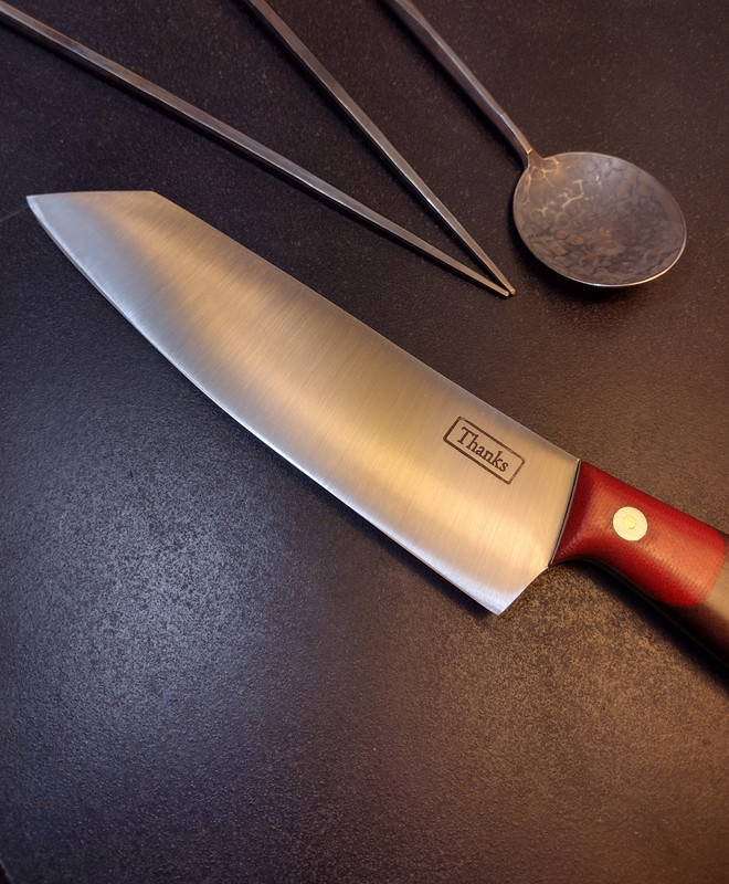

That makes sense with choppers, I should have thought of that. Thanks for all the info too.
