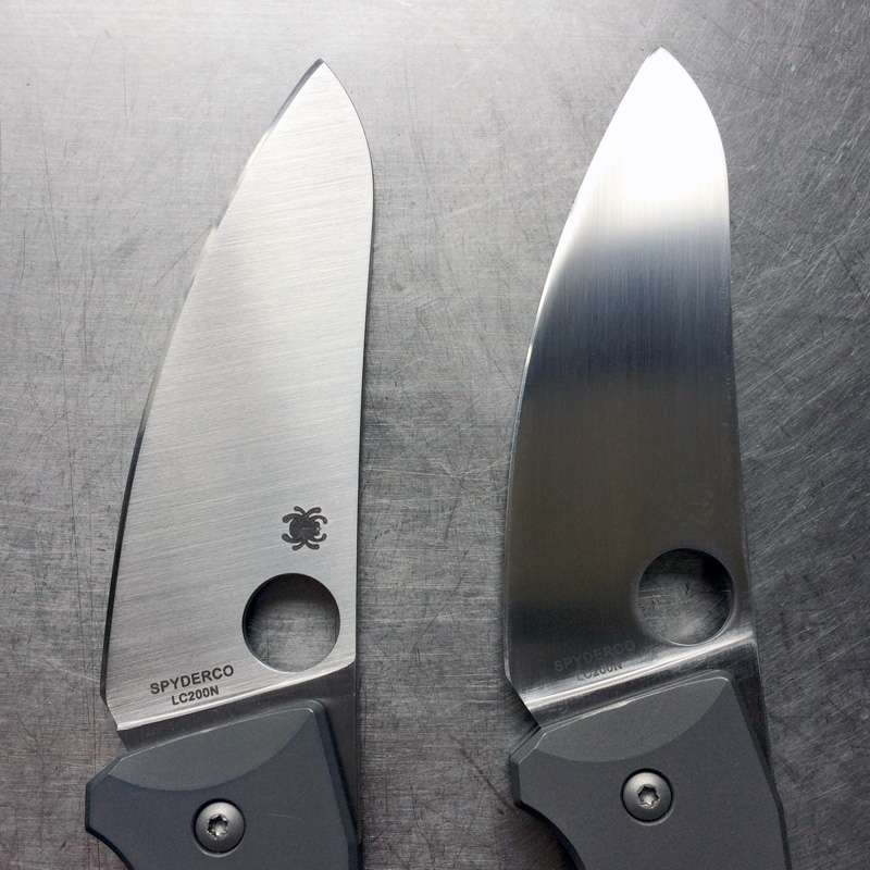

Here a few I have.
Kizer Feist regound by Josh @REK.
It is amazingly precise hollow grind to a thin edge.
Another one done by Josh.
The knife is now almost perfect.
The last one is done by me.
I was able to thin down the blade slightly with sandpaper.
