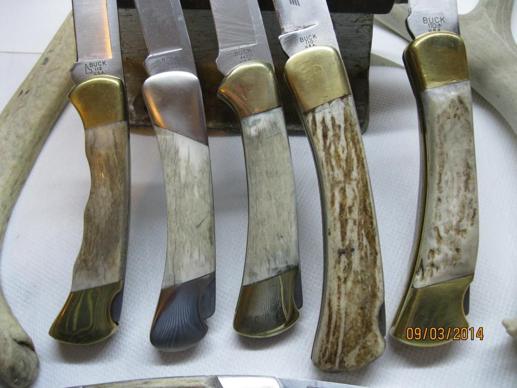

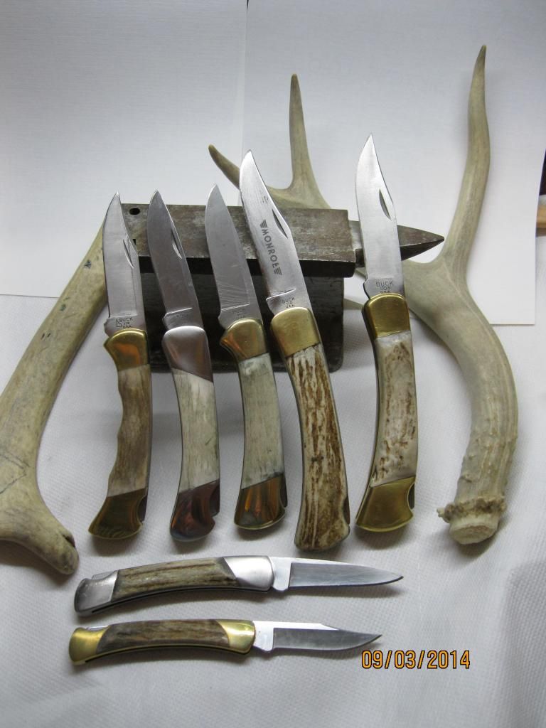

Just plain nice beyond description. I have a few home grown for EDC that I found in a box when setting up the new, improved and smaller shop. Nothing special but I always like to have something different to use. All Elk & Deer as I said nothing special
Thanks for giving me a reason to finely get them out and put away. I don't have any of the factory stag, sure would like to get some but as it stands now I need to limit my purchases, I have put money away for some of the nicer knives but always find some thing else to buy, I guess I'm an addict,,

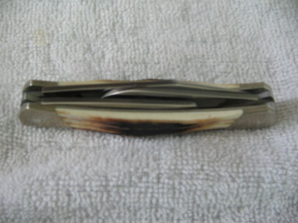

Here is a 701 stag, a beefed up 301. I really like the 700s

Dave…looks like those Buck knives are being used for what they were meant for. Did you do the re-handles?
Thanks for posting those! :thumbup::thumbup:
George…good to see you post some stag in this thread. Nice 701! :)

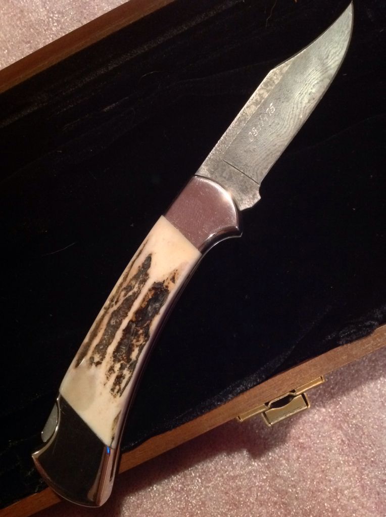

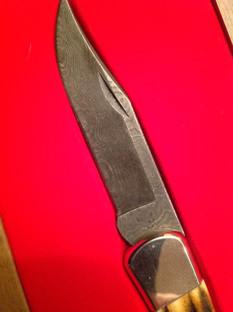

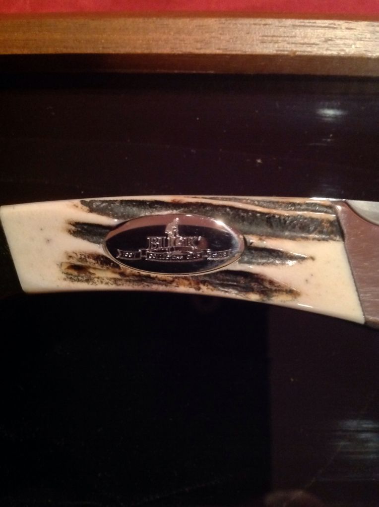

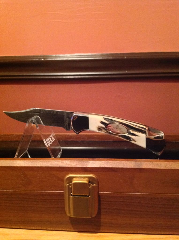

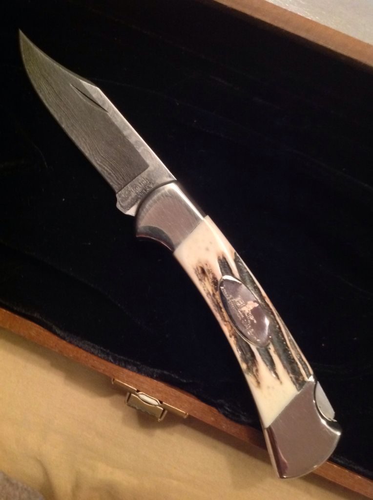

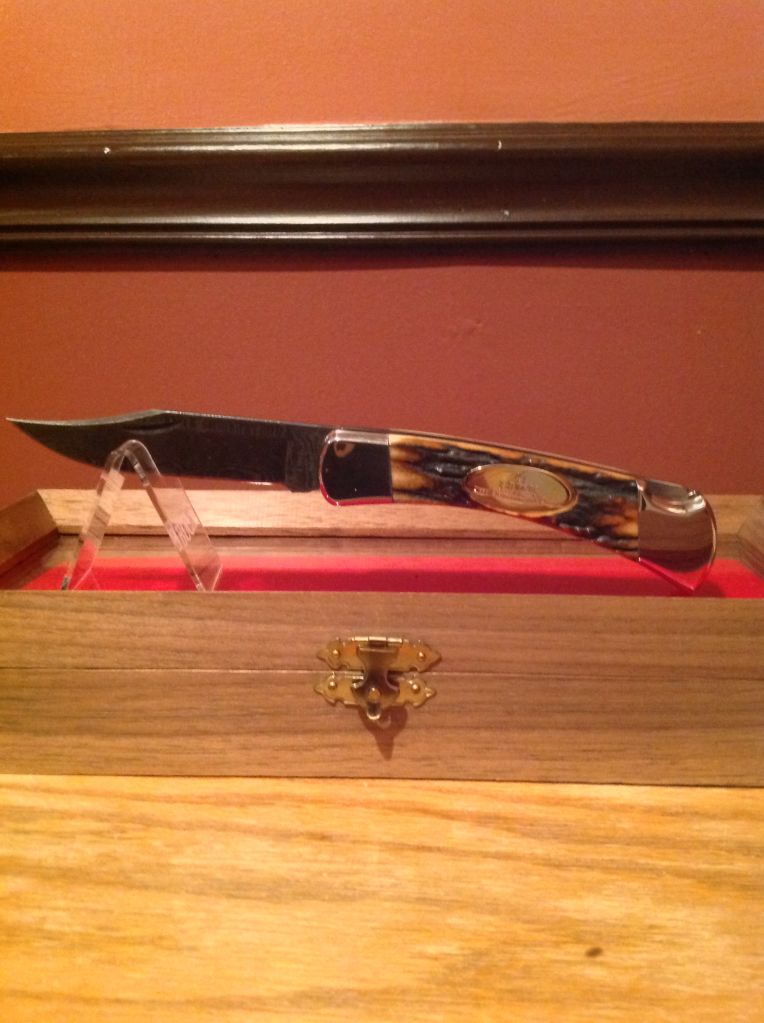

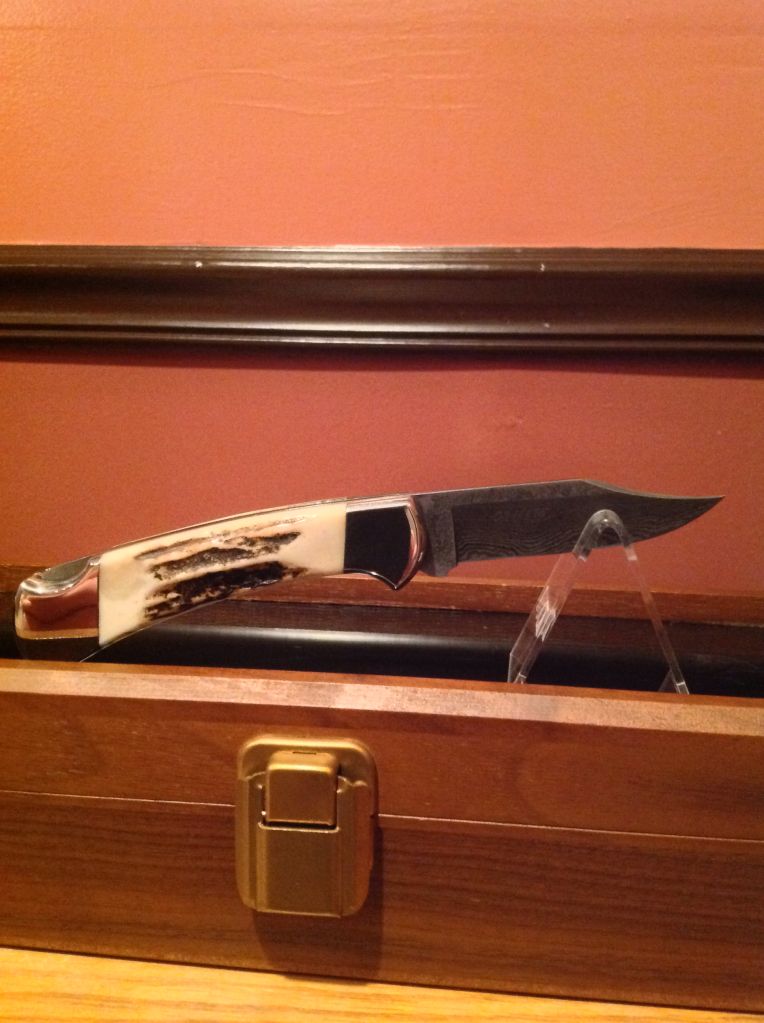

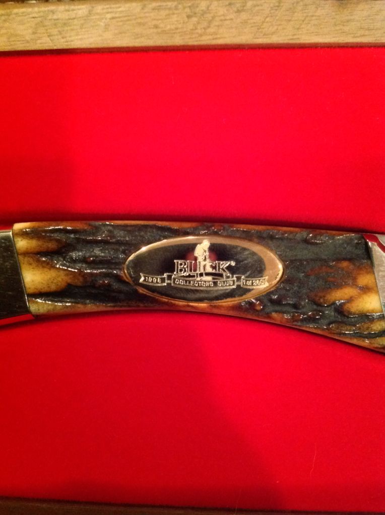

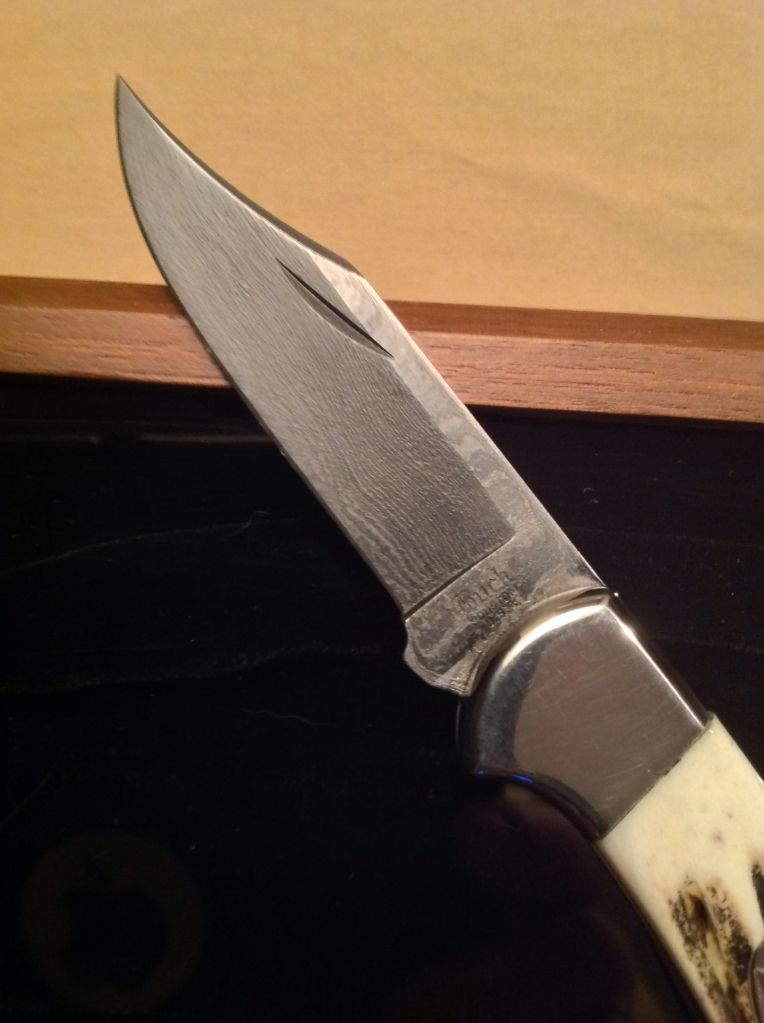

I showed these in the SPS but I'd be remiss if I didn't add them to the ASAIB thread. They are the 1996 and 1997 Club Annual knives . . . the 1996 110DM Stag and Damascus with BCCI Medallion and the 1997 112DM with same aspects. I've been searching for both of these but especially the 110 for over a year and finally obtained them thanks to the thoughtfulness of one of our Board Members and the generosity of one of our Officers.
Thanks Mark, yes, they are a few of my toys. I re-scale then EDC until I find another to play with. As I said nothing fancy just fun.
Thanks for posting those Michael!!
You are getting one heck of a nice BCCI knife collection put together. :thumbup::thumbup::thumbup:
