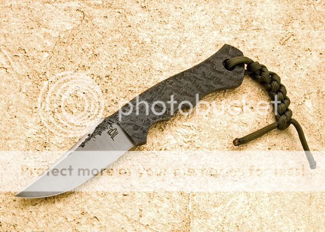

Even as a Master Bladesmith you still run the risk of being lured by the Dark Side. Sadly, such is the case with me. After years of forging blades to shape (the way it is supposed to be done) and flat grinding with a convex edge (the only way to ensure maximum cutting performance), I have been seduced. This little knife was not forged to shape, just banged on with a hammer (women gasp, and men "harrumph"), and if that were not enough, I actually hollow ground it (children weeping), and you know what, I love it! As we speak, paperwork has been started to forcibly excommunicate me from the ABS.
Maybe.
In any case it was kinda fun. This is the first knife I've ever hollow ground, and no offense to the hollow grinding crowd, but YOU GUYS ARE GENIUSES! Hollow grinding is so easy and fast (once you've been flat grinding for years) that it practically grinds itself.
Anyway, this little thing was "forged" from 1095, and ground to a 400 grit belt finish. No scales, just steel. I'll be making these in damascus, too. I think a little leather belt sheath, either horizontal or vertical or even a kydex neck sheath option would all work well.
I won't likely be changing the way I make any of my other knives, but this one was kinda fun, and would make a great, simple carry knife - despite all the obvious flaws in craftsmanship. :D:D:D

I did hollow grinding on all of my blades for 6 years before I ever did a flat grind. After you can do a decent hollow grind, you can do a flat grind in the dark.

They are affordable, cool-looking (in the eyes of a great many), functional (the steel handle is fine - on a knife this small, it's not like you can put a lot of torque on the handle), easily portable, and they are affordable. Did I mention that last one twice? :)
There are a lot more people out there with the funds to take one of these home from a show than there are people with pockets deep enough to accomodate multi-thousand dollar damascus / ivory bowies.
