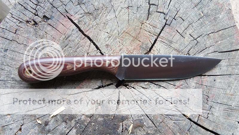

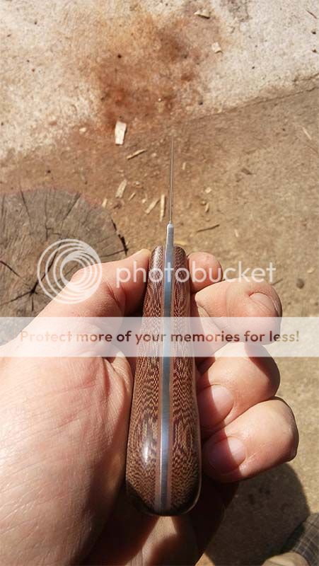

Part of the reason I have a general use knife with a 4 3/4" blade is that it is comparable in size to my boning knives.
I have the custom pictured below en route as we speak.
4 3/4" blade (52100), 9 1/4 OAL, just over 1" blade height and built with being my "goto" general duty knife in mind.
That's a super looking knife.
How do you feel that handles wood working, particularly making feather sticks and shavings. Do you loose control close to your hand with the edge below your hand?
I don't have it in hand yet seeing as how it is being shipped to me from Croatia as we speak.
I will be able to give a thorough review (Hopefully) the week after Mothers day.
Regarding the design of this knife, previous handle shapes that I prefer for users have been instrumental. That being the case, I should have no such issues. Most of the forced exerted are in plane with the spine/edge and shouldn't have much of a torquing effect that can't be easily negated due to the drop in the butt of the handle.
Thanks for the complimentary post. I am Really looking forward to getting that in hand. The micarta is 30+ year old stock and looks Phenomenal.

That is the main downside I see to the OP knife style. It seems like the aspect ratio of the handle would have a big impact on your control for carving. A rounder handle, which works great on narrow blades, would resist torquing less.
This may be a strength of the Canadian Belt Knife style - having a different handle angle from the edge lets the pommel end act as a lever to resist torque with the heel of the hand.

I have basically the same knife from the same maker & it's one of the few customs I actually use as a work horse...& the antique micarta is just mind blowing...it's just richer & I don't know, better than modern micarta for the most part (though, I love me some Shadetree products!). I craft bushes with this knife extensively, & my 15yo has his own & does the same with his....both of us find the knife to be a wood carving machine, & the handle has never been anything but comfortable for me, in every grip I try. I was wary about it too, but man, it's just super comfy & grippy, & his geometry & edge are designed perfectly for wood working tasks....our two examples just devour wood, and we find the entire design, while simple, to be extremely effective. NJBILLK - Congrats on your new knife brother - you're going to love it!!
