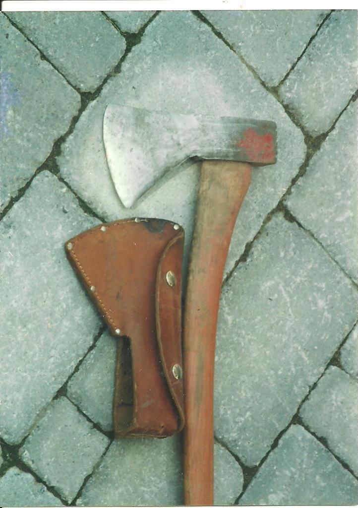

Pictured below is a Walters Axe (the handle is marked Ogdensburg NY) version of the H. B. pattern with original sheath. This was Walters general manager Ed Hammel's personal axe.

That's awesome, 300Six. Great curve in the haft of that axe.
I love the shape of that sheath and the dual snaps. Walters did things right.

Back in 2004 I couldn't convince Ed Hammel's son into parting with the family heirloom Walters HB so I had to be content with only taking a photograph of it. Despite poking through every garage, basement and shop I ever worked at as a general contractor in Ottawa for 20 years I never came across "exotic" patterns until I set foot at the Hammel household to build them a gazebo over their outdoor hot tub. They used that axe solely to make fireplace kindling out of already split rounds.

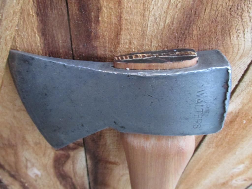

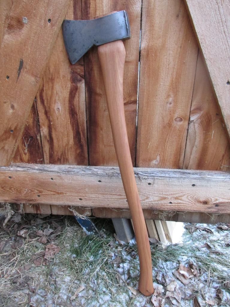

Here's another Walters H.B. pattern. It's a little more "squarish" overall, if it can be described with such a term.
Looking at yours and then looking at a few of mine (those with 2 1/4 lb heads which defines a 'Pulpwood' axe) I presume that Morley Walters must have experimented with various shapes and profiles over the years to see what worked to attract buyers and yet be durable.

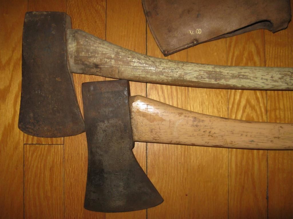

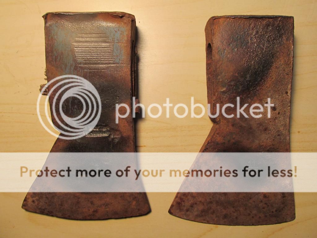

I came across this pair yesterday, and they demonstrate the variability that can be found in the design.
On the left is a head simply marked "Made in W. Germany" on one side and "2 1/2" on the other. The head on the right is marked "HB Made in Sweden" and then "1.1" over "2 1/2" on the opposite side.
Laid side by side, they appear roughly similar.

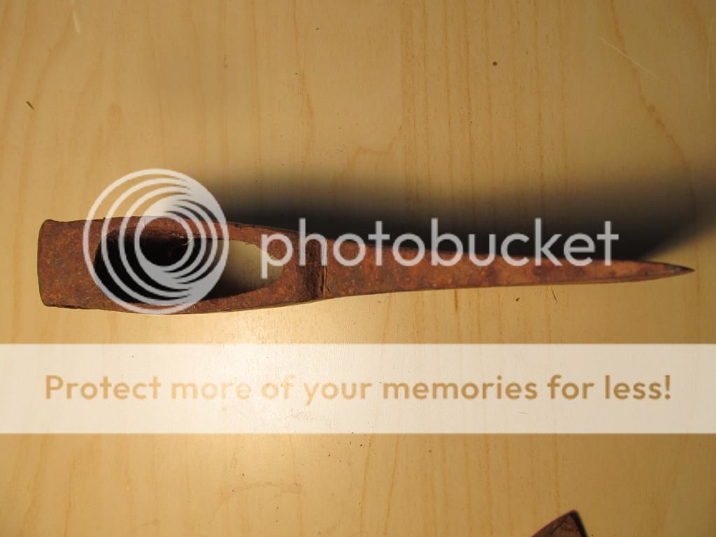

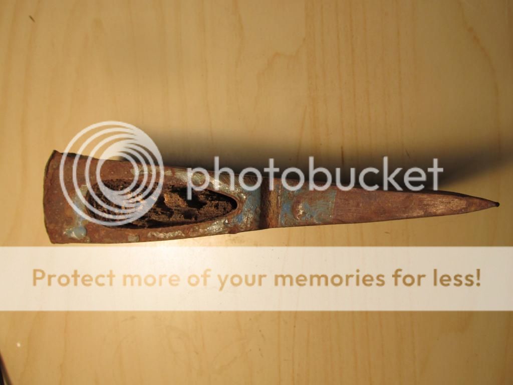

Placed on edge, however, and they reveal quite a contrast. The German head runs at pretty much a straight angle down from the poll, and is quite heavily constructed. There's no way it weights in as marked; I'd give it another pound, easily. I suspect that it could be used for some pretty heavy splitting work.
The Swedish head, by comparison, is quite thin and flat.

Those aren't Hudson Bay pattern axes. Those are Montreal pattern axes. Montreals have a deeper eye than Hudson Bays have. They're a better axe. Functionally similar to a boys axe. Hults Bruk sold scores of these. Good axes.

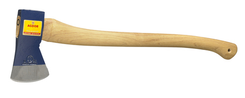

And the Montreal pattern axes are still being sold in Canada.
Hultafors AGDOR Felling Axe, Montreal Pattern, Smaller Model
Model: 28
Weight of head: 1.1 kg / 2.5 lbs
Handle: Hickory
Length of handle: 700 mm / 28"
