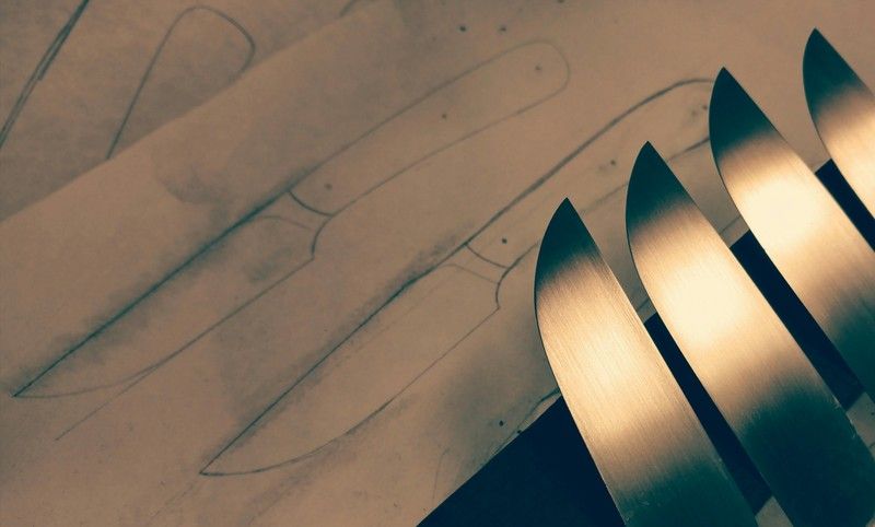

The old guard judging a stack of recruits.
Oh, those are going be nice.... I may have to get on board with that!
I'll get the sketch cleaned up and we'll pick it apart. What's your take on a blade length Scott? The drawings always seem to come out around 2 7/8".

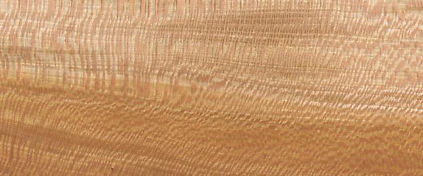

You're spot on, I was thinking around three inches and possibly figured walnut handles? Or quatersawn Sycamore, Which I might just happen to have.
That sounds good, what's that sycamore look like? I've seen some spalted sycamore that was amazing, never seen quartersawn I don't think.
