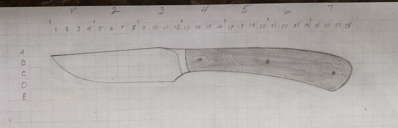

Let's start with this. I put letters and numbers so we can play it like battleship if theres a specific spot you want to point out for a change. Pick that apart and let me know.
3/32"
1/16" pins
Edge is 2.75"
OAL 7"
3/32"
1/16" pins
Edge is 2.75"
OAL 7"

For what it's worth I like my handles a little on the thicker side now days and I don't like a lot of taper. I bought a Dan Graves knife not long ago and it tapers a lot and feels like it wants to slip out of my hand and pull the blade though my hand. Try dropping the bottom handle line down a little bit to line C just behind the ricasso and see how that looks.

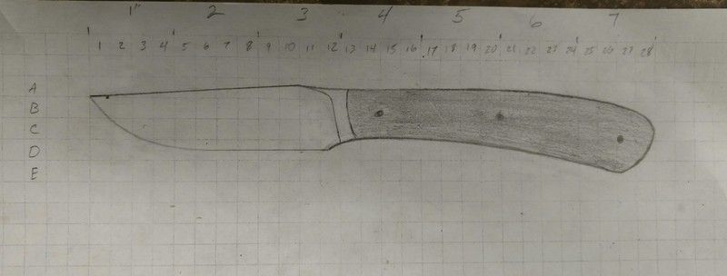

More like this Scott? I agree, a little thin necked at first. I need to contour E27 a little.
I agree Scott, something wasn't looking right and I couldn't figure it out I think you found it.
Agreed! Old broken hands just don't close as well, the larger grip might fit better. Looks good, John!

Yes, thats looking better.
:thumbup: I agree completely.
Great point Dennis.

Keep pickin this thing apart and I'll get a mock up made. Thong hole? Finger indent? Palm swell? Blender attachment?
Thong hole - optional.
Finger indent - nope.
Palm swell - no. Palm wood - maybe ;).
Blender attachment - hmmm...
