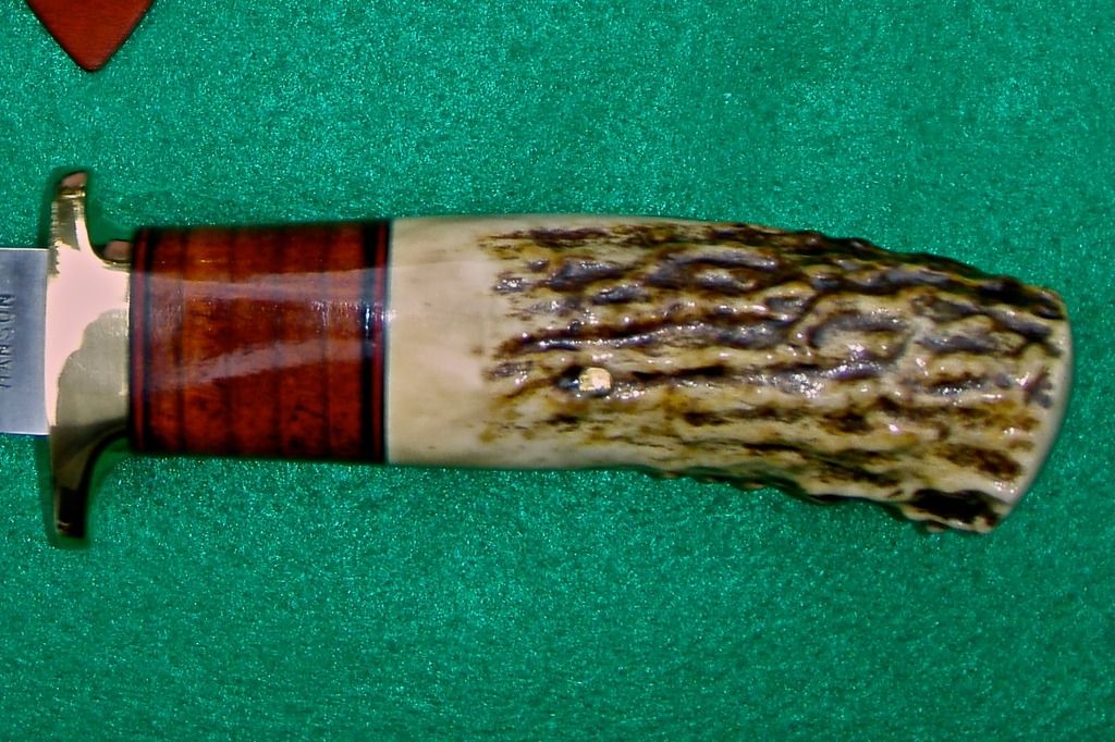

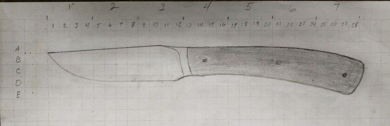

John, I took a closer look at your drawing and made some slight changes, maybe worth taking a look at. I added a small finger bump at the front of the handle slightly distal to the edge. This is to help index the knife edge to its position either up or down while it is in use in say the cavity of a deer were it is hard to see. This will let you know where the edge is before your finger or thumb get to it. The next thing I did was made the top and bottom radiuses on the butt symmetrical, this doesn't add anything to the performance but it gives the knife visual balance. Bob Loveless talked about this in one of videos on making a drop point hunter. For what it is worth I like butts on my knives to be cut at about a 90 degree angle with actual butt being domed with a slight radius on top. I'll post some pics.
[/URL[URL=http://s1038.photobucket.com/user/scotthanson1/media/P9260764_zpsv56iebln.jpg.html]
Thanks Scott, I like the index idea. I'll sketch it up, if I'm understanding correctly, it would just be a bit of a smooth bump, just enough to barely feel?
I like the butt end,that looks a lot better:thumbup:
Correct, not a finger notch just a small little bump or rise to help distinguish edge orientation, either up or down from feel alone, when the knife is not in view. If you look at the guards on the two handles I posted you will notice the front guard is about a 1/3 longer than the back guard, this is why.

I'm still sketching this up, I added a tiny bit of length to the handle just to make sure your finger doesn't ride on top of that bump, should be able to use it as an index for not only up and down, but how much room you have front to back.
Should we put less curve in the handle? Straighten it out and lessen the top curve?

Curves should match the natural curve of your hand/wrist when working with the knife. If it's curved correctly it will be much more comfortable to work with. When working with large animals that will be a huge benefit.

John, I think it's looking really good right now, a little bit of curve on the butt of the handle make feel and fit better in your hand, the forward 2/3 of the handle is plenty straight. I think you should try this design out or make a mock up out of wood and see how it feels first, but don't think you'll have to I think you got a winner right now. Like I said try this for a couple of knives and tweak it as you go if you have to. :thumbup:
I'll make mock up with clay handles and see how it feels and we'll go from there.
As for thickness, .07"-.09" would make for a thin slicer. What says you's?
Mmmm, thin but with curves in the right places.
Although I prefer drop points for a knife that will primarily be used for hunting, I am REALLY liking this one John...
