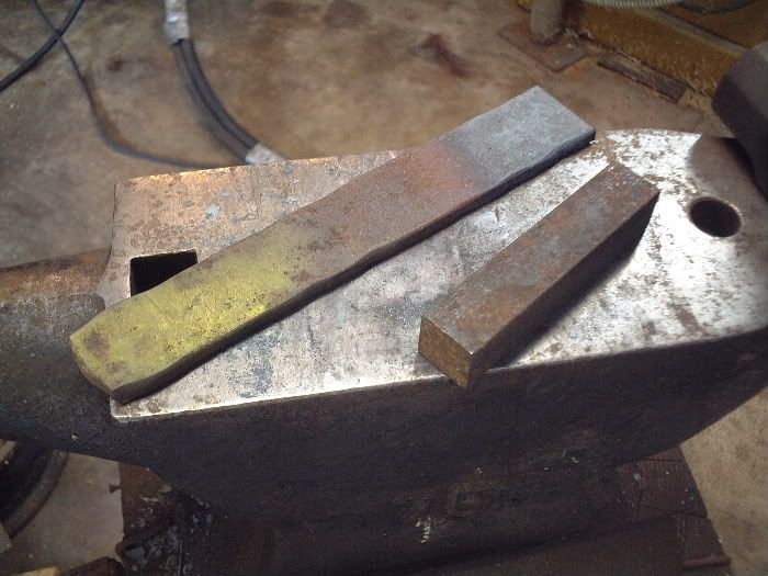

I started with my 1" square 5160 that was made in 1984 here in Illinois for a specific manufacturing process:

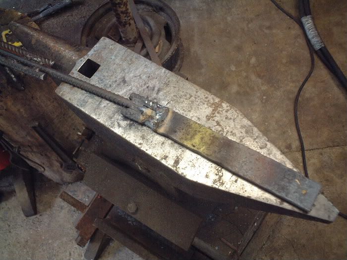

I'm not much of a tong guy until the end, so I weld up my material to handles made from rebar:

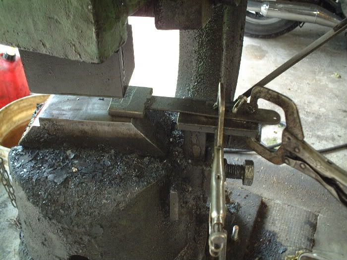

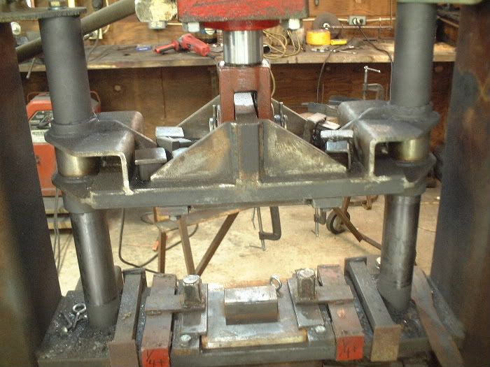

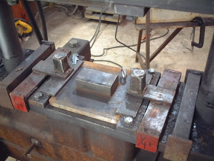

A picture of the press with post-spacers in place:
I have my power hammer set-up with a spacer holder to which I attach spacers that run from .130" up to over an inch:
I wanted this knife to finish up pretty thick at the guard, and my first posts on my press needed just a little extra, so I added two nickels!

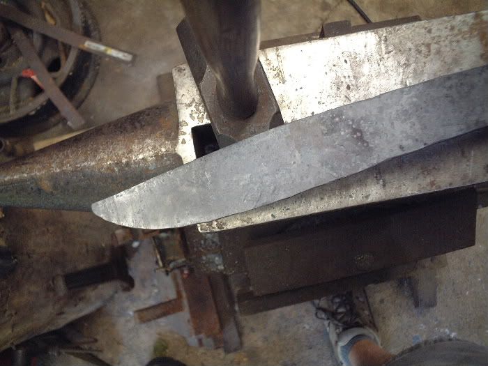

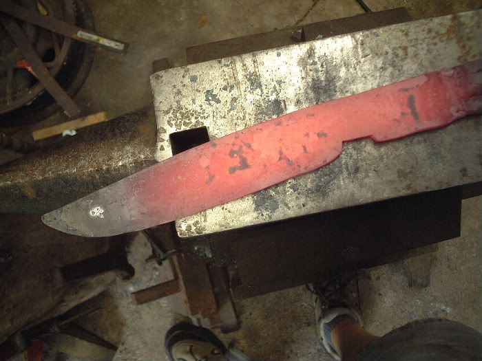

After a little beating and pounding we get this:
I forged this during that miserable heat we all had and just didn't finish it that day. I think I lost almost two pounds in sweat that day.
The next morning I forged in the raised clip and didn't think to take any pictures.

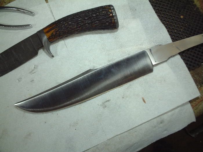

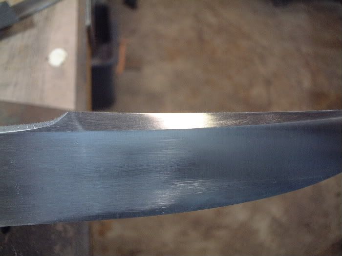

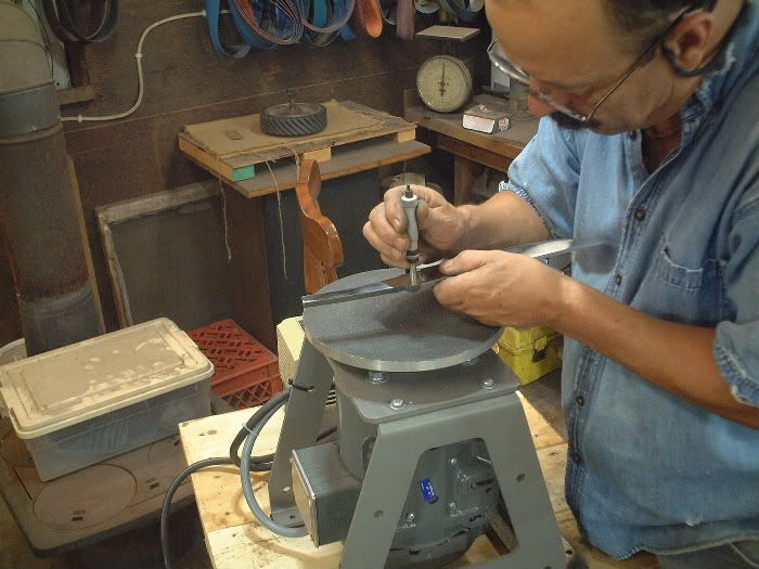

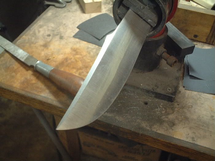

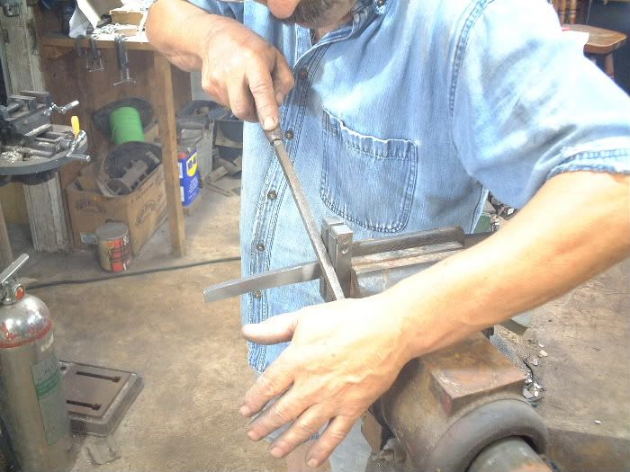

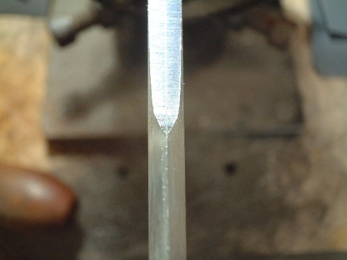

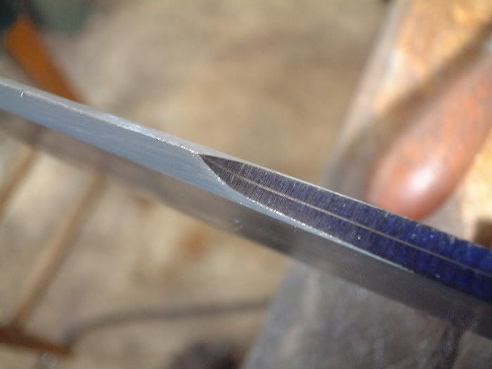

After some of the basic grinding has taken place, I've used my surface plate and height gauge to determine flat-ass dead center. I will use this line to help file in the false edge.

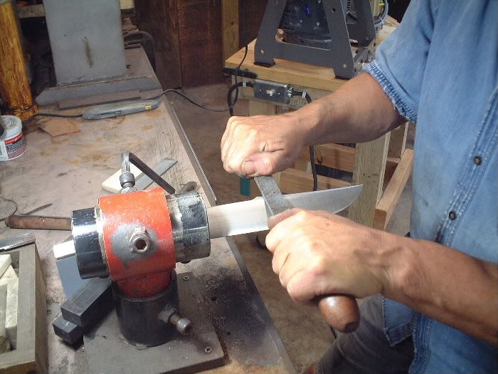

I sort of knock the major edges off on the grinder, but do the real IMPORTANT stuff by hand. There is really no other way to get a clip dead center and straight.

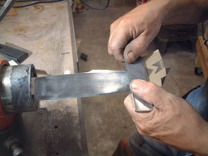

Then we need to clean up the clip which I do with hard steel backing to keep that clip SHARP!!
Now the clip is done and we need to sand the flats.

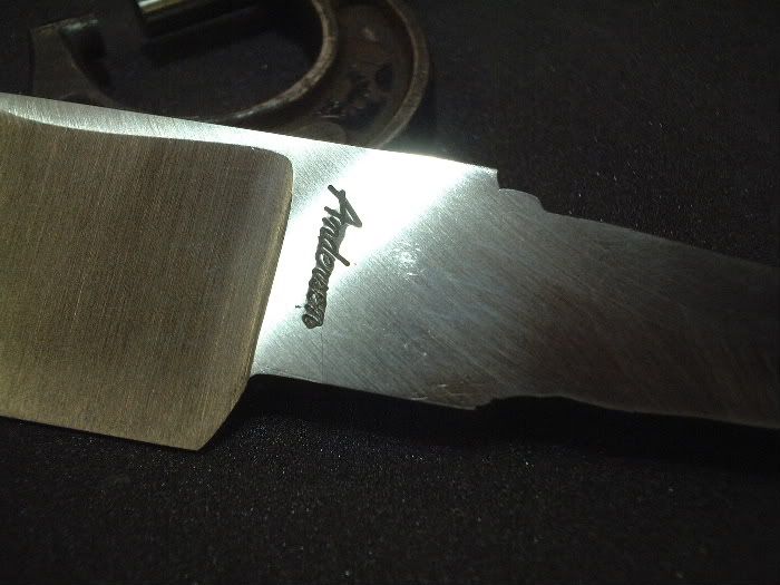

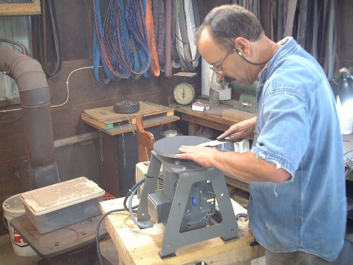

After the blade flats are readied for hardening, I have stamped my name and JS and need to do the final tweak on the ricasso, This I do on the disk.
After all is said and done, she's .262".

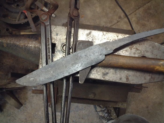

Set the guard shoulders:

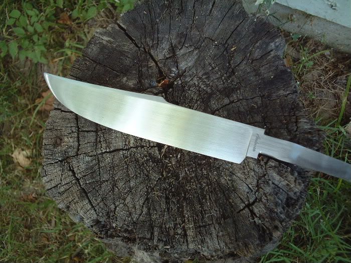

And the ol' "Gunflint Bowie" is about ready for the oven!

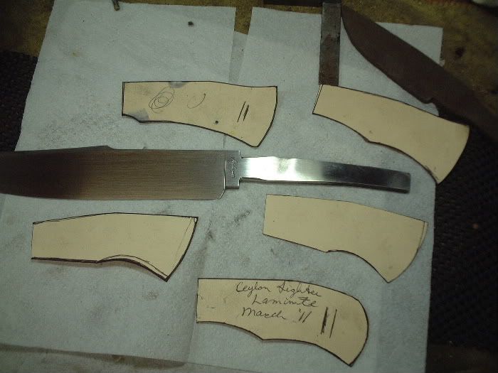

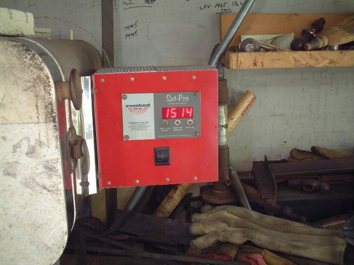

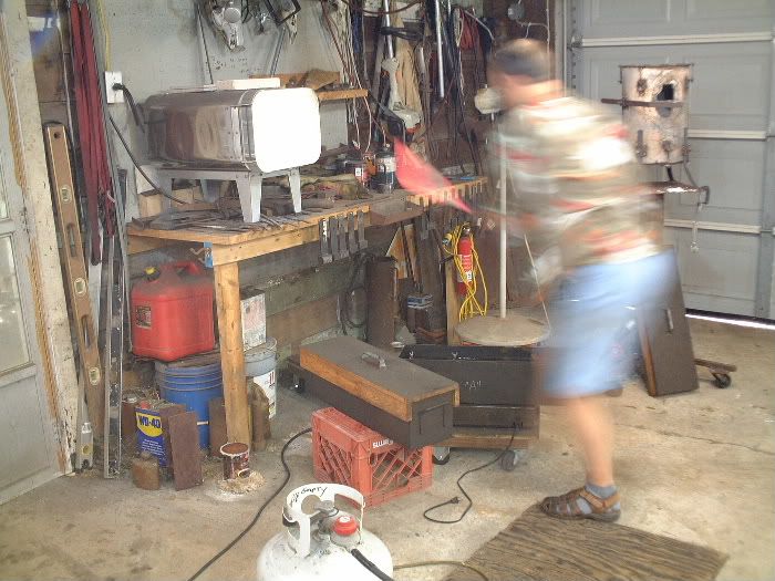

While my oven is warming its way up to 1515, I'll do a little thinking ahead.
I always like to have in my mind what exactly it is that I'm making, even long before I get there. Sort of helps keep me in focus.

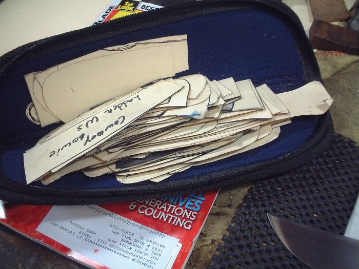

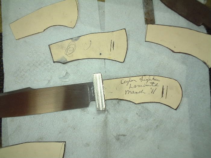

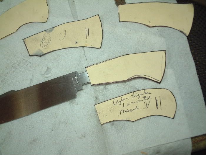

I always draw my knives for the visual, and also to have a pattern for my handle material cut-out. I save these and use them for ideas and future patterns.
Then I'll lay them out and get an idea of what I want.

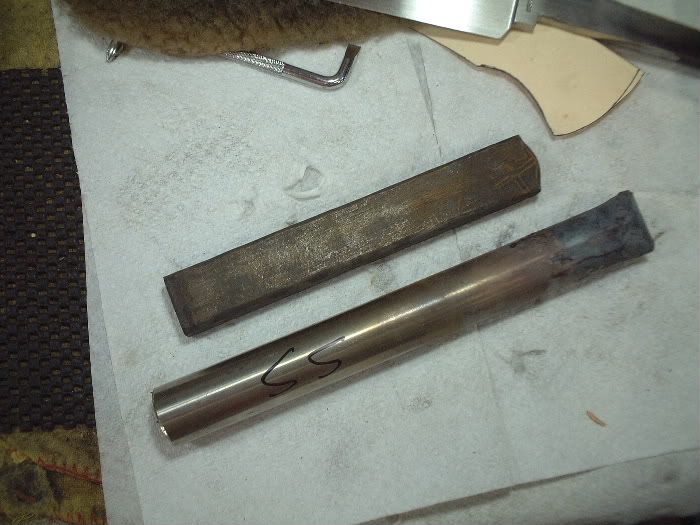

I buy 416 round stock and use for my fittings. This way I can get whatever size I want.

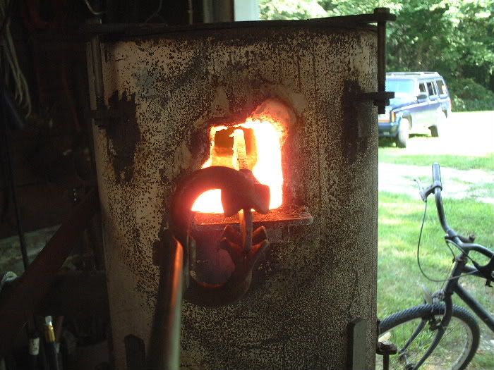

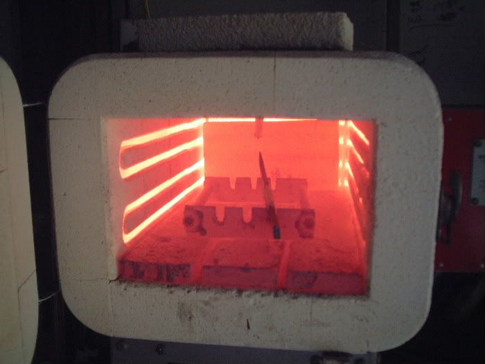

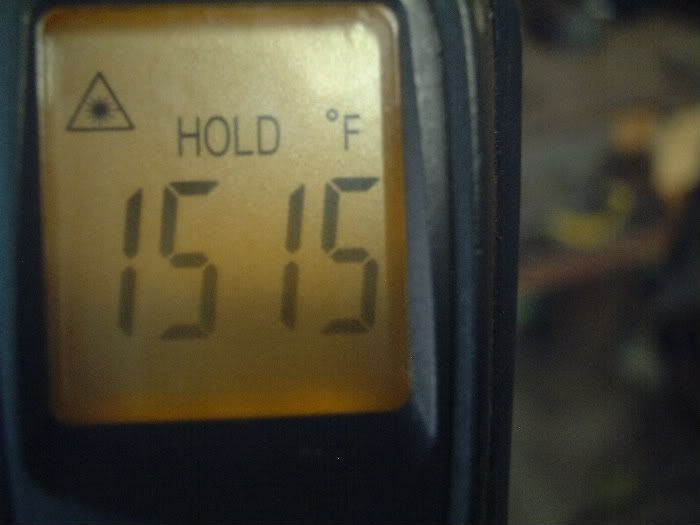

Look! She's up to heat. Now that the oven has made it up to 1515, the entire mass needs to come up as well. In the bottom of the oven I have a layer of 1" thick wrought iron that needs to heat up as well, so as to make a nice and even, continuous heat over 100% of the oven.
I give it one full hour - minimum - of soak time.

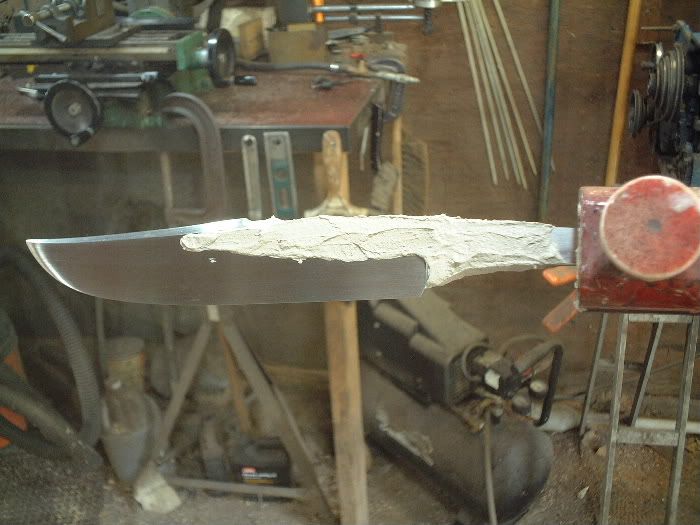

This 5160 that I got some time ago is amazingly deep hardening. I want a little bit of "give" in the spine and guard shoulder area, and I achieve this with a substantial application of clay.
This steel hardens so deeply, that it will harden underneath the bottom edge of the clay, and the tang will air harden without ever being quenched. It'll smoke a drill bit, no problem.
I will warm up my forge to dry the clay and I will do two reducing heat thermal cycles.
Then, after the second cycle and it drops to about 1000 degrees, into the oven she goes.
After four minutes in the oven, I open the door and shoot the blade with my laser thermometer. Guess where she is?

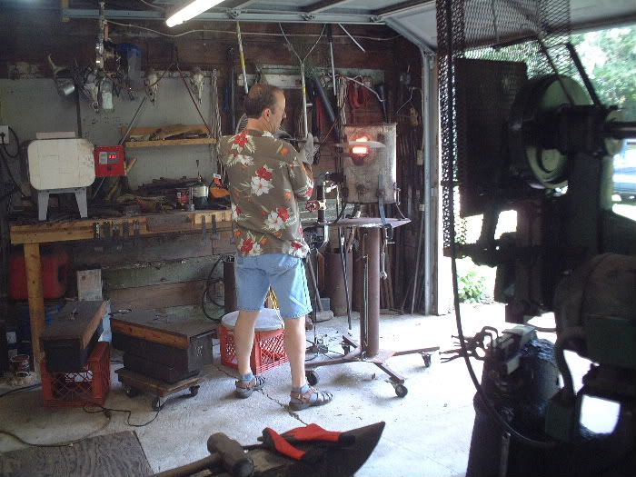

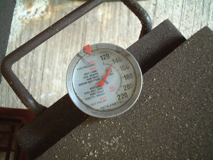

I was lucky enough to get 15 gallons of Texaco A before it became extinct.
(Luckily, it is now being produced, as far as I know, with the original formula/recipe and is called Quench A, by a company in Indiana.
I get good luck with it at about 140-150.
After sufficient soak time, a full blade quench!!
Then, a couple tempers.
