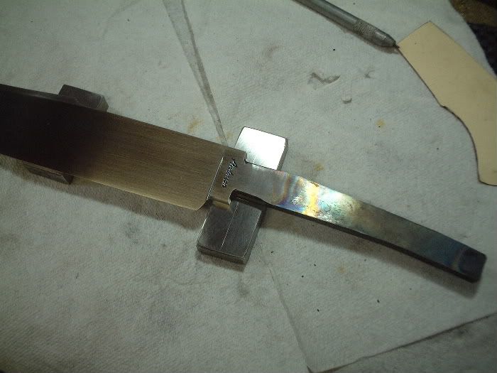

Anyway , earlier on in this thread I mentioned how I was sure that it would harden up under clay, as well as the tang itself simply from air hardening. Well, I forgot just how tough this stuff is.
Once I started to sand it, it was almost like Cru V. If you've ever tried to clean up a Cru V blade, you'll know what I'm talking about.

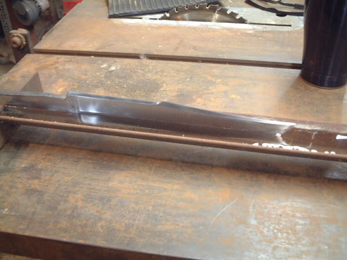

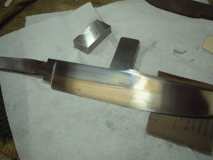

Anyway, I tried to keep that clayed up spine out of the quench, and I'm sure I did a pretty good job. Even with that, I could still skate a file on the spine!! Insane.

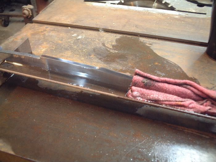

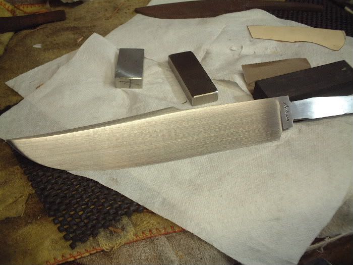

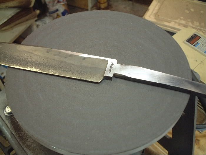

So, after I cleaned up the blade a little, I did a pretty intense draw-back on the spine. And the tang as well, so I could thread it later.
(clean up the ricasso)
(After an intense re-grind and rub job)
(draw back in progress - I keep the cutting edge and about 1/2 the blade submerged to stop the draw-back)
Result

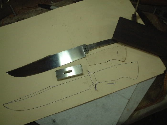

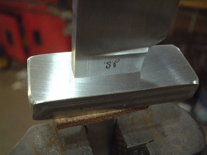

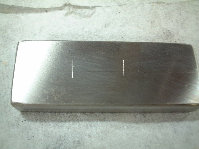

So now it's time to mark and slot that guard.
My ricasso is .262".
My end mill that I used was .123".
So, if I cut a slot .123" wide, I will need .139" more - 1/2 one way and 1/2 the other, or .0695" both directions.
So, here's the guard right off the mill as slotted:

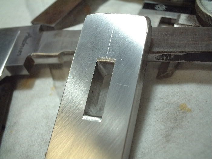

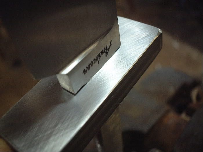

This is slid right onto the knife from the mill:

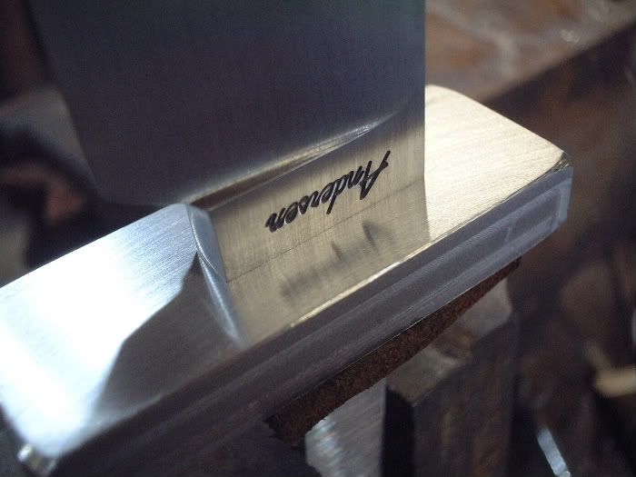

You can see how she comes to s dead stop right where the radius is on the guard shoulders.

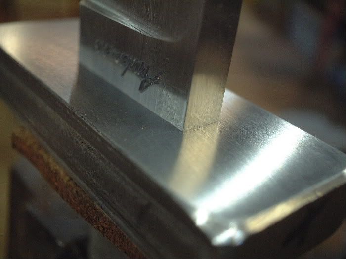

So, we file the top and bottom of the slot to match the guard shoulder radius:
Tap it into place:
(The radius at the top and bottom is the only place on the guard that I touched with a file)
And here's what you get:
