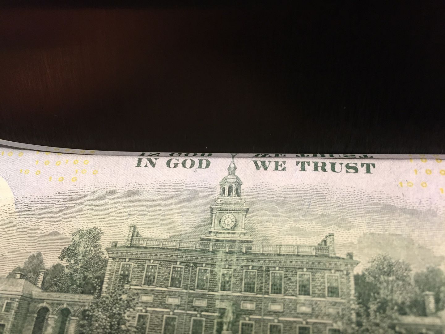

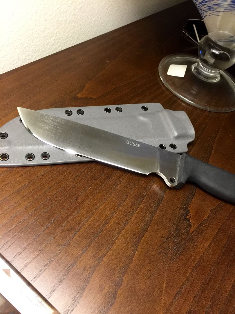

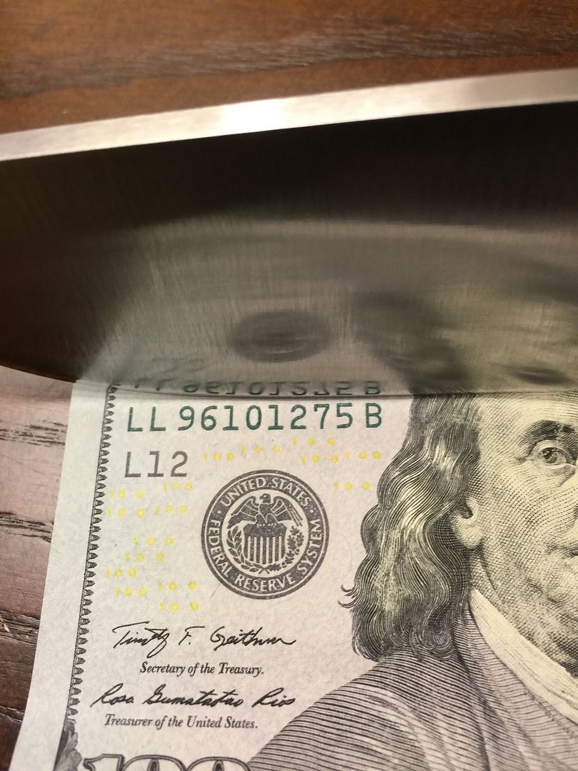

So last night I finally got around to finishing up my Basic 8 L.E.
I decided on a 19 degree per side edge (38 degrees Inclusive). I did some reprofiling and then took this beauty up to a clean mirror polish. It whittles hair along the entire edge. This beauty is my new go to hiking companion. I have no doubt she'll hold up to anything reasonable I challenge her with.
It was a real pain trying to get good pictures -- the satin finish and light bouncing off made the pics less than ideal ---- but here's a few anyway
I'd be interested in knowing if there's a large difference in degrees of the steel just behind the edge bevel to the 19 degrees of your edge bevel. Does that make sense?
If you want to take some better pics without harsh reflections on the satin, just wait for an overcast day and take the pics outside with a neutral medium toned background. I know, probably a tall order with how sunny South California tends to be. Or you could try indirect lighting by placing it near a window just outside of direct sunlight.

I would say that the angle behind the edge bevel has to be not much more obtuse than the edge bevel itself. If I had to guess -- I'd say maybe 21-22 degrees. The reason why I think that is because while stropping I noticed I was beginning to polish the area that you had ground with your low grit stone. I'd apply more hand palm pressure and tilt the strop so it made light contact with the area just behind the edge bevel.
Rob,
You must mean to say it's slightly less obtuse behind the edge bevel, it is not possible for it to be more obtuse behind the edge bevel unless the knife has a hollow primary grind. A convex primary grind sees a reduction in angle from edge to spine. Extrapolating, it must mean that it is around 16-17 degrees per side behind your edge bevel. Looks great btw, nice job!
Yes indeed -- my mistake -- yes hence the slight polishing that is happening as I apply palm pressure and slightly change the strop angle. (Assuming I understand you correctly). Thank you brother!
