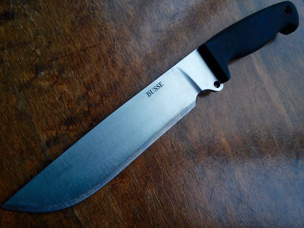

That Hell Razor looks mighty fine!:thumbup:
If 19.5 works for your HELLRAZOR, just make a secondary bevel above the 19° cutting edge that's a bit less steep, and you're golden.
The final cutting edge could be reeeeeal tiny, no one would even know its there I bet. Try a 24 dps leading to a 16 dps.
Just do 19 degrees, it should hold up just fine to those uses .![]()
Indeed Rob. You could even go with a 24 secondary to 19 primary.
I think we ALL do!:thumbup::thumbup:
Sweet --- thanks guys! I love the B8 LE
I'm glad you like it, ALOT! I was thinking though, you might even try 17 degrees per side . then use it and see how it holds up for your expected uses.
If the apex takes damage then simply increase the angle very slowly until the apex isn't taking damage with that usage.
