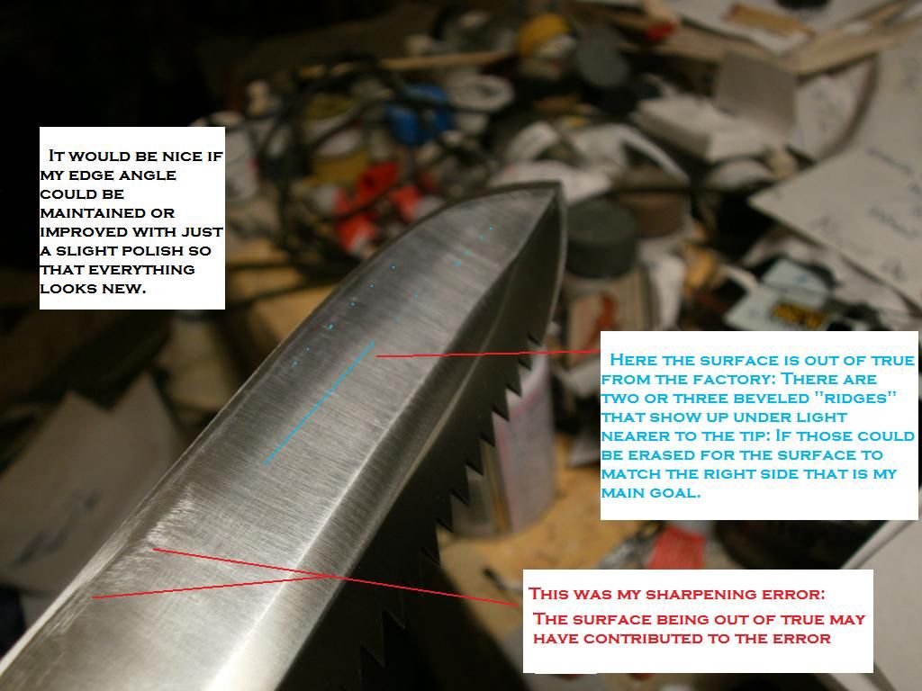

On the down side I had to send the Randall Model 14 back to the factory (in a cheap sheath, I kept the good sheath in case it got lost)... I just couldn't take some of the blade grinding errors. What I described previously as forging related flaws were actually finishing flaws that seem to be common on the Model 18 type blade: The right side hollow grind was perfect, but the left side had, near the belly of the edge, a series of flat surfaces that someone thought would pass for a proper hollow grind, once a shallow single "brush" polish was applied over the various flat surfaces...
Very hard issue to pick up on photos... What it looked like was like a long flat narrow area, with a straight delination top and bottom, then another long thin flat area: A succession of flat areas is not a proper "representation" of a true hollow grind curve imho... Furthermore, my impression is that it affected the functionality of the knife: When I sharpened, trying to get more angle on that excellent 0.5 mm thick edge, the diamond hone "slipped" and deeply scratched the finish, just where the diagonal "ridges", delineating the narrow "flats", met the edge... A sort of change of geometry occurred there that caused the stone to slip, in my opinion...
There was also the "problem" with the point, which I thought was jaw-droppingly sloppy: I just feel the need to post this so you know what you might be in for with a Randall... Check carefully for the pointiest point you can find on the model 18 blade: They vary hugely in profile alone... A Model 18 of the same vintage can vary from 11 teeth to 19, just to give you an idea...: My flawed 14 had an 18 style blade with 19 teeth, the incoming Model 18 has 18 teeth... They are truly not kidding when they say no two are alike...
This photo was part of some of the instructions that I intended to Email to Randall, until I realized they only deal with paper mail! (Having no printer or time to waste, I made a drawing and put it in the box instead):
The problem proved impossible to photograph, but it can sort of be guessed at in the darker area on the blade: The vertical sanding marks are my attempt to make the problem go away...:
This is how badly the point was ground on my example, I'm not kidding: This is the worst point grind I have ever seen on any knife I have ever purchased: I think some of my kitchen butter spreaders I have are more dangerous tools than this knife was...
This is what I managed to do after a huge amount of careful work: Still not my pointiest knife...:
This was how much metal I had to remove to get that point: You can imagine the difficulty in keeping the surfaces looking not too cosmetically damaged after all this grinding by hand...:
Incidently, this is the little survival kit I had devised for to replace the sharpening stone: the plastic box was cut out of a larger box, and is extremely rigid and uncrushable non-cracking type plastic... The packet at the end is just to make it fit better the slightly too long stone pouch, and contains just a single sealed Advil... Oh well... Fishing line, weight and a single hook is under the igniting "fuzzy" cord... The box could theoretically free up a lot of space in the hollow handle, which I think I will use for more intense fire-starting materials, if I need a fire fast, or in windy conditions.
So I will wait the 6 to 9 weeks they say repairs require to see how I am treated by Randall: Should be interesting... Quite frankly, I was very pleased with the 0.5 mm edge thickness (I wish all knives were all like that), the handle finish, and the unbelievably handsome sheath. Not much wire-edging occurred when sharpening as well, which is unusual compared to other knives I saw in 440... Despite this, the blade finish was a real downer... This was just one of the most roughly-finished knife blades I have ever seen, and I've bought some dime store clunkers too... There is some basic quality there, but they seem intent to bury it all under a notion of "if it looks rough, that's more old-world and handmade, and that's what you want". No it's not!
I'm giving them another chance with the 18, but if that is anywhere near as bad, that will be it... I just realized the lower price on that one ($500 vs 620 on the stainless 14) means it's carbon: No big deal, even though the 0-1 is supposed to be softer at 55 vs 57 rc: That one still had the best blade design of all the other 18s at that dealer: They are so different from each other it's like they are all different models: I'm not exaggerating... The expense of stainless is considerable on these knives: Again I don't really understand why, 'could be the forging stainless is a lot harder...
I would strongly recommend examining any Randall in person and carefully before buying... Photos just can't pick up all that can go wrong with these blades... And they shallowly buffer-polish errors out to make them look passable at first glance... In another thread were I showed this, another poster mentionned waiting the full four years, and being reminded what a huge letdown it was to get the knife after all these years... I looked hard at the photos this time: Hopefully the 18 will be all right, and they will do a good job on the 14. Fingers crossed...
