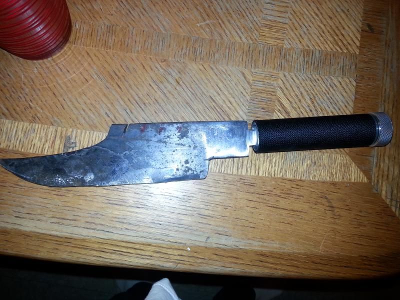

Radicalbearpaw sent me a few more pics of his knife in progress and I thought I'd post them for him. Looking pretty cool.
