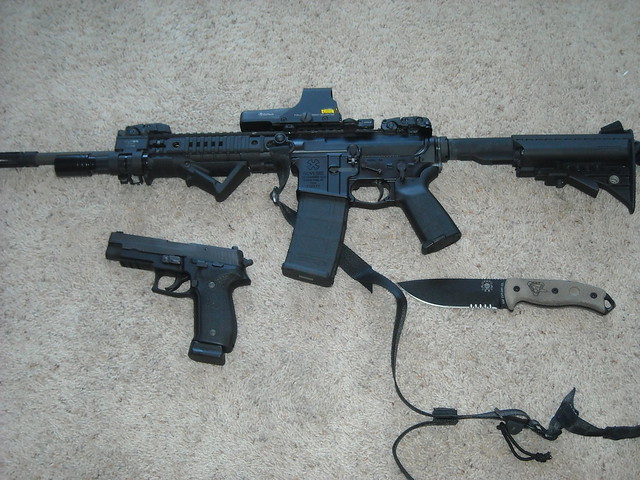

The 6520 is a great rifle. Here is my 6520 build:
I swapped the upper for a flat top and added a DD Lite 9.5FSP Rail. You don't have to hang a lot of do-dads but there are certain things that all my rifles get - Aimpoint (or ACOG), white light, and sling). Those are the non-negotiables. Those make a carbine more useful, functional, safe, and effective.
I should also add that if you are after a lightweight profile barrel, that several manufacturers make light weight midlength uppers now (BCM, Daniel Defense, and little birdie tells me that Spikes will be selling them at VERY attractive prices soon). If I was starting the above build from scratch today, I would go with a middy upper.
