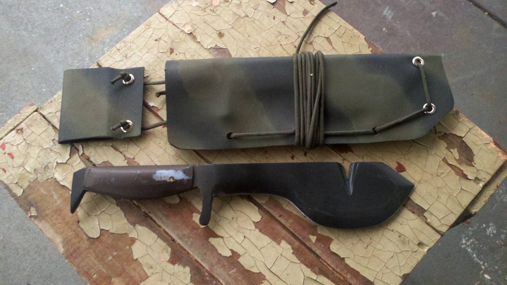

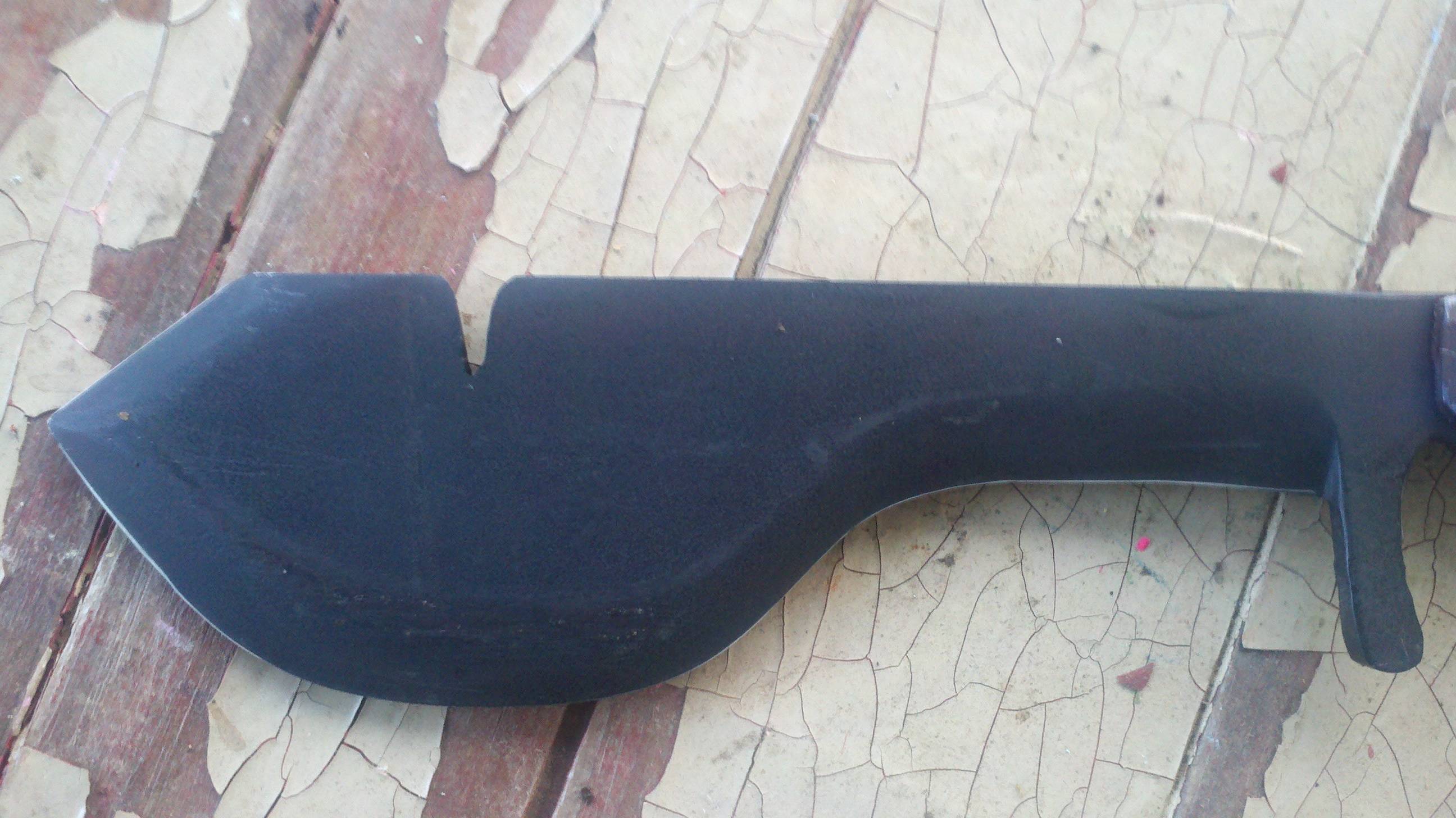

I call this prototype the BHX02 and I'm naming the model "The Hog". I'm very happy with it.

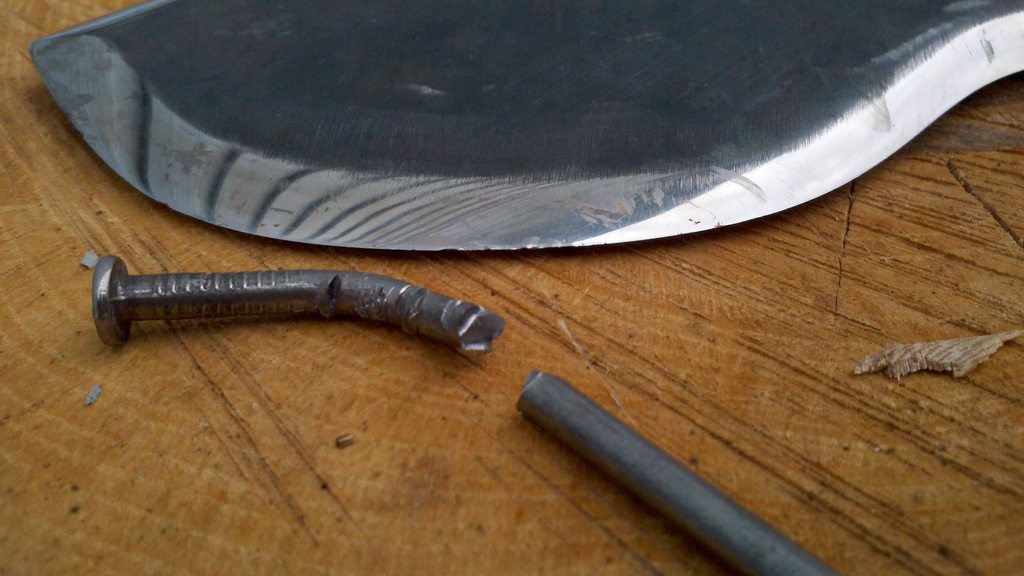

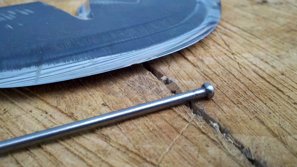

It cut this nail with a firm chop, but both halves went flying and were not recovered. NOTE that there was already a chip in the blade (we've been hard on this thing)
Took some practice chops and one monster chop, nicked the blade up a bit.

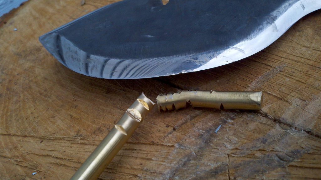

Tough stuff, a lot of work, 1/4" brass rod, no new damage to the knife though.
Reformed the edge, sprayed with Gunkote, and ready for bake.
I made the mistake of doing the final polish on the edge after the Gunkote, and marred it pretty good, the second application of Gunkote already had the handle scales on, and I couldn't bake it properly. It'll flake off.

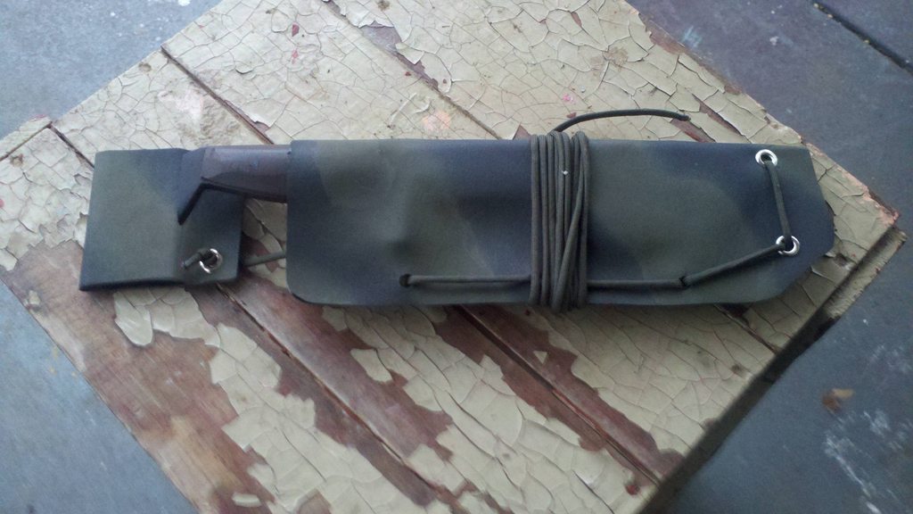

Finished and done. Kydex sheath. Plastic scales. Paint doesn't stick, but it'lll do. I need some good wood. I have access to some. I'll look into it.
My friend has some videos of how some of those nicks got there. I hope to have those up soon.

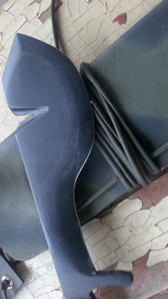

I'm very satisfied overall with the design aspects. Gut-hook and nail puller do the job but may be more trouble than they are worth. I'd still like some decent Chicago or post and barrel type screws to put the scales on, but the brass brads do very well. The eyelets and setter I got for the sheaths are JUNK. Looking into better of the same there. I'm anxious to make more!

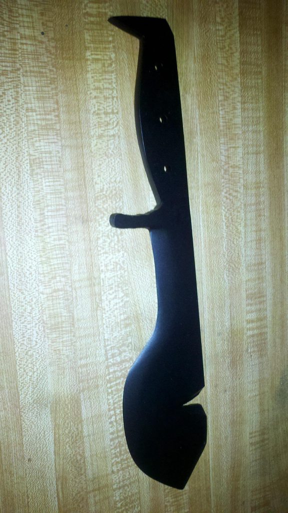

Again, it's A2, hardened and double tempered to 55RC, 20 degree convex edge, 20oz blade.
I'm going to look one last time at different steels, maybe one cheap tool steel option and one higher end option, possibly 1095 and D2.

I don't see anything that "shouldn't be" with this knife. I do see many flaws from a construction/performance perspective but those kind of things get ironed out with experience. I noticed in your link that you plan on selling these blades as soon as you can. I think that would be a mistake. You need to do more testing and growing before you release it to the public. There is a certain responsibility that a toolmaker owes to the folks who would put their trust in your ability. I don't think you are there yet. You have only just begun... you know this.
I'm glad you didn't let negative comments put you off from trying things but you need to be honest with yourself your craft and your potential customers.

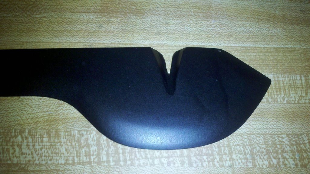

That nail puller right dab smack in the middle of the blade is a HUGE stress riser and at the hardness a knife requires might really cause that blade to break with heavy use over time.
Now if I really had to have a nail puller on a knife I probably would incorporate it at the rear of the tang and heat treat that area accordingly. At a 1/4" thick you could hammer with the spine of the knife and pull nails with the butt..... but then again that is starting to sound like a hammer with and edge :)

In the Kydex photo above, why not put eyelets in all the holes ?
Have you used that paracord drop legged sheath before ?
After 4, 5, 6 hours of walking through a rough trail I'd be really really fed up with the way it flapped around against my leg.
Have a look at other similar sheaths and look at kydex with a swivel instead.
Why put that nail puller in the middle of the blade?
In a survival situation I can envision having to pry, pound a nail, cut stuff, chop stuff but not nail pulling
If you had gone concave like a kukri instead of convex I would have had much less resistance.
An inward curve directs force towards the cut, while that outside curve pushes the knife out of the cut and possibly towards you .

My suggestion is to reduce the angle of your bevels and go with a full convex or v-grind. Thinning out the bevels would increase cutting performance with little to no effect on strength/toughness. You would be surprised at how thin you can go with proper geometry.
I also question the 55HRC tempering. That is WAY low for A2. You could do much better at 58HRC and probably get away with 60HRC. Your over-engineered geometry is compensating for the lack of hardness, but at the expense of cutting performance.
Your design resembles the Spetsnaz machete... which is held with high regard by many, so you are in good company.

If I did another nail puller design I'd like a teardrop hole in the center of the belly, with the point/V towards the tip, but that's a great deal more precision than I'm prepared to execute. Perhaps I should start practicing that.
Hi Barry,
Take a look at this on what causes stress risers
http://en.wikipedia.org/wiki/Stress_concentration
I do see, and I see how any notch creates a dramatic reduction in strength by creating an unsupported load bearing surface, like a floating balcony on a building.
I read that the fine point, like a crack increases the stress dramatically again by concentrating the stress to a fine point, this had not occurred to me, and is not at all desirable. I now understand how even though I have sufficent width in the steel, the manner in which the stress concentrates on the fine point is unacceptable.
If I should hope to include a nail puller in the design, is there a way to do it better? I had considered a tear drop inside of the blade, but thought better of the skill required, but the over all usefulness and appearance would be much more desirable to me, and worth inclusion in my own knife.

How is your machinist friend heat treating your blade? With what equipment? I worked in the tool & die industry for 15years and we did all our heat treating in-house. I can honestly tell you that the equipment we used would NOT work with knife geometry. I am speculating that your blade was severely overheated or the issue of retained austenite was not addressed, leaving untempered martensite over time. That is why is had to take such a low HRC to avoid chipping. Could you get him to outline his method?
I would be interested to see your source for the hard use blade at 53-54HRC.
A2 seems to be notorious for being "chippy" at any range of hardness. Perhaps another steel would serve your purpose better. On the other hand, Scott Gossman makes excellent hard-use knives using A2. He would be a good resource on that subject.
