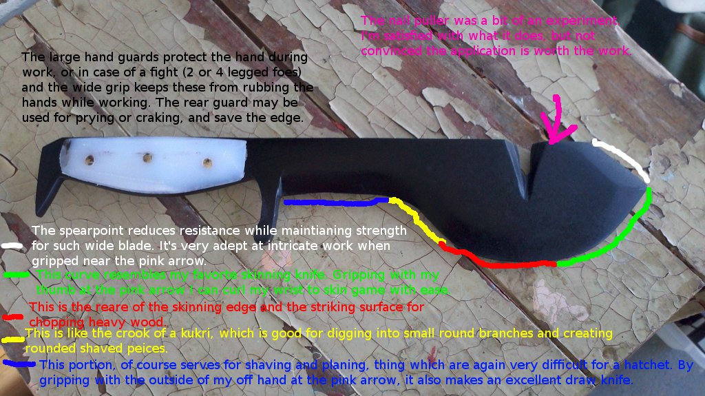

I'm not being critical for the sake of it, but I just don't get the design. You could weld an axehead to a handle and basically get the same function. But, with that said, I think with some refinement you are on to something. I see this evolving more into a tool used to cut/break into building/cars, etc., in emerency situations. Something firefighters might carry, for example.
I think you are missing the elements incorporated into this bush knife. Forgive the crudeness of my illustration, but it gets the point across just fine.
Naturally it's not strictly a bush knife and elements which may serve me in my suburban environment without taking away from the bush elements shouldn't be overlooked, or omitted in these prototypes.
I'm not so far from a police/fireman tool, and will be designing something for my cop buddies in time, but the true purpose of this is to reduce kit/weight in my backpacking/camping expeditions. I find that I end up carrying a hatchet, and often 3-4 knives, and this weights less than my hatchet and performs what I need it to, even better, while being able to do the tasks of my knives.
It makes fine work more tedious, but I haven't found a task that I need to do in the bush with a blade, that this won't accomplish. I'm still searching and open to ideas.

A claw/pry bar was largely what I was going for. The point is good for cracking/breaking, but the overall shape of the rear guard is to insert into cracks/crevices/joints, and hammer/pry.
Yes, the stresses, and the blade are the things to worry about. I think that the tear drop puller is the ticket, if hard to produce. A tear drop in the center of the widest part of the blade would allow a person to grip the handle and I think would greatly reduce any sort of stress riser as it would be totally enclosed, preventing any flexing on the fine 'V' point.

Basically I want to incorporate as much into a single knife as I can without taking away from it's primary functions. It's a lot going on and a lot to do, but if it doesn't hurt, "why not?" I'm not defending this nail puller design. It's not quite right, but If I can make a nail puller without hurting the rest, it'll be there. If I EVER need it, it'll keep my from toting a claw hammer or a pry bar.
You know, after looking at the picture that you put the colored lines in, I was going to say about the only thing you are missing on a survival knife is a spade, but you could use the fattest part of the blade in a pinch. Depending on how rounded it is on the flat that is. But honestly, I kind of like the multi use aspect of this. And I'm sure you had a lot of fun trying to work in everything into thise, unfortunately there is no room for a sink!

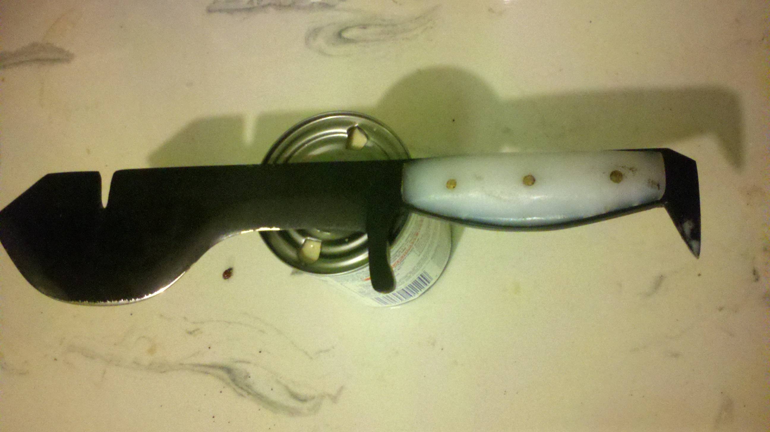

If I had to dig with it, I would use the pommel like a pick and scoop loose dirt with the blade or by hand, but making a digging stick is actually pretty effective for trenching and drilling small holes if you use your head a bit.

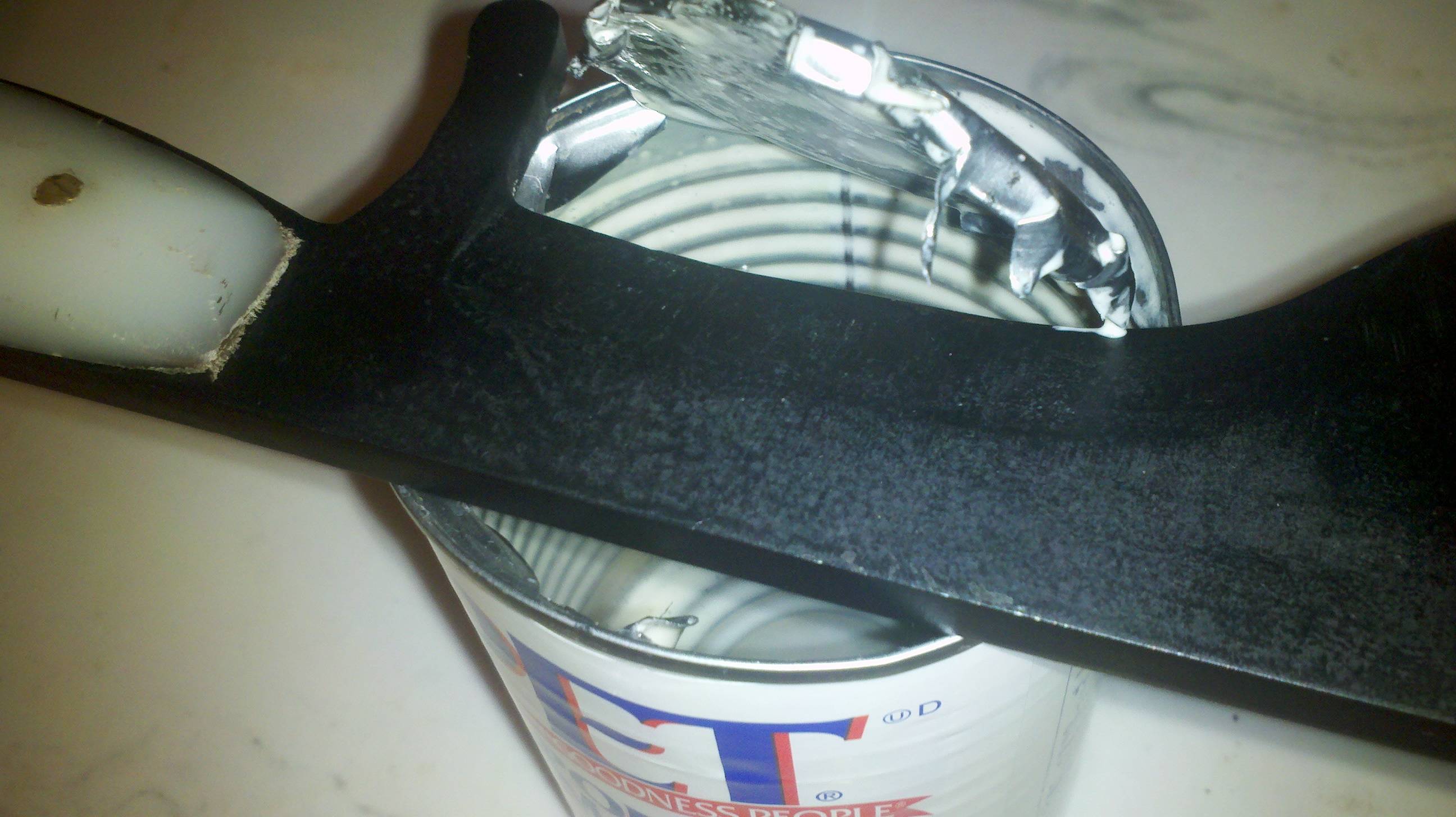

I had no doubt that I could get into a can with my knife. I had wondered whether I could do it without scattering the contents over half the county.
Well, by placing the rear spike onto the can and striking sharply with my palm I get in without spilling a drop!
Ladybug for scale.
A little rinse and repeat and it's wide open in a jiffy.
Sorry, my scale crawled off.

Well, the ax/hatchet element is strong, and accounts for a lot of he bulk, but in essence I wanted to combine my hatchet, carving knife, skinning knife, and some additional utility into a single blade in the interest of reducing weight/bulk in my kit. I'm confident that I have done exactly that. This is by far the most useful and durable knife I own, but there is still room for improvement, and that's why I come here.
I won't say that it'll be a seller, and if I never sell one, that's just fine. It'll do what I needed it to in the first place, and that tickles me PINK!
I'm going to go back and make some more blanks when I get a little spare cash. I want the straight part of the blade to be wider. Perhaps wider overall. More like my late sketches. I'll try to get one of those up later.
I'm wrestling with making it 1.5" longer an adding a choil. Seems a bit too long, but I love the feel of putting the front guard between my fingers, would make fine shaving more controllable.
